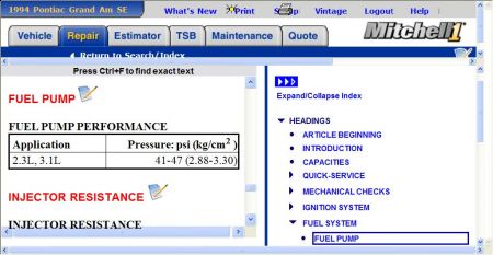

The fuel pressure is low it should be 41-47psi
https://www.2carpros.com/forum/automotive_pictures/12900_fp_10.jpg

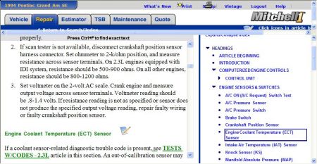

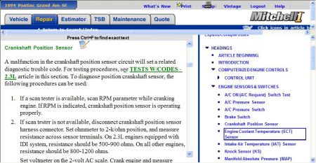

Check the crankshaft position sensor on left side of engine near oil filter. Sorry I couldn't come up with a pic for the exact location-See testing of CPS below
https://www.2carpros.com/forum/automotive_pictures/12900_cps_28.jpg
https://www.2carpros.com/forum/automotive_pictures/12900_cps2_6.jpg

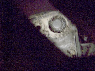

Well I found the CPS, its right next to the stater, you can just see it looking thru the intake runners, when I removed the screw and tried to wiggle it out, it was broken, so themagnet section with the O-Ring is flush inside the block.. Attached is a lousy picture, the center is the magnet, to the left is the mounting hole, to the right is the starter. Unless I can figure a way to either drill out the center of the magnet and use a screw extractor, I might be forced to remove th intake and that will be quite a job along with all the dirt after years of driving. Though of tacking a long welding rod to the end of the magnet and try to remove it that way, but concerned about pushing anything any further in the block, just making it that much harder. Any ideas ?

  • 75,992 POSTS
Drilling and screw extractor sounds good while a vacuum cleaner sucking the debris at the same time.

I used a drill bit to basically route out the plastic around the magnet untill the magnet showed a litle movment, then used custom made 90' vise grips grabbed onto the magnet and wiggled and pulled and slowly POP it came out and seemed to leave no residue in the hole. Installed the new CPS and fired it up, BTW when running the fuel pressure is around 40lbs so that is within limits. Let it idle for 20mins and drove it around block before heading out to get gas. All "seems" fine now. Many thanx for your help ! ! ! ! ! ! Hmmm just tried to PM ya but it says I need 10 posts first?
