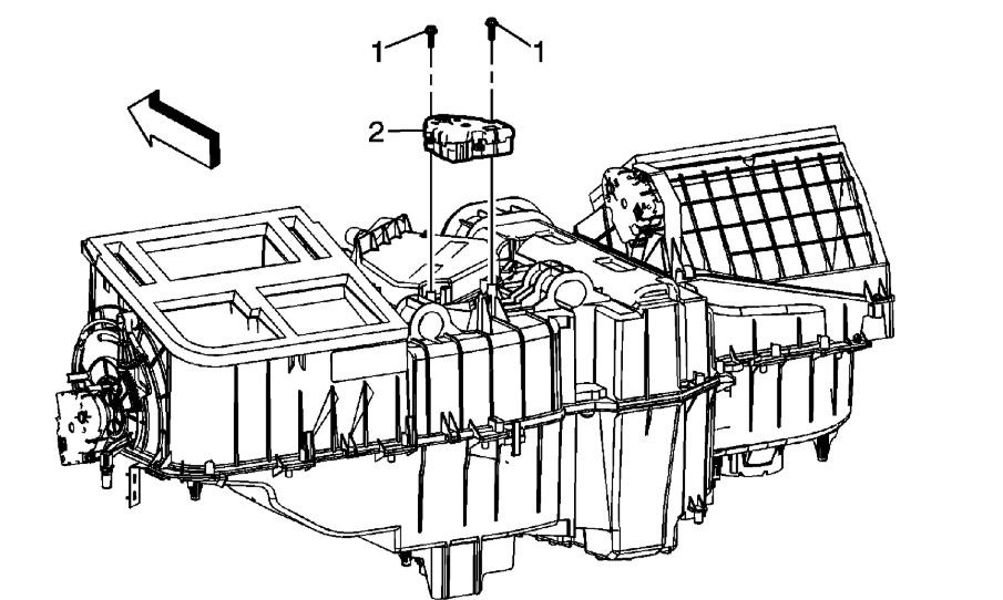

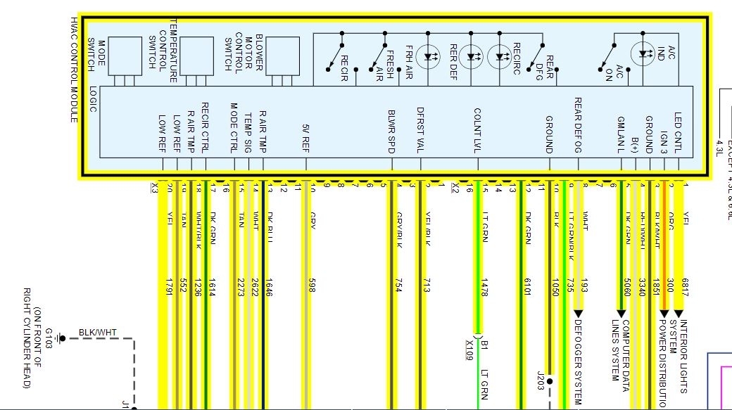

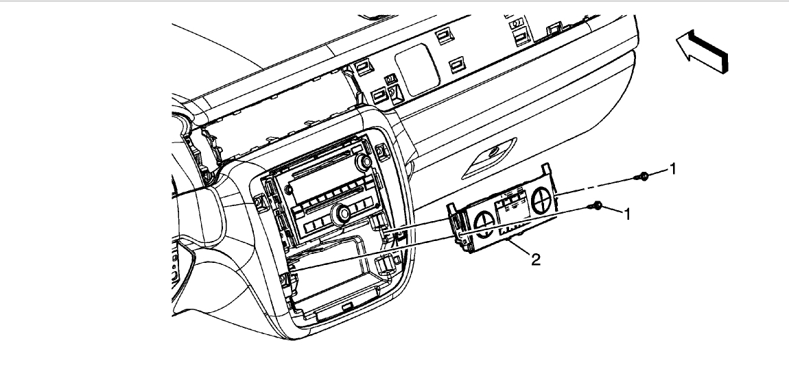

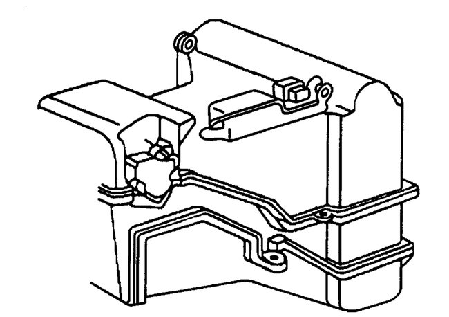

my climate control works but doesn't throw heat or A/C mechanic said it's the blender on the top of the dashboard or the wiring which it was messed with. need help finding this pin out please.
Jun 26, 2020 at 5:41 AM
  • CAR REPAIR CONTRIBUTOR
Good morning,
The actuator is the most common failure for the temperatures not changing. It is on top of the heater case as your tech stated. This guide and video will show you how to change it.
https://youtu.be/Eqf-H3COtSo
and

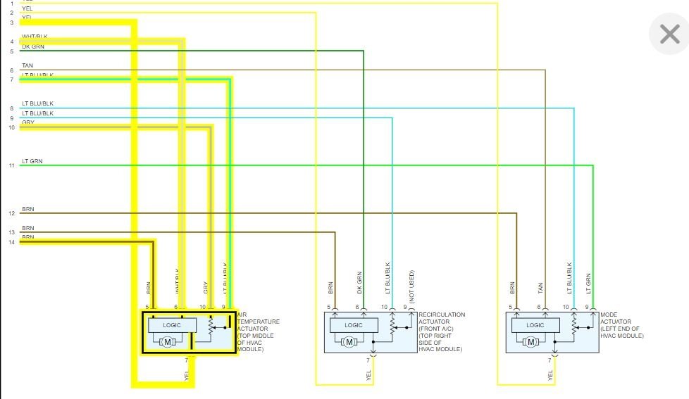

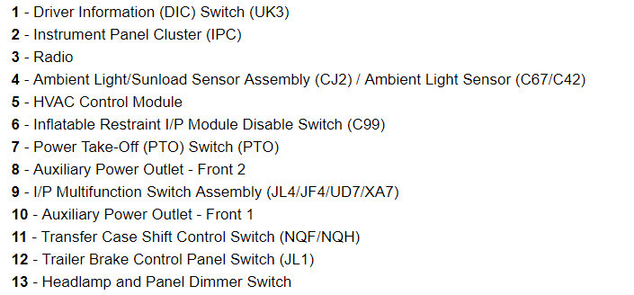

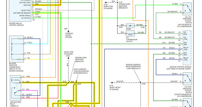

I attached the pinout of the module as you requested.
I also attached the actuator replacement procedure and location of the blend door for you. Check out the diagrams (Below). Let us know what happens and please upload pictures or videos of the problem.

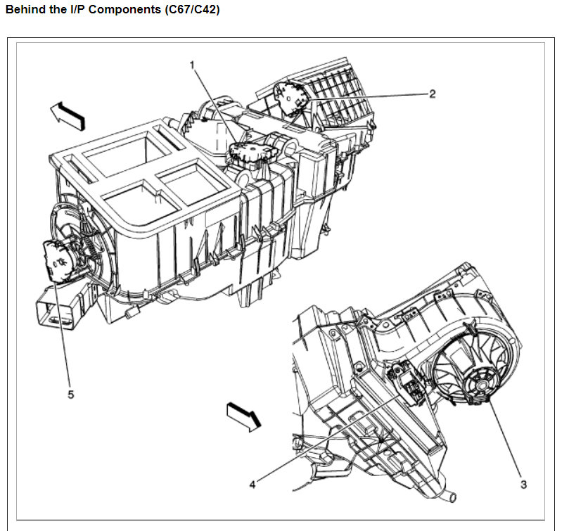

This definitely sounds like it could be a problem with your Heating Ventilation Air Conditioning (HVAC) blend door actuator. I have included diagrams down below in the diagrams down below of the location of the blend door actuator for your vehicle. I also have included a link for you to go to:
Please go through the guides and get back to us with what you are able to find out.

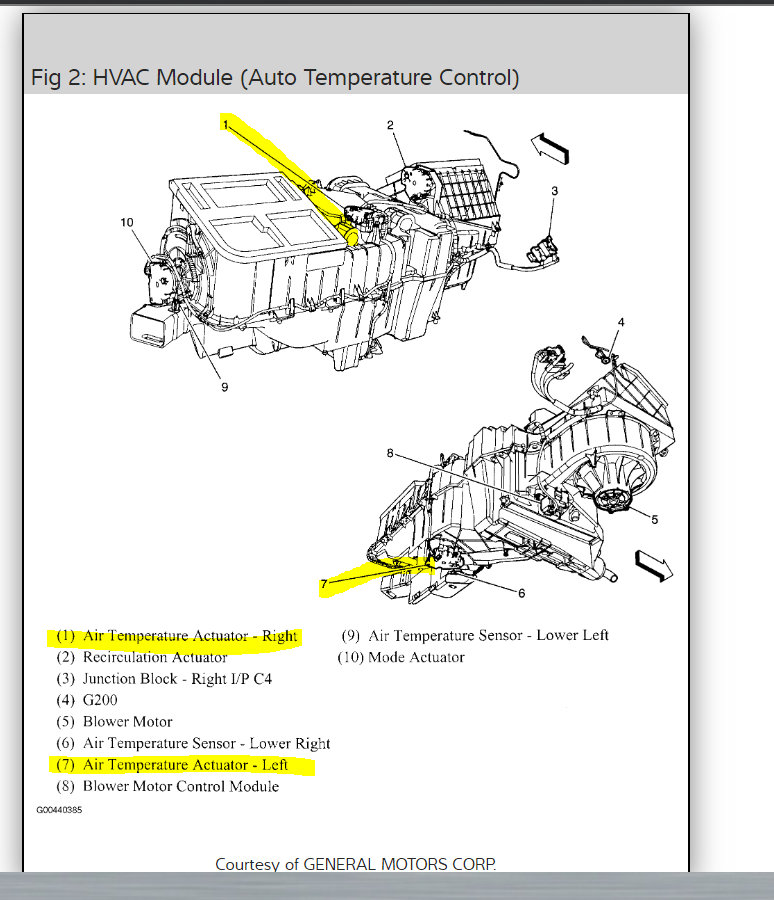

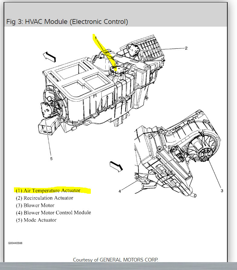

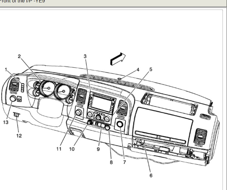

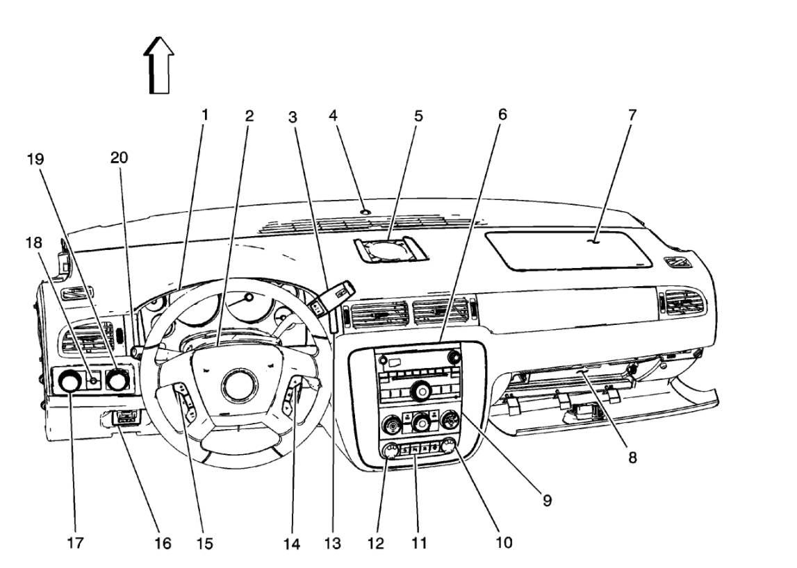

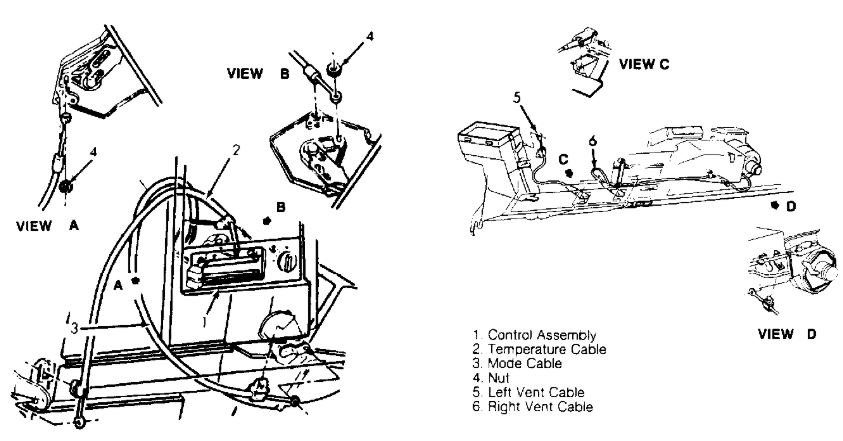

Is Fig. 2 for a dual climate control and Fig. 3 for a single? Just want to make sure im reading this right because i have a single control unit and not a dual.
Apr 30, 2021 at 2:05 PM (Merged)
SCGRANTURISMO
  • 4,897 POSTS
Hello again,
Figure 2 is Auto Climate Control and Figure 3 is for Electronic Control. The way I see it is Figure two is when you set a desired temperature and the vehicle maintains that cabin temperature for you, and figure 3 is for you have to manually adjust the temperature yourself. It must be an option on your vehicle.

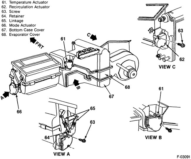

i have discovered that the heat/cool blend actuator is not always working and that I may need to replace it but I do not know where it is located, when I took the (3) 7 mm screws from under the dash near the floor, then removed the cover I did not see any actuators just more plastic, so before I start pull the whole thing apart or paying some crazy amount of money I was wondering if you knew where it is located or even have the exact diagram for my truck? Thanks.
  • 54,415 POSTS

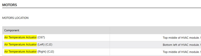

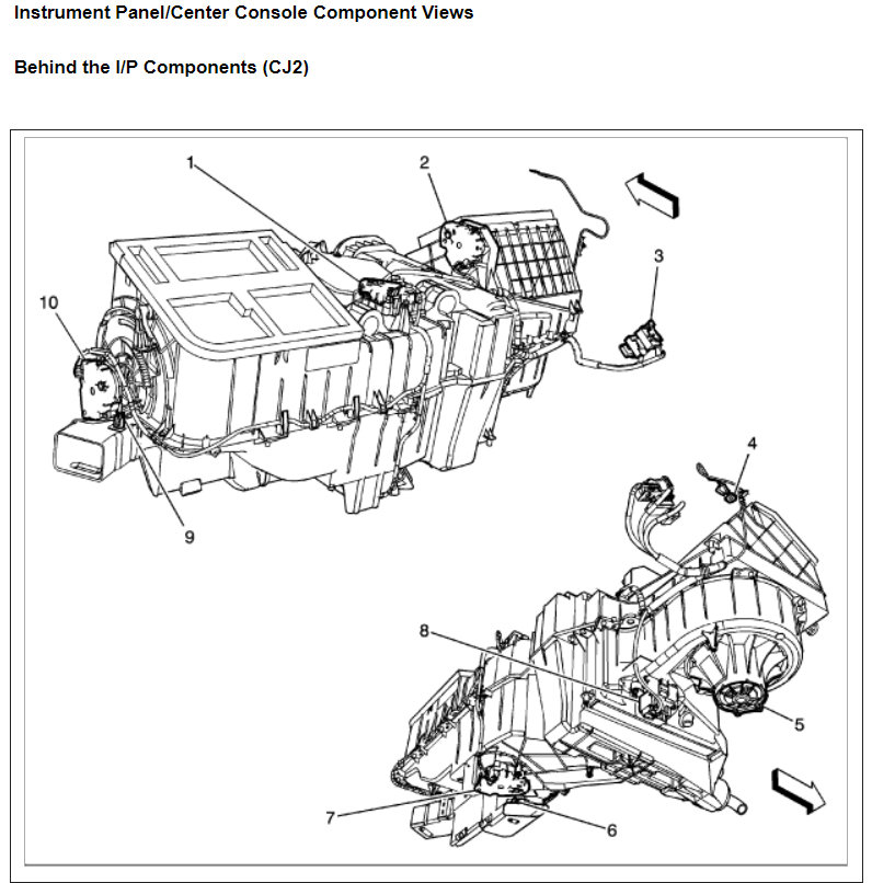

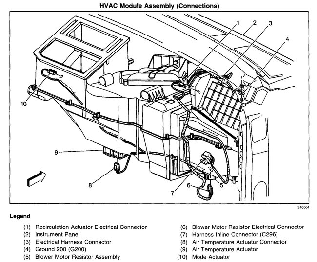

Here is a guide to help you see where all blend door motors are with diagrams below

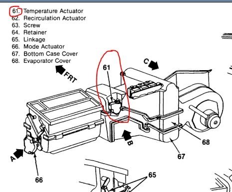

Try pulling hvac fuse under hood for 60 seconds first as it may reset the actuators. see pic for temp actuator, if you have both left and right temps this is also for right side. Check out the diagrams (Below) Please let us know if you need anything else to get the problem fixed.

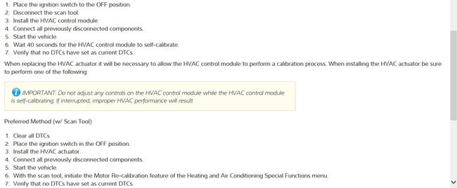

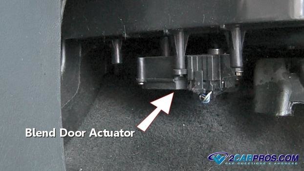

The driver side vents would flip from AC to very hot air. I watched the video and replaced the blend door actuator. Did the re-calibration by disconnecting the battery for about fifteen minutes, reconnect and turn the truck on for one minute. Turn off a few minutes and turn on again two minutes. I could hear a ratchet sound during the process. Now it is hot all the time and very little air volume coming from the passenger side vents. What can I do to fix this? Thanks.

Looking at your diagrams, it appears I replaced the wrong actuator. The one I replace is shown in your photo below under the cowl on the passenger side. Is the correct one under the top of the dash? Do you have a video showing how to get to it?
Apr 30, 2021 at 2:06 PM (Merged)

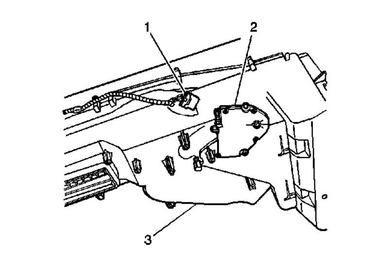

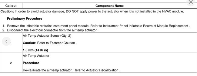

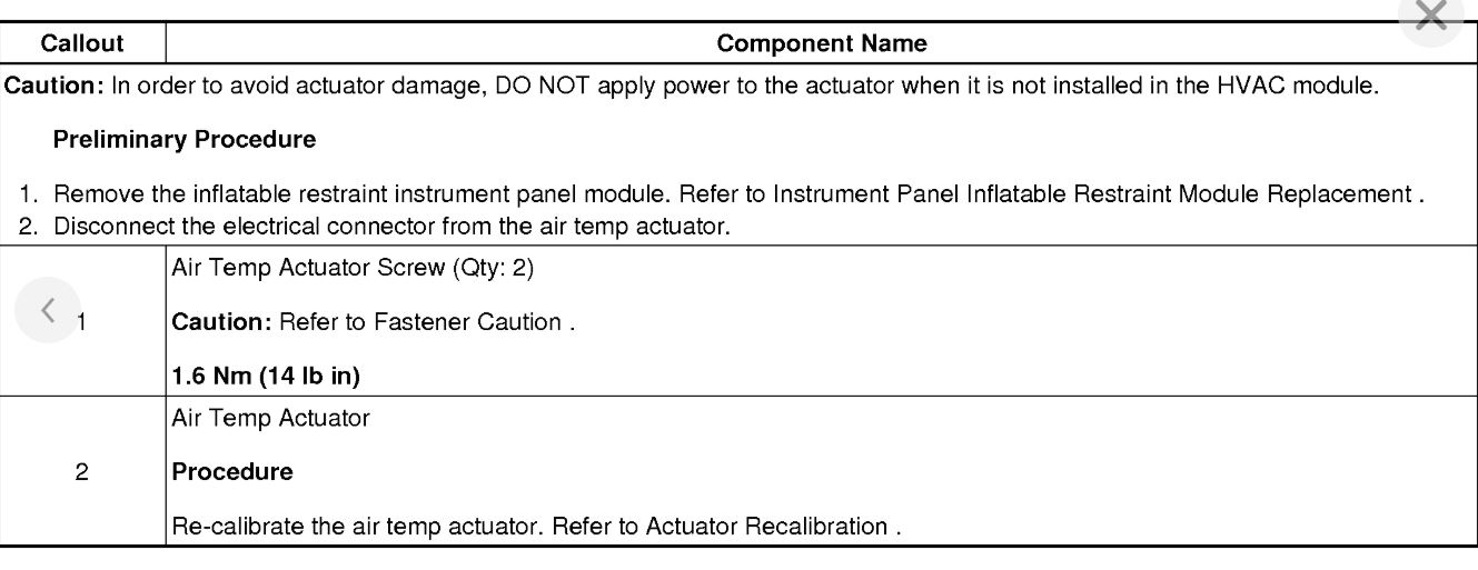

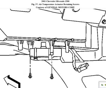

That is correct. That is not the actuator. The correct one is under the dash, left side above the fuel pedal.
I attached a picture and the procedure. Easy replacement.
REMOVAL PROCEDURE
1. Remove the I/P insulator panel.
imageZoom/Print
2. Disconnect the electrical connector (1) from the left air temperature actuator (2).
3. Remove the screws from the left air temperature actuator (2).
4. Remove the left air temperature actuator (2) from the HVAC module assembly (3).

Now I am confused. According to what I have read, the actuator on the left over the gas pedal is the mode door. Most of the videos I have seen state that the hot/cold on the driver side is regulated by the actuator on the right side underneath, the one I replaced. I even think the 2CarPros video stated or implied that. But the diagram on the 2CarPros article suggested that the driver side hot/cold was the actuator on the top right side (not the recirculate). So I am thinking that I did replace the correct actuator, but that either my replacement part is not correct or I did the re-calibration wrong.
I opened the actuator that I took out. It did not have the metal under the large gear, nor the track on the board like all the ones in the videos have. I do not know what that could mean. Outside, the actuators look the same.
If you have dual control or left and right control, that is the left side.
If you have only one control for both sides then it is the one on the right side.
Since you said only the left side goes warm, it sounds like you have dual control.

you can try tip that I'm sending also try removing hvac fuse inside truck for 60 seconds then reinstall. Do not move any hvac controls after reinstall. wait another minute and see if it straightens out. then look at first pic that is a tip that other mechanics have found.

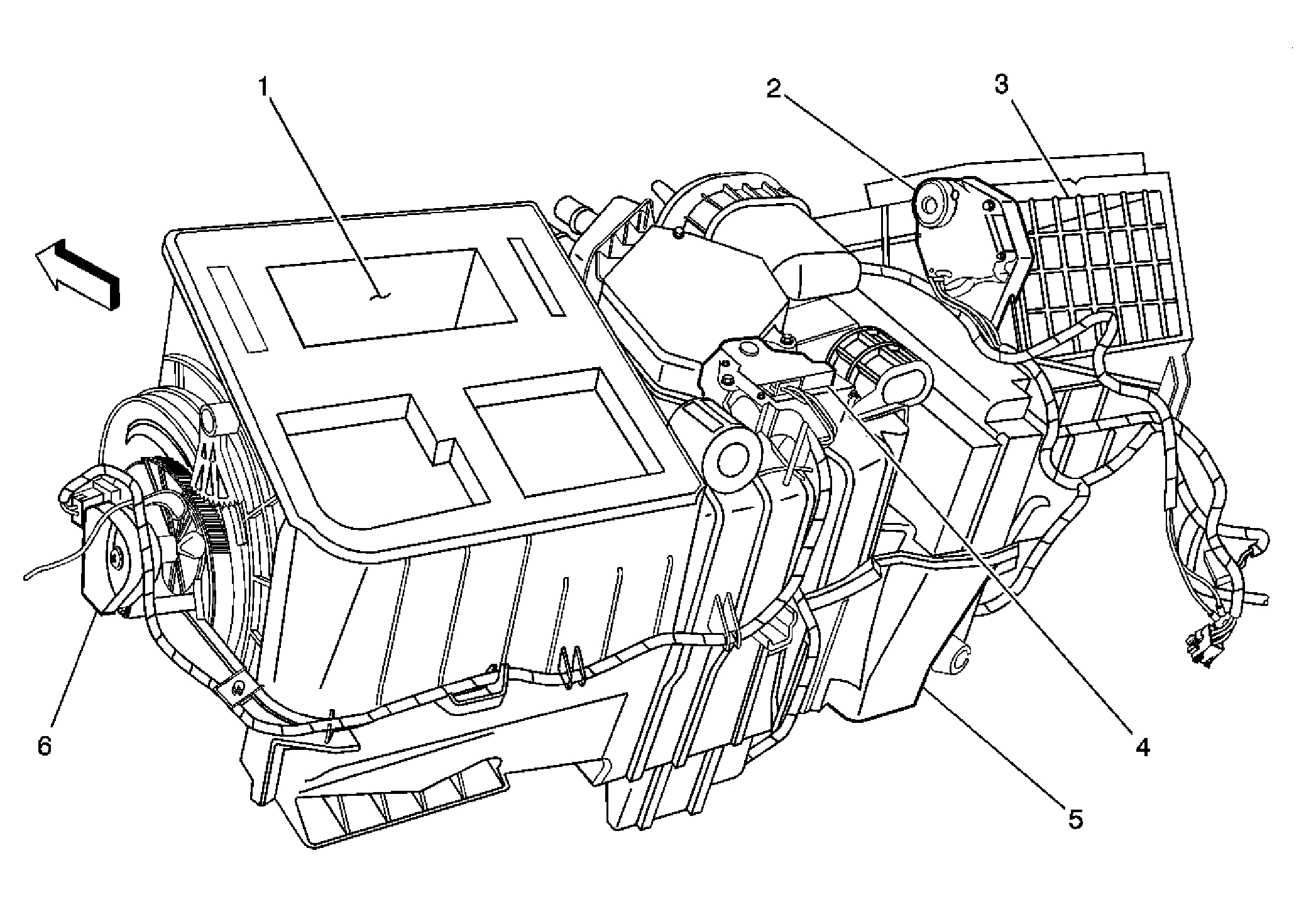

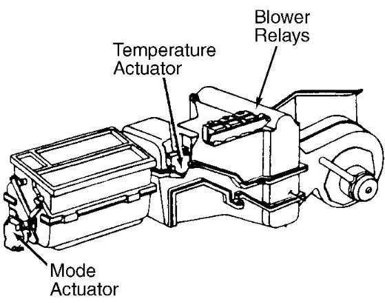

1BIGFISH
I have the manual temp control and I know my actuators do not work. I have replaced the actuator located at the bottom over the transmission tunnel. It moves with the temperature control. I still cannot move the air off the defrost and don't think I get recirculating air. So, here is my question. Per your diagrams, it looks like there are a total of four actuators. When I look for the part, I find it confusing to find the correct part number for each actuator even though I have the RPO codes. I installed Dorman 604-112 and it works great. Is it possible that this same actuator will work in all four spots?
STEVE W.
  • 15,167 POSTS

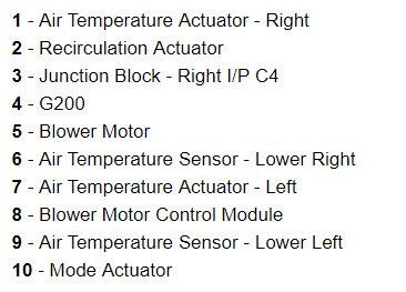

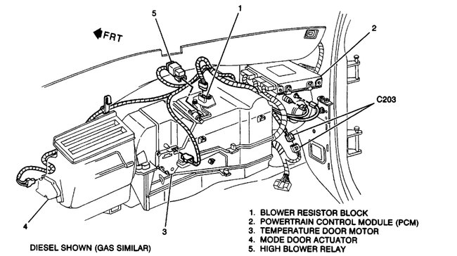

It is rare for all of the actuators to fail at once. In your case it sounds like the mode actuator on the left side (drivers side) at the top of the case has failed. It controls the floor/dash/defrost modes. I believe you can change it without taking the entire dash out.
In the picture six is the mode door actuator, two is the re-circulation door actuator, four is the passenger side blend door actuator and the one you replaced is the drivers side blend door unit. Depending on the actual option package and controls the actuators are the same for the two blend doors, the mode unit is different as is the re-circulation actuator.
Here is a guide that can help you too.

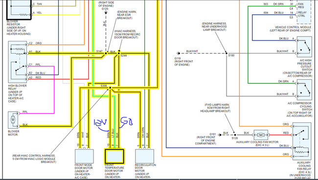

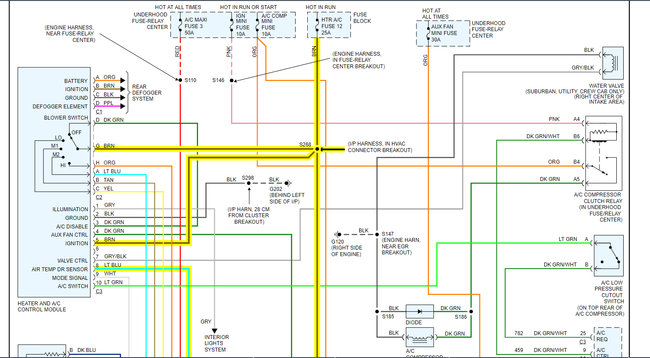

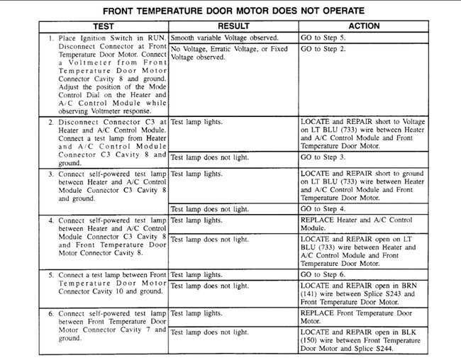

I attached some additional pictures and a flow chart for you.
Check the voltages at the connector for the blend door. I identified the power and ground for the motor.

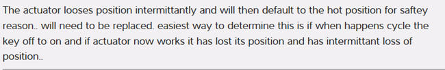

When I have my defroster on in it is blowing hot air sometimes it switches to cold air automatically. I sometimes have to run the control all the way too cold then back to hot to get heat.
MASTERWRENCH
  • 258 POSTS
It sounds like there is an issue with the temperature blend door and/or blend door cable or actuator. This particular model vehicle used two different types of control systems depending on whether or not it was equipped with air conditioning. Attached below are two different diagrams of these systems. The first is the heat only version which uses cables to control the blend/mode doors. The second is the system with A/C which uses electronic actuators for these doors.
If you have heat only, have someone move the temperature control while watching the cable/lever at the lower left area of the heater housing. Based on you description, it sounds like the cable may be loose where it attaches to the door lever.
If you have A/C, remove the glove box assembly to access the door actuators. Looking at the second diagram below, you can see that the blend door/temperature actuator is at the top, toward the center of the housing. Again with someone moving the temperature control, observe the actuator and make sure the linkage is all in place and not loose or broken.
Let us know what you find!

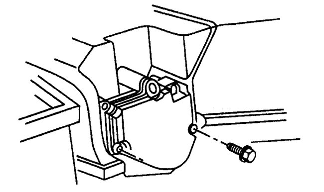

JOSE PEñA RAZORS NATION
I was told the blend door motor might be stuck in the hot position. It blows hot air to the drivers side floor board even with the heater/AC controls off.The heater and defrost work though when needed. I just can't get cool air from A/CI've gotten the Freon filled so that's not the problem.I want to fix it myself and just want to know whys it doing this and how do I fix it. Thank you
Apr 30, 2021 at 2:07 PM (Merged)
  • 110,193 POSTS
Welcome to 2CarPros.
The blend air door actuator is under the dash on the HVAC unit. Here is a link that explains in general how one is replaced:
Here are the directions specific to your vehicle. I attached two pics. One shows the HVAC unit under the dash, and the other, I circled the actuator in question.
