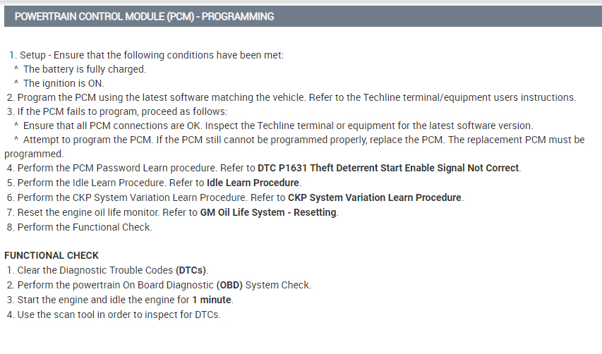

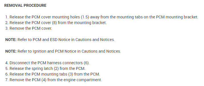

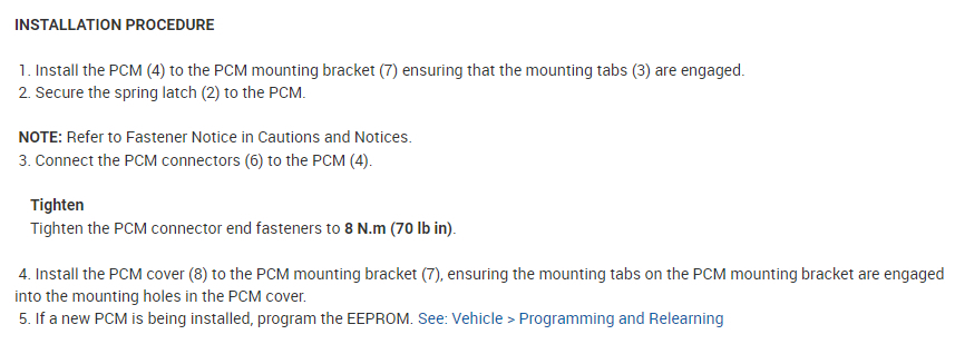

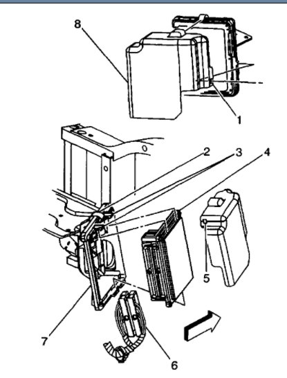

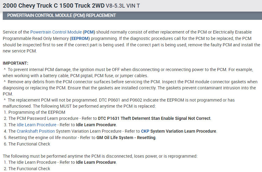

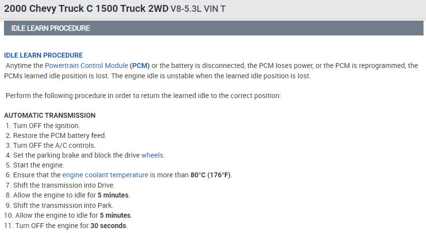

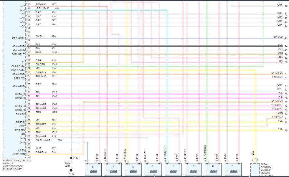

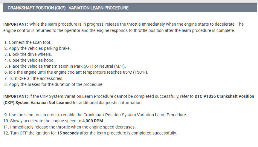

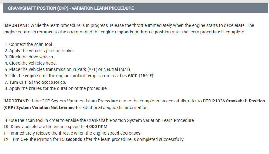

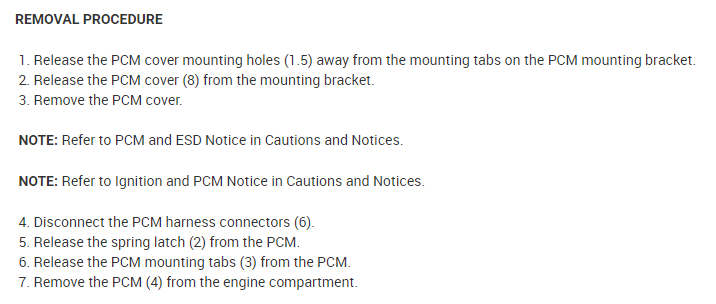

Hello again.
Okay, let us know how things go after ECM replacement. There are a few relearn procedures that will need to be done after replacement. I've attached picture steps below showing how to replace the ECM and the relearn procedures. Hope this helps and thanks again for using 2CarPros.
Danny-
Sunday, March 21st, 2021 AT 11:01 PM
  • 52,797 POSTS
Like Danny stated, you need to program the replacement ECM for it to work.

  • 52,797 POSTS
Okay, did you have the ECM programmed to your VIN number? Even if you have the same part number it still has to be programmed to your VIN.
That can be done with a DRB 2 or equivalent advanced scan tool. Most shops have the capability to program the ECM.
Procedure
1. Setup - Ensure that the following conditions have been met:
The battery is fully charged.
The ignition is ON.
2. Program the PCM using the latest software matching the vehicle. Refer to the Techline terminal/equipment users instructions.
3. If the PCM fails to program, proceed as follows:
Ensure that all PCM connections are OK. Inspect the Techline terminal or equipment for the latest software version.
Attempt to program the PCM. If the PCM still cannot be programmed properly, replace the PCM. The replacement PCM must be programmed.
4. Perform the PCM Password Learn procedure. Refer to DTC P1631 Theft Deterrent Start Enable Signal Not Correct.
5. Perform the Idle Learn Procedure. Refer to Idle Learn Procedure.
6. Perform the CKP System Variation Learn Procedure. Refer to CKP System Variation Learn Procedure.
7. Reset the engine oil life monitor. Refer to GM Oil Life System - Resetting.
8. Perform the Functional Check.

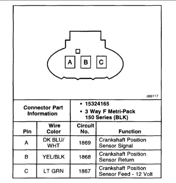

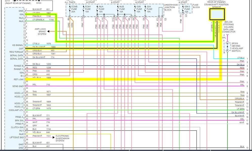

Okay, I attached the wiring diagram of the crank sensor and the connector.
Do you have 12 volts to the connector on terminal C or the light green wire?
Also, put your voltmeter leads in the connector. Red lead to C and black lead to B or the yellow-black. Tell me the voltage. It should be battery voltage with the key on.

Yes, 14v.
Saturday, April 10th, 2021 AT 3:04 PM
  • 52,797 POSTS
Okay, that is 14 on both pins? Did you put the black lead in the connector as well?
Saturday, April 10th, 2021 AT 3:10 PM
AKILLEON SAMPSON
  • 33 POSTS
Yes I did.
Saturday, April 10th, 2021 AT 3:31 PM
AKILLEON SAMPSON
  • 33 POSTS
There is no ground at the ECU.
