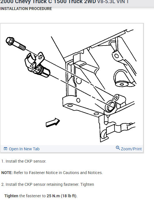

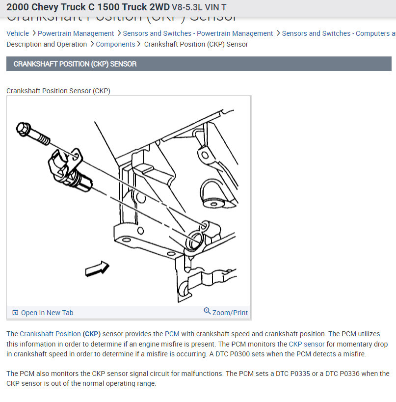

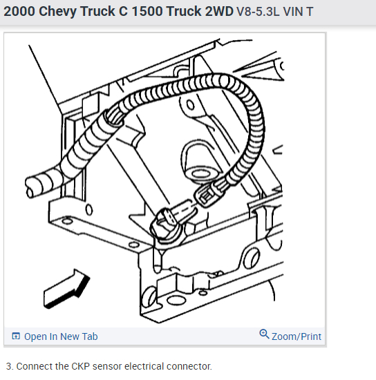

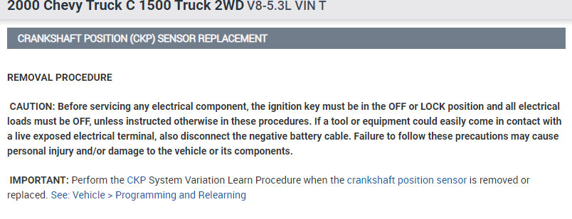

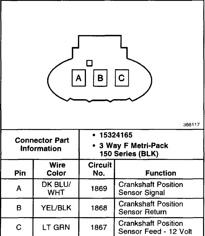

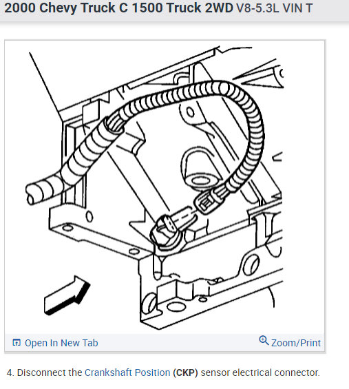

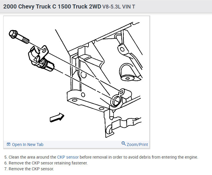

Have you checked the crankshaft position sensor?
It sounds like you could have a faulty crank sensor, as the crank sensor has a tendency to fault for temperature fluctuation.
The crank sensor is located towards the lower part of the engine.
Right next to the crankshaft pulley.
You might find these articles helpful:
https://www.2carpros.com/articles/how-a-crank-shaft-angle-sensor-works

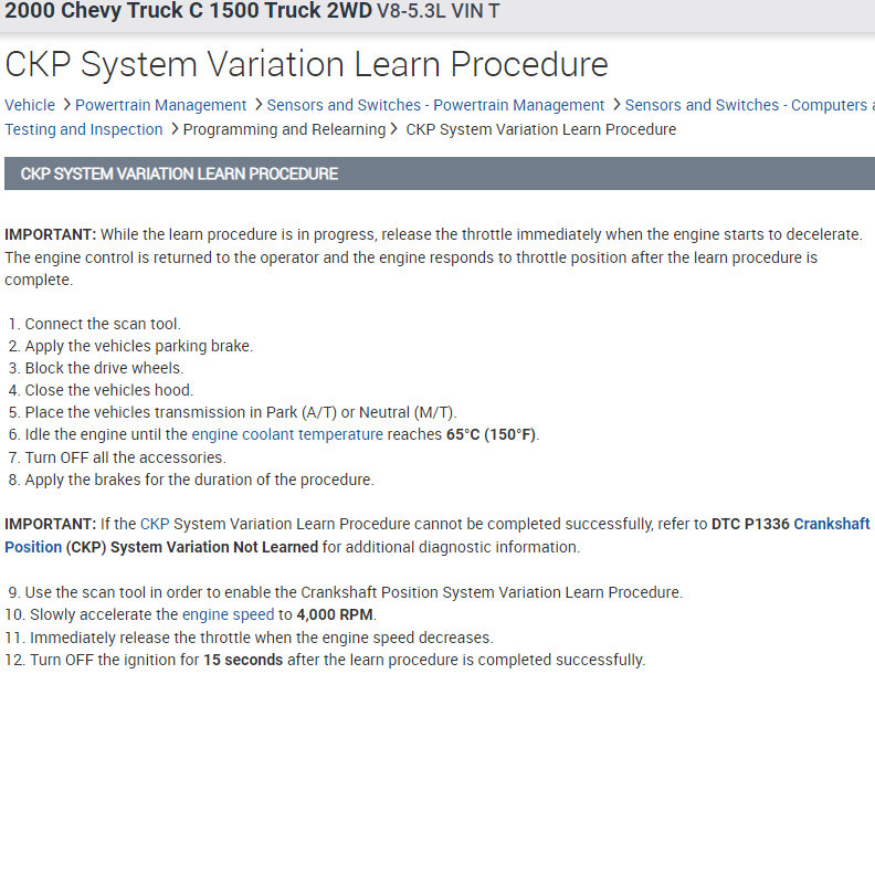

I have attached the replacement procedure for your reference.
