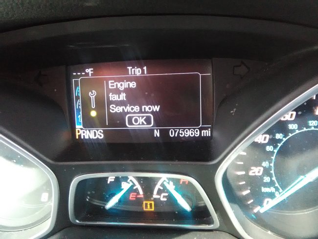

Right now I have Engine failure Service now on car and twice when I turn it on. First time it showed up twice. No codes.
Sunday, June 2nd, 2019 AT 11:47 AM
You need to get the injectors cleaned.
Sunday, June 2nd, 2019 AT 11:56 AM
CYNTHIAWA
  • 67 POSTS
I had injectors all cleaned. A bit later when I got in my car at home message came up three times and was acting rough like I pushed hard on gas in park then message actually went away. No codes when I went back up to Goodyear. They suggested dealership?
