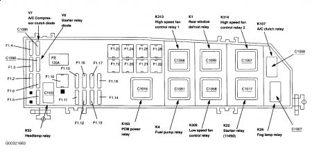

If you did replace the sensor check fuse F1.5 in the under hood fuse block.

O2 Sensor was replaced. Actually replaced both downstream sensors (four total, two per bank). Assume they are working as able to pull measured voltages off them. Not sure which fuse under the hood is F1.5. What size is it and what function would it be labeled under? Looked and none labeled as "F1.5". Pulled and checked all of the smaller fuses and all okay. Other ideas?

OK, you might want to call your local parts store and have them look it up again. The Part Number I come up with is 15718. Also here is the diagram for the fuse....
https://images.2carpros.com/forum/automotive_pictures/188069_03escapeunderhoodfuse_1.jpg

Fuse is good. You are correct that the first choice would be 15718. They did not have the first time, so went with 15719 which is same only longer wires, so it can be used on either left or right or one of the upstream. When we changed Bank 2 downstream sensor, I actually did get the 15718. But that one did not even need to be changed. We just did it because that was the side that had the misfiring cylinder (#5). But no sensor fault code on that side. Anyway, I believe the 15719 should be fine and we are still getting P0136 which is Bank 1 Sensor 2. Checked for leak, and nothing. Mechanic wants to change Cat, which we don't want to do if it is good and voltage readings indicate it is working. I may give to Ford and let them try and figure it out. By the way, I am a volunteer EMT, so I appreciate your service and help.
