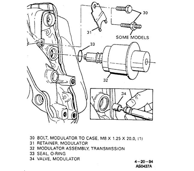

So I pulled the vacuum modulator and it was certainly bad as the piston was lose and the replacement one had a tight piston.
Although the car shifted better in accelerating, it still had the moments of 'drag' or whatever and I had to mash the accelerator to push through it.
What is the throttle valve and how can I test it or how hard is it to access?

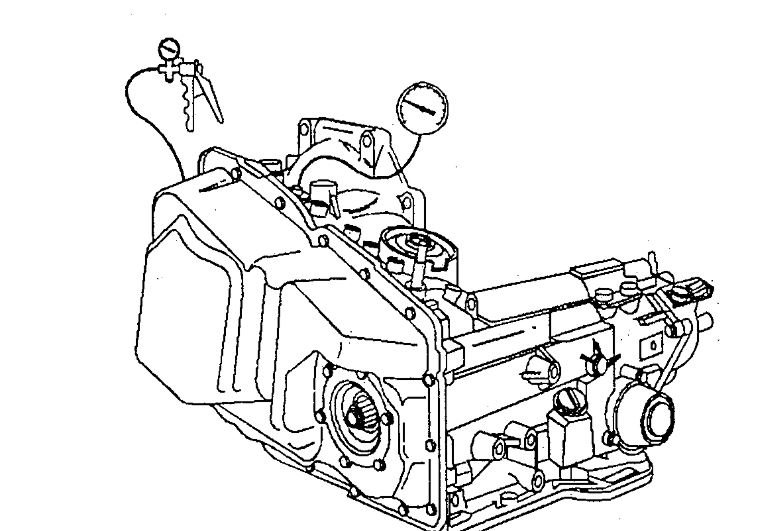

You would need a set of pressure gauges and tap into the plugs in the transmission and monitor the pressures to check the valve.
1. Check the fluid.
2. Remove the line pressure plug and install J 21867 Pressure Gage (A).
3. Disconnect the vacuum line from the transaxle modulator and connect J 23738-A Vacuum Gage/Pump (B) to the engine vacuum line.
CAUTION: Keep the brakes applied at all Ames in order to prevent unexpected vehicle motion.
NOTICE: Total test running time should not be longer than two minutes, or else transmission damage could occur.
4. Start the engine and set the parking brake.
5. Note the vacuum pump gage:
At sea level, the engine vacuum should be at least 61 kPa (18 in Hg).
Engine vacuum will drop about 3.5 kPa (1 in Hg) for every increase in altitude of 305 m (1000 ft).
If the engine vacuum is low, refer to Powertrain for diagnosis.
6. Disconnect J 23738-A vacuum gage/pump (B) from the engine vacuum line. Connect J 23738-A vacuum gage/pump (B) to the transaxle modulator. Install a plug in the engine vacuum line to prevent a vacuum leak.
7. Raise the engine speed to 1250 RPM.
8. Check the transaxle line pressure:
Minimum Line Pressure-provide 61 kPa (18 in Hg) of vacuum to the modulator with J 23738-A gage/pump (B).
Full Line Pressure-provide 0 kPa (0 in Hg) of vacuum to the modulator with J 23738-A gage/pump (B).
Note the pressure readings in all gear ranges for both Minimum and Full Line Pressure. Compare these readings with the information in the Line Pressure.
9. Refer to the HIGH OR LOW OIL PRESSURE CONDITION DIAGNOSIS chart in order to diagnose the line pressure readings that are too low or too high. See: Automatic Transmission/Transaxle > Symptom Related Diagnostic Procedures
10. Reconnect the engine vacuum line to the transaxle modulator. Remove J 21867 pressure gage (A) with the engine off. Install the line pressure plug.

It was behind the modulator you removed. I posted a picture way back.
It would be cheaper to have someone check it for you.

The valve would be a couple of bucks, if it was the issue.
I would be more concerned about the bore in the valve body that it rides in. If it is worn or not clean, the valve will not move freely.
