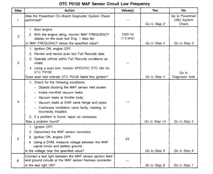

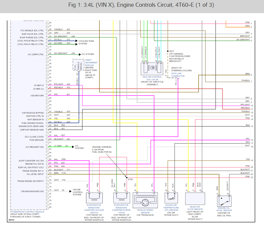

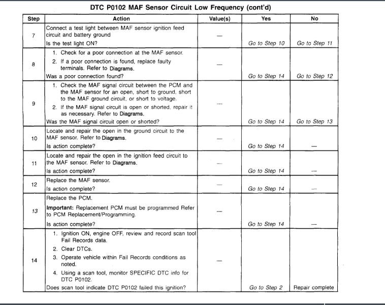

Good afternoon,
I attached a flow chart for you to follow.
Follow the steps and let me know what you find.
Circuit Description
The Mass Air Flow (MAF) sensor measures the amount of air which passes through it into the engine during a given time. The PCM uses the mass air flow information to monitor engine operating conditions for fuel delivery calculations. A large quantity of air entering the engine indicates an acceleration or high load situation, while a small quantity of air indicates deceleration or idle.
The MAF sensor produces a frequency signal which can be monitored using a scan tool. The frequency will vary within a range of around 2000 Hertz at idle to near 10,000 Hertz at maximum engine load. DTC P0102 will be set if the signal from the MAF sensor is below the possible range of a normally operating MAF sensor.

2. This step verifies that the problem is present at idle.
5. A voltage reading of less than 4 or over 6 volts at the MAF sensor signal circuit indicates a fault in the wiring or a poor connection.
6. Verifies that ignition feed voltage and a good ground are available at the MAF sensor.
13. This vehicle is equipped with a PCM which utilizes an Electrically Erasable Programmable Read Only Memory (EEPROM). When the PCM is being replaced, the new PCM must be programmed. Refer to PCM Replacement and Programming Procedures.

Did you follow the flow chart and what were your results?

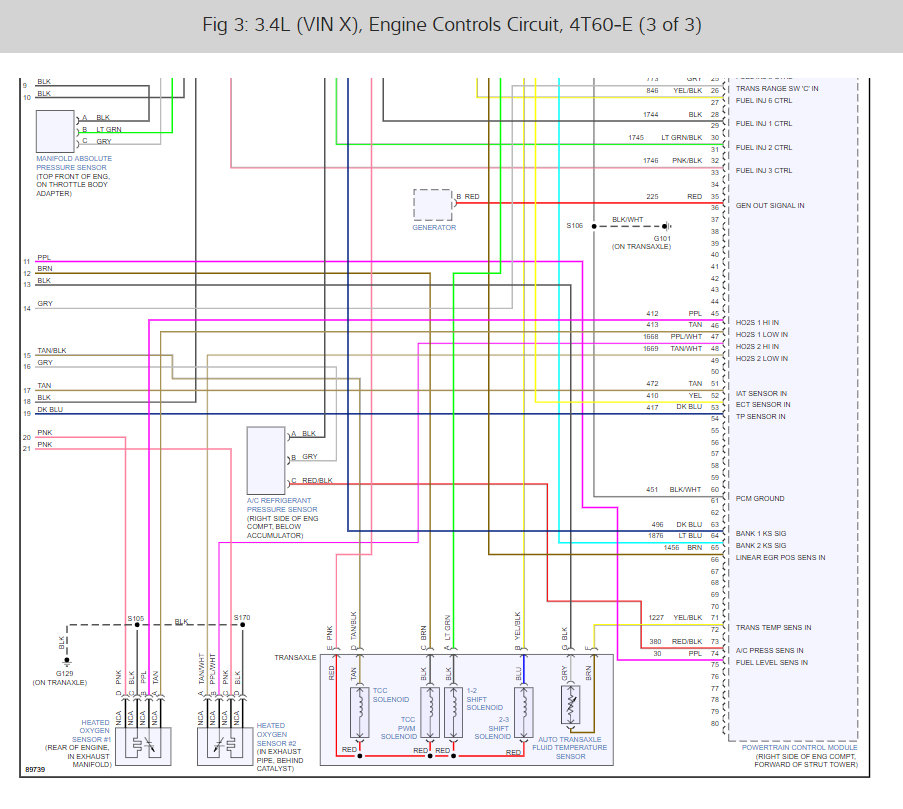

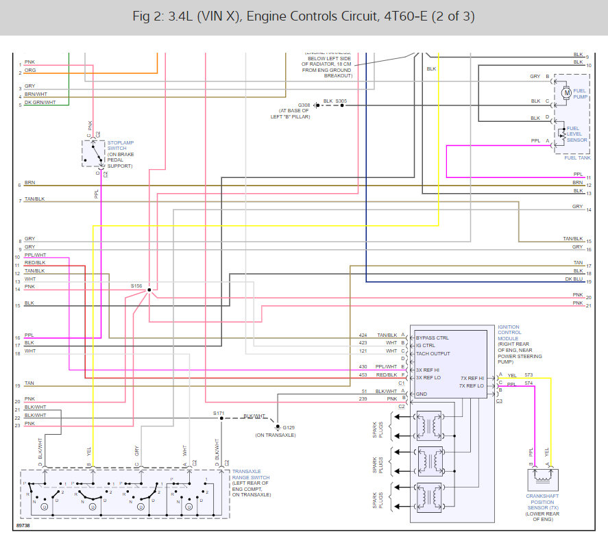

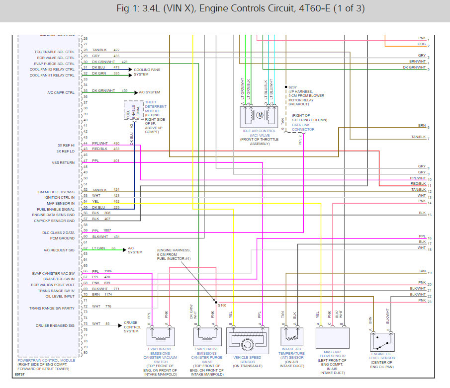

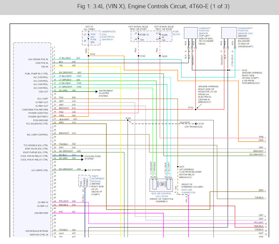

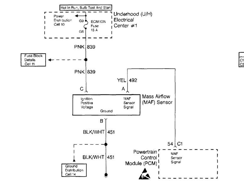

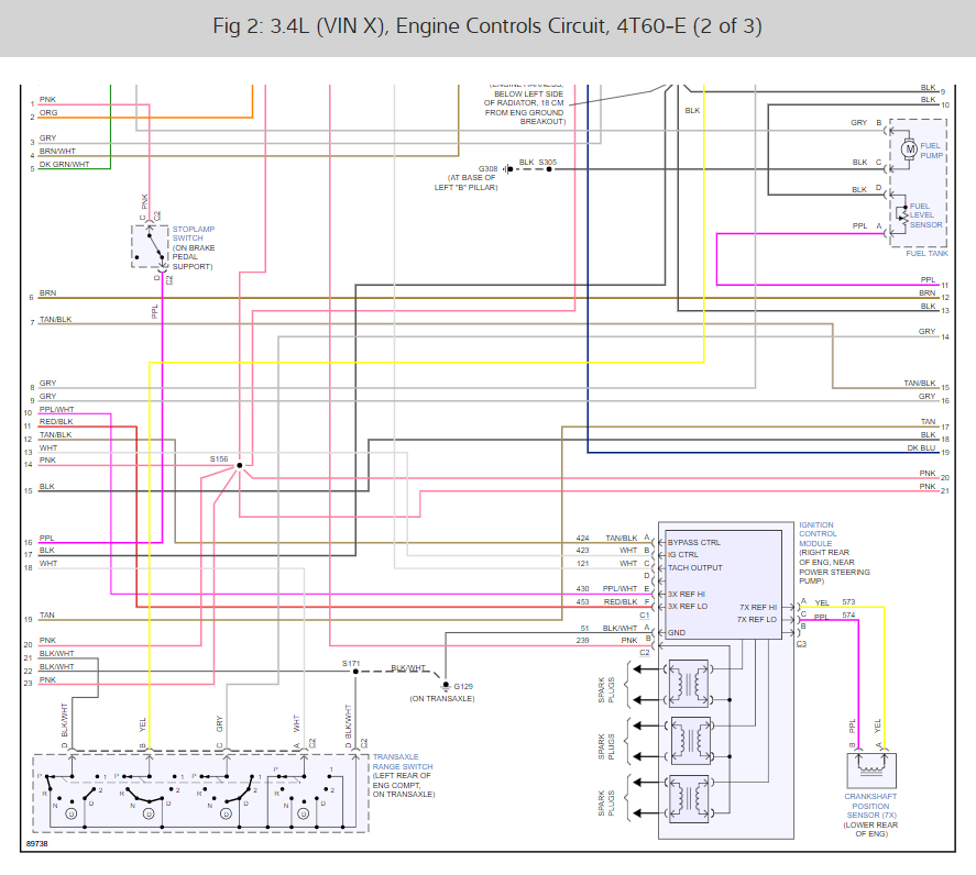

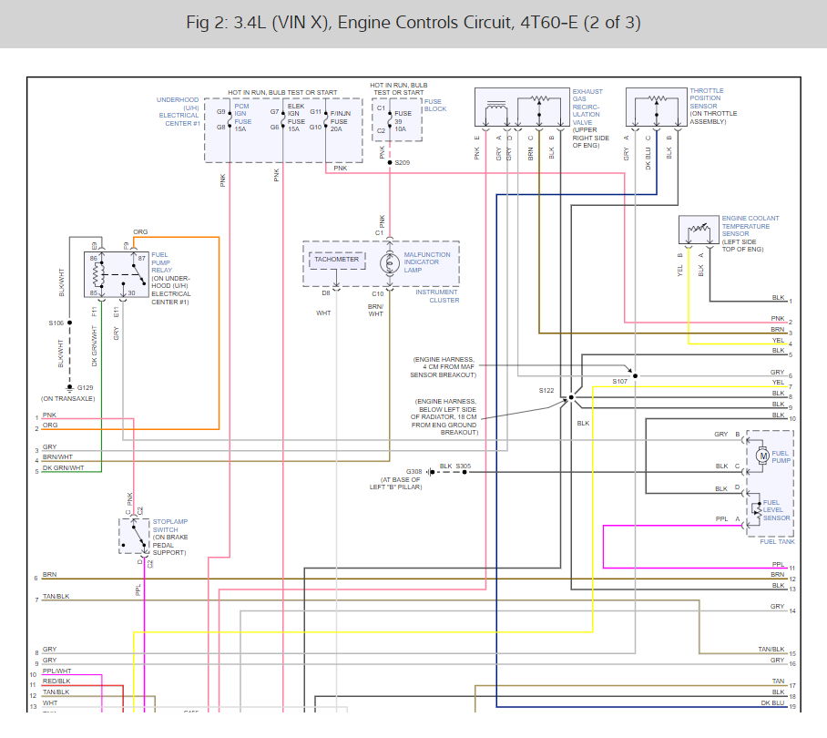

Lets check the connection between the PCM and MAF. here is a guide and the wiring diagrams so you can see how the system works and which wires to check:
Mar 12, 2020 at 10:33 AM
CLANOFWOLVES
  • 33 POSTS
Thanks for the advice!
I did ohm out the yellow signal wire from the MAF harness to the PCM harness pin and I got no tone and about 1.87 on the resistance. I then ran a same gauge yellow wire along the existing plastic conduit (wire bundle cover) and skinned back the existing wire just short of each harness and wrapped the new wire for good contact. I then checked the connector to connector and had tone and something like .002. I then put everything back together and drove it.
She went up hills fine but there was a slight hesitation here and there, so I plugged in my Foxwell and saw the MAF (g/s) stayed steady at 1.95 no matter my acceleration. I then thought the old wire still in the circuit might be the issue, or the original MAF sensor that I put back on was bad (I thought not as the new MAF sensor threw the same readings, but it could have been the wire). So I returned home to cut out the old wire and see how she ran back to the auto parts store to get a new MAF.
I cut the old yellow sensor wire free at both ends and wrapped the ends good. Got it to start her and she wouldn't start.
She just spun the starter.
Foxwell was connected and stated there was no error code.
So I checked a few of the fuses, they were good. I'll need to start at fuel pressure, and so one to find out what happened between leaving the old sensor wire and taking it out.
Am I missing something simple???
Frustration sets in. I need a breather for an hour or so before I get back into it.
Thanks guys!

How did you check the resistance?
What tool were you using?
Mar 12, 2020 at 4:26 PM
CLANOFWOLVES
  • 33 POSTS
I use my BKPrecision Test Bench 388-HD.
I checked the wire/solder and it all shows connectivity, and I checked the other pins around the MAF sensor input wire at the lower large PCM plug in case my manipulation of the wires to get to the yellow MAF sensor wire caused any damage.
Another thought: although I always disconnected the battery hot before working with the PCM or other wiring (like soldering in a new sensor wire), I didn’t disconnect the positive side of the battery to disconnect the old sensor wire I theorized might be causing signal issues. I used insulated snips, and didn’t cut any other wires, but I’m wondering about anything that could have occurred.
Mar 12, 2020 at 6:59 PM
  • CAR REPAIR CONTRIBUTOR
Just to be clear, did you run the overlay wire without disconnecting the original wire?
Mar 13, 2020 at 2:56 AM
CLANOFWOLVES
  • 33 POSTS
Yes. Then, when it was better, but seemed a little hesitant, I theorized the original wire’s still attached and attempting to carry signal, so removing it from the carrying material might clean up the signal so the info is clearer for the PCM. Or so I thought.
I can’t help but think it’s something that got altered during the getting to and putting back of everything else.

I agree. Are you sure you cut the correct wire? Did you verify the wire from one end to the other?
Mar 13, 2020 at 4:29 AM
CLANOFWOLVES
  • 33 POSTS
I checked fuel pressure at the rail last night and it’s good. I’ll check MAF power and signal at the MAF and at the PCM connector this AM.
All the fuses, connectors, pins and wires at all of my work points checked out visually. I did see in the wiring diagram that the anti-theft and ignition wires were right next to the MAF signal wire, and they weren’t damaged, and when the wires were moved, the female pin connectors inside the harness moved, so they look fine.
I’ll just recheck everything again. Then check for spark.

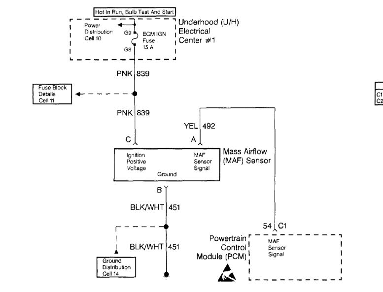

So I went out and checked: the wiring vs. the diagram again, 2) my wire connections and solder ability, 3) insuring there were no shorts or anything, and 4) disconnected the MAF sensor.
I then tried to crank it and she started up (relief) but she was a bit rough. What I did to "fix" the issue from the night before I have absolutely no idea. I then reconnected the MAF as it was running and it kept running and actually smoothed out a bit. However, my Foxwell still gave me the MAF code " PO102, Mass of Volume Air Flow A, Circuit Low."
I'm going to get a replacement MAF sensor and put it in and see how she runs and if the code comes back.

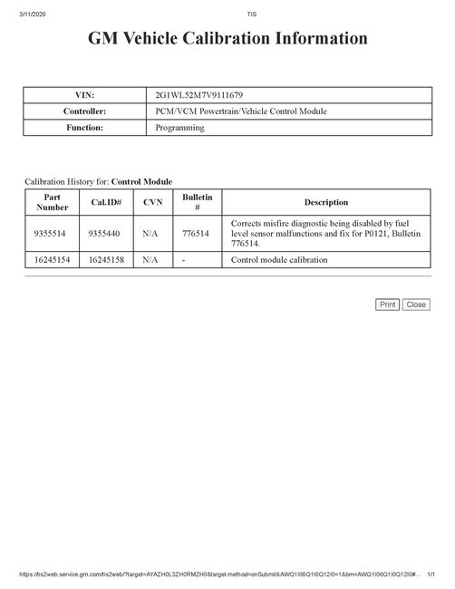

Should I try "flashing" the PCM/VCM to factory original with just the two calibration history's included or is it something else?
Closer, ever so much closer.
Again, thanks!
Mar 13, 2020 at 8:54 AM
Start with flashing with the most current update.

I'm tracking down an older XP laptop as the free GM program requires XP Sp3 to run and we don't have one anymore. I'm not sure an emulator would work well as it will have issues connecting to the ports (I have read).
I'll let you know when I have it (hopefully today) and do the "flash."

It seems the PCM has the most updated software, and I cannot flash it without a Tech 2 scanner (which I don't have), but all I can do is check its values, and if I want, I could modify them like a fool, if I wish. Not gonna do it.
I drove her again and found these three details quite illuminating:
1) In order to start it, you must push the pedal (open the air valve), or it will simply spin the starter/engine; which I don't think is how this car is supposed to start, ie. it should be simply to turn the key. Correct? Why do you guys think this little detail occurring?
2) But once it starts, it idles well and drives with all the power one would expect.
3) The "service engine soon" light is on and my Foxwell tells me the same old code, "PO102, Mass of Volume Air Flow A, Circuit Low" even if I erase it, and then drive it again. This is a new sensor wire as well as a new MAF. As an aside, something keeps telling me the original MAF is still good.
As an aside, I had a friend tell me to disconnect the battery for a while, then reconnect it as this would allow the flash memory to be erased and the code might go away. Ever heard of that?
Mar 16, 2020 at 3:17 PM
Forget about disconnecting the battery. That does nothing.
I think you have a bad PCM. Just because it has the most recent program does not mean it is working correctly.

Finished (though I had to go to a shop with a Tech 2 and basically rent it with the mechanic).
Everything is factory spec, and it idles and revs without issue. No trouble codes. Everything is within spec. when we looked over all the info in his Tech 2 readings.
When driving (though markedly better and gets up to highway speed great), still it seems the engine, as it is accelerating: feels that it either adjusts the fuel/spark a bit, or the transmission shifts prematurely into a higher gear or something (that's the only way I can describe it). It's weird to feel the car do something without driver input. Whatever it is is keeps the car from continuing its acceleration for a few seconds. If I give it throttle during the event, it downshifts and accelerates great through the issue. If I don't alter the accelerator, and keep it steady during the event, it waits a few seconds and then shifts to overdrive and feels normal.
Since I changed the fluid and filter when I first was alerted of the issue by my daughter during my maintenance work, and the old fluid was discolored (aged) and there was no metal dust or filings on the magnet, I'm wondering if I just need to allow her to drive it and change the fluid again in a few days and see if it flushes more of the old fluid that was trapped inside the torque converter?
