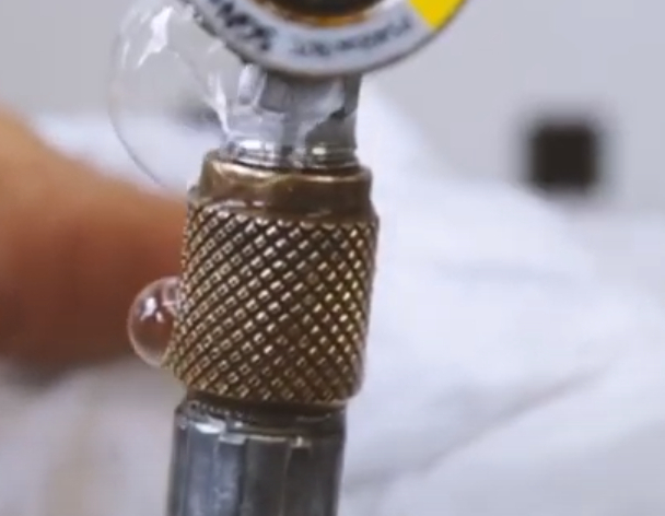

AL514
  • 5,556 POSTS
Well, if you want it to last another 10 years, the best thing to do is have a shop evacuate the system with an A/C machine. This way they can measure how much is taken out. If it's low on the amount that should be in there, then there is a leak somewhere and it should be found and repaired. That way the new refill will last, and you won't have to refill it every year. Because there's no way of telling when the leak actually started, so if it's a fill valve for example that section of line with the valve can be replaced. The fill valves are almost exactly the same as a valve stem on a tire. The one-way valve has those small seals on them that leak. If you have the vehicle off, and you put your ear real close to the valve while taking the cap off, you can almost always hear a small hiss of a leak. These leaks are overlooked most of the time because when the A/C machine is on both fill valves (High side and Low side), the leak is not detected. You can also spray each fitting of the A/C lines with soapy water in a spray bottle, and the leak will bubble up. Dish soap works the best.
If the system is still running semi cold and the compressor is still cycling, you can find a leak with soapy water.
Most leaking areas are any connections, the front AC condenser in front with the radiator (they leak a lot at the soldered bent connections), fill valves, compressor seals.
You can find the leak, do the repair and then have a shop vacuum it down and refill it. Or you can just add a can and see how long it lasts. So there's a couple options here. I'll bet you can find a leak pretty quick. If you do, take a video of it for us. Here's a soapy A/C leak picture. Sorry for the long post.
Sunday, July 9th, 2023 AT 8:59 PM

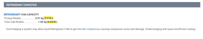

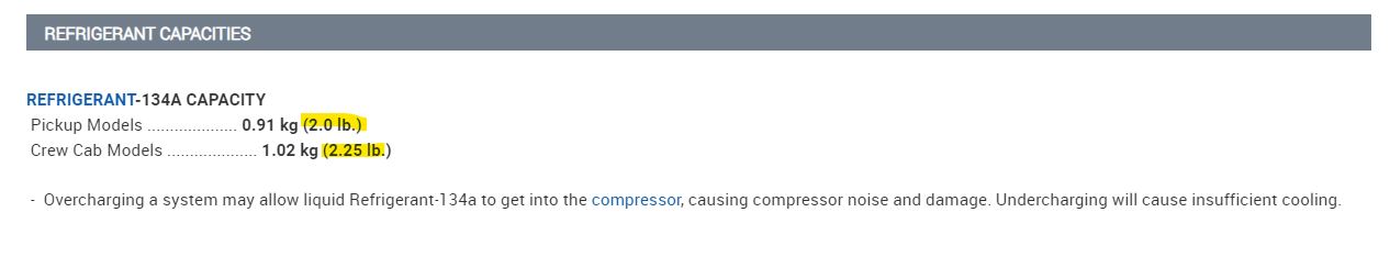

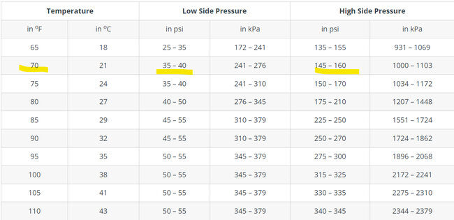

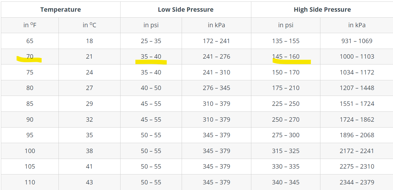

AL514
  • 5,556 POSTS
The specs for your vehicle is quite a lot of refrigerant. 2.0lbs or 2.25lbs. With 16 ounces in 1 pound, that's 32 ounces to fill the system for a pickup model. So, you can buy one of the 13 ounce cans and just add it slowly, the guide has you raise the rpm while filling it a little at a time, until it gets cold enough for you. I bought a 13oz can from harbor freight for $12 the other day. So, if you still have semi cool air, you shouldn't need to add more than 1 can, just go slow while adding it, give the system time to adjust and build pressure before adding more.
