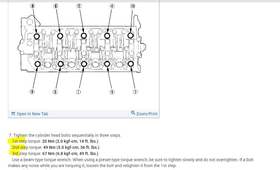

Hey, I have a question. If I changed the head gasket, do I need to get the head re-torqued after 6 months or something like that?
Monday, September 18th, 2023 AT 1:14 PM
  • 110,194 POSTS
As far as the torque goes, no that doesn't need to be done. As long as you follow the torque sequence and tighten the head bolts in the three-step process, it will be fine. See pic below.
Monday, September 18th, 2023 AT 1:35 PM
DOMINIK1234
  • 13 POSTS
Do you think my problem could be because the bolts aren't torqued enough or I need to re torque the head?
Monday, September 18th, 2023 AT 2:24 PM
  • 110,194 POSTS
If you did torque the cylinder head bolts to the proper specifications, no, I don't think that needs to be done. Plus, if there was an issue related to the head gasket, there would be other symptoms.
If you have a chance, take a look at the link above that explains how to determine a head gasket issue.
