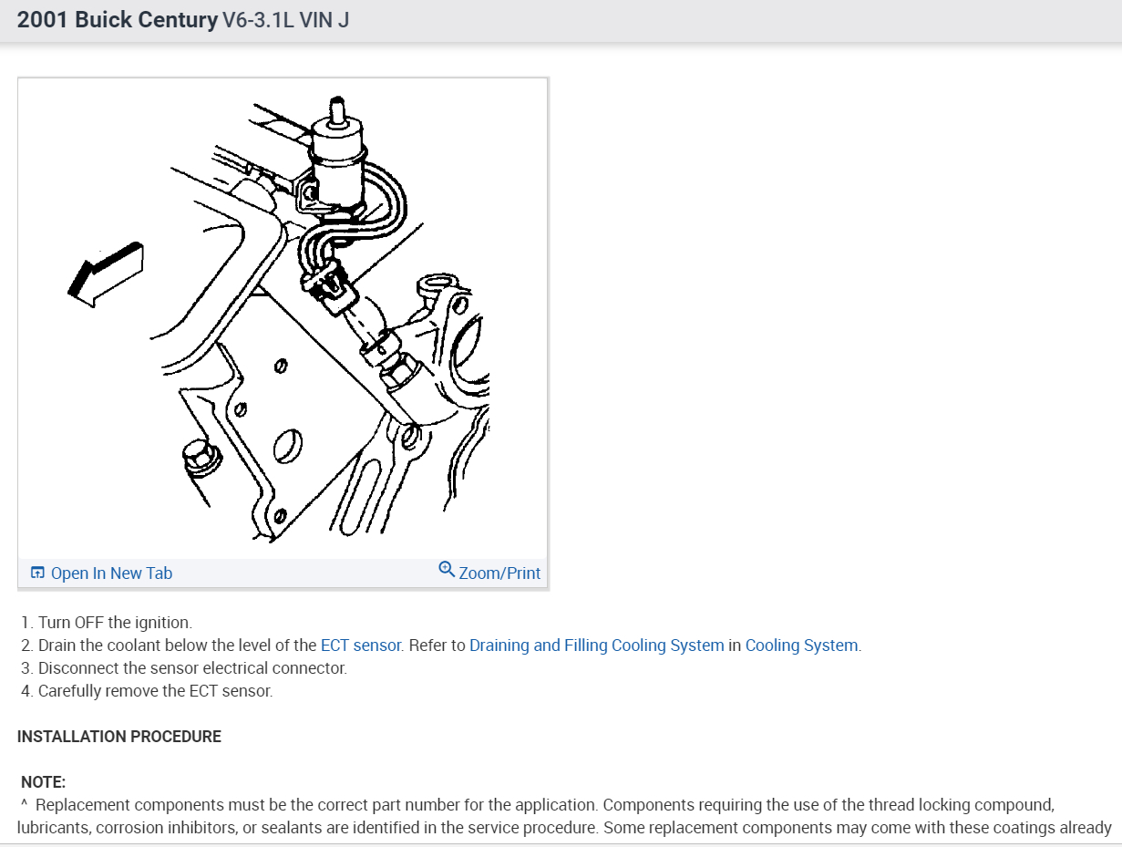

Can you hear the radiator fans come on? If so, It could be the thermostat or the engine temperature coolant sensor. Here is the location of the sensor in the images below. Please let us know what you find. We are interested to see what it is.

SEAN844
So, like I mentioned I had a friend look at it and he said it was a few different things causing it. There were a couple bad fan relay switches, a water pump that wasn't pumping any water along with a thermostat that was stuck open. He went ahead and took care of the work yesterday and now it seems to be running well not overheating and the heat is blowing hot air now.
