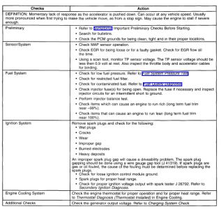

My car has had a severe problem now for a couple of years. I go to get on the gas and it hesitates, shakes, and back fires. We have changed coils, MAP sensor, spark plugs, fuel filter, oxygen sensor and nothing seems to change how the car runs! Please help!

Dirty fuel injectors (cleaning the injectors often fixes this).
Bad TPS (throttle position) sensor
Bad or dirty MAF (mass airflow) sensor
Low fuel pressure (leaky fuel pressure regulator or weak fuel pump)
Vacuum leaks (intake manifold, vacuum hoses, throttle body, EGR valve)
Bad gasoline (fuel contaminated with water or too much alcohol)
Has the check engine light ever come on during this problem? If so scanning it for codes could help pinpoint the problem instead of just throwing parts at it.
See the article below on code gathering
And this one on Hesitation- it may give you some more insight
https://www.2carpros.com/articles/engine-hesitates
Let us know what you find
