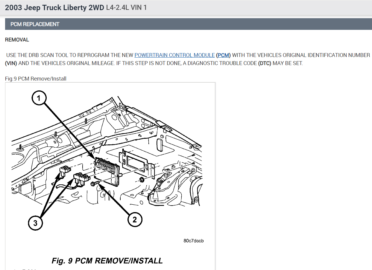

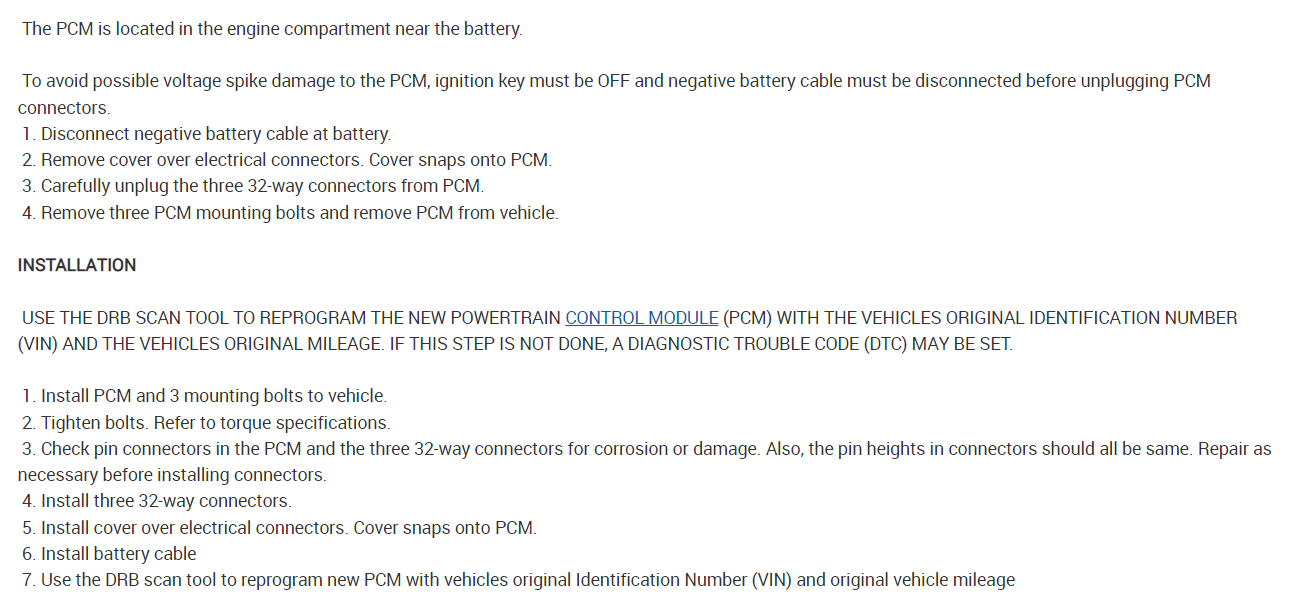

Sure, here is a line of them in the search, just pick one that has good reviews.
https://www.google.com/search?q=2003+jeep+liberty+pcm&oq=2003+JEEP+LIBERTY+pcm&gs_lcrp=EgZjaHJvbWUqBwgAEAAYgAQyBwgAEAAYgAQyBwgBEAAYgAQyBwgCEAAYgAQyBwgDEAAYgAQyCAgEEAAYFhgeMggIBRAAGBYYHjINCAYQABiGAxiABBiKBdIBCDE5ODFqMGo3qAIAsAIA&sourceid=chrome&ie=UTF-8
Here is the location and how to change the PCM out. Check out the images (below). Please let us know what happens.

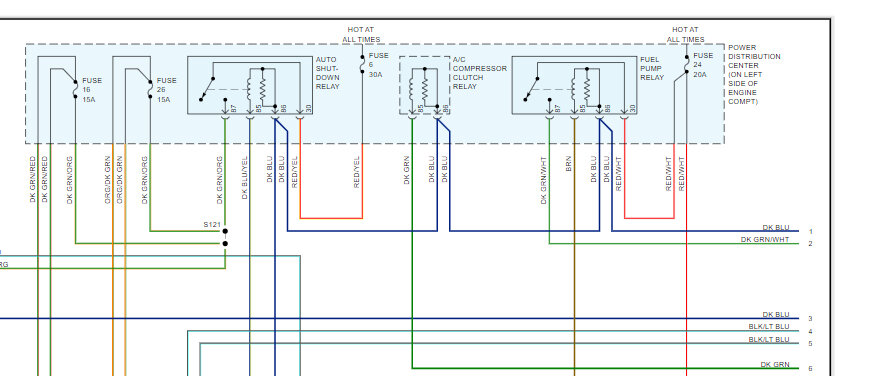

Let's check the main power to the PCM. Here is what powers the PCM so you can check it out, I would try swapping out ASD relay as well. Check out the images (below). Let us know how it goes.
Thursday, January 4th, 2024 AT 7:48 AM

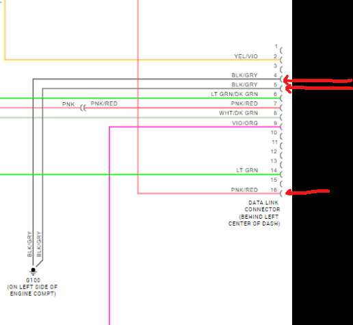

Do you have power to the pink and red wire on the OBD2 connector?

Ken, I bought another OBD II Diagnostic tool (more expensive) and it doesn’t work on my jeep also. I checked it on another car 2010 Honda Accord and it worked fine. I had checked the pins in the past and they seem to be in good condition. I recall mentioning that I had taken the pins out and fixed them so they would not be lost. I can't seem to find the OBD II results I sent you. I'm going to keep looking.

I checked the OBD2 pins 4, 5, and 16. 4 and 5 are ground and 16 is power 12V. I got a reading of 4.21 from pin 16+ and I check it with pin 4, 5-. So, what does that mean? I have a little bit of power coming to pin 16. I also took the 2 screws out that hold the OBD2 and checked the wires in the back of it. I didn't see any broken wires there. In fact, they look new.

It seems like the port has power and ground this just leaves the PCM that is not reporting to the scanner. I would try removing the PCM and send it in for testing, you can find a place that does this by searching google or Ebay.

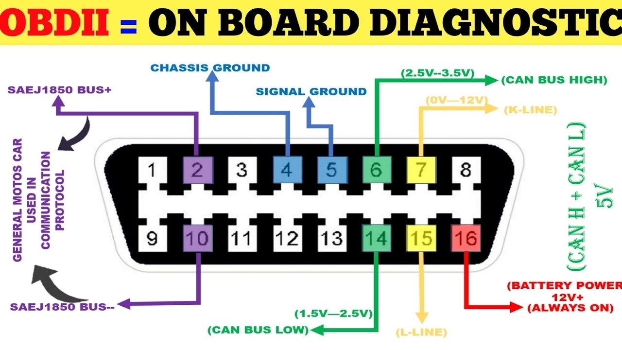

Okay, do you have power and ground at the data port connector?
This guide can help:
