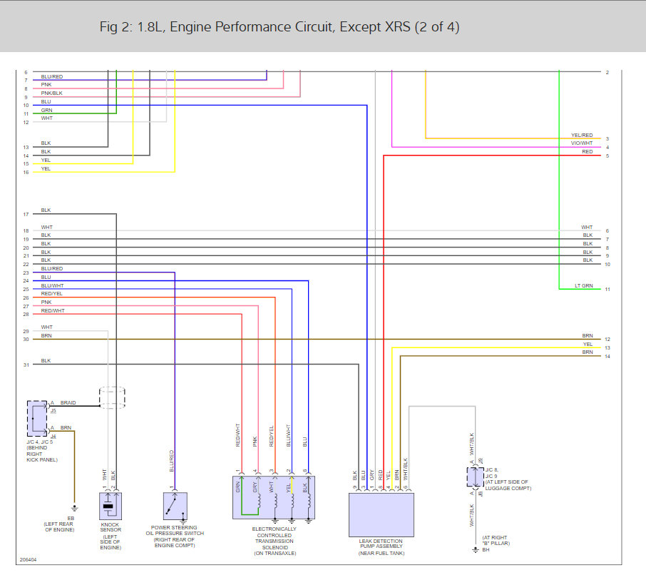

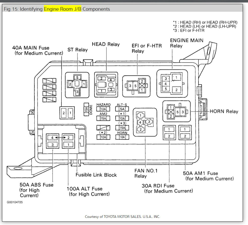

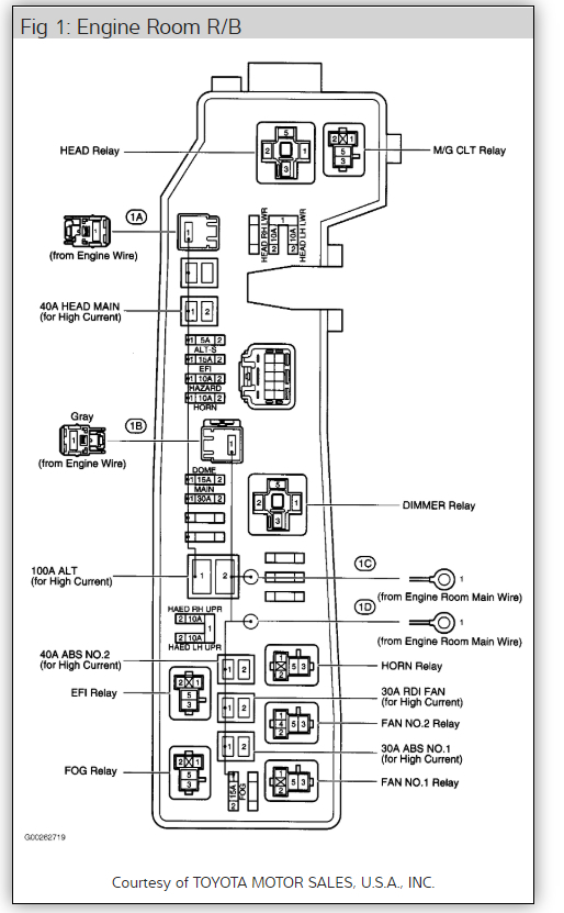

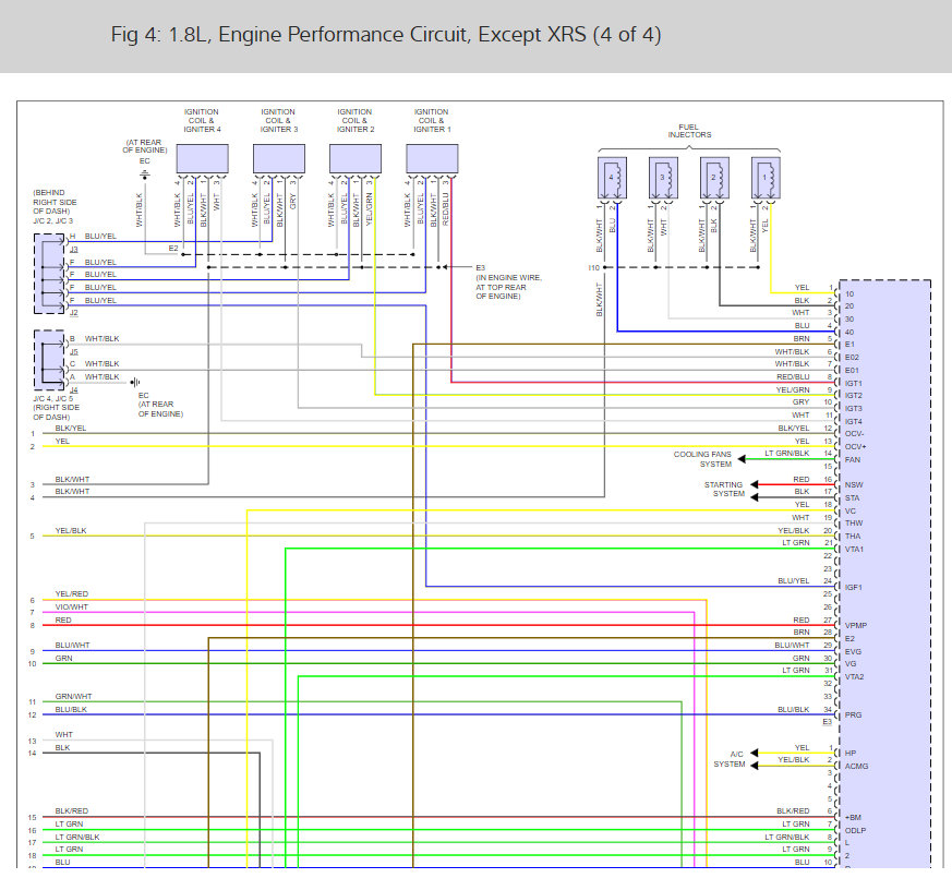

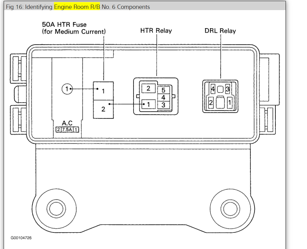

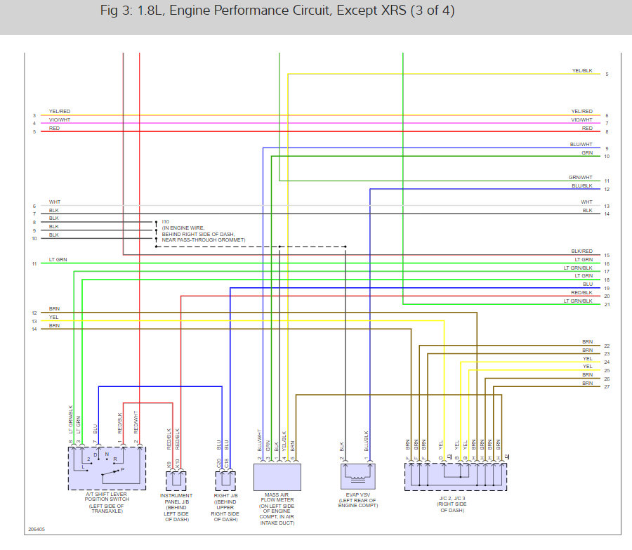

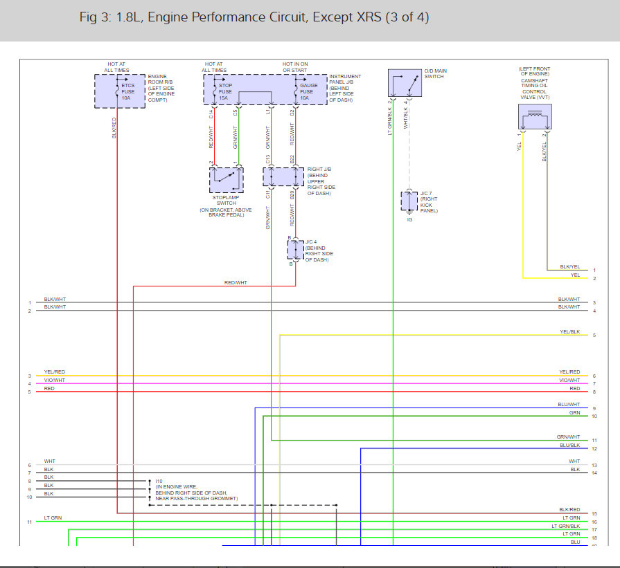

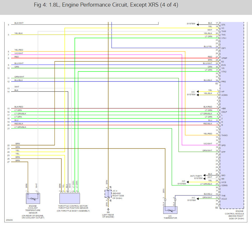

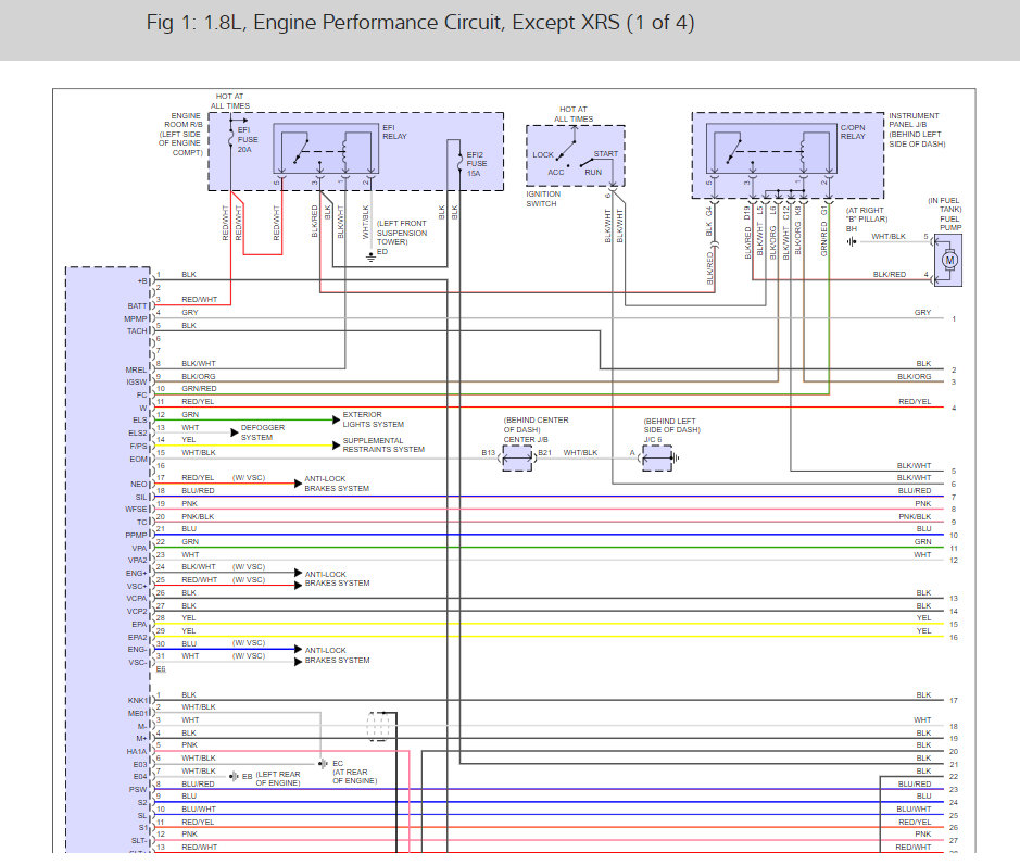

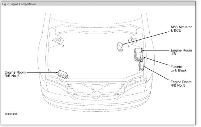

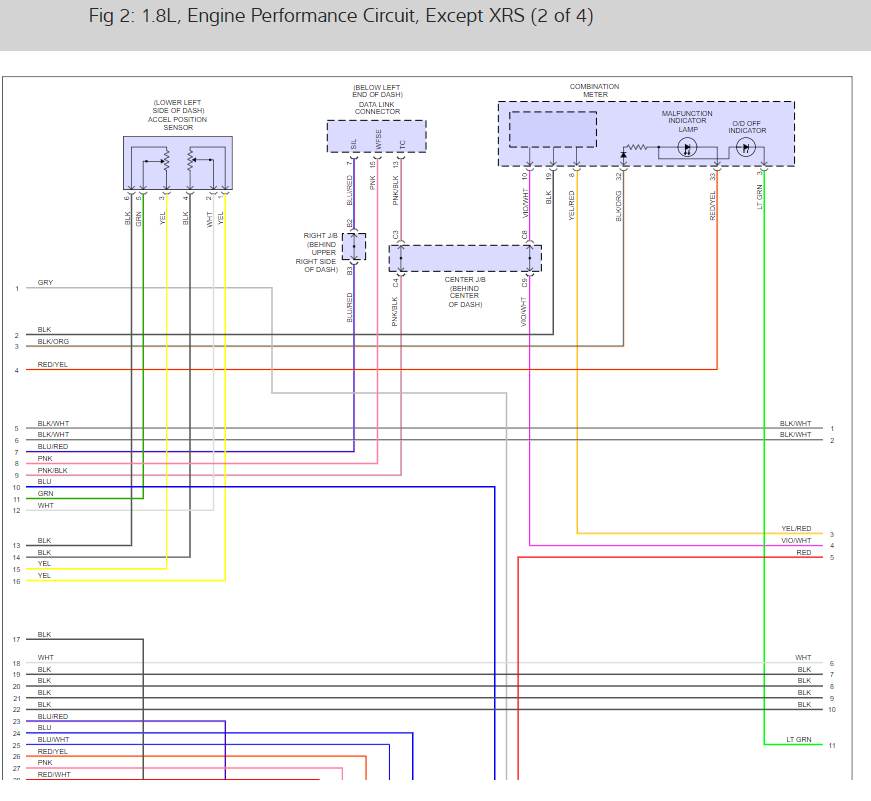

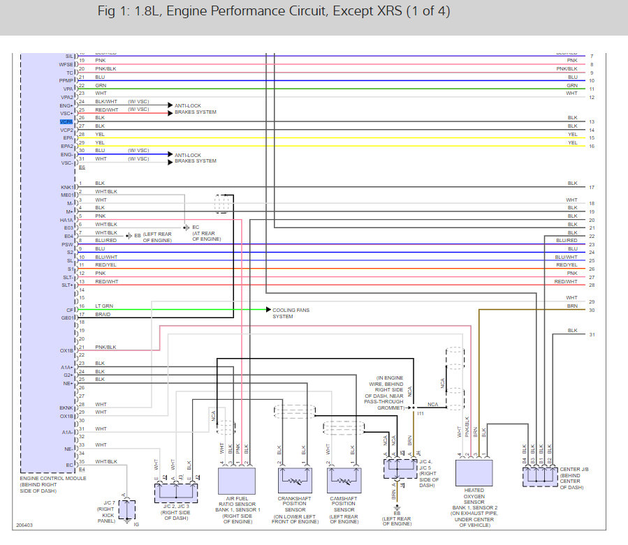

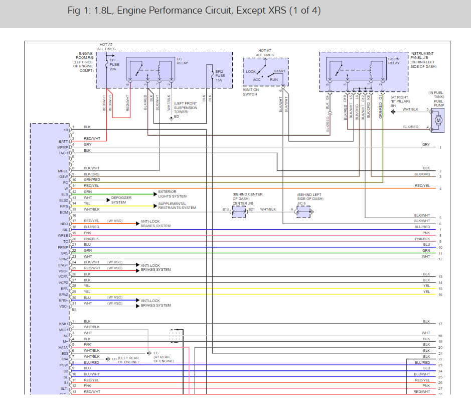

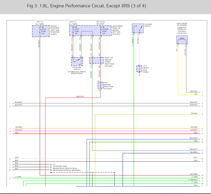

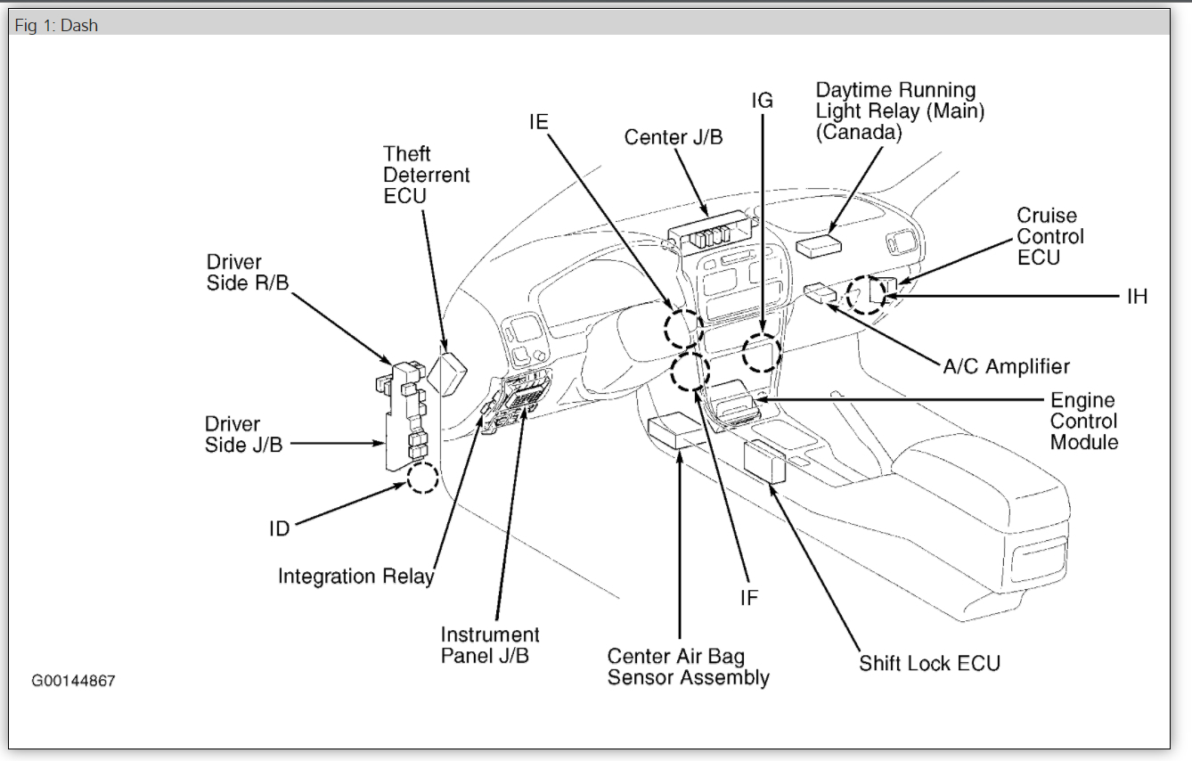

The last ECU sounds like it should work. Can you hear the fuel pump running in the tank and the security light is not flashing? Because the scanner will not communicate makes me think the EFI relay is not working here is a guide to show you how to test it and the engine wiring diagrams so you can see how the system works with the relay location as well.
Check out the diagrams (Below). Please let us know what you find. We are interested to see what it is.

Thank you for the information. The fuel pump is under the back seat and I can't hear it running. I can if I wire it directly but the car still isn't starting, I will certainly check the EFI relay. Thanks so, so much. I will let you know how it turns out. One more thing my first question due to trying to be thorough was probably difficult. About programming the vin in the new computer? Oh and the immobilizer system does seem to recognize the key because the light stops flashing when I insert key.

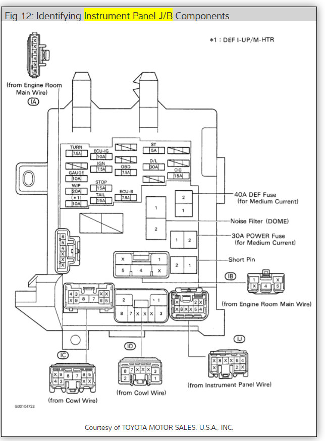

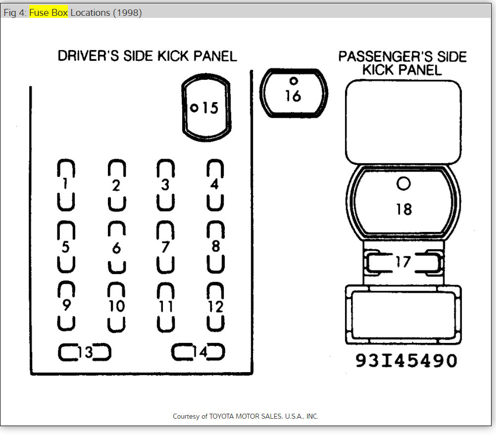

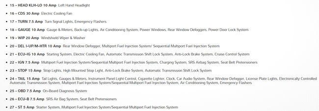

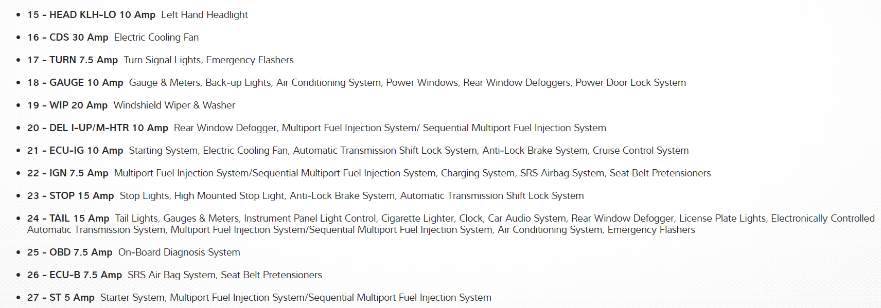

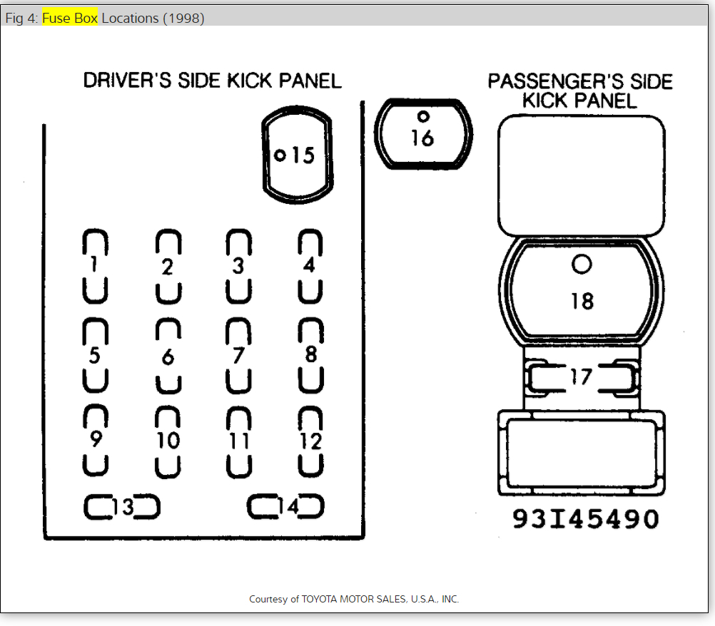

  • 110,192 POSTS

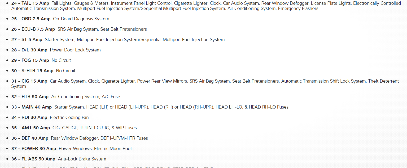

That honestly doesn't make sense. Pin 16 should be hot all the time. If it only gets power when cranking, I have to ask where you are getting ground. If you are using the signal ground, then we have a problem with the chassis ground. If you are using a known good ground location on the vehicle, then we have a problem in the fuse box. If you look at the pic I attached above, you will see an OBD fuse. That should always provide power. Do me a favor, check the fuse and confirm there is power in and out at all times.
Friday, June 25th, 2021 AT 5:11 PM (Merged)

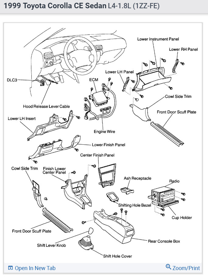

KEN L
  • MASTER CERTIFIED MECHANIC
  • 55,266 POSTS

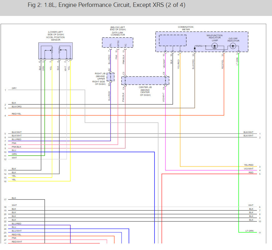

It sounds like the computer is shorted out. Lets try a used/rebuilt unit to see if that helps. Here is the location. Also make sure all fuses are good. Check out the diagrams (below). Please let us know what happens.
