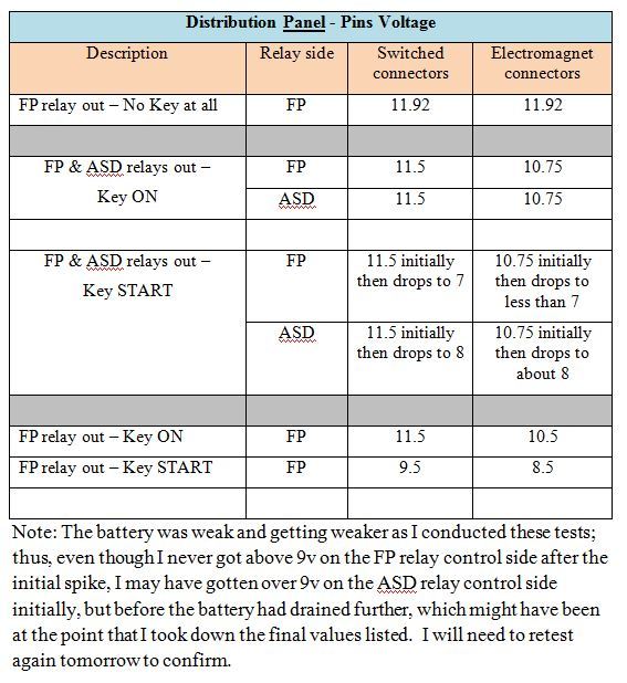

Thank you Caradiodoc for responding. First off, I have done so many tests that I may need to redo some of them again and this time write the test and results down simply because I cannot always remember all of them and their combinations or what were the exact results and/or values! Having said that, I'll clarify a couple of the results which you brought up.
First, I have not gotten the replacement pump in the tank to make any noise or to build up any type of pressure, even when attaching a motorcycle battery (w about 10.25v on it) directly to the connector on the harness leading to the tank (next to it). This was also true when the pump received voltage from the van battery after I jumped the FP relay (see below), which is why I think the pump has failed. Thus, the "burst" I was referring to was one of voltage, not pressure, and then that was at the connector next to the tank (sorry if I was not clear). That burst was a momentary one - more of a split-second +/- 12v spike right when the key is in the ON position (if my memory serves me), but nothing when the engine is being cranked. Because of this, I have not dropped the tank again and installed the new Bosch pump. Note that I'm primarily checking for voltage to the dark green wire (pump); however, the dark blue wire (sending unit) does get continuous (I believe) voltage.
To verify that the issue was not the FP relay, I took it out and jumped the load side pins (30 & 87) on the PDC and I did get voltage at the connector on the harness by the tank when I cranked the engine. The caveat with that is that I do not remember the voltage or how consistent it was, nor if I also had the ASD relay out and the pins jumped when I got the voltage (Done too many combinations of tests!). However, being that, if I'm not mistaken, the load side of the relay always has power present (or at least when the engine is cranked/running) and it's the relay that switches the load connection on/off (like a house light switch), then for the purposes of the above test, whether the ASD relay was in or not might be irrelevant since I did get voltage at the pump. Where it might come in to play, I'm guessing, is if the computer recognizes the ASD relay missing (or not working) based on the control side circuit remaining open even after voltage is applied to it, and/or that control side circuit feeds something else downstream of the relay - something which is needed to start the engine. But, then again, if either of the latter two were indeed factors, wouldn't it make sense that the van would then NOT start even when I by-pass the fuel pump by injecting gas directly into the rail!
You touched on the crankshaft and camshaft sensors. Initially, I thought that if one or both were not working that the computer would not send power to the coil for a spark. However, is it possible that all the computer needs to turn on the coil is a quick "confirmation" that the one or both of the ASD & FP relays (control side) work even momentarily, and, further, that once it gets that quick response it ignores the state of the control-side of the relays' circuits? That might explain why I can still start the engine without the fuel pump working. To bolster that theory, I have confirmed that momentary surge of voltage (+/- 12v) on the control side of both relays when cranking the engine, The caveat here is that the voltage only lasts for a short period, dropping almost immediately to below the 9v threshold that the relays need to switch on (see attached chart image, which shows voltages measured on both the control & load sides of both relays under various conditions). So, if the normal engine electrical design is such that both relays (or at least the FP relay, of course) should remain powered (and therefore load side switched on) once the engine is running, then the question is why the voltage on both, but particularly the FP relay, drops so significantly and below the 9v threshold.
Anyhow, I will charge the battery again tonight and perform both my tests and the ones you suggested tomorrow. Thanks and stay tuned.

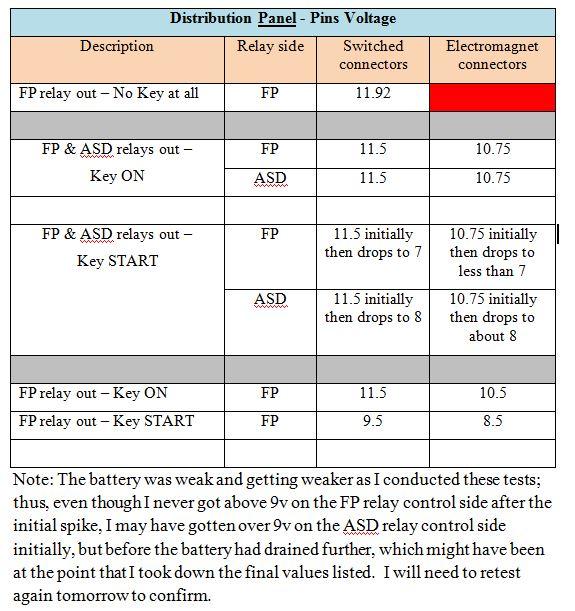

P.S. A couple of corrections: First, on the 3rd paragraph of my last response, I meant to say that I was verifying that there wasn't a broken connection in PDC or in the harness down to the fuel pump (well, at least to the connector near the tank). Second, the chart is incorrect in that I had no voltage on the control side of the FP relay pins when the key was off. Corrected chart is attached.

One thing that I think is going to give more accuracy is if you can use a test light instead of a voltmeter. When you get back to the pump connector, I never paid any attention to the voltage, just whether it was there or not. If there is a high-resistance break in that wire, all it takes is a tiny spot of corrosion or a little carbon track to conduct enough current that the voltmeter will detect the voltage, but obviously that's not enough current to run the pump. A test light needs a lot more current to operate and will not light up if there's a break in that wire.
The alternative is to measure the voltage on that wire while it's still plugged in and the pump is drawing current, but that's not easy to do unless you can fashion a piece of wire for a test point.
The pump still should have run with an external battery.
Oops. Let me back up for a minute. When you turn on the ignition switch, you already heard those relays get powered for one second. That is done to run the fuel pump in case the pressure bled off overnight. I don't know about the 3.3L, but I do know from chasing an intermittent problem on my '88 with the 3.0L, that both engines run around 50 pounds of pressure, but my 3.0L still runs fine down to 20 pounds. (Some GM engines won't start if pressure is just two pounds low).
Once you start cranking the engine, pulses arrive from the cam and crank sensors. That is how the computer knows the engine is rotating, (cranking or running), and that is when it turns on those two relays. The fuel pump relay feeds only the fuel pump. The ASD relay feeds the ignition coil, or coil pack in your case, injectors, alternator field, oxygen sensor heaters, AND the fuel pump on older vehicles without a separate fuel pump relay. This is a safety circuit and it's real effective and reliable. If the vehicle is in a crash that ruptures a fuel line, raw fuel will get pumped onto the ground, and some people seem to think that's a fire hazard. The injectors can't spray fuel with no fuel pressure in that ruptured hose, so the engine stalls. When it stalls, there's no more pulses from the two sensors so the computer turns the ASD relay, (and the fuel pump relay) off. That stops the gas from being dumped on the ground.
I don't recall the computer monitoring the coil part of those two relays. It just grounds one terminal and assumes they turned on. There IS, however, another circuit coming off the ASD relay that, along with feeding the injectors and coil pack, goes back to a terminal at the computer. If no voltage shows up there, the computer can set a fault code related to the ASD relay not turning on, or that voltage is missing, or something like that. That circuit might supply other things inside the computer but it has nothing to do with the engine not running.
On the newer engines, as a point of interest, the engine will continue to run if one of the two sensors fails, but once it is stopped, it will crank but not restart. (There is a way to trick it into starting and running), but on this one the engine will stall if either signal is missing. The fact that the engine runs proves there's spark and the injectors are firing. That proves they're getting current from the ASD relay, so we know the computer is turning it on and the two sensors are working.
That brings us back to the fuel pump. GM pumps commonly fail while you're driving, leaving you sitting in the middle of nowhere on the side of the road. Chrysler pumps rarely if ever fail once they've started to run. They typically fail to start up. There's two causes for that. Most commonly, at high mileage, the brushes in the motor wear down and don't make good contact. The clues are that often a bang on the gas tank gets them going, you don't hear the hum for that one-second burst, and if you jump the relay or squeeze its contact, you won't see the normal tiny spark when you open the circuit. That's because there's no current flow, hence, no spark when you turn it off.
The second cause, which I eluded to earlier, has to do with repeat failures, usually from a week to a month apart. Many people buy a replacement pump from an auto parts store, and it works fine for a few weeks, then fails to start up. After four or five failures, out of frustration, they buy one from the dealer and don't have any more problems. In reality, the pumps weren't the problem. Unlike GM truck fuel pumps that you can hear a mile away, Chrysler pumps are built to very close tolerances to make them really quiet. Microscopic debris collects in the tank, (I suspect mold growth from using ethanol), and that debris clogs the impeller which locks up the motor. Each replacement pump collects a little more of that debris until finally it's all gone and the next pump won't fail. That one just happens to be from the dealer. As another point of interest, NAPA buys their fuel pumps for Chrysler products from the same supplier that makes them for Chrysler, so you're getting the same pump as the dealer's pump, and they're just as quiet. That may be true of other auto parts stores too but I only know that for sure about NAPA. The clue to this problem is you WILL see a spark when you jump the fuel pump relay but it won't blow a fuse. There's obviously current flow but the motor doesn't run. The fix for this was to remove the tank and have it steam-cleaned at a radiator repair shop. I haven't heard of this happening lately, possibly due to better additives in the gas today.
Getting back to your pump, jump the relay so you don't have to turn on the ignition switch or crank the engine to do the troubleshooting. Check for voltage at the pump on the dark green / black wire. If it's missing, there's two connectors between there and the relay that are good suspects. If you DO have voltage there, check on the black ground wire. If you have any voltage on that one, there's a break in it. You may be able to get a clue from watching the fuel gauge on the dash. The sending unit shares the pump's ground wire. If the gauge reads correctly with the ignition switch on, but changes during cranking, it has to be due to voltage on the ground wire.

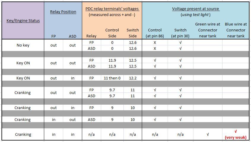

Performed some additional tests today using the voltmeter and the test light but I was not able to do any tests on the connector near the tank using the either tool simply because I did not realize I no longer have access to that side of the van since I moved it last (not having the reverse drive working complicates matters. Will try again on Thursday when I have my kids around to help me push it back!)
What I was able to do was a couple of things: First, I took the battery out and completely cleaned all the connections down to shiny metal since there was a grayish film on the surface of the connections. The second thing I did was get the DTC’s, which came up with 12 and 55 right after reconnecting the battery, which I understand represent a normal condition, and I got equal results after cranking the engine. The third thing I did was get some voltage readings again using both a voltmeter and the test light at the PDC. The battery cleaning must have really helped since I was able to get better voltage readings at the PDC relay terminal points than I had gotten last week †particularly in the low range affecting the relay control side's 9v needed to activate them. However, I want to redo a couple of them before posting them here because they don’t make sense based on my earlier tests and I need to verify I didn't miscopy (is that a word!) Something somewhere; plus I want to do the test with the test light at the connector near the pump as well.
The interesting thing in all this, however, is that after doing all those voltage readings, which involved taking the FP and ASD relays in & out and in various combinations thereof, I cranked the engine again and got a new DTC: 42... Twice! Just to be sure it wasn’t related to playing around with the relays, I disconnected the negative terminal of the battery to erase whatever codes were stored, cranked the engine once more, but got the same result: 12, 42, 42, 55. I don’t know why I got 42 twice, if it means anything, but a 42 DTC seems to be that there is a short or open circuit at the ASD relay, though I can’t confirm that since one website listed 42 having multiple meanings, including fuel pump relay circuit, no change in fuel level unit, and voltage missing when auto shutdown is energized!
Incidentally, I did test voltage at the source for each of the FP and ASD relays (pins 30 & 86) using the test light, and always got a solid light on each, but let me confirm that tomorrow.

42 - Auto shutdown (ASD) relay voltage not sensed at controller.
This is right out of the '94 service manual. The generic description from this site covers multiple years. That's why it includes the fuel pump relay with the ASD relay in the description.
If the engine runs on starting fluid, the ASD relay is working. That only leaves the wire that splices off and goes to the Engine Computer so it can verify that relay turned on. Put your test light on either smaller terminal on the back of the alternator, or the dark green / orange wire at the coil pack or any injector. You can back-probe those terminals through the rubber seals. You should see 12 volts there for one second after turning on the ignition switch, then again during engine cranking. If it's missing, try a different relay. If it's only missing during cranking, we have to look at the cam and crank sensors.
If you have voltage there, it may be not reaching the computer. That comes in on pin 57, also a dark green / orange wire. The connector is a 60-pin low-insertion plug meaning it takes no pressure to install it. You remove it by unscrewing the bolt in the middle, and you install it by just holding it in place, and running that bolt down with a small hand ratchet. Pin 57 is in the bottom row of pins, fourth one from the firewall end. You don't have to remove the plug. There's a plastic cover that can be snapped off to get to the terminals.

Hello Caradiodoc, I have some interesting news.I now have power on the green wire at the connector near the tank when cranking! I don't know why, since the only thing I have done is reset the computer by disconnecting the battery as well as cleaned its connections. I'm also not getting the 42 DTC anymore. However, the fuel pump still does not pump. I'm baffled, elated, and concerned all at once. I'm concerned bc I don't know if the fix is permanent or if there is a short somewhere that is going to prop its head sometime again and leave me stranded with a third damaged pump!
Notwithstanding the fix, I still conducted several tests (voltage readings and use of the test light) and their results are listed in the attached image. I also did the check at the injector and computer using the test light. I was able to get voltage at the injector, but not at the computer or its connector (not knowing which way the power flowed, I tested both of them). I don't know if my test light probe was too thick for the connector to get a reading, or if there is still a problem somewhere.
Incidentally, I confirmed power at the wire harness connector with the test light as well, which also showed that the blue wire had a low amperage since the light came one very dimly. I can imagine this might be by design since it's feeding only the sending unit, but I don't have a service manual to confirm. Do you think that is a problem? Furthermore, whether the low amperage is by design or not, if I somehow crossed the green and blue wires at the pump connector, if might explain why the pump does not pump. The caveat with that theory is that I again tested the pump by connecting it directly (well via the connector) to a 10.5v battery and I never heard any noises, so it's either very, very quiet, there's a break at the connector at the pump itself, or it is indeed fried.
I don't know when I will get a chance to drop the tank again to replace the pump and test the current one or replace it if need be. In the interim, besides any additional info you could provide on this on/off voltage issue, can you provide any suggestions on what could be causing the van not to shift into reverse?
