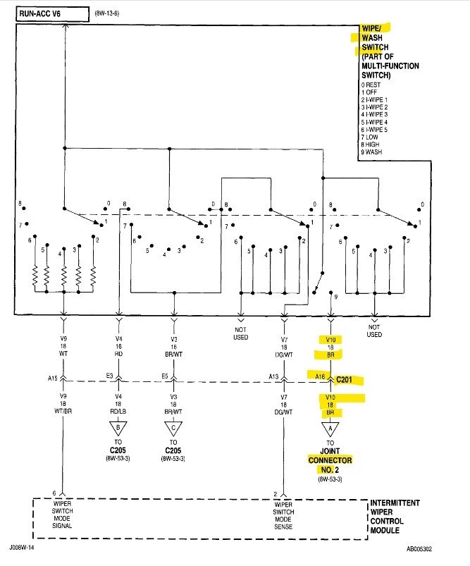

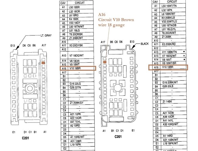

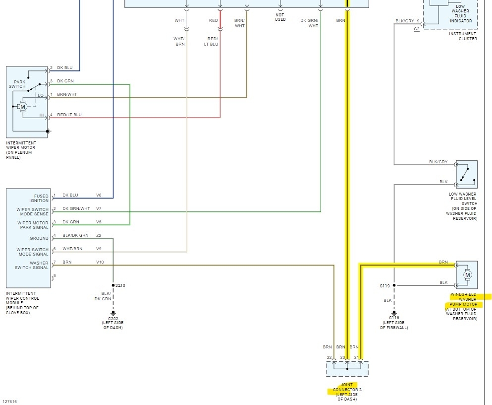

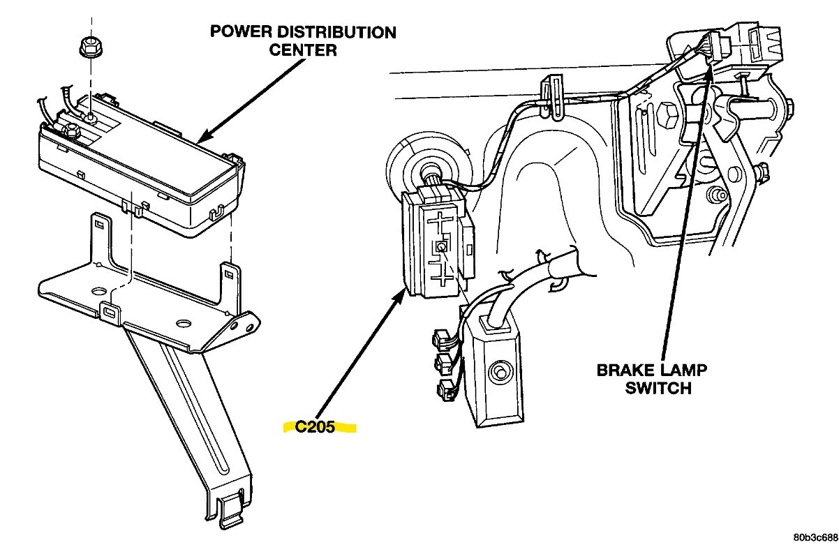

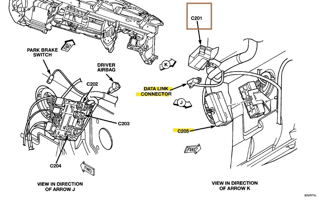

While I'm waiting for the new PCM I figured I'd replace and repair a few little things on the van. Would you have the wiring diagram for the windshield washer, the fuse is good, wipers and blinkers work, I checked for power to the washer and found none.
Monday, March 18th, 2024 AT 2:24 PM
AL514
  • 5,596 POSTS

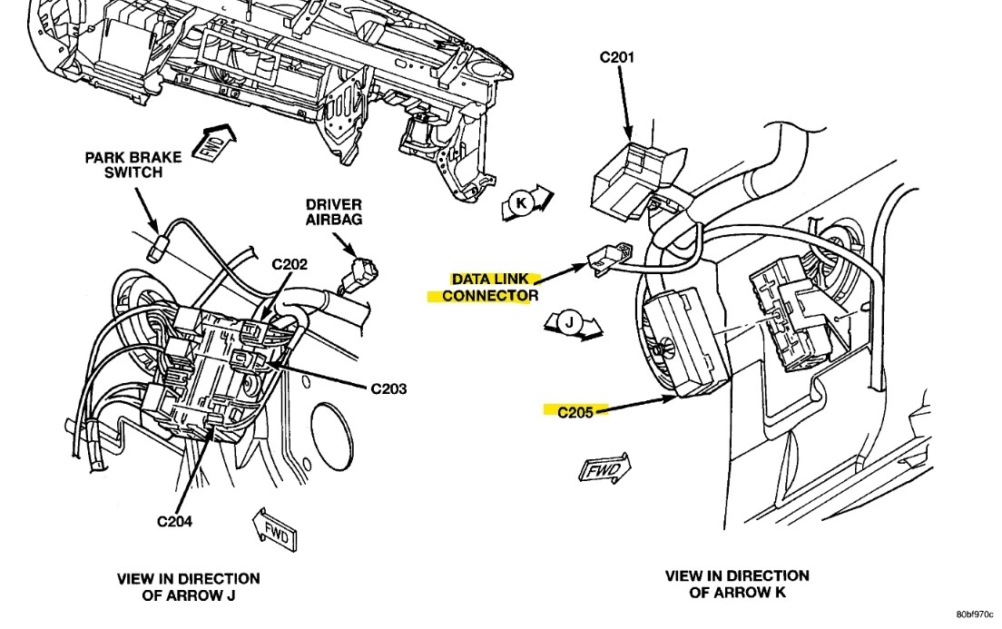

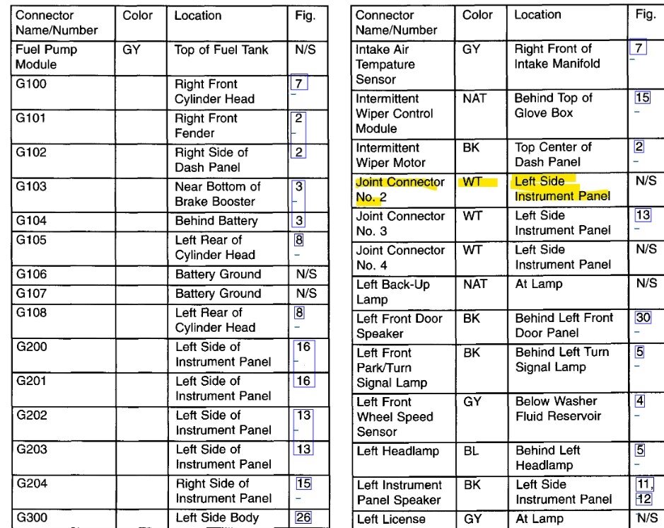

Yeah, there's this junction connector where power splits off. Left side of dash, so driver side. I'll see if I can find its location.
+1
Monday, March 18th, 2024 AT 2:41 PM
AL514
  • 5,596 POSTS

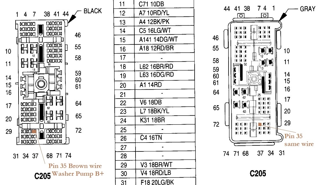

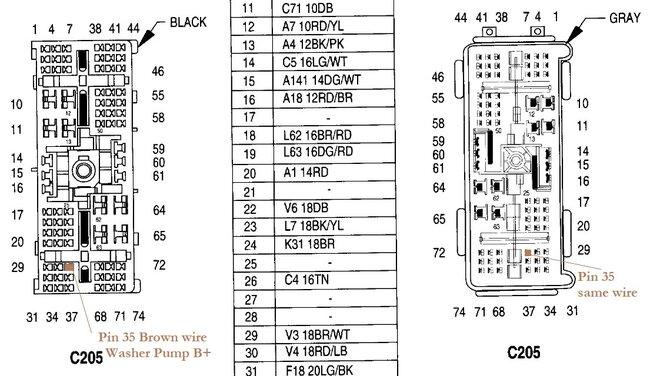

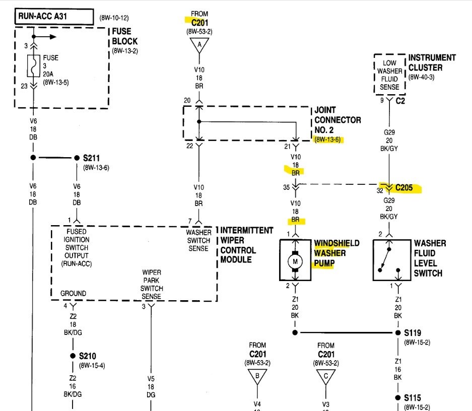

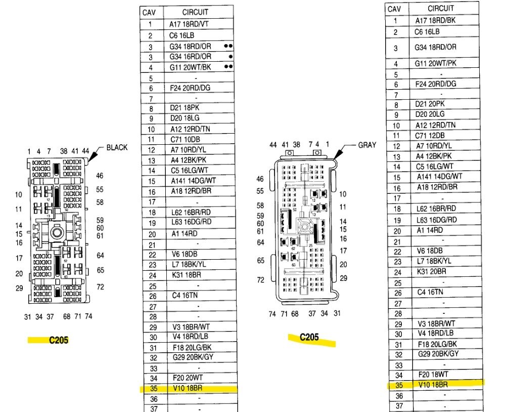

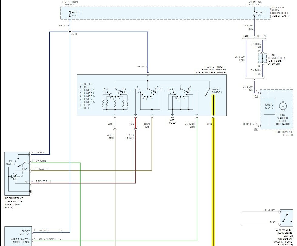

So, in the OEM diagram the washer pump's power feed comes from connector C205 next, which is just below the data link connector, it's still a brown wire there, pin 35. Then goes to that Joint Connector No. 2 which is probably on the steering column going towards the switch.
The 6th diagram is as far as they go with that connector, it's a white connector and should have 3 brown wires, but it might actually be plugged into the fuse block on the driver side dash, because they have the brown wires labelled as pins 20, 21, 22, so if power is missing a C205, I'd go to the back of that Fuse Block.
+1
Monday, March 18th, 2024 AT 3:01 PM
AL514
  • 5,596 POSTS

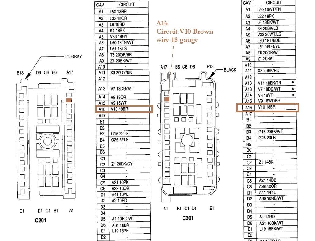

Actually, after C205 the brown wire runs to C201, its pin A16 circuit V10 still a brown wire. Thats the washer pump feed still. And C201 ends at the Multifunction Switch, so it can be traced all the way back to there.
It's still circuit V10 brown wire all the way to the switch.

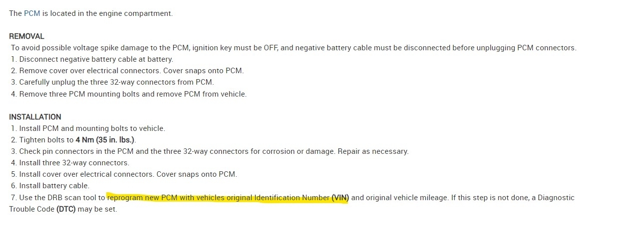

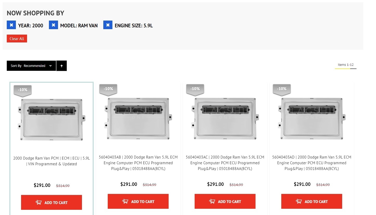

AL514
  • 5,596 POSTS

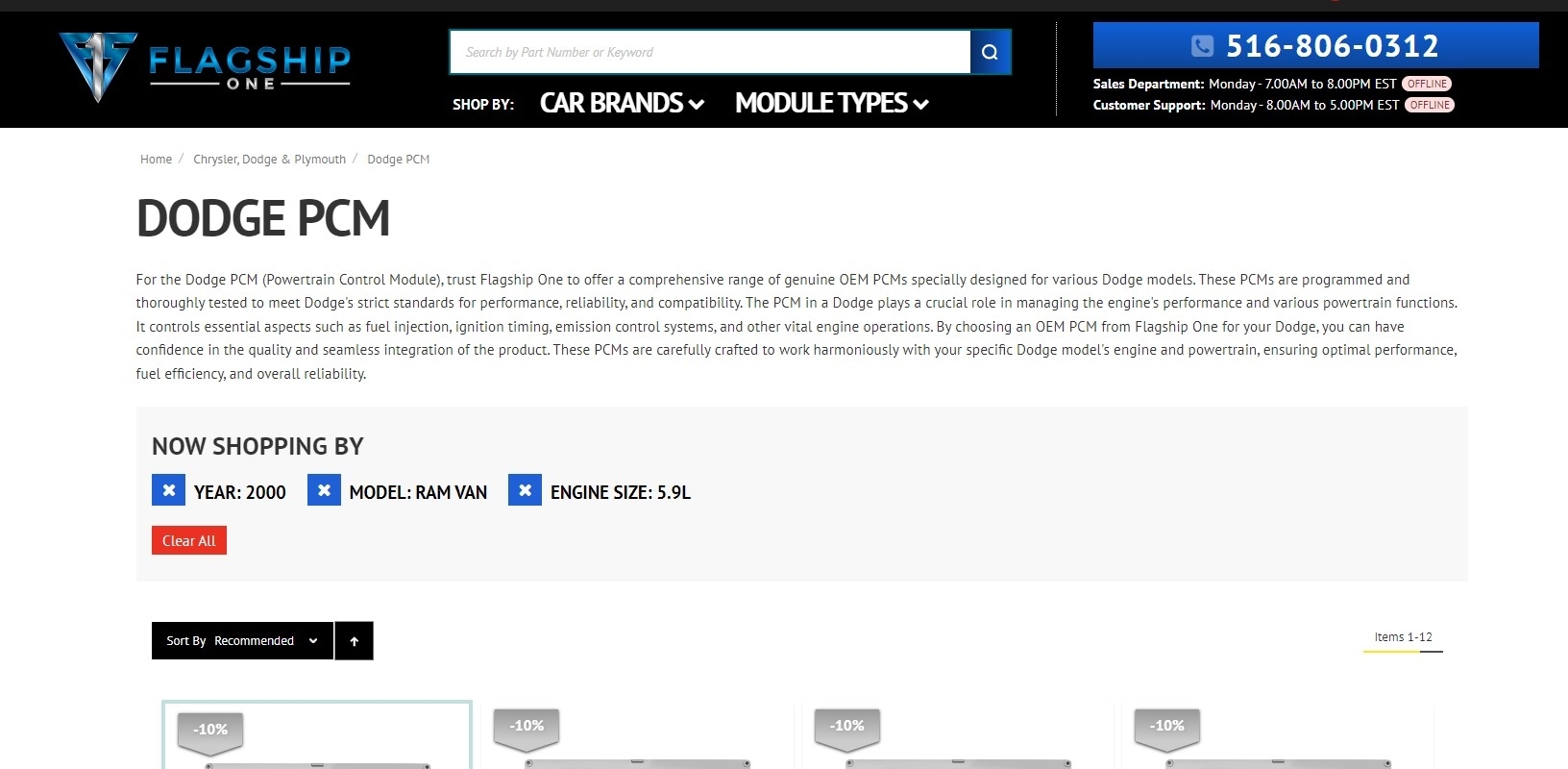

Just FYI, service info requires a VIN to be programmed into a new PCM using a capable scan tool. I'm not sure what options they gave you at the auto parts store, or where you ordered it from. But if you order from Flagship One, they can preprogram the VIN for you, so the module is plug and play.
+1

CAPTAIN KURTZ
  • 42 POSTS
Update, plugged in new PCM and all issues appear to be solved, all dash gauges and lights work and van is running good, has not given me any no starts. Windshield washer had been plugged in backwards so that was an easy fix. Thank you for all of your time and knowledge, Al with 2carpros is the Best!
