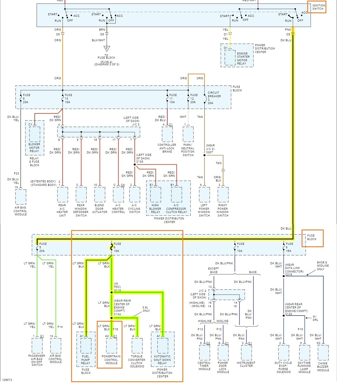

A2 on C1 has no power, but A1 and A3 on C1 read 12v with key on, this is when it's disconnected from PCM.

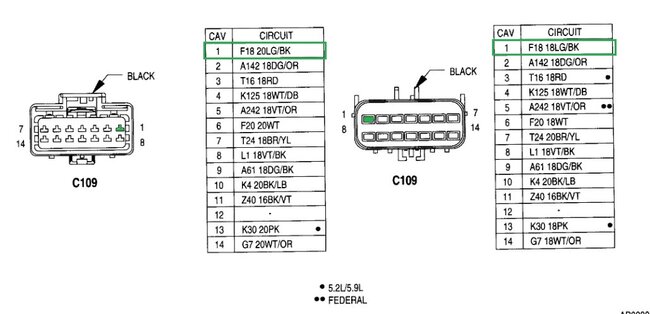

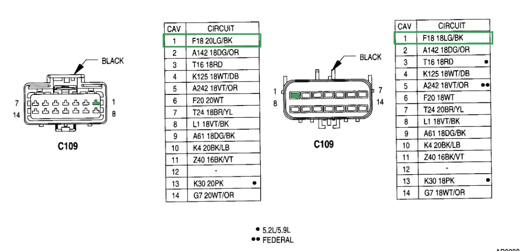

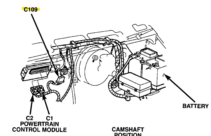

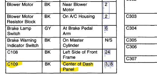

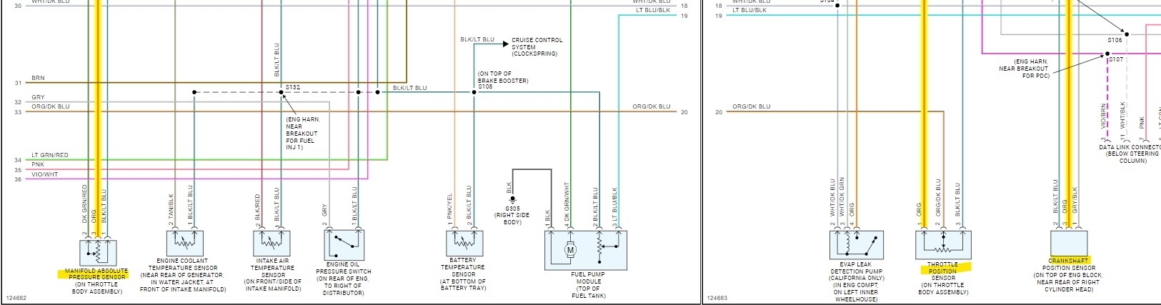

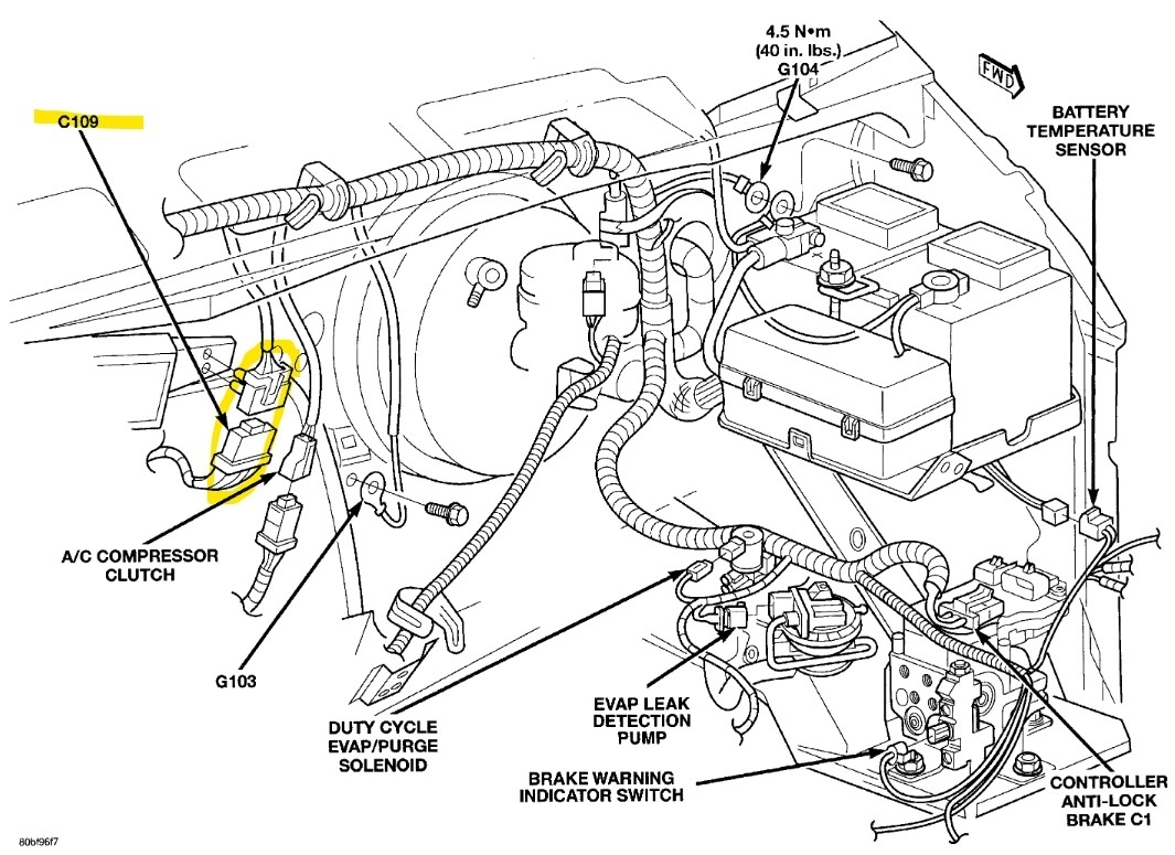

Here is connector C109, it has 13 wires and is Black, you'll have to identify it by its wire colors, service info doesnt show if its up in the center of the dash or on the firewall in the engine compartment, I think its going to be above the gas pedal area, Pin 1 is the Lite Green wire with a Black stripe. Its the last connector inline to the PCM A2.
You mentioned you had 5volts at the crank sensor, and that comes from A17, so A2 has to have power, since its the only Ignition Switch feed.
Once you have the PCM connector plugged back in, back probe one of the sensors in diagram 6 while its still plugged in and check for the 5volts, It should be there, if its missing while all those sensors are plugged in. We will go from there. I think you will find its there, and we are dealing with some type of network issue. There are other modules that can be causing this.

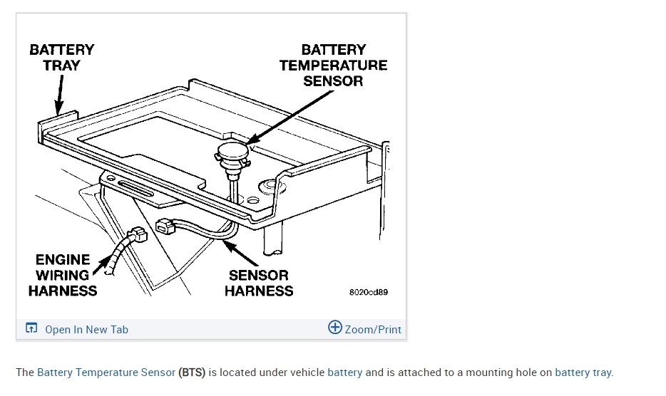

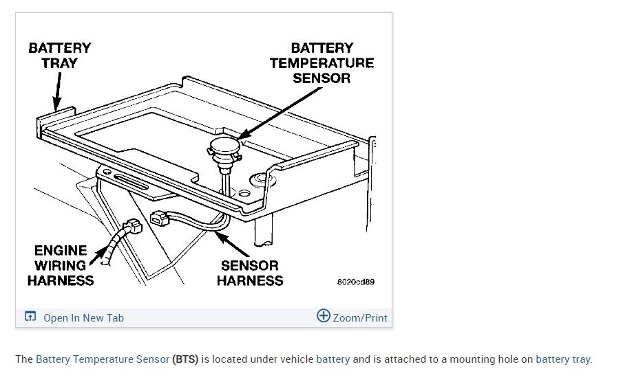

The battery temp sensor works on a 5volt reference, service info states its at the bottom of the battery tray (the worst place in the world to put it), but Id definitely check it. If the sensor is shorted to ground anywhere it will pull down the 5v ref. But so far I dont think you were missing any reference voltages, this is where testing with the PCM plugged in is important.

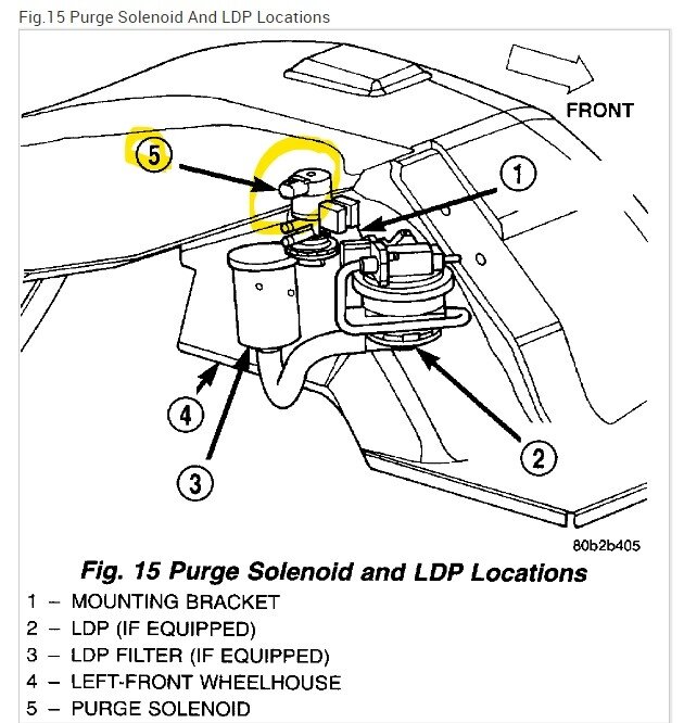

As for the P0443, thats the PCM not seeing 12volts on the control wire for the Purge valve, when a solenoid like the purge valve is off, the PCM will see 12volts coming through the solenoid and its monitoring that wire, When the PCM turns on the Purge solenoid it will Ground the control wire and that wire will go to 0volts,
You can check the Purge valves resistance with it unplugged, it should be 10-15 Ohms, and with the key On one wire of the connector should have 12volts on it.

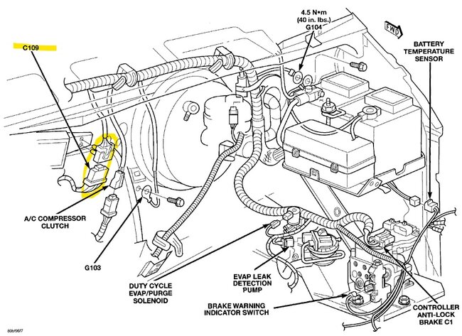

I'm going to keep looking for any modules located in the upper dash that could be affected so easily. But clear the codes out that have set, if they come back, here's the location of the battery temperature sensor and the Evap Purge valve. But you are correct the codes probably set because the PCM was unplugged with the key on.

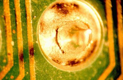

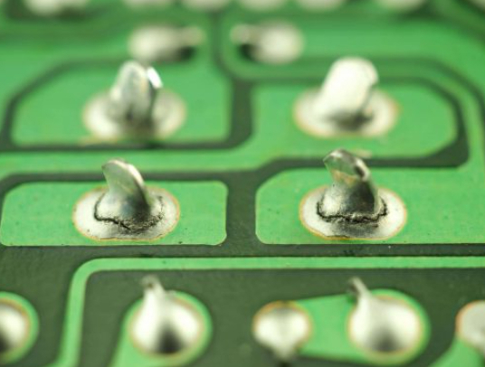

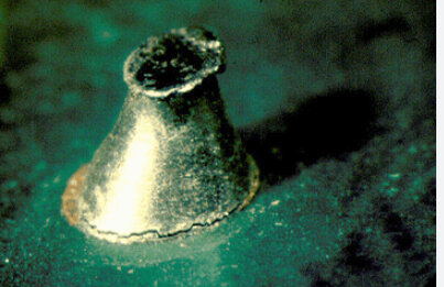

Good idea with the hair dryer, I suspected a connector issue, it might not even be corroded inside the connector, it may be that the females pins in the harness side of the PCM connector are spread apart some, since you can move the connector and hear relays activate, that means there just isn't a good connection inside. Another possibly is that the PCM circuit board has cracked solder joints right where the connector plugs in. Thats where they usually crack. Here are some pictures I saved of cracked solder joints, I know you replaced the PCM, but I'm almost a 100% sure it's a reman PCM.
But the way to check the pin tension in the connector is to find a pin that's the same size or just a tiny bit smaller than the ones on the PCM. They do a drag test to check the pin tension inside the PCMs harness side connector.
If you find loose pins, you'll feel it, go through and check all 3 connectors and spray some cleaner in there too,
The thermal issue sounds more like cracked solder though, but it might be pin tension, at least you have some direction now though. Let me know what you find.
