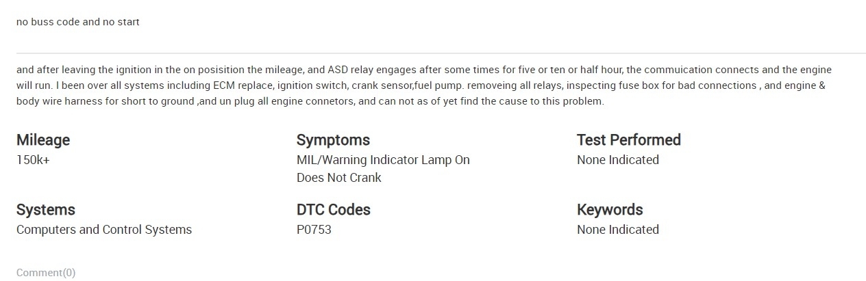

Tried switching the cluster bulbs between Cruise which was working and CEL to see if it was just a bad bulb. Now neither work. Could something in the cluster be doing all of this?

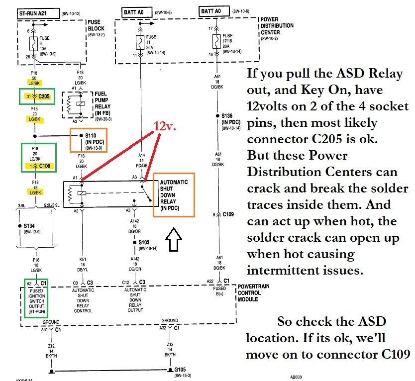

Checked ASD relay ports got 12.25 out of two of them.

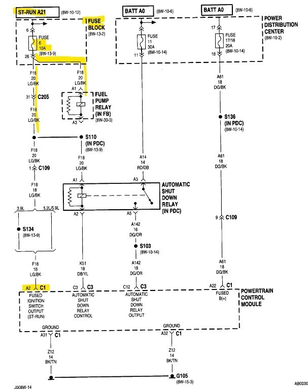

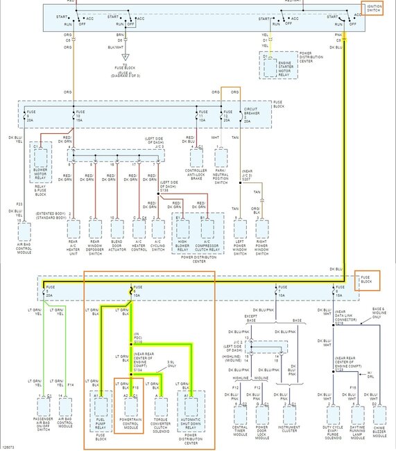

A2 on C1 has no power, but A1 and A3 on C1 read 12v with key on, this is when it's disconnected from PCM.
Mar 16, 2024 at 6:34 PM
It may be coincidence but almost seems like wiggling C3 gets it to register something and turns on fuel pump. I pulled the cover off the back of c3 and tried to located the C12 wire, will back probe both the dark green and orange wire and see what happens.
Mar 16, 2024 at 6:39 PM

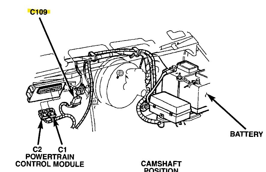

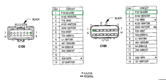

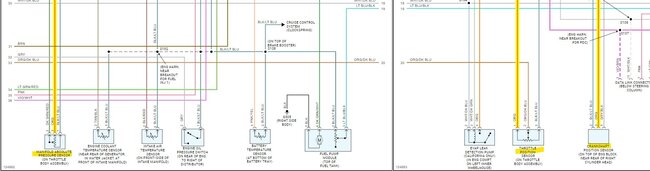

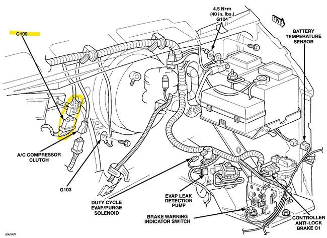

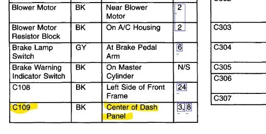

Here is connector C109, it has 13 wires and is Black, you'll have to identify it by its wire colors, service info doesnt show if its up in the center of the dash or on the firewall in the engine compartment, I think its going to be above the gas pedal area, Pin 1 is the Lite Green wire with a Black stripe. Its the last connector inline to the PCM A2.
You mentioned you had 5volts at the crank sensor, and that comes from A17, so A2 has to have power, since its the only Ignition Switch feed.
Once you have the PCM connector plugged back in, back probe one of the sensors in diagram 6 while its still plugged in and check for the 5volts, It should be there, if its missing while all those sensors are plugged in. We will go from there. I think you will find its there, and we are dealing with some type of network issue. There are other modules that can be causing this.

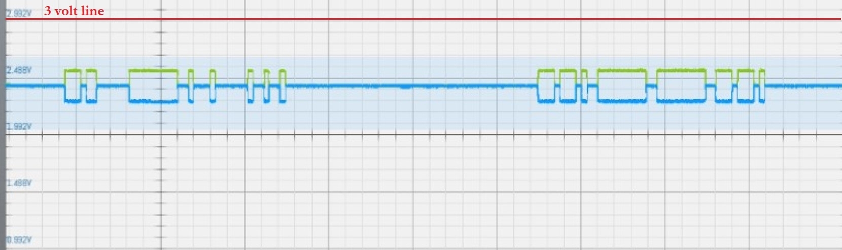

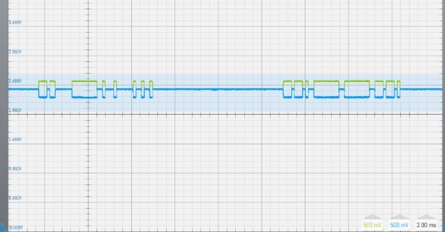

At this point I would be scoping the network to check the CCD signal, but you cant do that with a multimeter,.
The 11.2volts on A22 is low as well. That should be the same voltage level as at the ASD relay socket.
So retest with the PCM plugged in, and we'll get back at this tomorrow.

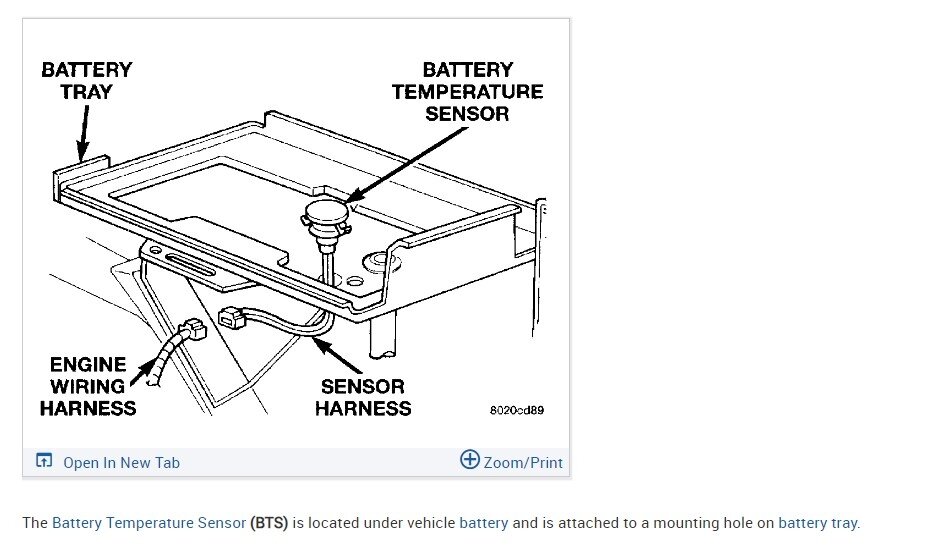

Thank you, just pulled two codes off it from the OBD P1492 Battery Temp Sensor and P0443 EVAP control circuit, I figure it's related to me disconnecting PCM harness but am surprised it actually threw a code, wasn't sure if it was capable. Once again thank you for your time, will talk tomorrow.

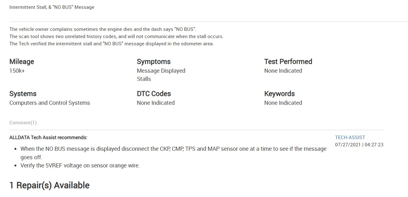

Are you still getting a no bus message and the PCM is setting codes? This makes me think there is something going on with the PCM connector pin fitment, with the PCM reacting like this. I would try unplugging the other 2 connectors and go to autozone or whatever auto parts store you have near you and get some electrical terminal cleaning spray. It will say Terminal Cleaner on the can. This is the best kind you can get, but I also use a WD40 terminal spray that works good. It will clean any corrosion that deep inside the connectors you may not be seeing.
The battery temp sensor works on a 5volt reference, service info states its at the bottom of the battery tray (the worst place in the world to put it), but Id definitely check it. If the sensor is shorted to ground anywhere it will pull down the 5v ref. But so far I dont think you were missing any reference voltages, this is where testing with the PCM plugged in is important.

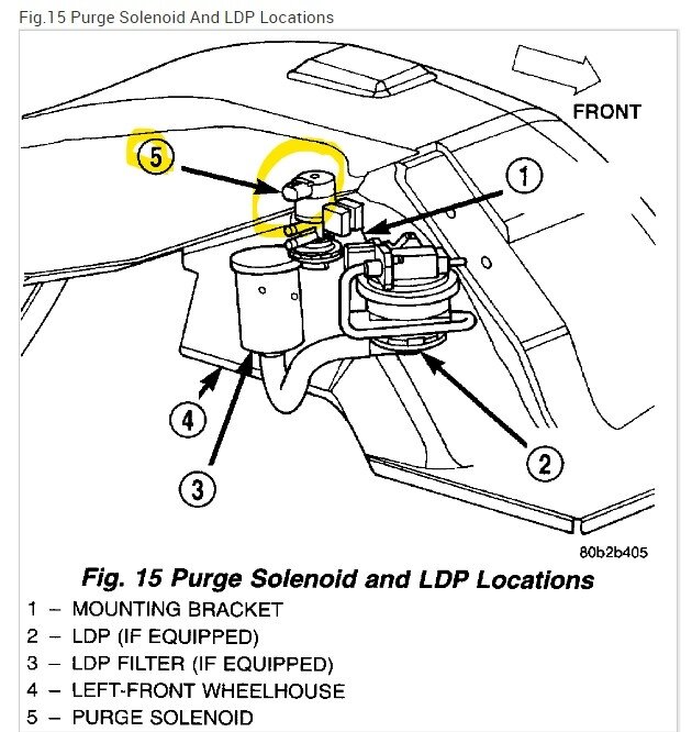

As for the P0443, thats the PCM not seeing 12volts on the control wire for the Purge valve, when a solenoid like the purge valve is off, the PCM will see 12volts coming through the solenoid and its monitoring that wire, When the PCM turns on the Purge solenoid it will Ground the control wire and that wire will go to 0volts,
You can check the Purge valves resistance with it unplugged, it should be 10-15 Ohms, and with the key On one wire of the connector should have 12volts on it.
If the no bus message is still showing but you can pull codes from the PCM, theres something going on with the other network, the scan tool communicates with the PCM on the SCI network (Serial Communication Interface) but the rest of the communications are done on the CCD network.

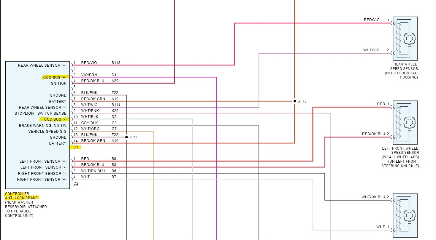

Okay, did you have the no bus message when pulling the codes from the PCM? or do you always have no comms with the PCM with the no bus message?
The next check during the fault, with the key off and no bus message, check for continuity to ground on pins 3 and then 11 of the DLC. Thats checking if either of the bus + or - is shorted to ground while this is happening. Have your meter set on the resistance (Ohms) setting. Since you're checking at the data link connector, you can use pins 4 or 5 for ground checks, but also use a body ground as well just to be sure. You shouldn't have any continuity to ground on pins 3(CCD bus +) or 11(CCD bus -). You might as well check pins 6 and 7 as well, those are the PCM to scan tool data wires.

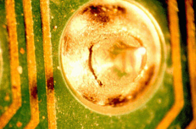

I think I'm onto something. It's been starting today at about 65*. I can make it not start by holding a blow dryer over C3 (we are going c1-c3 left to right?). Afterwards I can push or pull very lightly on the same connector and hear fuel gauge activated and then it will start. Going to get the CRC or WD40 electrical cleaner in an hour or so, finding the Deoxit proved nearly impossible, will order some for future projects.
Mar 17, 2024 at 3:13 PM

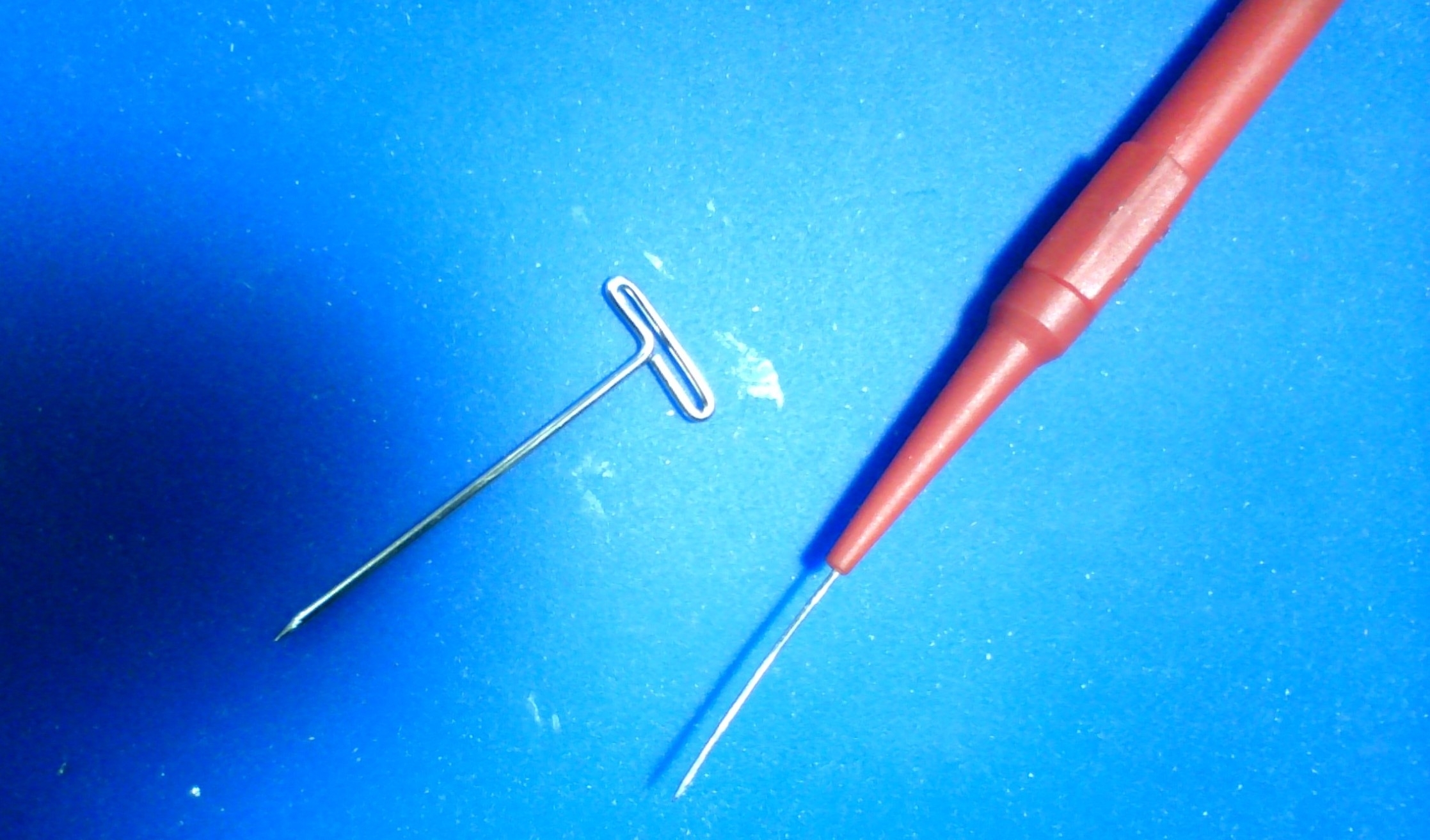

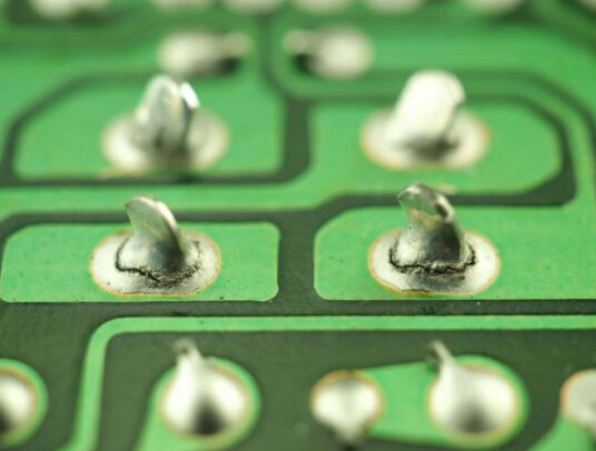

Good idea with the hair dryer, I suspected a connector issue, it might not even be corroded inside the connector, it may be that the females pins in the harness side of the PCM connector are spread apart some, since you can move the connector and hear relays activate, that means there just isn't a good connection inside. Another possibly is that the PCM circuit board has cracked solder joints right where the connector plugs in. Thats where they usually crack. Here are some pictures I saved of cracked solder joints, I know you replaced the PCM, but I'm almost a 100% sure it's a reman PCM.
But the way to check the pin tension in the connector is to find a pin that's the same size or just a tiny bit smaller than the ones on the PCM. They do a drag test to check the pin tension inside the PCMs harness side connector.
If you find loose pins, you'll feel it, go through and check all 3 connectors and spray some cleaner in there too,
The thermal issue sounds more like cracked solder though, but it might be pin tension, at least you have some direction now though. Let me know what you find.

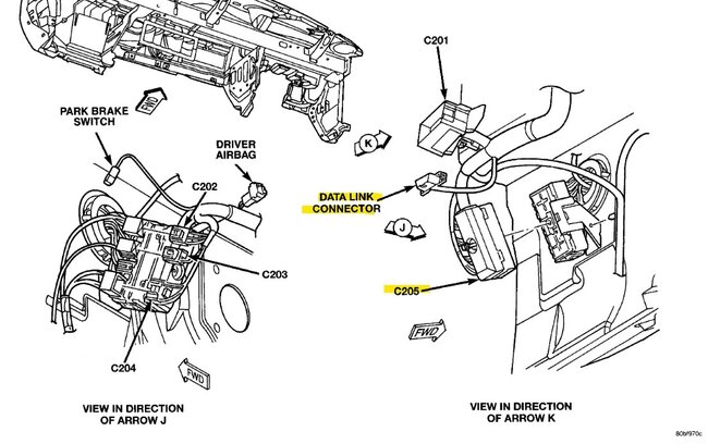

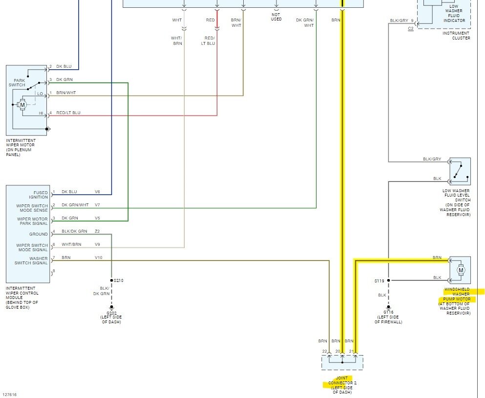

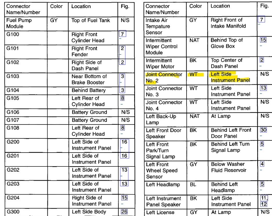

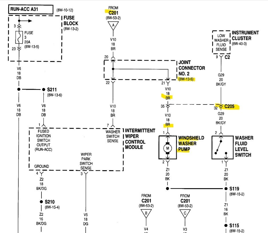

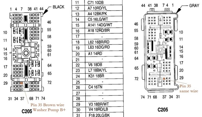

While I'm waiting for the new PCM I figured I'd replace and repair a few little things on the van. Would you have the wiring diagram for the windshield washer, the fuse is good, wipers and blinkers work, I checked for power to the washer and found none.
Mar 18, 2024 at 2:24 PM

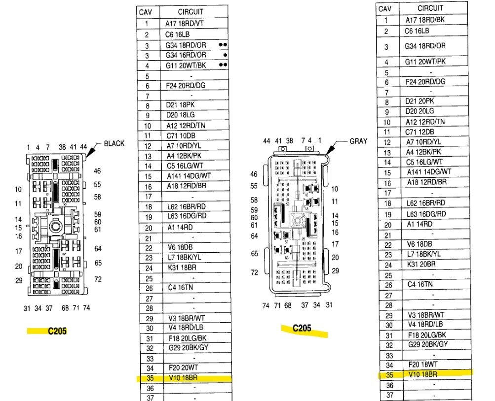

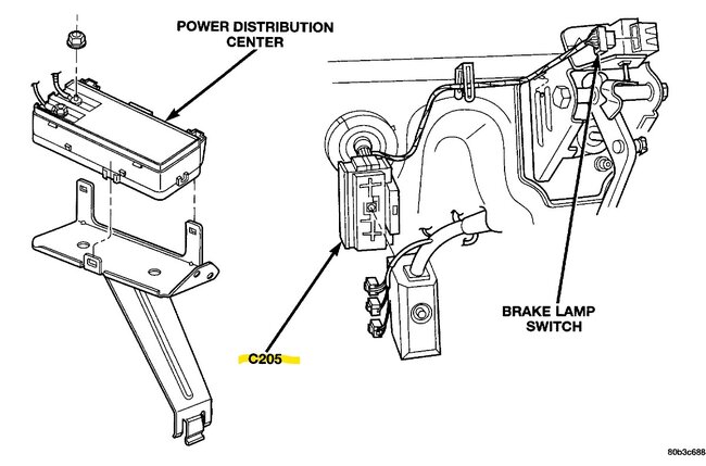

So, in the OEM diagram the washer pump's power feed comes from connector C205 next, which is just below the data link connector, it's still a brown wire there, pin 35. Then goes to that Joint Connector No. 2 which is probably on the steering column going towards the switch.
The 6th diagram is as far as they go with that connector, it's a white connector and should have 3 brown wires, but it might actually be plugged into the fuse block on the driver side dash, because they have the brown wires labelled as pins 20, 21, 22, so if power is missing a C205, I'd go to the back of that Fuse Block.

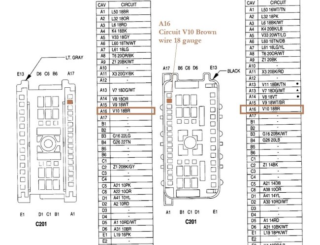

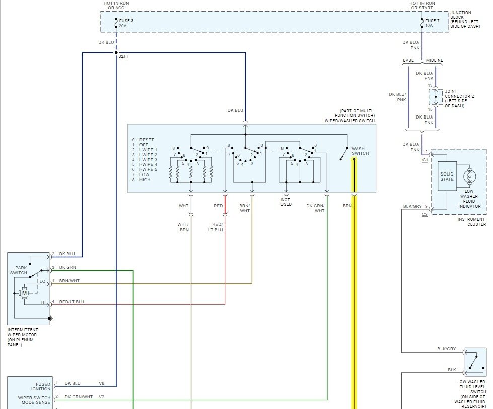

Mar 18, 2024 at 3:01 PM

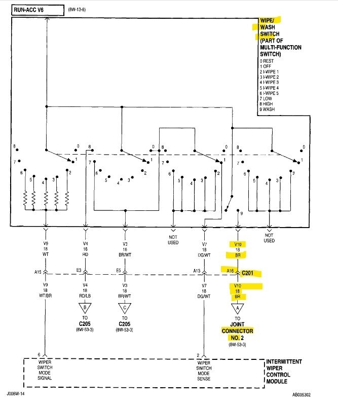

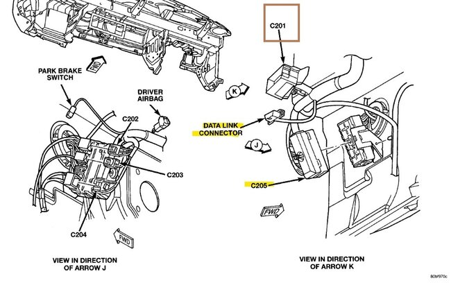

Actually, after C205 the brown wire runs to C201, its pin A16 circuit V10 still a brown wire. Thats the washer pump feed still. And C201 ends at the Multifunction Switch, so it can be traced all the way back to there.
It's still circuit V10 brown wire all the way to the switch.

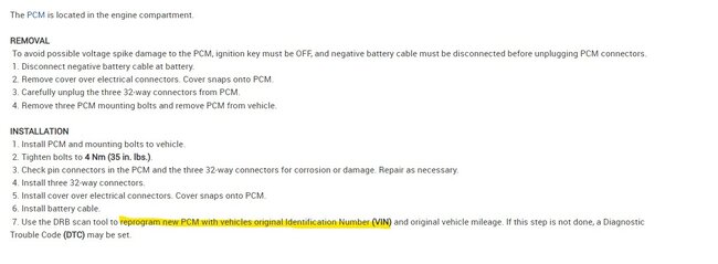

Just FYI, service info requires a VIN to be programmed into a new PCM using a capable scan tool. I'm not sure what options they gave you at the auto parts store, or where you ordered it from. But if you order from Flagship One, they can preprogram the VIN for you, so the module is plug and play.
