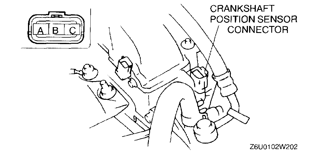

First, when it doesn't start, I would suggest seeing if you lost spark to the plugs. Often times, a bad crankshaft position sensor will fail when they get hot.
Take a look through this link:
Here are directions for testing your sensor. These are specific to your vehicle.
2002 Mazda 626 LX L4-2.0L DOHC
Component Tests and General Diagnostics
Vehicle Powertrain Management Sensors and Switches - Powertrain Management Sensors and Switches - Computers and Control Systems Crankshaft Position Sensor Testing and Inspection Component Tests and General Diagnostics
COMPONENT TESTS AND GENERAL DIAGNOSTICS
CRANKSHAFT POSITION SENSOR INSPECTION
Inspection of Resistance
1. Disconnect the battery negative cable.
2. Disconnect the crankshaft position sensor connector.
pic 1
3. Measure the resistance between terminals A and B using an ohmmeter.
- If not as specified, check related wiring harness. If they are okay, replace the crankshaft position sensor.
Specification: Approx. 550 ohms

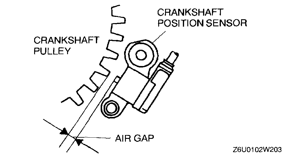

Inspection of Air Gap
1. Verify that the crankshaft position sensor is installed correctly and securely.
pic 2
2. Measure the air gap between the crankshaft pulley teeth and the crankshaft position sensor using a feeler gauge.
- If not as specified, replace the crankshaft pulley or the crankshaft position sensor.
Specification: 0.5 - 1.5 mm 0.020 - 0.059 in
___________________________________________
If you lose spark, chances are this is the problem. I have one more link and that explains how to check for spark. Note, if you have a live data scan tool, you can check to see if there is an RPM signal when it won't start. If there is no signal, then chances are this is the issue.

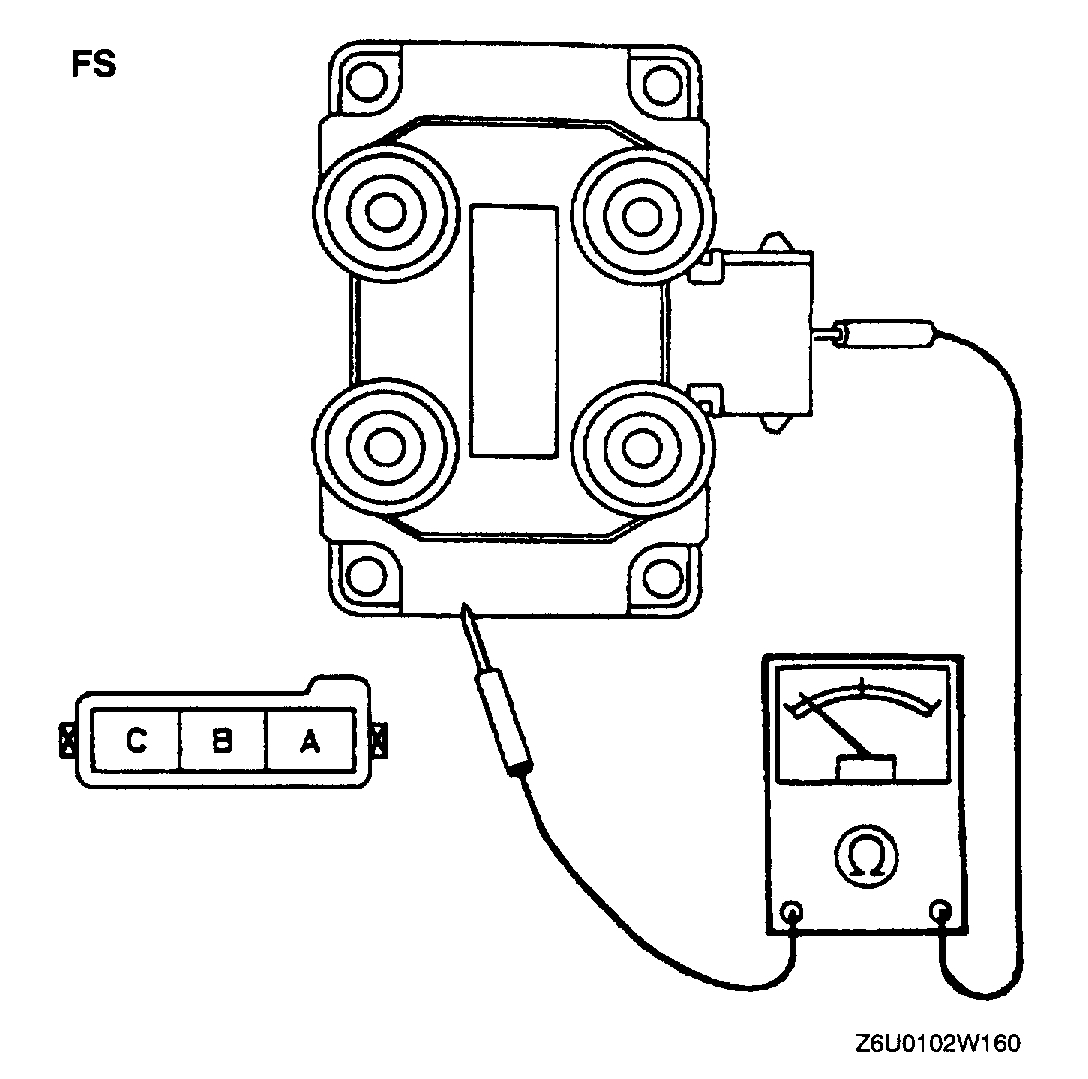

It sounds like an electrical issue. Have you checked fuel pressure?
Also, it could be the ignition coil. Here are directions for testing it:

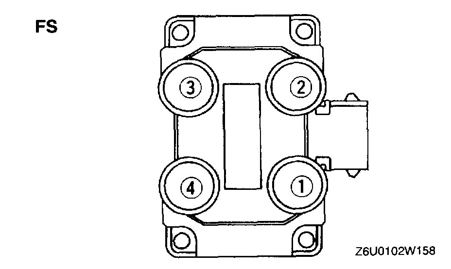

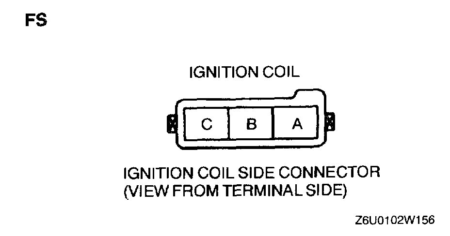

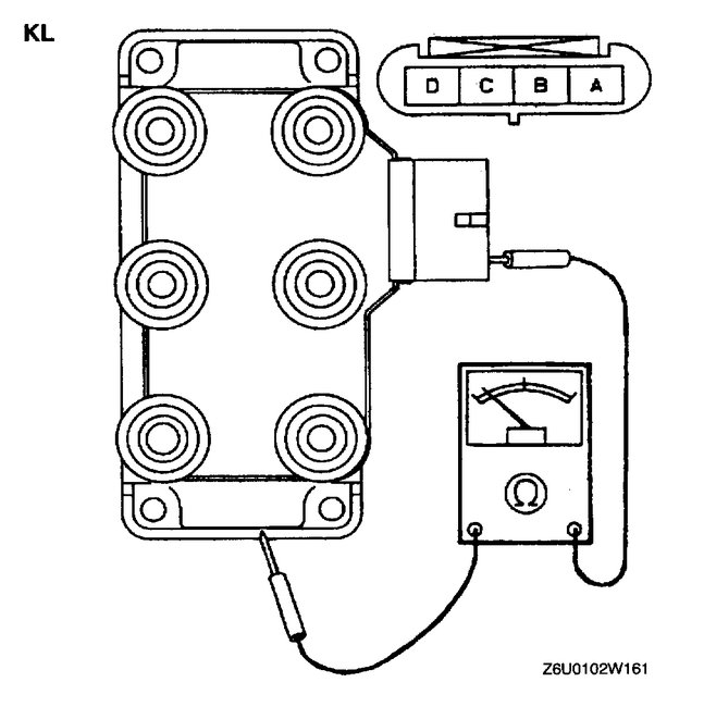

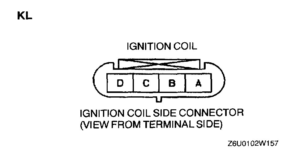

IGNITION COIL INSPECTION
Primary Coil Winding
1. Disconnect the ignition coil connector.
FS
pic 1
KL
pic 2
2. Measure the resistance using an ohmmeter.
1. From terminal A to B, and terminal B to C. (FS)
- If not as specified, replace the ignition coil.
2. From terminal A to D, and terminal B to D, and terminal C to D. (KL)
Specification: 0.45 - 0.55 Ohm [20 °C 68 °F ]

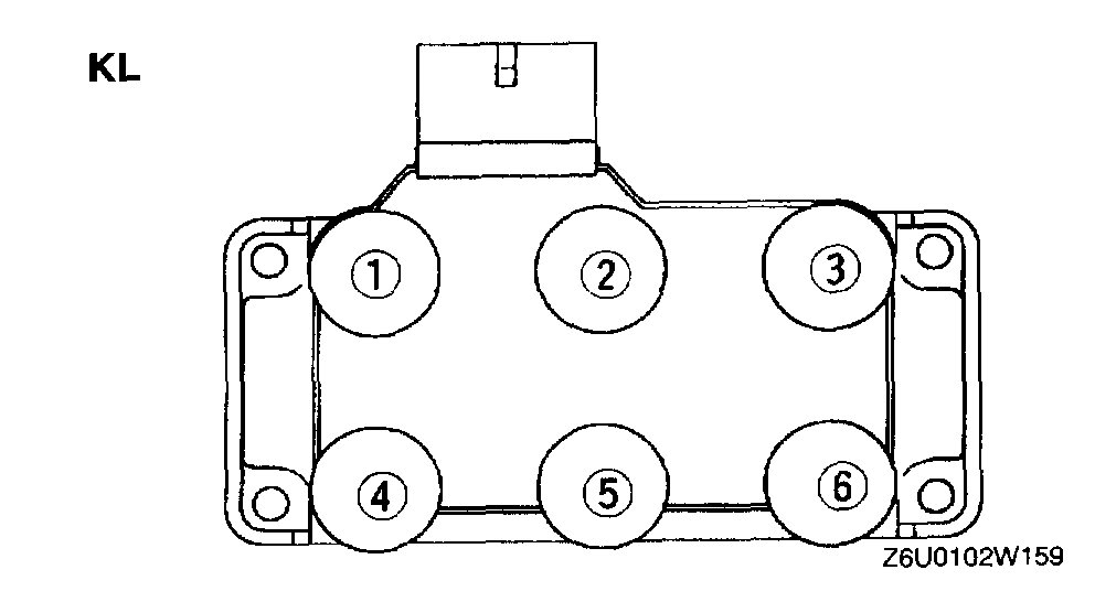

Secondary Coil Winding
1. Disconnect the high-tension leads.
FS
pic 3
KL
pic 4
1. From lead hole 1 to 4, and lead hole 2 to 3. (FS)
2. From lead hole 1 to 4, and lead hole 2 to 5, and lead hole 3 to 6. (KL)
Specification: 11.5 - 15.5 kilOhms [20 °C 68 °F ]

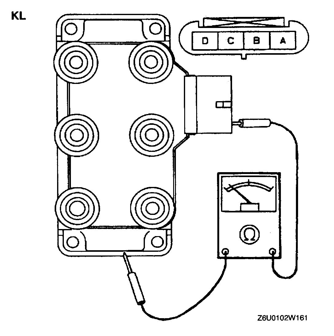

Insulation Resistance of Case
1. Disconnect the high-tension leads and ignition coil connector.
FS
pic 5
KL
pic 6
2. Measure the insulation resistance between terminal B (FS) or D (KL), and ignition coil case using an ohmmeter.
Specification: Above 10 megohms
