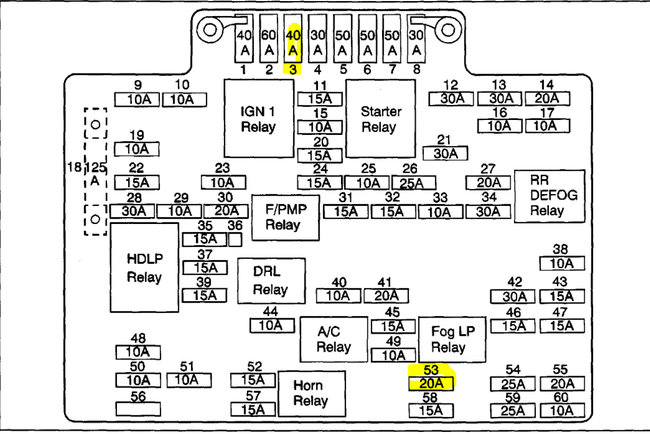

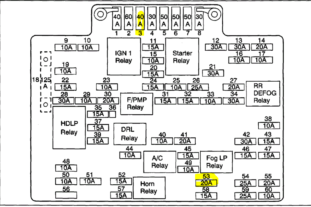

I need to start from the beginning. The ignition C fuse can be causing issues as well as ignition fuse A. Both fuses are in the underhood junction box. I need these checked first. In addition to checking the fuses, make sure there is power to and from them. Here is a link you may find helpful:
Also, see if it will start if you place the transmission in neutral.

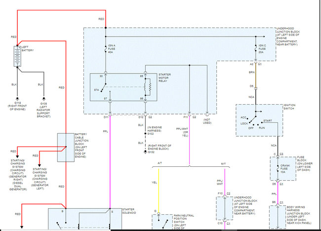

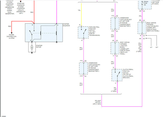

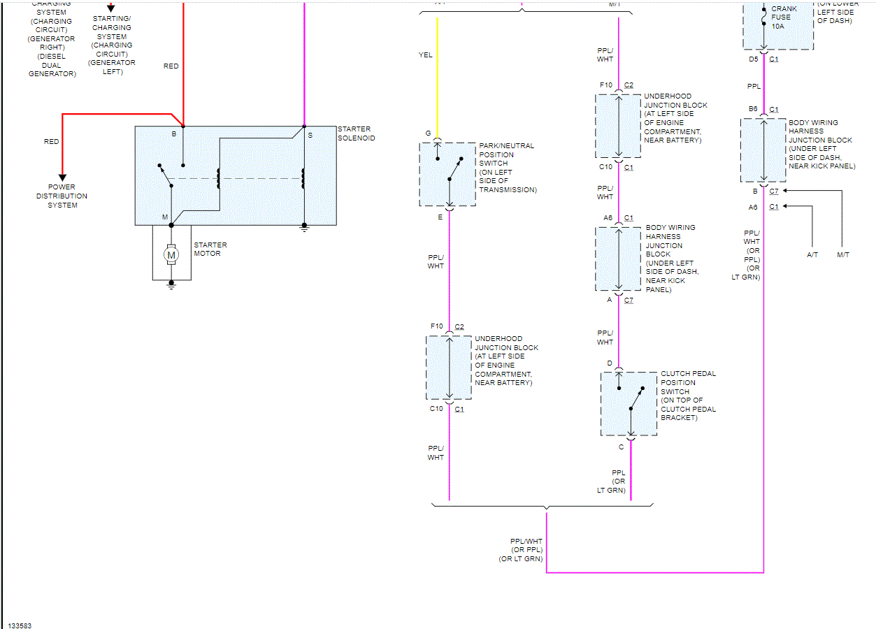

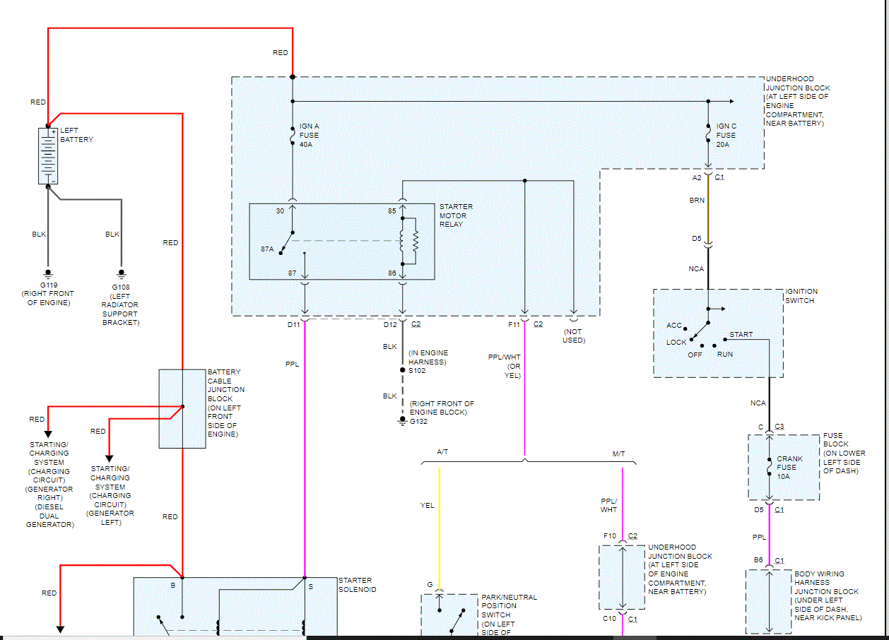

Next, I attached the entire starting system wiring schematic below. I had to cut the pic in half to make it readable, but I did overlap them. You can use this as a reference.
Also, switch the starter relay with a different one in the box that has the same part number. Or, here is a link that explains how to check one:
If the fuses are good and the relay is good, we need to check the purple wire on the starter motor for power. It should only have 12v when the key is in the start position. You will need a helper when testing. Here is a link that explains the procedure:
Pic 3 below shows the fuse box underhood. I highlighted two fuses I need to have checked.
Let me know what results are found.

Thanks for the info. Was able to take a peak and get ign A pulled out this morning and it as a break in the fuse. I did not have my needle nose handy to pull out ign c but looking it seemed to be good. I intend to pick up a replacement today and will try to get it all back together to test it out. Anything I should look for as the cause for the fuse blowing out? Thanks for the help.
Tuesday, June 22nd, 2021 AT 6:53 AM
  • 110,194 POSTS
If it has only happened one time, I wouldn't be overly concerned. Fuses get old. The truck is 20, and I bet that is the original fuse.
When you replace it, only use the same amperage fuse that you removed. That way if there is a problem, it will blow again and not cause other problems.
If possible, let me know if that takes care of the problem.

I replace the Ign A 40 Amp fuse and now I have it cranking again! The truck will crank and then sputter a bit but every few minutes but it does not start. The fuel pressure gauge climbed to 50-55 once I started turning it over but still nothing.

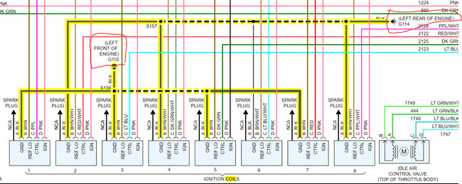

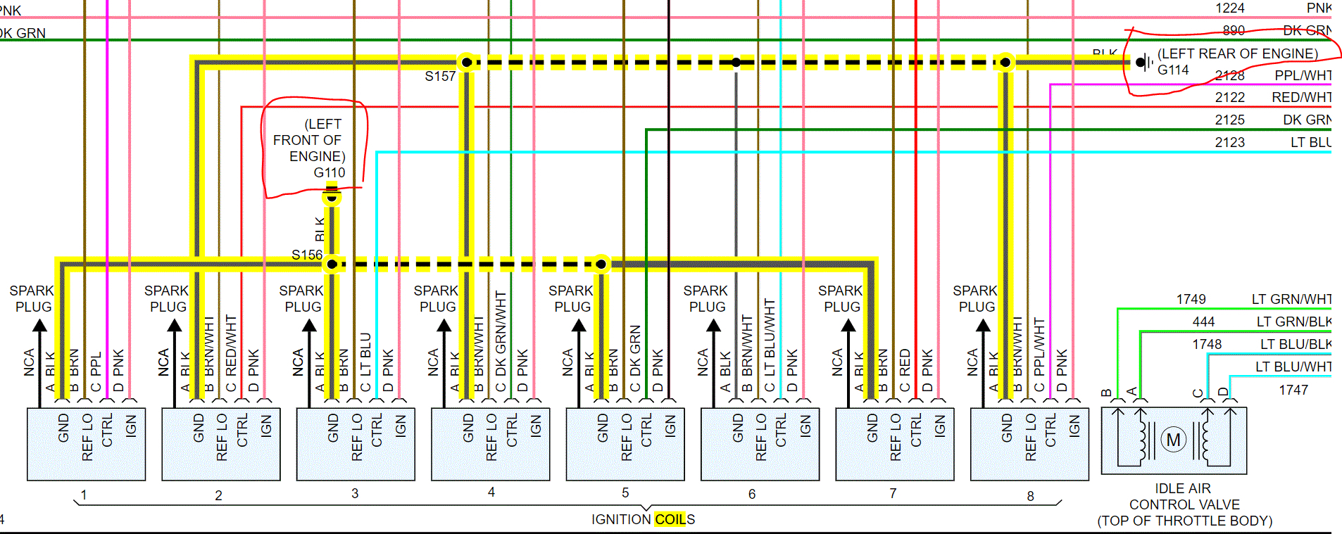

One other thing. There are two grounding locations for the ignition coils. Both are on the left side of the engine, one in the front and one in the rear. See pic below. Check the condition of the grounds, wiring, and connector. It isn't uncommon for these trucks to have ground issues for the ignition coils.
The P0335 is related to the CKP, but testing is done at the powertrain control module. There could be a loose connection, corrosion, or water may have gotten into it and caused problems. So we really need to take this one step at a time.
