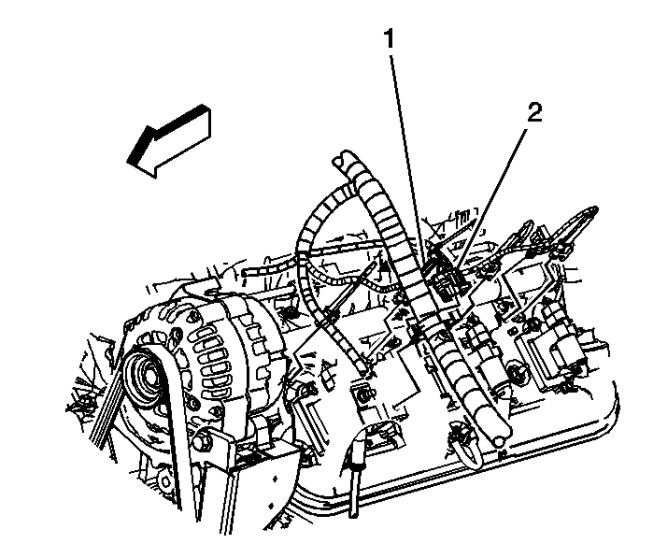

1. Remove the engine sight shield, if required.
2. Remove the Connector Position Assurance (CPA) lock.
3. Disconnect the main electrical connector (2) to the ignition coil wire harness.
4. Remove the harness clips (1).
5. Reposition the engine harness, if necessary.
6. Remove the spark plug wires from the ignition coils.
Twist each plug wire 1/2 turn.
Pull only on the boot in order to remove the wire from the ignition coil.

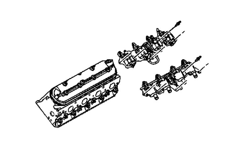

7. Remove the ignition coil bracket studs.
8. Remove the ignition coil bracket.
ImageOpen In New TabZoom/Print

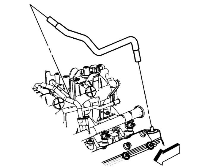

9. Remove the positive crankcase ventilation (PCV) hose.

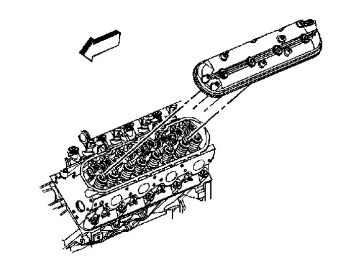

10. Loosen the valve rocker arm cover bolts.
11. Remove the valve rocker arm cover.
12. Remove and discard the old gasket (1).
13. If required, clean and inspect the rocker arm cover.
