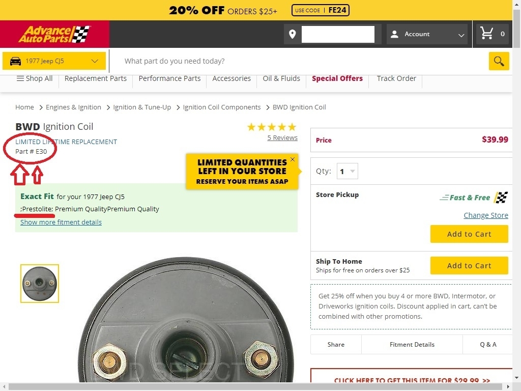

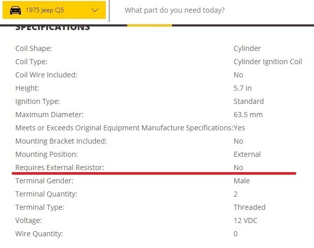

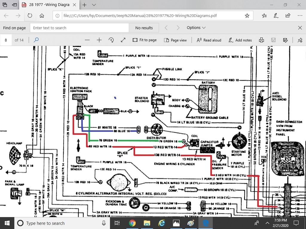

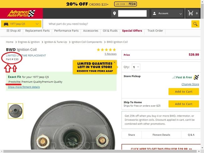

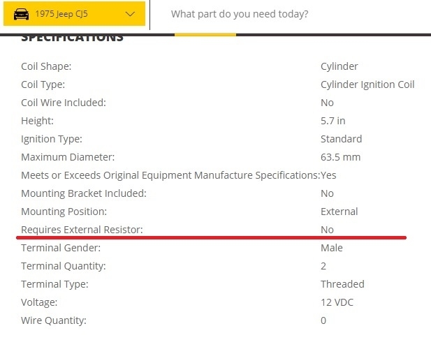

External resistor is not needed.
Here's info from a 1977 with the same system.
I also made you some screenshots from Advance Auto Parts of the correct coil.
