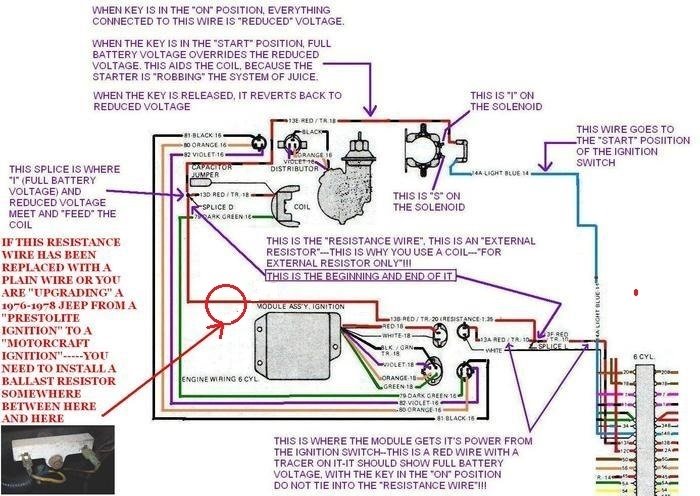

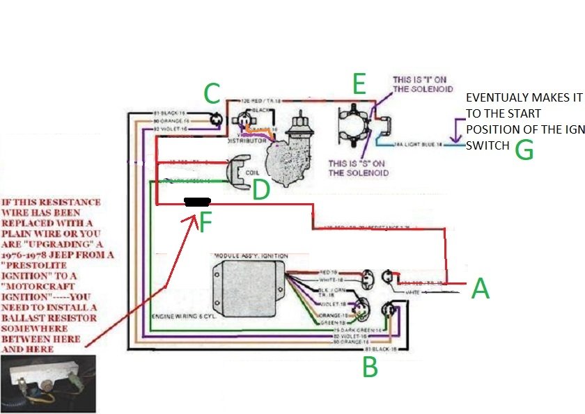

I was able to read through most of you the forum on the CJ 1976-1977 ignition problems. My ignition module is going out and the after market module does not work in conjunction with the Prestolite distributor currently in the vehicle. My confusion is in what all do I need to change out to upgrade to a better ignition solution?
Thanks,
Tom

Prestolite is not well suited for a CJ.
I sort of experienced every problem it dished out to me. Module/wires entering the distributor/spring breakage on the mechanical advance weights inside the distributor/ and the "balloon" cracking for the vacuum advance inside the front of the distributor.
When they started duplicating the same problems, I switched to Motorcraft on my 1977.
Best thing I did for this Jeep!
This is your list for what you need.
Basically, your system will be a "1979" when we are done.
So when you ask for this stuff, tell them it is a 1979.
A new or re-manufactured 258 distributor. Advance Auto/Carquest has this one with the cap and rotor included. Lifetime Warranty too! Link below.
https://shop.advanceautoparts.com/p/carquest-ignition-distributor-with-cap-and-rotor-new-t4691/10435884-P?navigationPath=L1*14923%7CL2*15034%7CL3*16062
Need an Ignition Module too! This one's a little more expensive. Lifetime warranty!
https://shop.advanceautoparts.com/p/wells-vehicle-electronics-control-module-f102/10302218-P?navigationPath=L1*14923%7CL2*15032%7CL3*16043
Need a coil!
https://shop.advanceautoparts.com/p/bwd-ignition-coil-e71p/5240271-P?navigationPath=L1*14923%7CL2*15034%7CL3*16064
A connector for the coil.
https://shop.advanceautoparts.com/p/bwd-ignition-coil-connector-pt5764/20974639-P?navigationPath=L1*14923%7CL2*15034%7CL3*16064
Wire set. Does no have to be anything special.
https://shop.advanceautoparts.com/p/carquest-premium-spark-plug-wire-set-35-6309/19250131-P?navigationPath=L1*14923%7CL2*15034%7CL3*16072
Going to need a ballast resistor. The Prestolite set-up did not use a resistance wire, the ballast resistor will be its substitute for the 1979 set-up.
https://shop.advanceautoparts.com/web/PartSearchCmd?storeId=10151&catalogId=10051&langId=-1&pageId=partTypeList&actionSrc=Form&searchTerm=ballast+resistor&vehicleIdSearch=1627
Need some wiring to connect the distributor to the module.
To get a deal, We will have to shop around on eBay/salvage yards to find the correct connectors for the ignition module feed and the four wire connectors from the ignition module to the distributor.
I will help you with this treasure hunt if you are indeed serious with this upgrade.
I will hang with you as long as you keep responding. I have wire diagrams and can talk you through this whole process. I can also show you how to save money on these parts too.

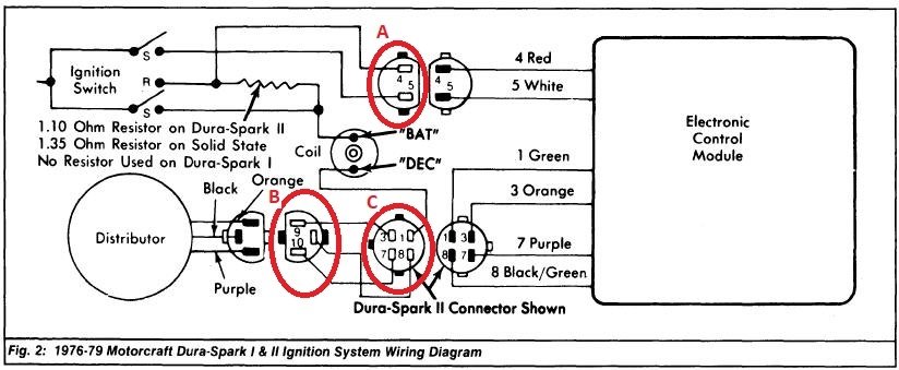

At minimum, you will need the two connections to the ignition module, one will have two wires, the other will have four.
The connection for the distributor will have three wires (it sort of goes to the four wire connector at the module).
Sending you a diagram of how it works.
I will aid you later on where to tie onto the Prestolite wires, it is probably vague in my diagram below.

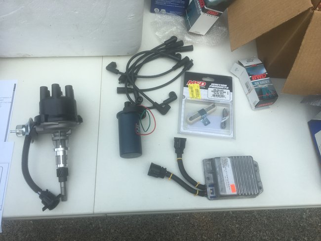

I just scored on a module and will be ordering everything else. I will get a picture out to you ASAP.

I ordered the parts you recommended, so hopefully with your help I can find the proper connector and get this installed when everything arrives.

I'll start looking for New connectors, You may have to add wire to 'em to make 'em reach.
If you are still looking in salvage yards, Ford stuff from the 70's may be perfect.
Just compare the # of wires on the connector ends to the diagram I sent you.
Mine came off of a pickup, I had to shorten the wires from the module to the distributor, as they went around the world to connect on the truck setup.
Just a pointer
Don't try to pry them apart, you'll break off the locking tabs. The textbook correct way (dumb as it sounds), is to
Grasp the wires on both sides of the connector, snatch/ jerk, it will come apart.

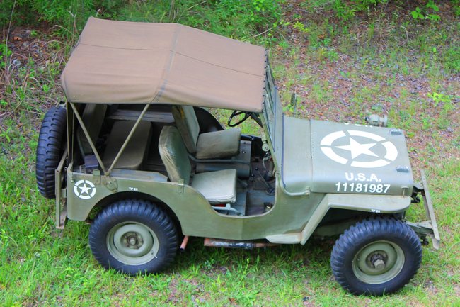

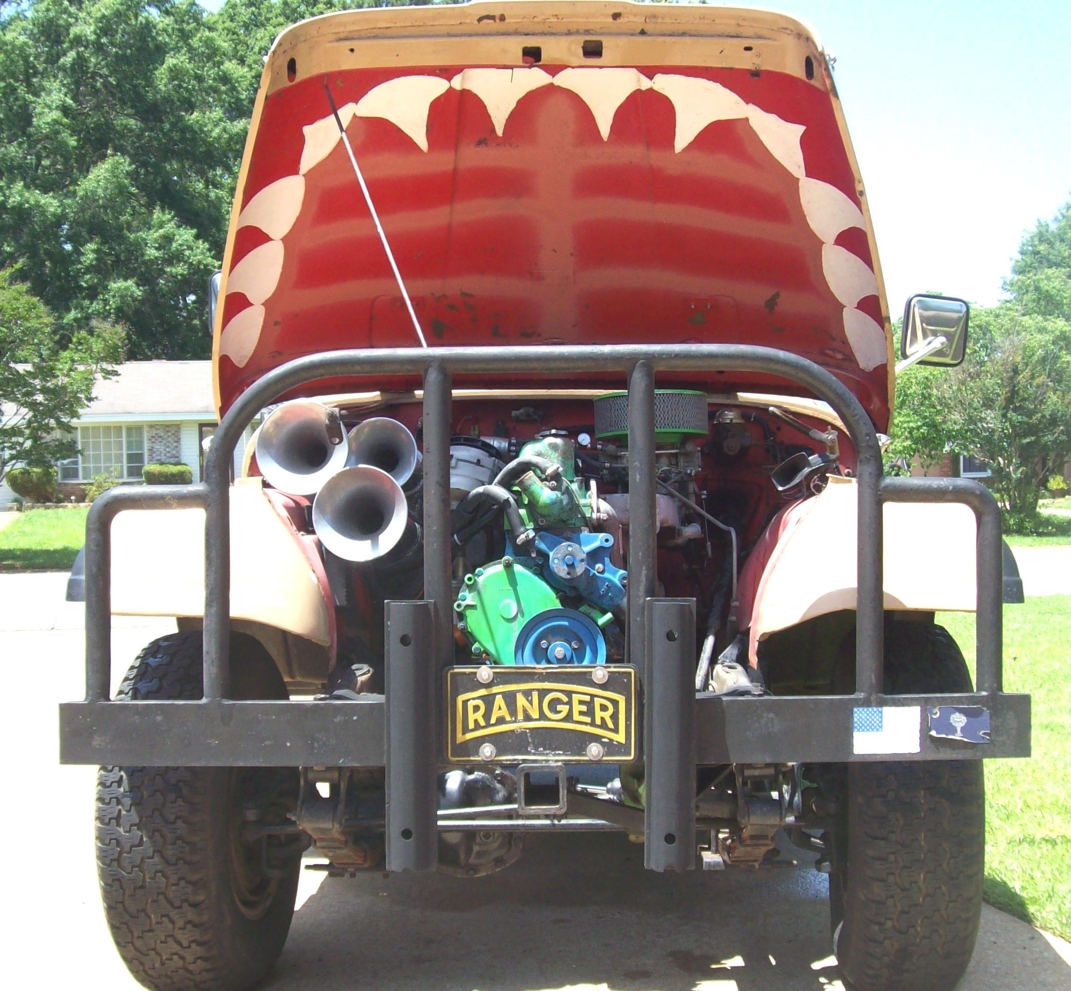

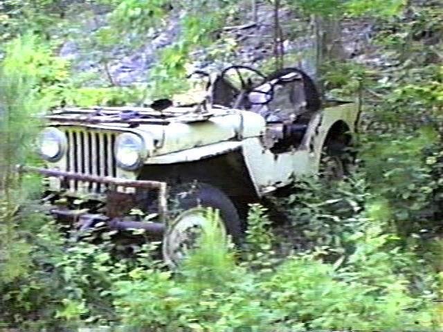

pic 1) Present '77 w/ 258
pic 1) Jeep #1 '77 in 1983 w/ 304
4 others in between
And of course, we have my '46 "Willy" too!

Just letting you know that I hadn't forgot you! If you are on during my 2cartime, we can sorta back and forth communicate in real time with questions and answers!
I've been to Fort Lewis several times, 2nd Ranger Battalion is there, I was in 1st Ranger Battalion at Hunter Army Airfield,Savannah, GA. They even let us invade Seattle twice, during off time!
So, Late for me, is kinda early for you!
Diagram Again.
See below/ click on it!
Let me know if you see it! Sometimes there are 2carglitches!

Right on , I received the diagram.. I can't thank you enough for your service and for all that you do and have done for this country.

How are you, hopefully my parts will be arriving this week. I have another question for you, I have the original swing out arm - spare tire holder on the back of my jeep do. you have any diagrams or pictures on the mechanism that secures and locks its closed. Looks like the previous owner did a make shift job on it . I ll send you a pic of what I have.

Hello sir how are you ? The good news is that the sun is still shining here in the Seattle area. No rain yet . I have received all the parts you recommended to get my ignition switched over. Now I need to get the proper wire and connectors taken care of . I ll do a dry run on all the components then see if that local cj junk yard has any of those connectors. Any thoughts out your way on possible connectors ?

No word back from my Email yet.
I have continued to look here and there.
In pic below, I can find "B" and "C",
Just not "A"
I was sorta hoping to find 'em all at one site and REASONABLE!
Any luck with the late '70s- early '80s Fords in the salvage yard?

See if what I did get and labeled will aid you in the salvage yard. '70s and early '80s Fords (and Jeeps) is the ticket!

I took my diagram and sorta stripped away the crap in your way.
I also Labeled areas of the wiring with Green Capital Letters so you can reference the area back to me that you may be having problems with.
Lemme know where you need assistance.

My last diagram (Monday, Feb 5)
At location "A" I have a "Red" and "White" wire going nowhere. These wires will get tied in to your '76 wiring, I will show you where soon!
My last diagram - this is all new stuff (and the wiring) going into the Jeep (except the solenoid at location "E", it remains) Do you understand how all of that goes in?

Pretty much, Lay the parts out as in the diagram.
Insure the plugs will plug in where the should and the right number of pins are on them. Go ahead and figure out which wire will match up correctly for the pins.
It may be helpful to label each wire near the connector so that connecting them will go really smooth when cutting them to length. The label should be far enough away so that it doesn't get cut off.
"A" on this end goes to "A" on the other end, "B" on this end matches up with "B" on that end.
You may have to shorten or lengthen the wires from the salvage yard, but wait until you are installing them, this will insure a neat job.
The big thing is, while you install them and are butt splicing them together make sure the wires connect to the correct pins on either end. Salvage yard wires from various vehicles may be different colored.
Stupid example:
Diagram may show a hot pink wire from pin "A" to the other end pin "B".
Your salvage yard wire to Pin "A" may be "brown"
Your salvage yard wire to Pin "B" may be "yellow"
So, You must connect "brown" to "yellow" to mimic the hot pink setup shown in the diagram.
I hope I'm not baby-ing you too much here!

Haha, I need to be babied on this stuff. I am sending you a picture of everything I have. My girl friend and I went back through emails to try and figure out the rest of this wiring diagram. To get the right connectors. This picture is everything I have so far.

Here is a few near the beginning of their site:
https://www.carid.com/ignition-control-module-connectors/
Here is a bunch more to sift through:
https://www.google.com/search?rlz=1C1CHBF_enUS752US752&ei=RQR-W6XMBq2Hggfg9Y2IDg&q=ford+ignition+module+connector&oq=motorcraft+ignition+module+connectors&gs_l=psy-ab.1.0.0i22i30k1.68429.79705.0.81488.13.12.1.0.0.0.100.973.11j1.12.0....0...1.1.64.psy-ab..0.13.976...35i39k1.0.N_bI092wq3o
Sorry! Doing Honey-dos, trying to get you something to work with as she is not letting me get close to the computer.
