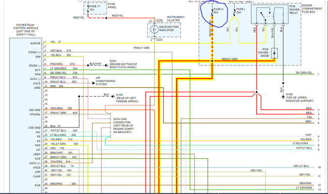

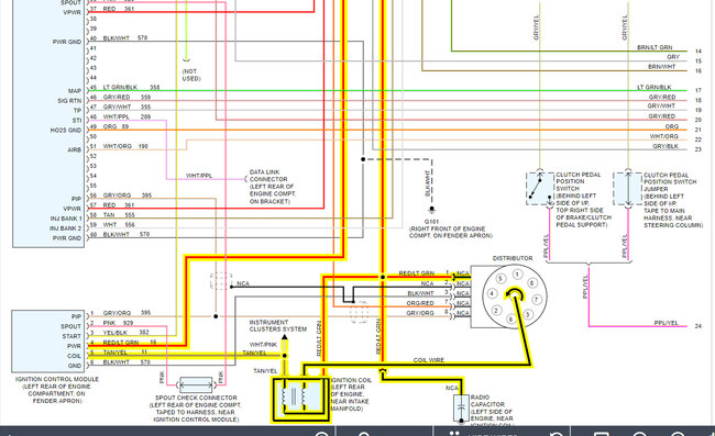

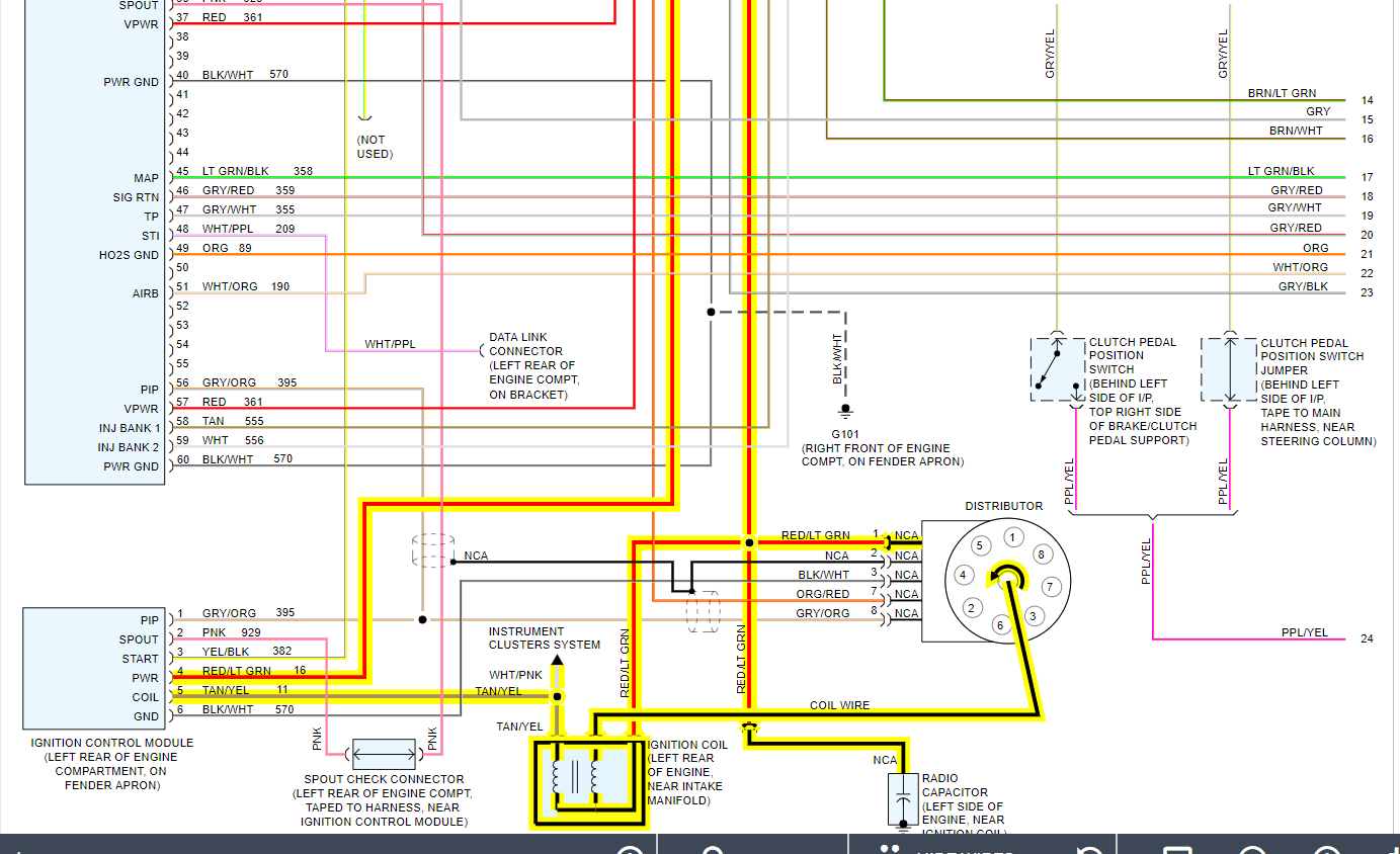

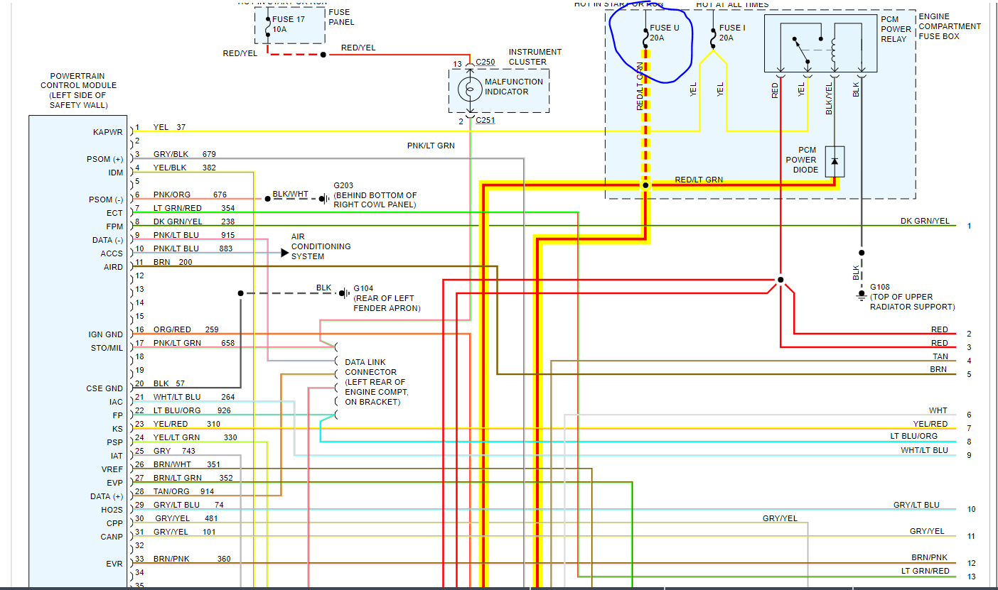

I have no spark on the coil my truck won’t turn on not sure.
Wednesday, April 7th, 2021 AT 2:55 PM
MECHANIC
52,796 POSTS
Good afternoon,

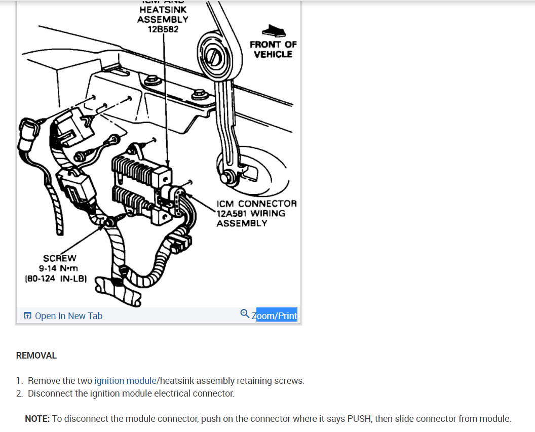

I attached a wiring diagram for you. Check for power to the positive side of the coil with the key on.

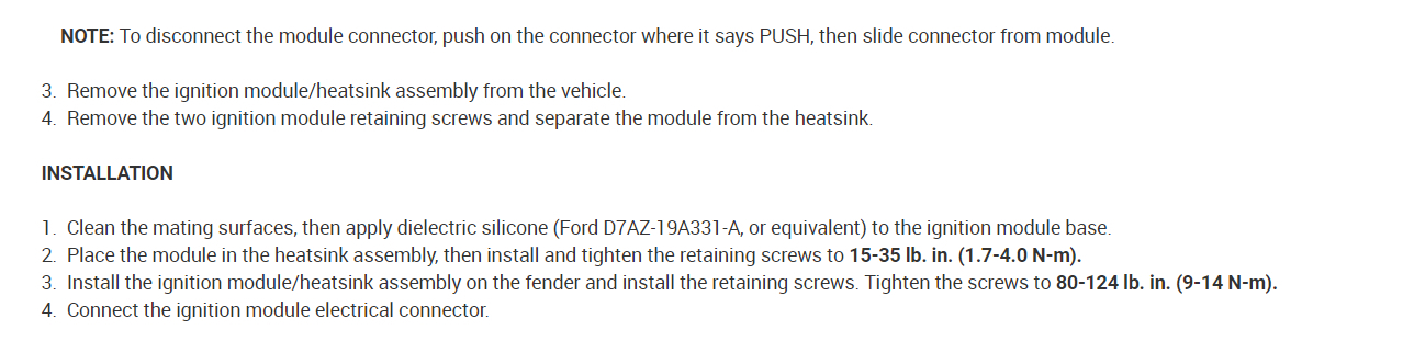

You may have a bad ignition control module which was very common. I attached the procedure for you to view below.
