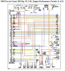

My '96 Toyota Camry rolls over like a champ but has literally no spark. We've replaced the distributor, ignitor, fuse and relay boxes, relays, fuses, coil, and checked every inch of wiring under the hood by testing it. The crank sensor pulley and computer test out fine. There's fuel coming through but no spark to fire it up.
We've been fiddling with this thing for weeks and still no difference. Please, please, PLEASE someone help me. We're willing to try anything.

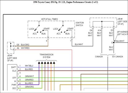

Car stalled at hwy speed, was able to restart 1x with repeated cranking, stalled immediate and am now troubleshooting cold wiithout spark and code 1300; CPS, and pick-up sensor test within range as well as coil; Did try new coil, and 2nd igniter(used) with no result; Power at coil and igniter; Distributor turns freely; Have checked connections and all appear ok. Do have multimeter and test light ; Tested negative side of coil with light while cranking and saw only dim light, no pulse; Have not checked igniter plug for pulse; Pick-up sensor plug has 2 pin connector; Igniter outer wires w,wr I believe are igt and igf signal; Is it possible for me to get a good test for igt signal from plug? and also good test at pick-up plug to confirm voltage? Thanks, Ray

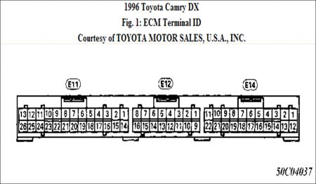

DOCFIXIT
  • 18,828 POSTS
Hi
try these tests

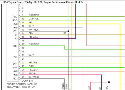

Disconnect Black 5 pin igniter connector acess ECM behind glove box. With ignition on measure voltage between ground and term. # 3 white/red wire at ECM E 11 connector. Voltage should be 4.5 to 5.5V if not replace igniter if not replace ECM.
Next test Back probe trem. #20 white wire at ECM 11 and ground while cranking if voltage is not .1 to 4.5 replace ECM
Hope this helps

Thanks for prompt reply; I did check voltage at ECM with igniter connector unplugged and all else plugged and got 5V #3 and .6 #20 while cranking. All components under hood are OE and have not been able to check air gap on distr, as I do not have proper guage. Thanks, Ray

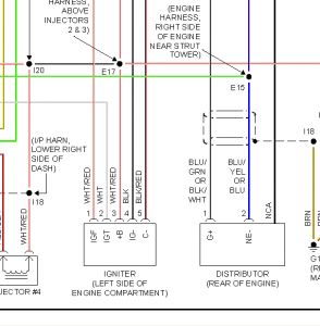

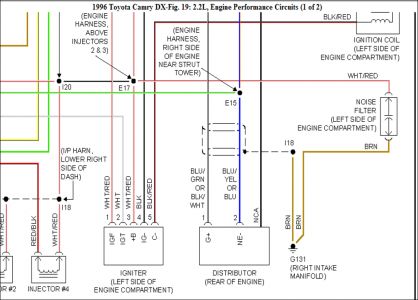

Check for open or short to ground on these two circuits
IGF on ECM connector E12 terminal 3 white/red wire and IGF on igniter term 1
IGT on ECM connector E12 term 6 white wire and igniter term 2

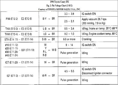

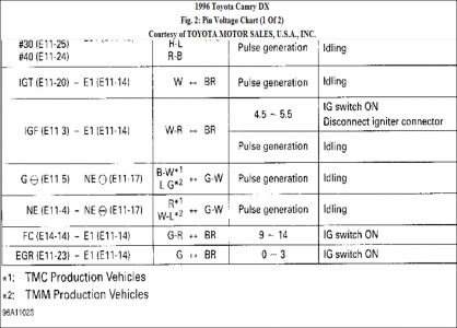

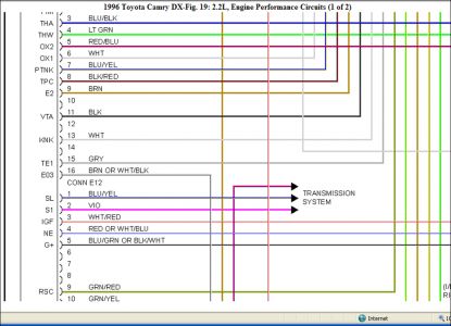

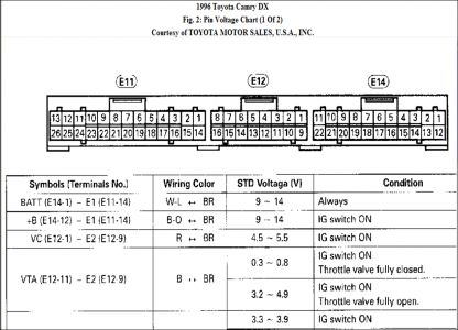

KHLOW2008
  • 41,814 POSTS

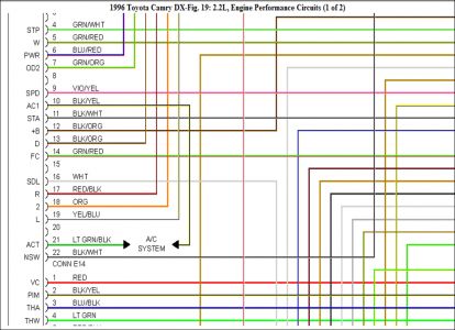

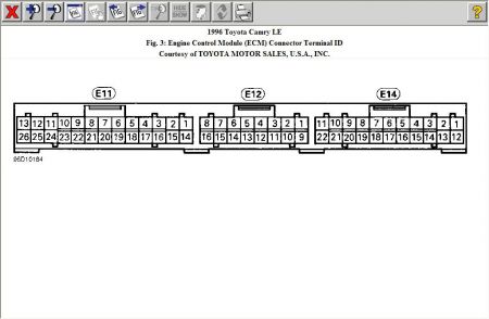

Hi Ray, Sorry for the delay in replying. Yes, seems the ECM or its wiring is at fault. I do have the completed diagnostic procedures her, go through them again and see if you get any different results. DTC P1300 - IGNITER CIRCUIT MALFUNCTION CAUTION: If ECM replacement is instructed in following testing, always ensure ECM connectors and ground circuit are okay. If either are suspect, repair and repeat testing to confirm ECM malfunction. Circuit Description The ECM uses pick-up coil input signals to switch primary ignition circuit on and off. Primary circuit is turned off when ECM delivers a signal to igniter on the IGT wire, causing ignition coil to fire spark plug. After delivering a command to turn off primary circuit on IGT wire, the ECM monitors IGF circuit to ensure primary switching occurred. DTC is set when there is no IGF signal to ECM for 4 consecutive IGT signals during engine operation. Possible causes are: IGF or IGT open or short circuit from igniter to ECM. Igniter ECM Diagnosis & Repair 1. Check for spark at misfiring cylinder. If spark is present, go to next step. If spark is not present, go to step 4 . 2. Check for open or short in IGF circuit between ECM and igniter. Igniter is located near left shock tower. See appropriate wiring diagram in WIRING DIAGRAMS. Repair as necessary. If circuit is okay, go to next step. 3. Disconnect Black 5-pin igniter connector. Access ECM behind glove box. Turn ignition on. Measure voltage between ground and terminal No. 3 (White/Red wire) at ECM "E11" connector. See Fig. 3 . If voltage is 4.5-5.5 volts, replace igniter. If voltage is not 4.5-5.5 volts, replace ECM and retest.
https://images.2carpros.com/forum/automotive_pictures/192750_ECM96CAmry_1.jpg
4. Check for open or short in IGT circuit (White wire) between ECM and igniter. Repair as necessary. If circuit is okay, go to next step. 5. Access ECM behind glove box. Locate ECM "E11" connector. See Fig. 3 . Backprobing ECM connector, measure voltage between ground and terminal No. 20 (White wire) at ECM "E11" connector while cranking engine. If voltage is .1-4.5 volts, go to next step. If voltage is not .1-4.5 volts, replace ECM and retest. 6. Disconnect Black 5-pin igniter connector. Backprobing ECM connector, measure voltage between ground and terminal No. 20 (White wire) at ECM "E11" connector while cranking engine. If voltage is .1-4.5 volts, go to next step. If voltage is not .1-4.5 volts, replace ECM and retest. 7. Turn ignition on. Measure voltage between ground and terminal No. 3 (White/Red wire) at igniter wiring harness connector. See Fig. 8 . If voltage is 9-14 volts, go to next step. If voltage is not 9- 14 volts, check and repair igniter power source circuit. See appropriate wiring diagram in WIRING DIAGRAMS article.

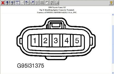

https://images.2carpros.com/forum/automotive_pictures/192750_IgniterTerminal96Camry_1.jpg

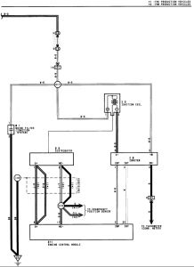

8. Check for an open or short in wiring harness between ignition switch and ignition coil, and between ignition coil and igniter. Repair as necessary. If wiring is okay, go to next step. 9. Check ignition coil. See IGNITION CHECKS (DISTRIBUTOR TYPE IGNITION SYSTEM) in BASIC TESTING - 2.2L article. Replace coil as necessary. If coil is okay, replace igniter.
