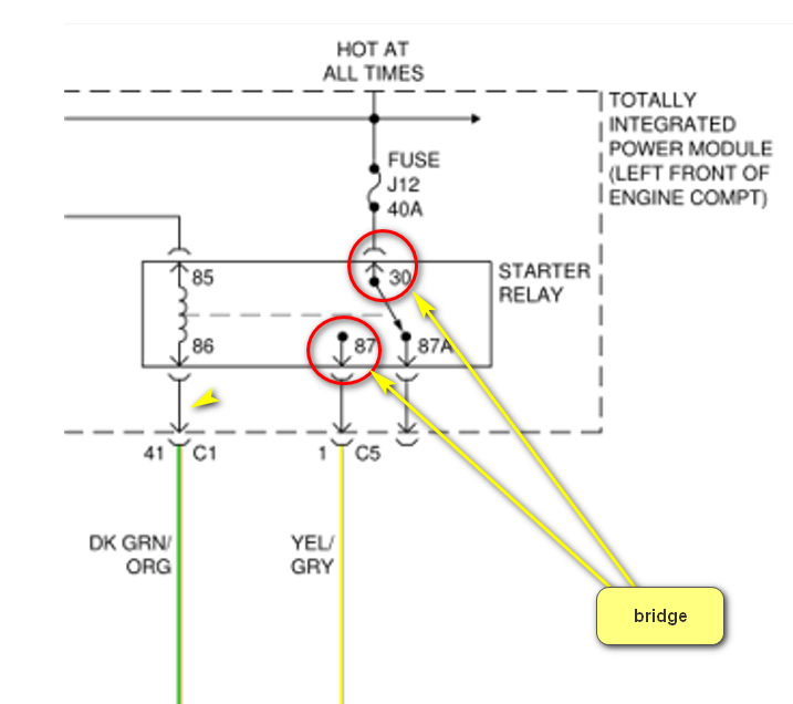

I seem to have confused terminals 85+86.

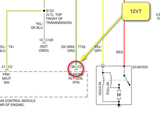

Terminal 86 is the 12V activation from the PCM, dark/green/orange wire from connector C3 pin 38 at the PCM. The TIPM is switching a ground at terminal 85 when cranking.
The voltage from the PCM at pin 38 is not enough.
I would suggest to check directly at the PCM, pin 38, when cranking/key on if 12V is given there. See image below
If it is then we know that the PCM is outputting the correct voltage.

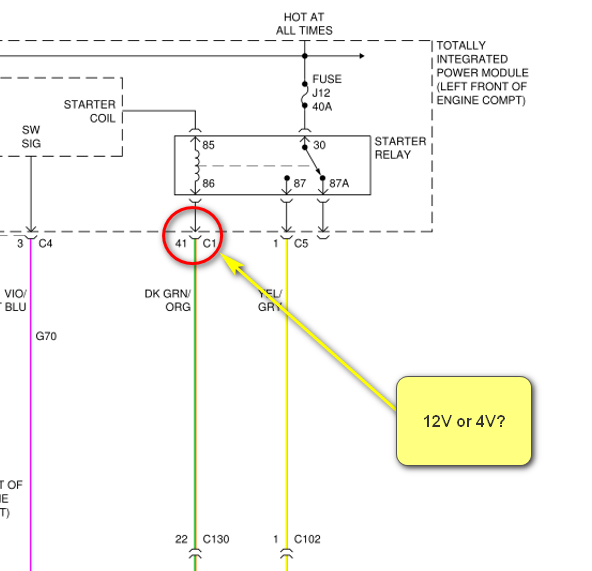

Next check if 12V is given at the TIPM, connector C1 pin 41. Image 2 below
If 12 v is given at this terminal then this proves that the wire is intact.
If the voltage at the TIPM pin 41 is only 4V then this shows that the wire has a high resistance and needs replacing.
If 12V is given at pin 41 and only 4V given at terminal 86 then this shows that the TIPM is bad
Cheers, Boris

Thanks for getting back to me. Today, I took off the PCM C3 connector and did a voltage reading directly to pin 38 with key turned to run/start- No volts? I'm thinking this has something to do with the P0750 code? What are your thoughts?
Thursday, June 9th, 2022 AT 6:16 PM

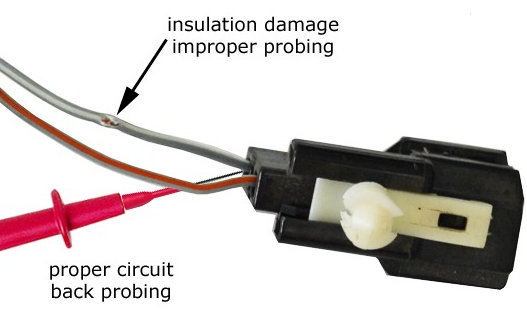

The PCM connector will have to be connected to the PCM as the PCM will not power up. You will need to back probe the connector at pin 38.
I suggest you use a thin metal pin to gain access and then use the voltmeter and check voltage at the pin while cranking.
Do not pierce the wire, back probe into the connector.
See image below.

Yes, okay. I was not sure. I have some probes I can use. I'll check that 38 wire with the harness connected and get back to you. Thanks

Today, I back-probed wire 38 and with key turned to run/start I got.001 volts? So, I started thinking about the P0750 code and took off the PCM C4 connector and started doing ohm on shift solenoids- I forgot which ones, but the first test showed OL. I thought, okay and tested another and got OL and the third one, again OL? I then went underneath and disconnected the TSS harness on side of transmission (very tight space). Took it off and was thinking to hook up the air compressor and try to shoot some air in the pin area of the TSS. I applied air and noticed a few small bits of rock or road debris come flying out. When I went to plug the connector back in, it for some reason was not wanting to go in completely? I pulled the harness side back out and tried again, same resistance, so after the fourth time, I went looking for my inspection mirror and of course, could not find it. Ended up using the wife's small make-up bad mirror and looks like a small plastic piece (which there were a few) that I'm assuming is just a guide to align the pins to the sockets of the harness side was bent? So, I got out from under the truck as other things had to be done around the house. Is it possible that the small plastic piece could have been causing a weak connection? What are your thoughts?

I sounds like that the pin you used to back probe the wire at pin 38 did not make proper contact. You had a reading of 4V+ at the starter solenoid terminal 86 before. Have you tried to bridge terminals 30+87 at the starter solenoid socket? With ignition on this should start the motor. Ensure that transmission is in park/neutral before trying this

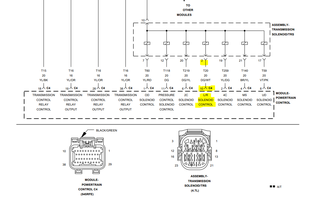

Code P0750 will not cause a starting issue, it will put the transmission in limp home mode.
Did disconnecting, cleaning and then reconnecting the transmission connector fix P0750?
A good discussion regarding P0750 can be found here:
https://www.ramforumz.com/threads/limp-mode-with-p0750.174265/
Testing for P0750 is done at PCM connector C4(black/green), pin 10, and transmission connector pin 2. Test wire pin to pin for possible open circuit or high resistance, more than 5 ohm.
This DTC is strictly an electrical fault and cannot be caused by any internal transmission failure other than an open in the Transmission Solenoid/TRS Assembly. If the Transmission Solenoid/TRS assembly is in need of replacement †do not replace the Valve Body.

The weather here has been hit and miss the past few days. When I tested pin 38 at C4 connector, I could not figure out how to disassemble the harness body, so I pierced the wire as close to the PCM as I could and tested it and got the 0 Volts. I did in fact, jump the relay sockets 30 to 87 and the starter did turn, so I know the starter works fine and the yellow/grey starter solenoid wire is good. I have not tried to re-connect the TSS connector back on due to the weather. Since it is still disconnected, before I re-connect, I'll do what you mentioned above and check ohms from C4 pin 10 to TSS pin 2 and see what I get. I will let you know as soon as this is completed. I again appreciate the help and the diagram you sent. Thanks again Boris.

I did ohm check from PCM C4 Pin 10 to TSS Pin 2 and got 00.5 Ohms. So, that tells me the wire has integrity.

Theory of operation to set P0750
The Transmission Control System uses six electronically controlled solenoids that allow hydraulic fluid to be applied to various friction elements (clutches), which enables the gear requested. The continuity of each solenoid circuit is periodically tested. Each inactive solenoid is turned on for a few milliseconds, then off. Each active solenoid is turned
off for a few milliseconds, then on. This pulsing of voltage to the solenoid causes an inductive spike which can be sensed by the Transmission Control System. If an inductive spike is not sensed by the Transmission Control System during the
continuity check, it is tested again. If the test fails three consecutive times, the appropriate Diagnostic Trouble Code (DTC) is set. If the solenoid test is run in response to a gear ratio or pressure switch error, one failure will result in setting the appropriate DTC.
Possible causes:
Related TCM Power Input DTCs Present.
(T20) L/R Solenoid Control Circuit Shorted to other Circuits.
(T20) L/R Solenoid Control Circuit Open.
(T20) L/R Solenoid Control Circuit Shorted to Ground.
Powertrain Control Module (PCM).
Next test at the transmission connector would be to check if any of the other pins has continuity (short circuit) to pin 2. Also test the pins for a possible short to ground or positive.
Test pin 2 to pins 12, 17, 19, 20 and 21.
If no short to any other pin can be seen, then you most likely have a failed transmission solenoid pack.
