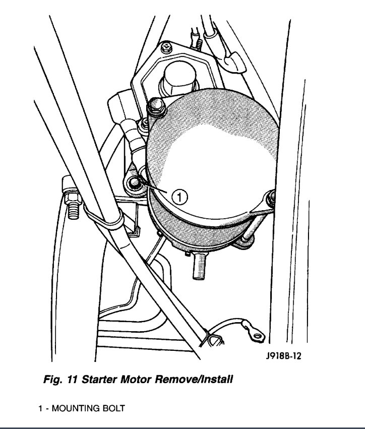

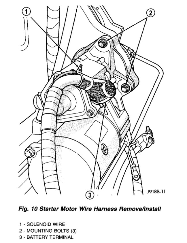

What size or type wrench is needed to remove the three bolts on a 2500 diesel pick up starter?
Friday, August 31st, 2007 AT 2:33 PM
5 Replies
MERLIN2021
  • 17,250 POSTS
The bolt size is 13mm. Here is a guide to help you see what you are in for when doing the job and diagrams to show you what it will be like for your truck:
INSTALLATION
1. If equipped, position aluminum spacer to rear of starter.
2. Position starter motor to engine.
3. Support starter and loosely install three mounting bolts.
4. Tighten 3 bolts to 43.4 Nm (32 ft. lbs.).
5. Position wiring eyelets to starter studs and install nuts. Tighten small nut to 6.2 Nm (55 in. lbs.). Tighten large nut to 13.6 Nm (120 in. lbs.).
6. Install protective rubber boot over stud.
7. Lower vehicle.
8. Connect battery cables to both batt

How do I get the to the top starter nut to get it off? Frame, exhaust, transmission housing, and fuel rails in the way. Cannot get a socket or combination wrench in to loosen it.
+2
Friday, August 3rd, 2018 AT 4:16 PM (Merged)
  • 110,192 POSTS
A long extension through the inner fender. Make sure the battery is disconnected.

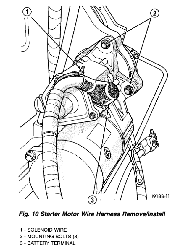

Replace starter in a 2500.
  • 75,992 POSTS
Disconnect battery ground cable(s), then remove wiring connector from starter.
Remove starter mounting bolts, then the starter.
Reverse procedure to install, noting the following:
Torque B+ terminal nut to 6-9 ft-lbs and solenoid terminal nut to 45-65 in-lbs.
Torque starter mounting bolts to 50 ft-lbs.
