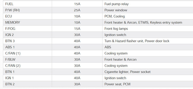

Fuel pump went bad. I changed it and now there is no power to it. I can bypass the fuel relay and it works. checked fuses and cut off switch, and no power to either side of switch.

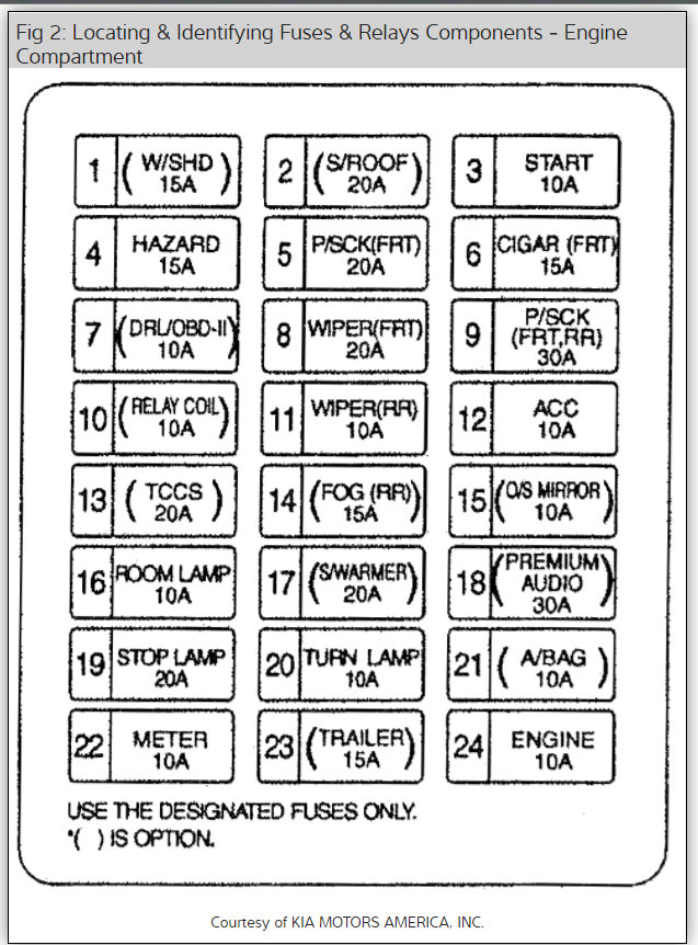

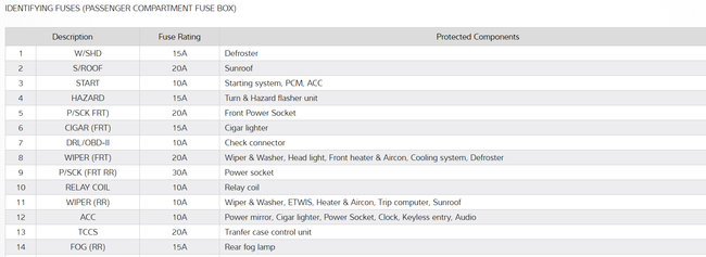

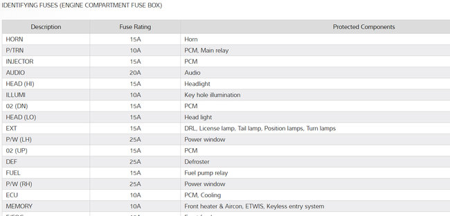

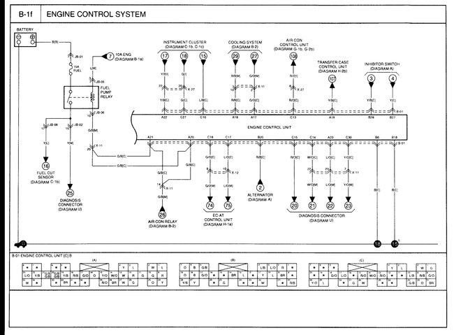

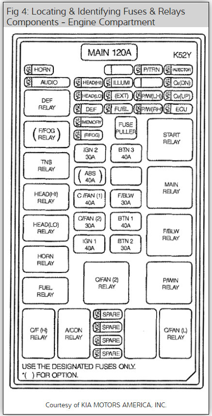

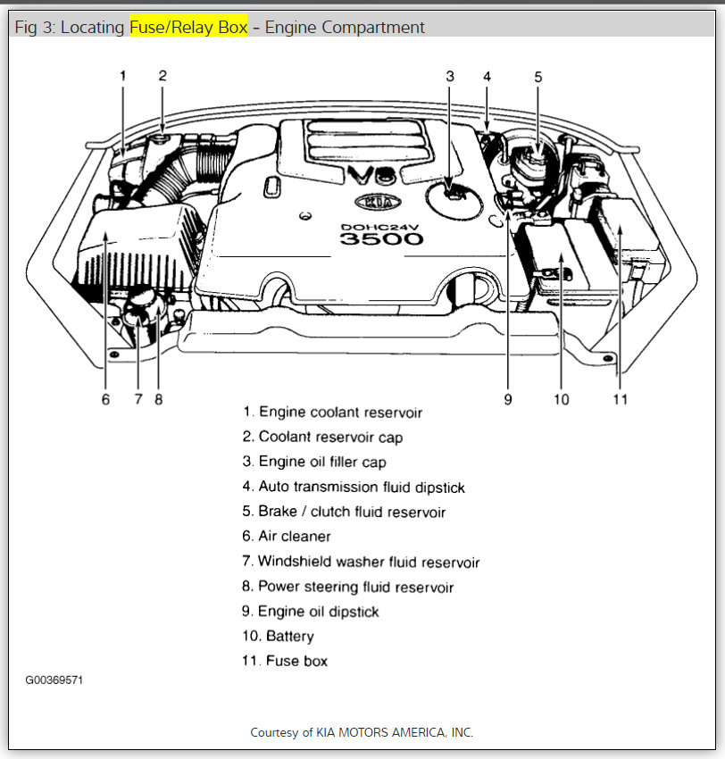

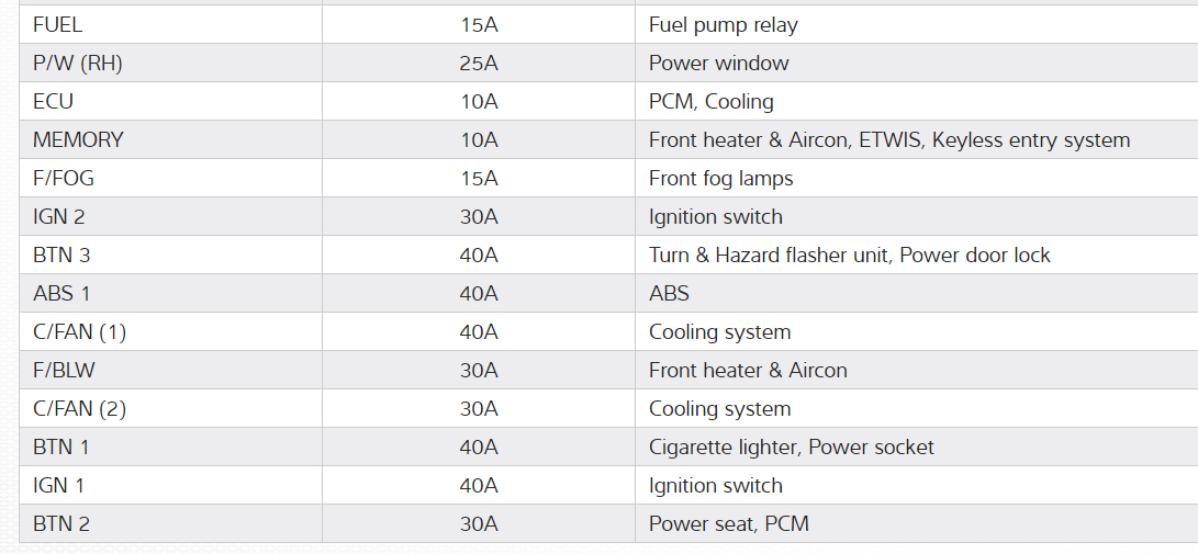

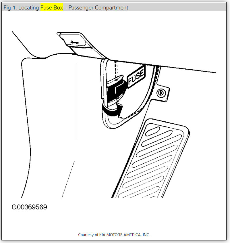

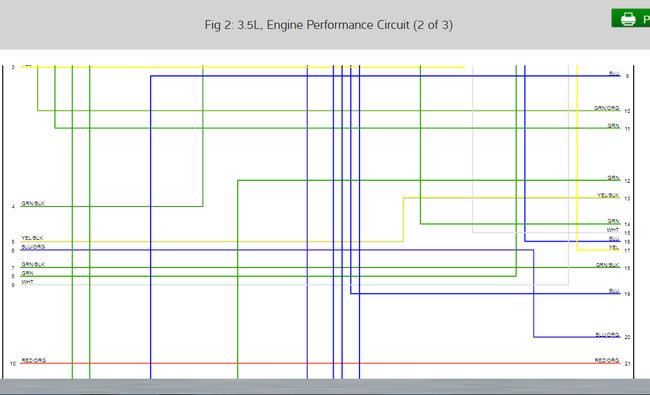

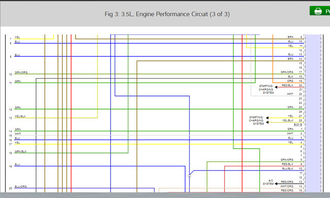

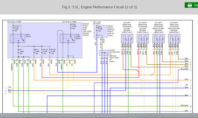

Do you realize that is only powers for two seconds when the key is first turned on? You need two people to test this properly. If so lets check the fuses first here is a guide to help check the fuses and the fuse location below.
Check out the diagrams (Below). Please let us know what you find.
Nov 10, 2017 at 10:19 AM

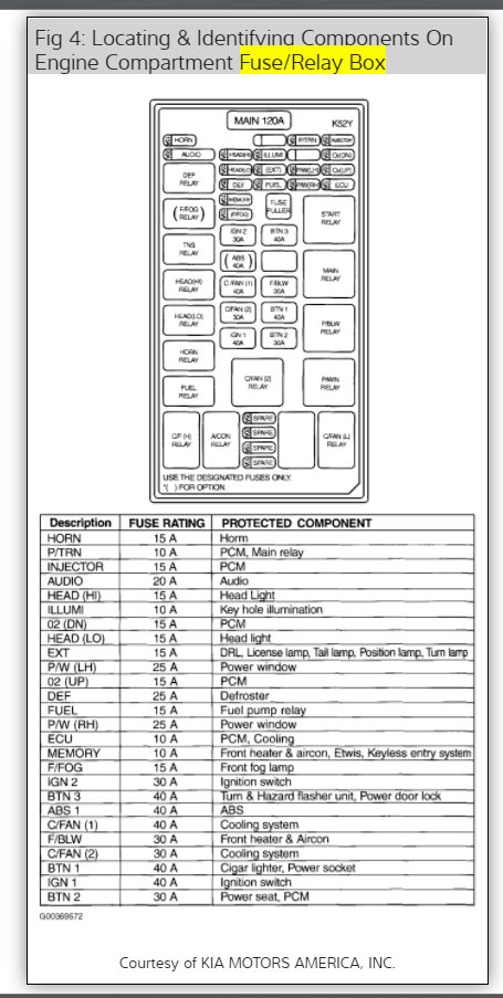

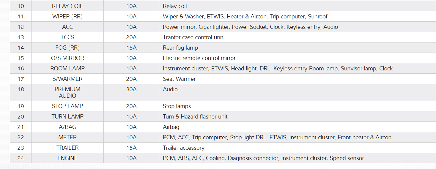

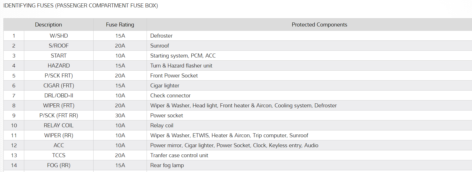

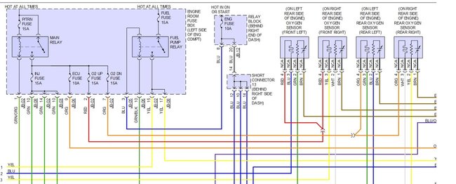

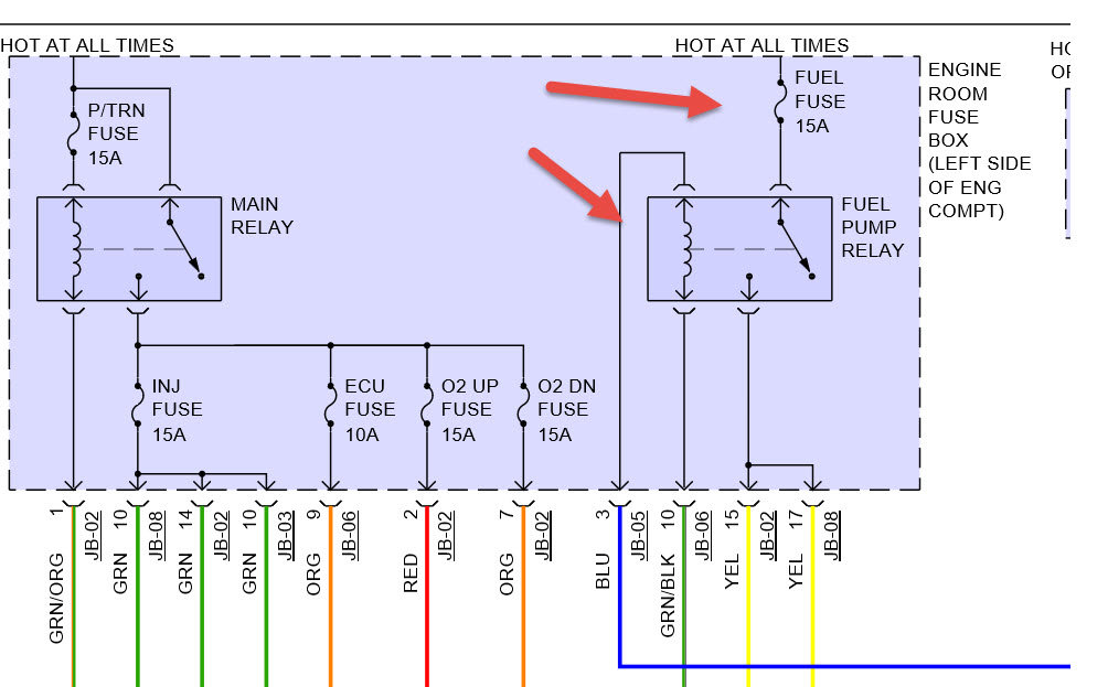

It sounds like you may have a fuse (fuel fuse) that could be out. Lets check for power at the fuel pump relay and then test the relay.
Here is a guide to show you how to do the test:
and
Please recheck the fuses as well.

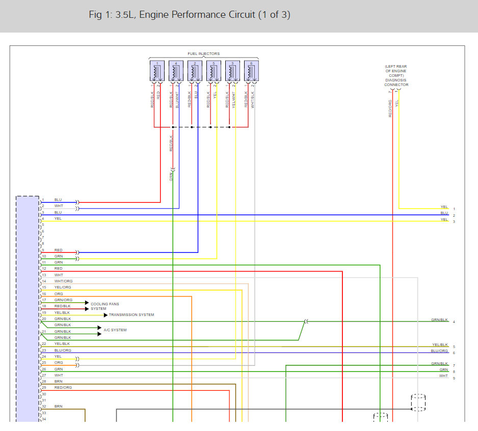

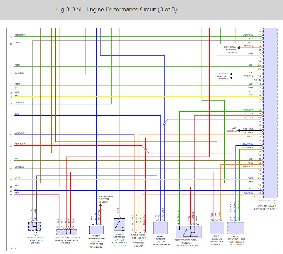

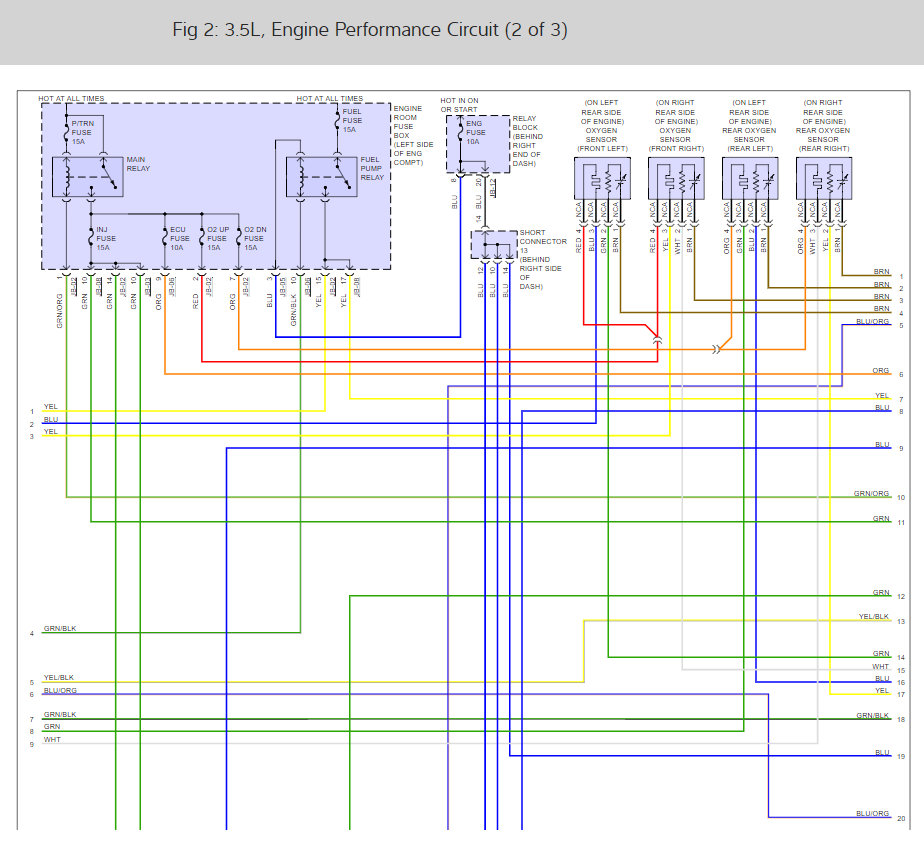

Here are the fuse panel and engine with fuel pump wiring diagrams so you can do some simple tests (below).
Nov 13, 2017 at 7:05 AM

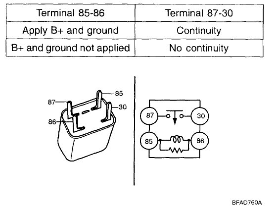

Ok 30 85 when the switch is off I have 12volts and when the switch is on only have 3.5and 30 86 is hot saltines don't have anything from the rest this is with the relay out,u have tryed changing them no difference
Nov 13, 2017 at 7:22 AM
JASON WATSON
  • 16 POSTS
I meant 30 86 is hot al time

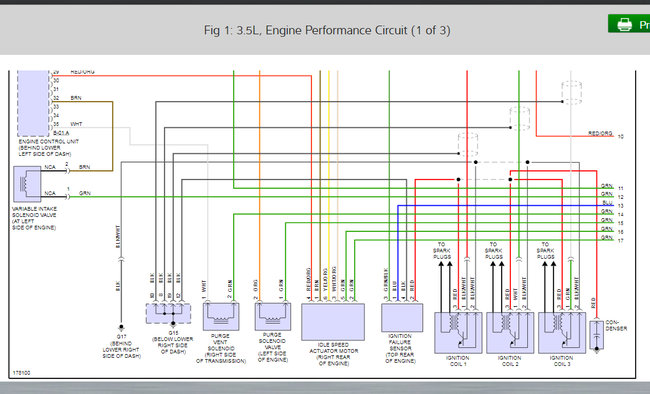

It sounds like the computer is not triggering the relay to operate. Can you check the ignition system for spark? This will tell us if the computer is seeing the engine rotation.
Here is a guide.

Okay, I checked the fuel relay I got from 30-86i have twelve volts 30-85 I have. 24 85-86 I have twelve. no difference after crank up and it sits there with the switch on.
Dec 28, 2020 at 4:25 AM (Merged)
STEVE W.
  • 15,260 POSTS

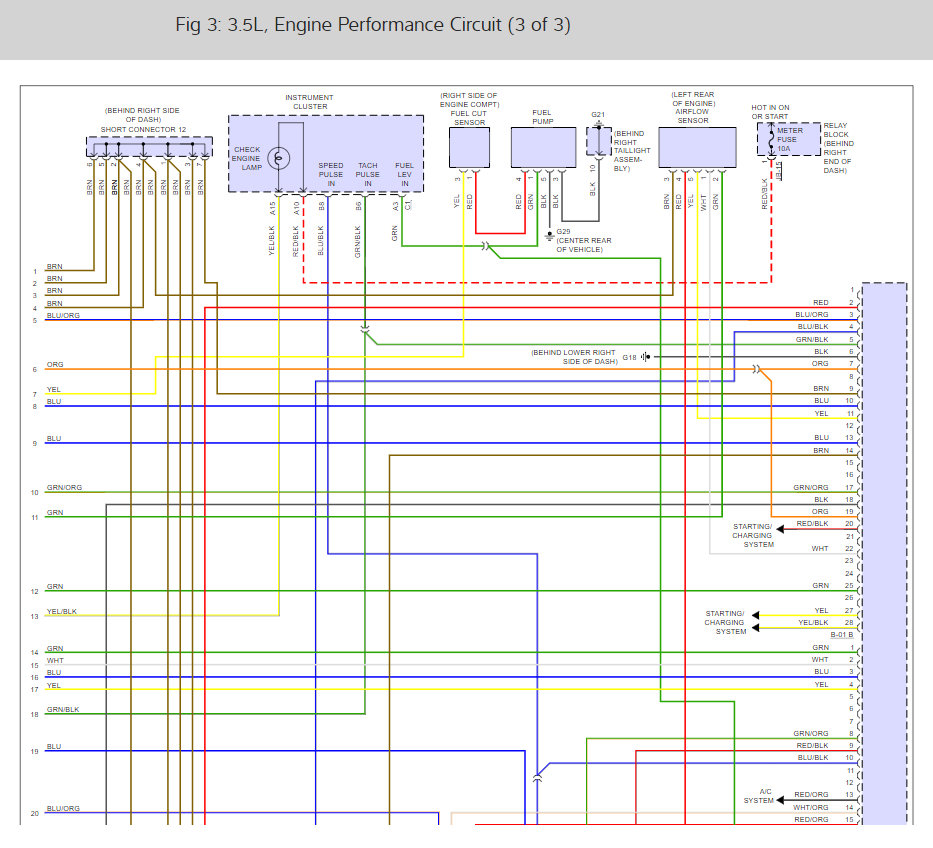

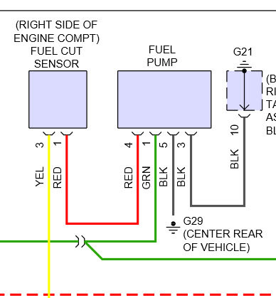

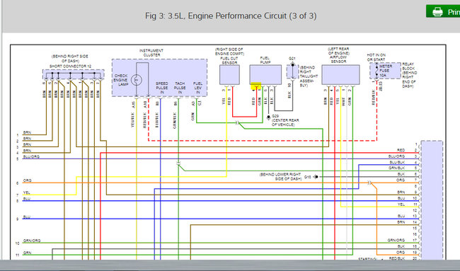

Pin 87 should be the power feed from the relay to the pump. Pins 85/86 are both sides of the coil. Pin 30 is twelve volts from the pump fuse.
If you jump from pin 30 to pin 87 in the socket the pump should run if the pump is good. If you want a quick test of the circuit put a test light in as a jumper. If the pump circuit is good the light should turn on.
There is a fuel cut sensor shown in the power line to the pump. That is in the right hand side of the engine compartment with a yellow wire and red wire in its connector. If it fails or opens no power gets to the pump. But other than telling where it is there is no other information in the service information
The pump ground wire is a black wire behind the right taillight.

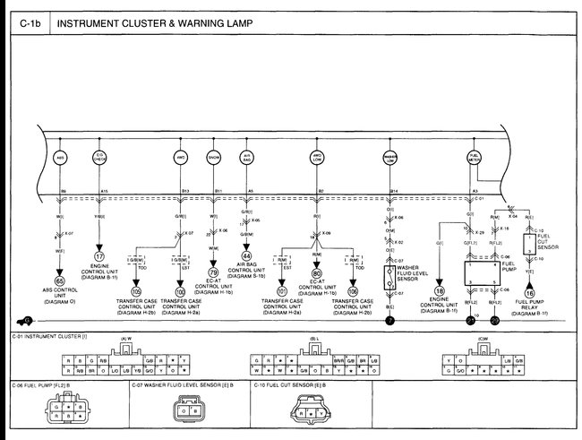

I don't see a blue as pump power, The pump power supply should be a red wire. Then a black for ground.
A full line trace shows the relay fed by the fuel fuse, then out of the relay as a yellow wire to the fuel cut sensor, out of the sensor the power is now on a red wire to the pump.
There should be a Green wire that goes to the fuel gauge from the sending unit in the tank and another Black which is the ground for the fuel gauge.
Green/black stripe, Brown and Red should be the colors on the tank pressure sensor and White and Black for the temperature sensor.
This is assuming that these are correct.

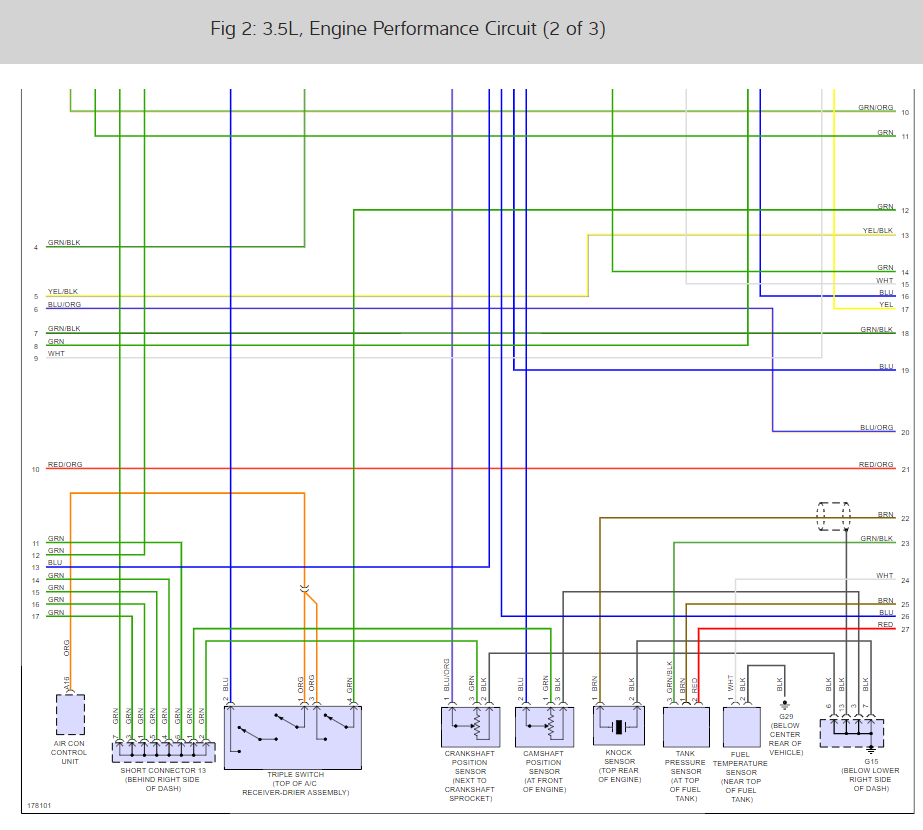

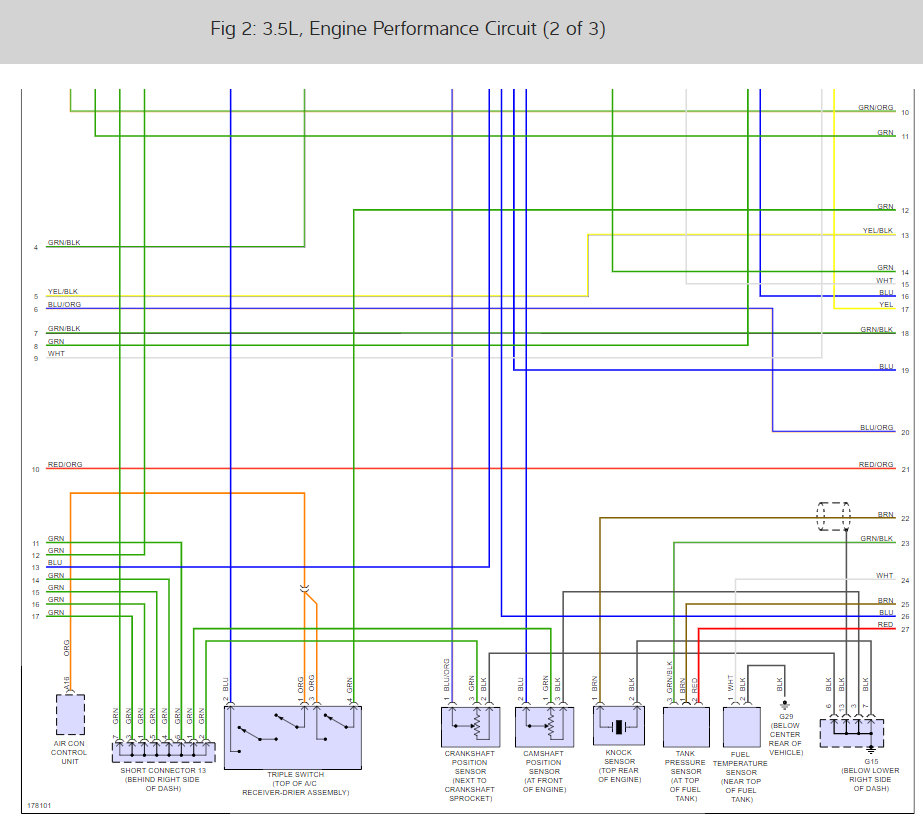

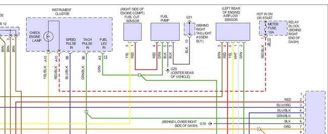

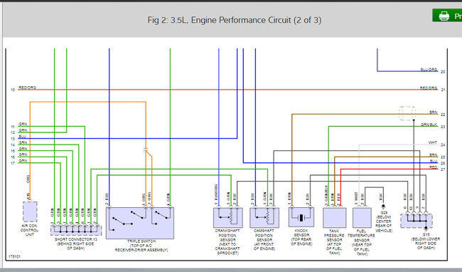

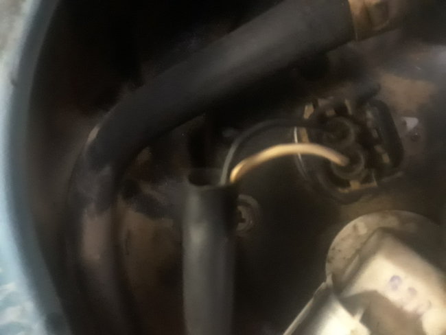

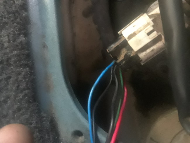

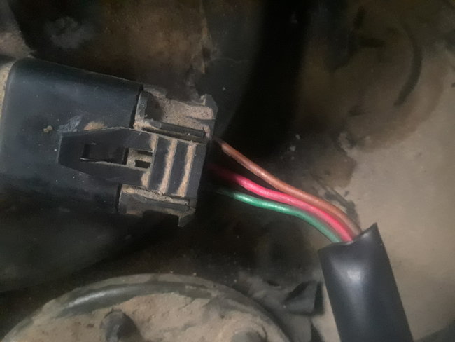

The first pic I have power on green and black ,2nd pic I have power 3rd power there to,I don't no I'm lost
STEVE W.
  • 15,260 POSTS
OK in those pictures the first picture is the wiring for the pump and fuel level sensor.
The second picture with the black and white wires is the fuel temperature sender and the third picture is the fuel tank pressure sensor.
Out of those you can ignore the second and third items, they only tell the PCM info, they don't control or work with the fuel pump.
In the first picture, you should have power on the RED wire, it feeds power to the pump.
There will also be power on the GREEN wire as it feeds the fuel level sending unit.
You say you have power on a black wire? Is it the larger black wire on the right next to the green and red wires? If so that is supposed to be a ground wire. If it wasn't grounded properly it will show power. Follow it and you should find it connects to either the middle of the car or runs up and behind the taillight. It is either broken or corroded off. I would simply run a test wire to a good ground and connect it to that wire. The pump should work then.

Fuel pumps are like being pregnant, they either work or they don't. When you turn your vehicle's key on you should hear the fuel pump come on a two or three seconds to prime the fuel system. So, let's see if you are getting battery voltage back to the fuel pump. With the multimeter already measuring the voltage, I need you to have an assistant turn the key to RUN. I want you to have the red lead of the multimeter backprobing pin #4 of the fuel pump connector(Red Wire) and the black lead good metal to metal contact on the vehicle body.I have included the wiring diagrams for your vehicle's fuel pump in the diagrams down below. Please get back to us with what you find out.

check fuse and relay under hood fuse box then check to see if fuel cut sensor is telling pump to come on. See pictures and link.
