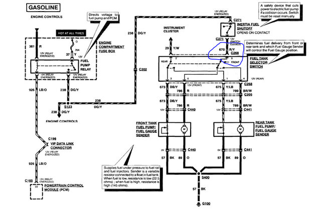

No power on my fuel tank switch to change front or rear tank. I have no power on the switch.

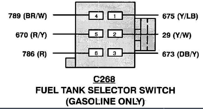

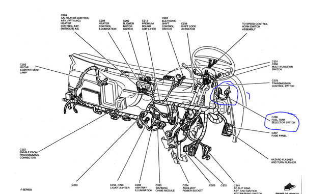

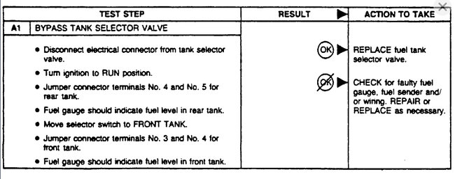

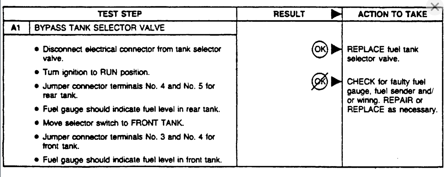

I attached the diagram of the switch for and the testing procedure below. The power comes from the inertia switch.
