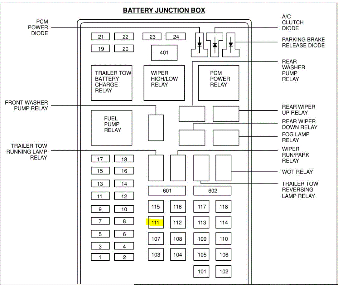

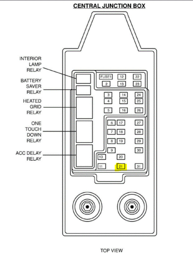

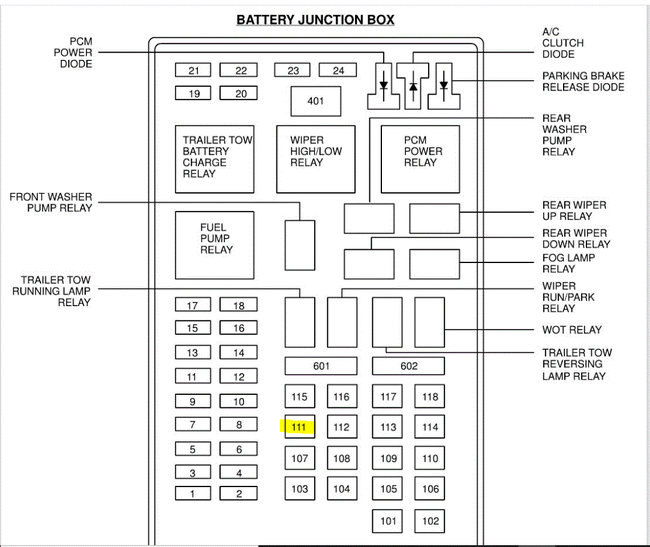

If that doesn't change anything, I need you to check fuse 111 in the battery junction box and fuse 21 in the central junction box. In addition to checking the fuses, confirm there is power to them. Note: Fuse 21 in the central junction box will only get power with the key in the start position, so you will need a helper to do this.

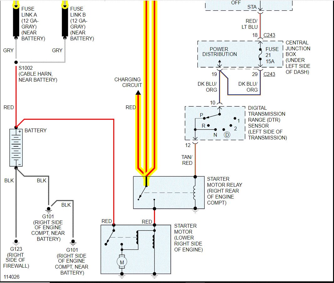

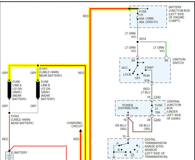

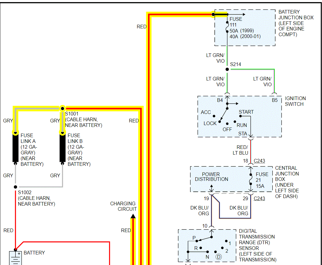

If the fuses check good, I need you to go to the s terminal on the starter. It will be the smaller gauge wire of the two. It should get power when the key is in the start position. If it does and you do have power to the starter direct from the battery (larger wire) the starter is bad.

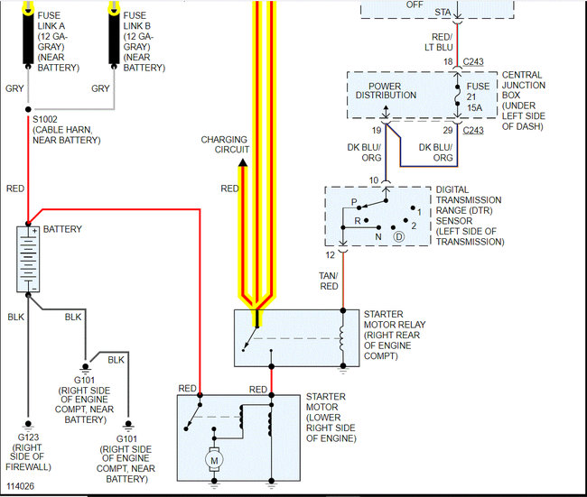

I have attached the wiring schematics below for the starting system for your reference. I had to cut the schematic in two to make them readable, but I did overlap them so you could follow them.

See pics below Pics 3-4 are the fuses. Pic 3 is the underhood box and pic 4 is the central junction box in the vehicle.

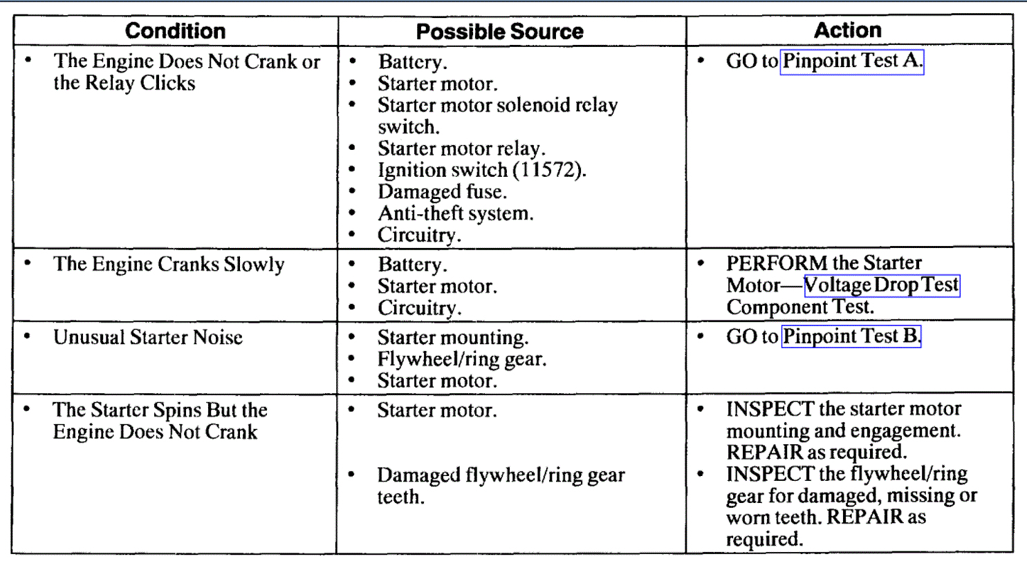

Sounds like you were busy. Do me a favor. Take a look at the attached pic below. Let me know which symptom you feel best describes what you experience. Then, I will get the specific tests you need.
See pic below.

BRANDON CONGER
  • 9 POSTS
It will be the first one I took the starter off and it is spinning it just will not engage and there is only one click coming from the ceiling noyd on the firewall.
Wednesday, July 7th, 2021 AT 1:39 AM
  • 110,192 POSTS
Brandon,
When you say it spins but doesn't engage, it sounds like the bendix is bad. That is the part of the starter which engaged the starter motor gear to the engine flywheel to crank the engine.
When this happens, do you hear the starter motor spinning? Is it possible for you to record what is happening and upload it for me to hear?
Let me know. When I read through the list above, it seems the last thing mentioned is what fits what you are experiencing.

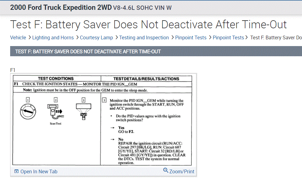

That did not work for a new cables and still doing the same thing. My battery saver relay keeps clicking when I turn the key on and off and when I took it out it was hot.

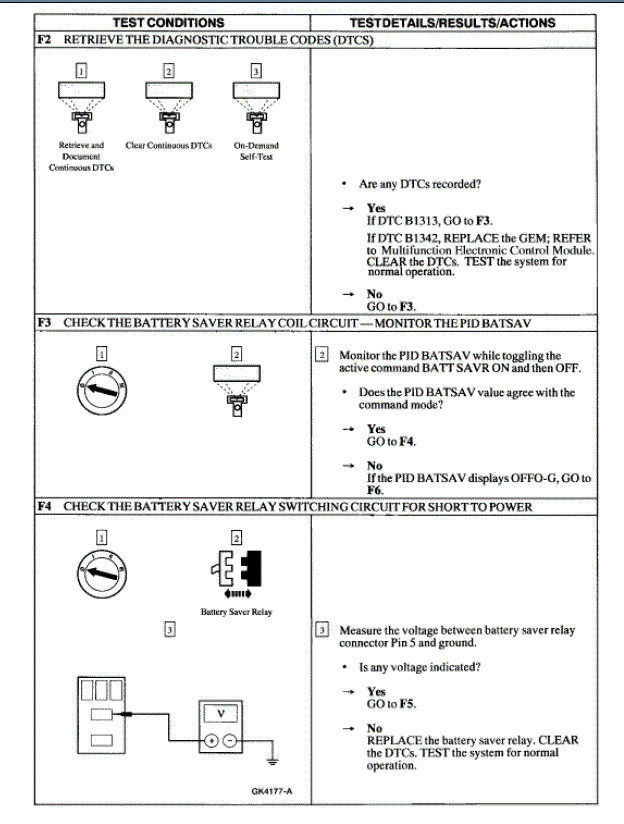

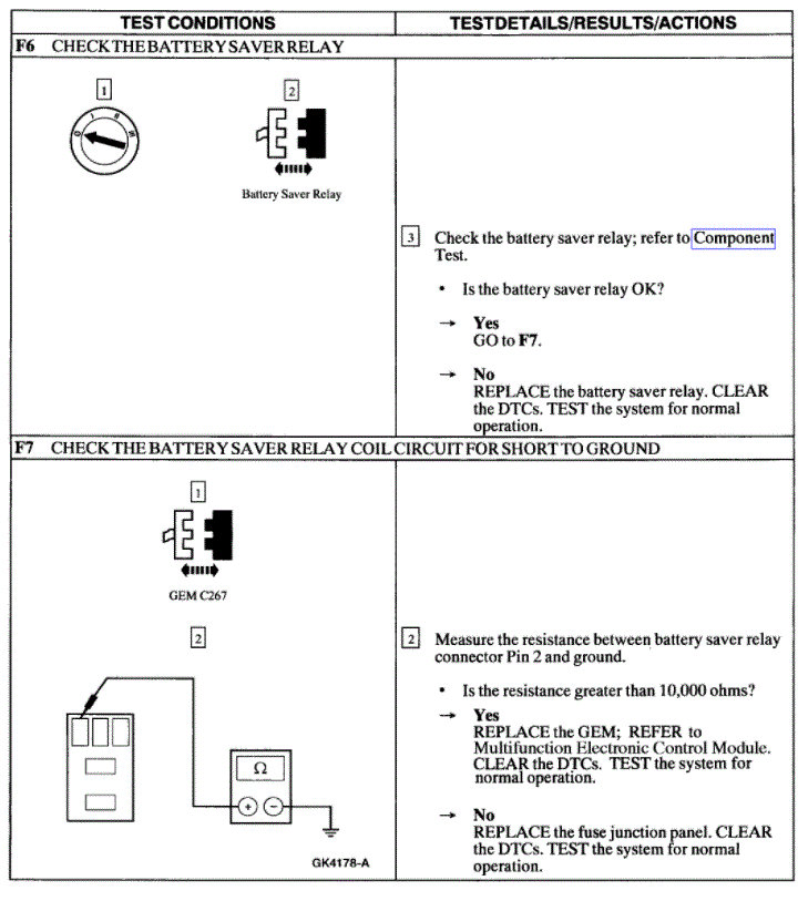

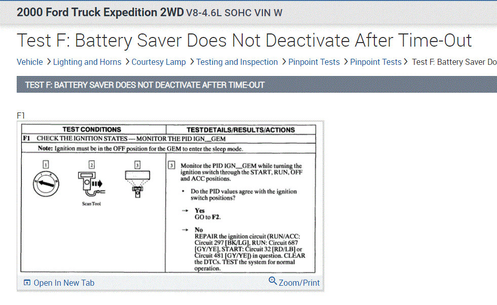

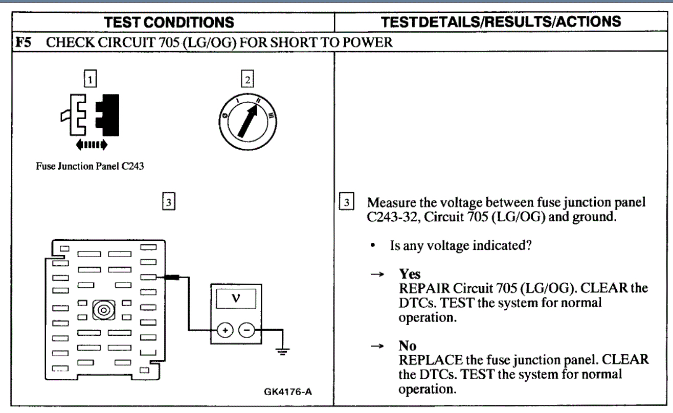

If it is getting hot, it sounds like it isn't timing out. Do me a favor. Take a look at the diagnostics below and let me know if you are comfortable performing them. Something is causing that to get hot and I have a feeling if we determine what it is, the other problems will resolve themselves.

I'm not sure I understand. Are you asking how to test the CAN bus or the battery saver? The battery saver directions are above. If you want to test the can-bus, you simply need a scan tool that can read the system.
Here is a video showing it being done:
https://youtu.be/InIlnsjOVFA
