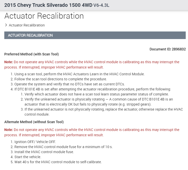

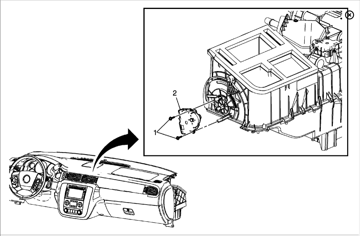

No air flowing to the windshield. Mid and low vents work fine. When selecting the windshield vent on the temperature control panel, air still flows through the middle vents and nothing comes through the top. There is no clicking sound when key in ignition. Cold and hot air work fine. Temperature control works well.
Oct 16, 2019 at 7:04 AM
DANNY L
  • 5,648 POSTS

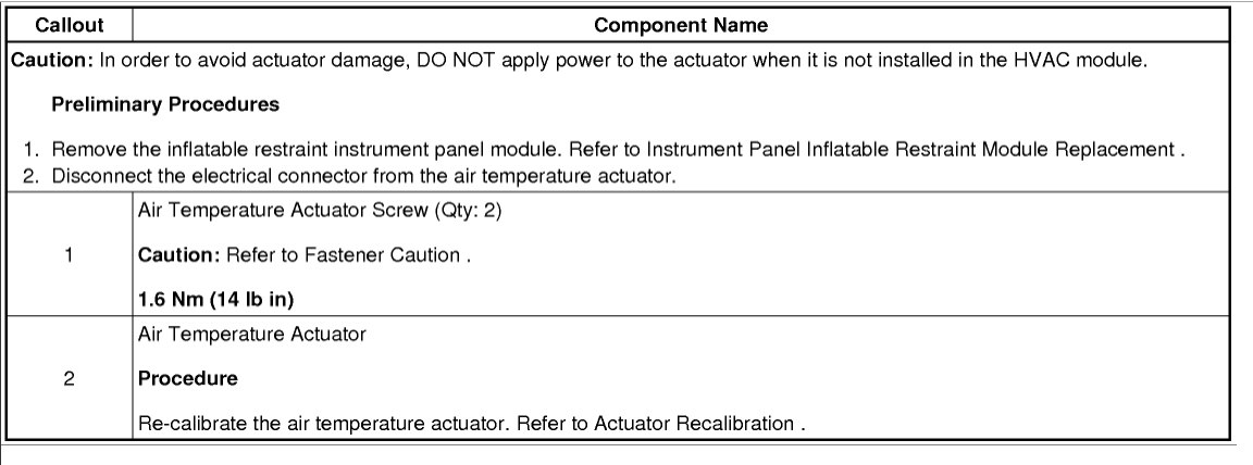

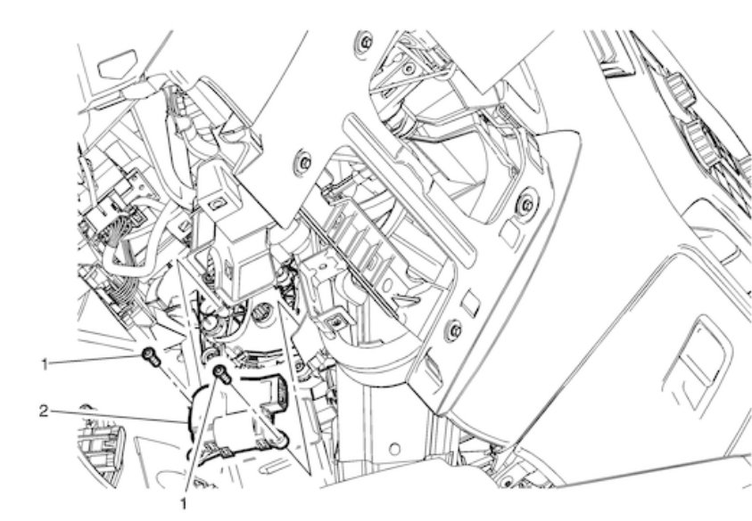

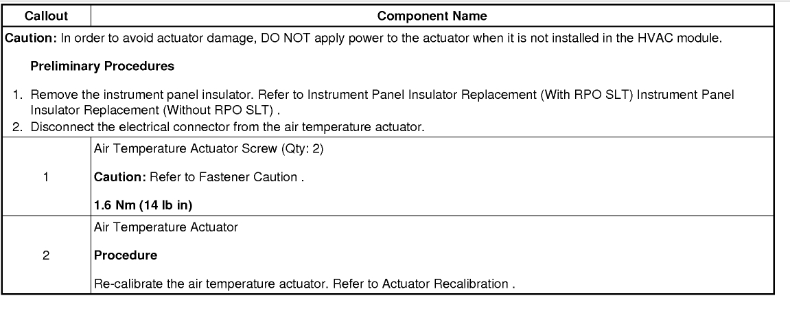

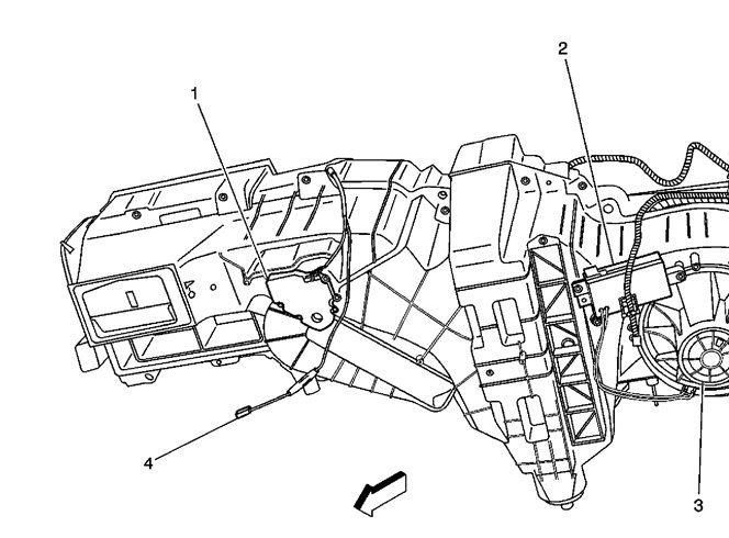

It sounds like you are having an issue with the mode blend door actuator. It's a small electric motor that opens/closes to move air flow throughout the proper air ducts. Here is a tutorial to show what's involved for replacement:
I've attached step-by-step pictures below including its location for your specific Chevrolet truck.You will need a GM scanner to calibrate the actuator after replacement.Hope this helps and thanks for using 2CarPros.
Check out the diagrams (Below). Let us know what happens and please upload pictures or videos of the problem.

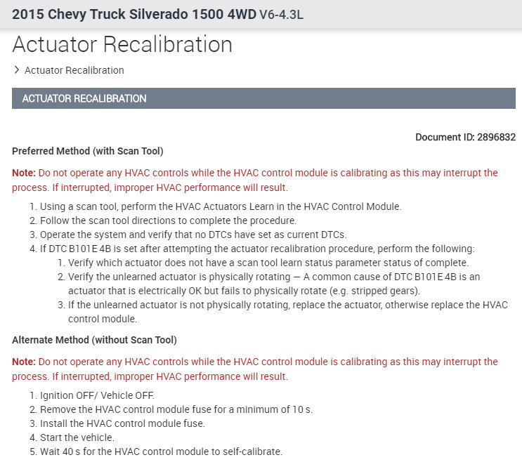

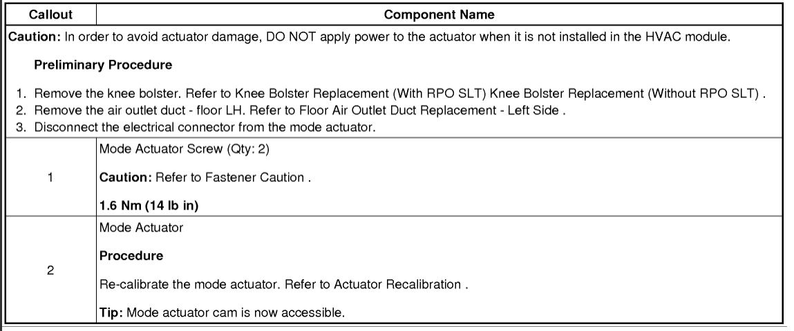

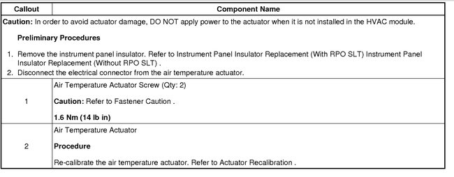

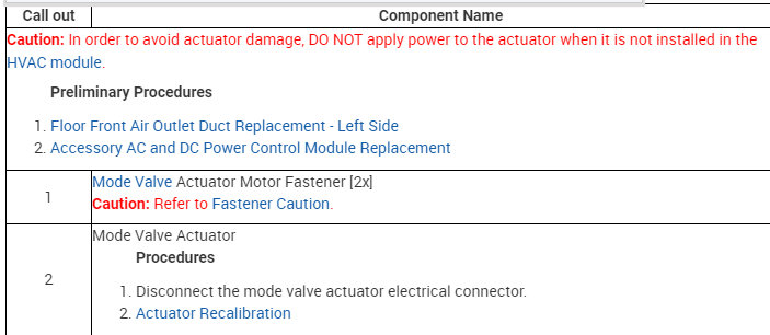

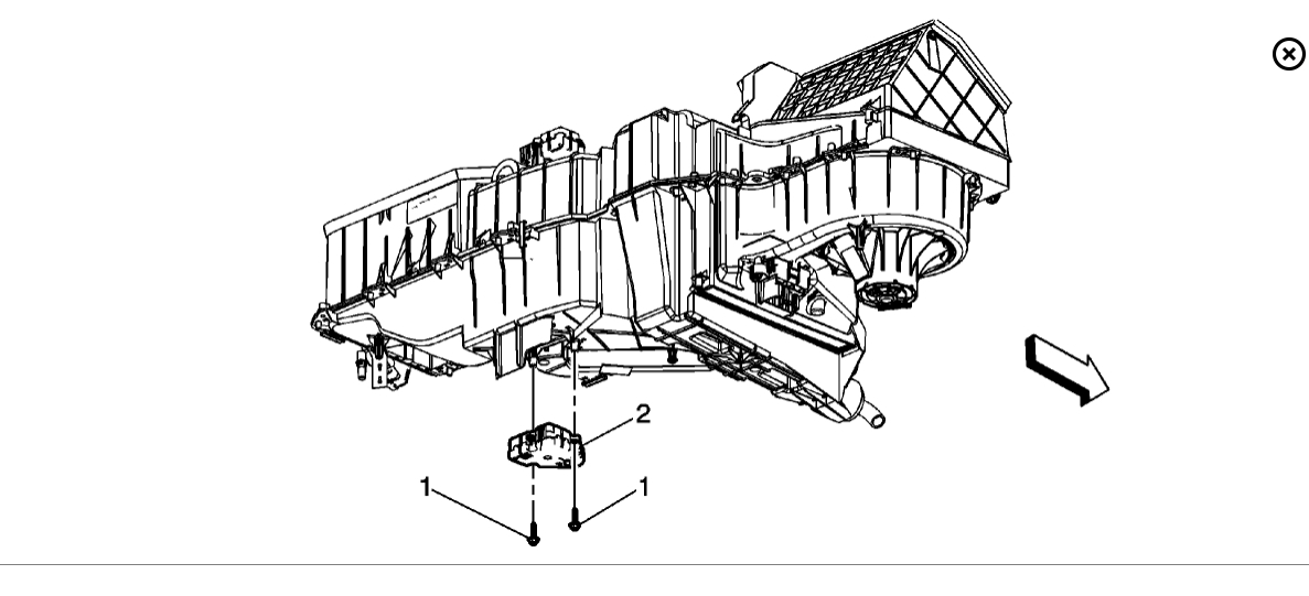

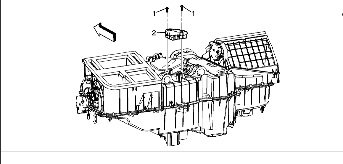

Okay it sounds like you have a mode blend door actuator that is going out. Here is a guide that should show you what you are in for when doing the job.
Here is what it will be like in your car (below)
The diagrams are Mode, Right then Left air blend door actuators. After replacing the actuator the system may need to relearn which can be done by removing the HVAC fuse for 15 minutes.

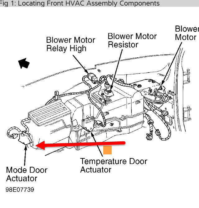

ROY HALL
my control panel will not switch from air to heat only blows out air vents no defrost or heat on floor?
Apr 28, 2021 at 11:29 AM (Merged)
HMAC300
  • 48,601 POSTS

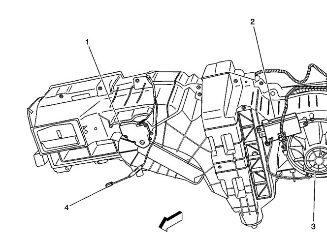

try puling the heater fuse and see if the control will reset. if not you'll have to see if your actuators are getting power to operate. i'll send a generic pic along to show where they are....

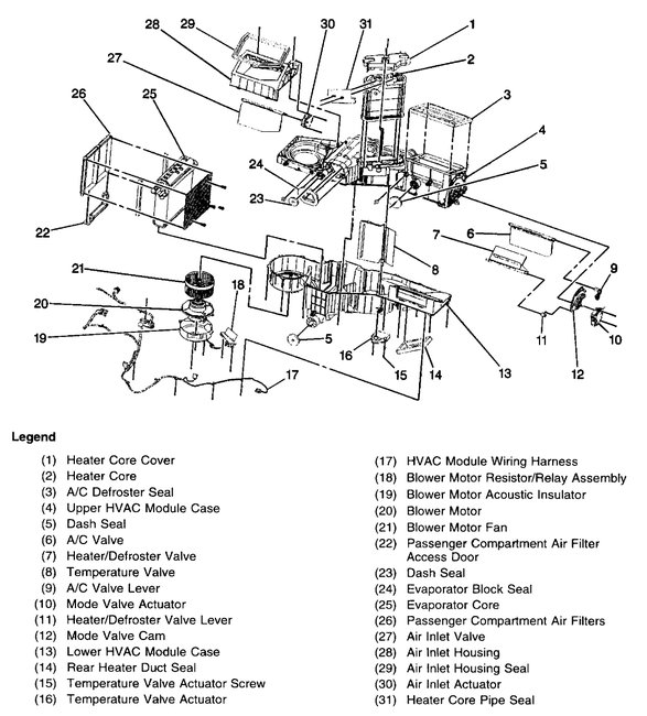

STEVE W.
  • 15,423 POSTS
As the mode doors seem to be working I suspect the blockage is down in the blower area itself, around the squirrel cage. Item 20/21 in the image. I would drop the blower motor out the bottom and see what you find. It is real simple, remove the sound deaden-er cover screws, disconnect the wiring, drop the cover off, release the tab and turn the motor counter-clockwise to disengage it from the housing. Maybe put a plastic bag under it, just in case it has debris in it. With the blower out you can use a light and a vacuum hose to clean out the housing of whatever you find.

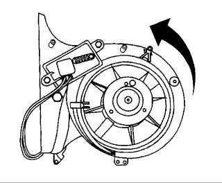

PHIL MORARRE
  • 6 POSTS
Well my flex shaft attachment for my ratchet finally got here (there was no room for any other approach to the screw behind the housing) and I took the bottom plate off under the fan motor (I was expecting to be able then to drop the motor but it only exposed the very bottom of it. Please explain again how to get the fan out. Is there a video or some photos available perhaps?
Apr 28, 2021 at 11:48 AM (Merged)
STEVE W.
  • 15,423 POSTS
There is a tab you press in and rotate the motor counter clockwise and the blower drops out. Sort of a child proof blower....

HMAC300
  • 48,601 POSTS
try pulling heater/A/C fuse inside truck It may reset actuators. if not it may be the mode actuator that is bad. it is above gas pedal. See picture.

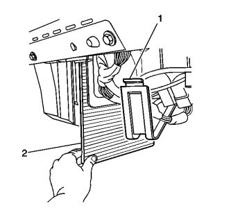

COMWIZZ2
The only thing i don't like about the truck is that when you turn on the a/c, you can hear it blowing really loud, but if you put your hand to the vents, you only feel a little bit of cold air. My dad said it may be dirty a/c coils. I'm open to any suggestions please! Texas weather is brutal without an ac!
Apr 28, 2021 at 11:50 AM (Merged)
CLY
  • 308 POSTS
The truck may have a passanger compartment filter. It is on the rightside under the dash.If it is pluged the air will be affected. Remove the lower kick panel and you should see a cover.Remove the cover and then slide the filter down. You would be better off installing a new one verses leaving it out or trying to clean it....I attatched a pic to show you where it is
https://images.2carpros.com/forum/automotive_pictures/86485_687390_1.jpg
#1 is the cover #2 is the filter Cly
COMWIZZ2
Thanks! I took out the filter and it is blowing hard again! This truck used to be used by my dad's logging business and had the air filter completely clogged with large chunks of dirt! I'm going tomorrow to pick up a new filter thanks a million!
