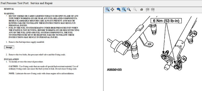

sounds like fuel pump problem, as a first step read fault codes send to us to narrow down our problem.
check our link below how to check fault codes.
check our link how to check fuel pump.

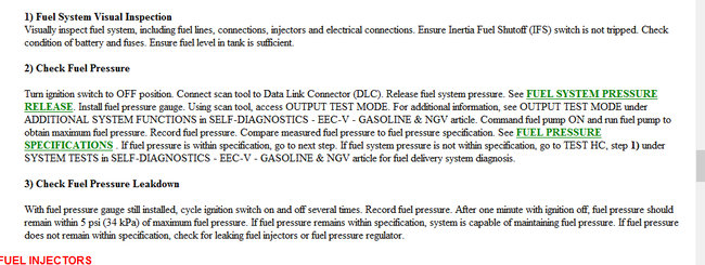

install outside fuel pressure gauge test drive when the pressure drops means you need fuel pump.

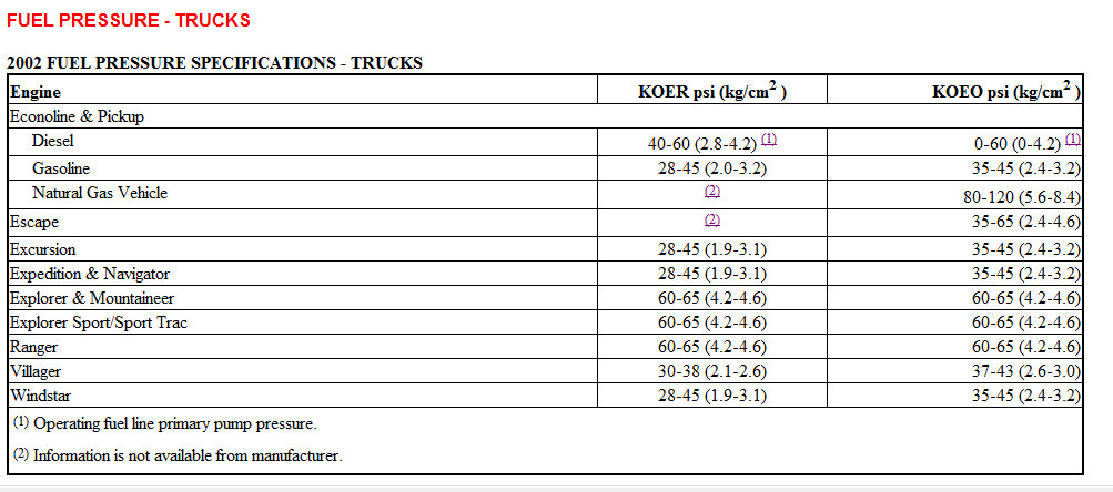

check the table and diagrams below how to check fuel pressure specific to your engine.
let us know if you need more help.
