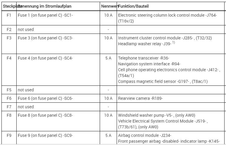

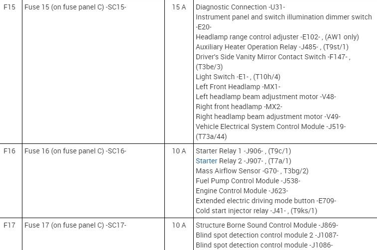

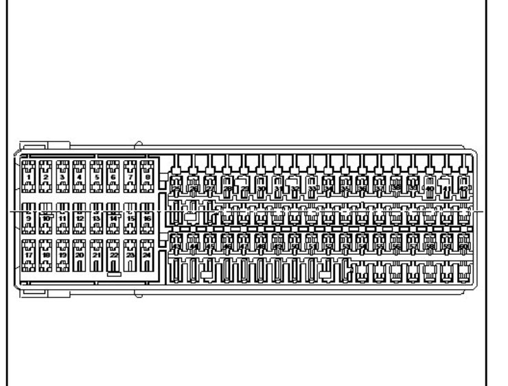

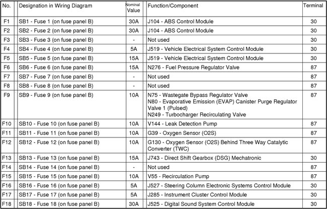

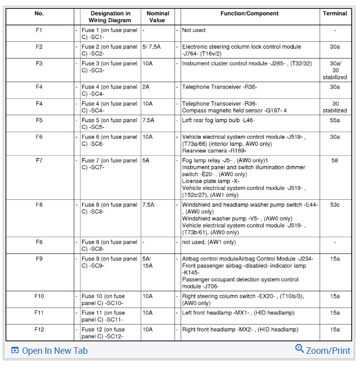

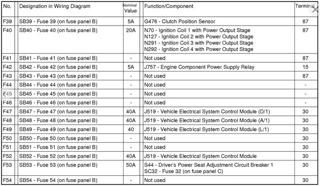

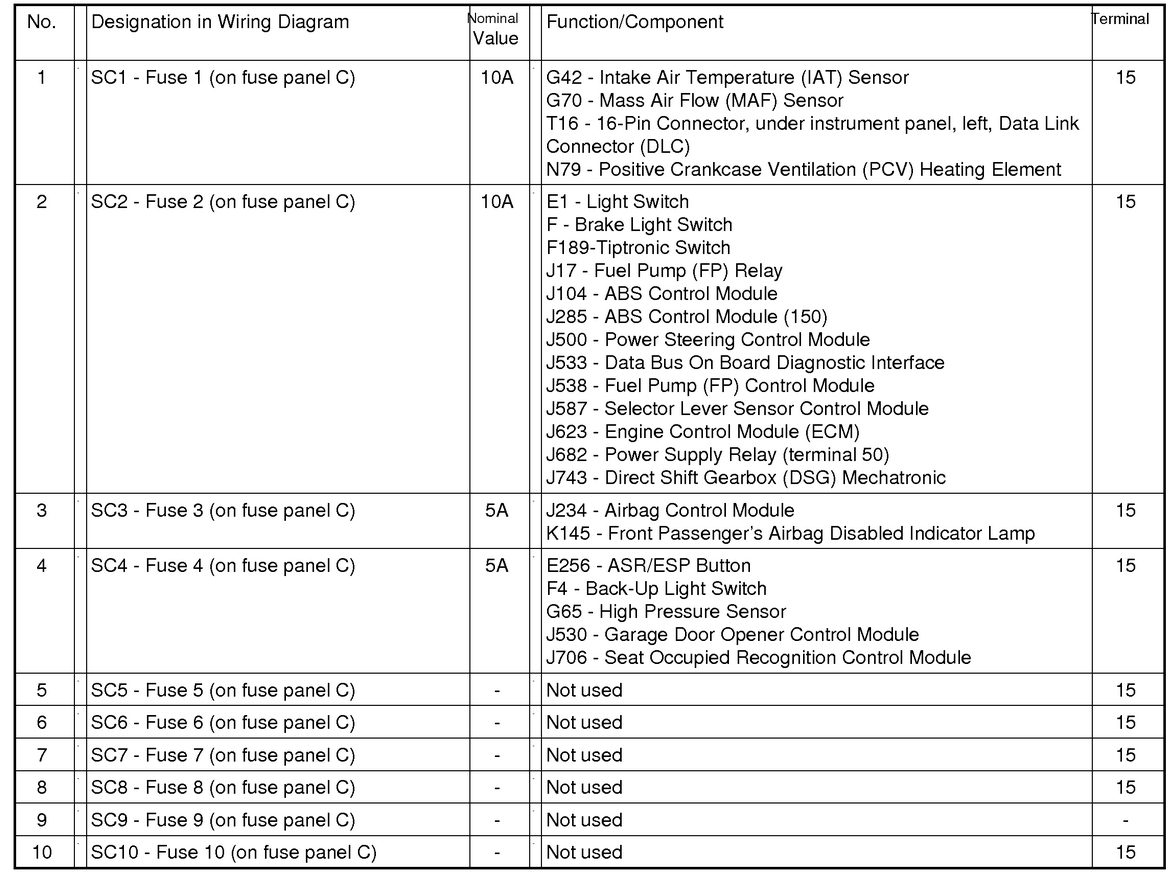

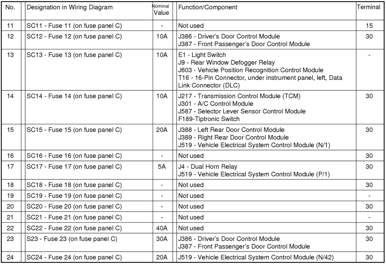

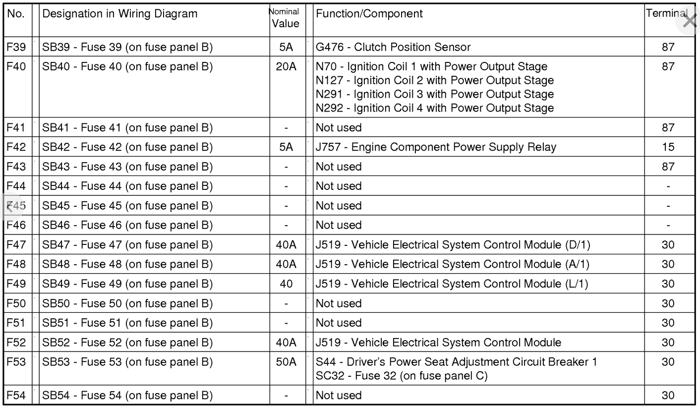

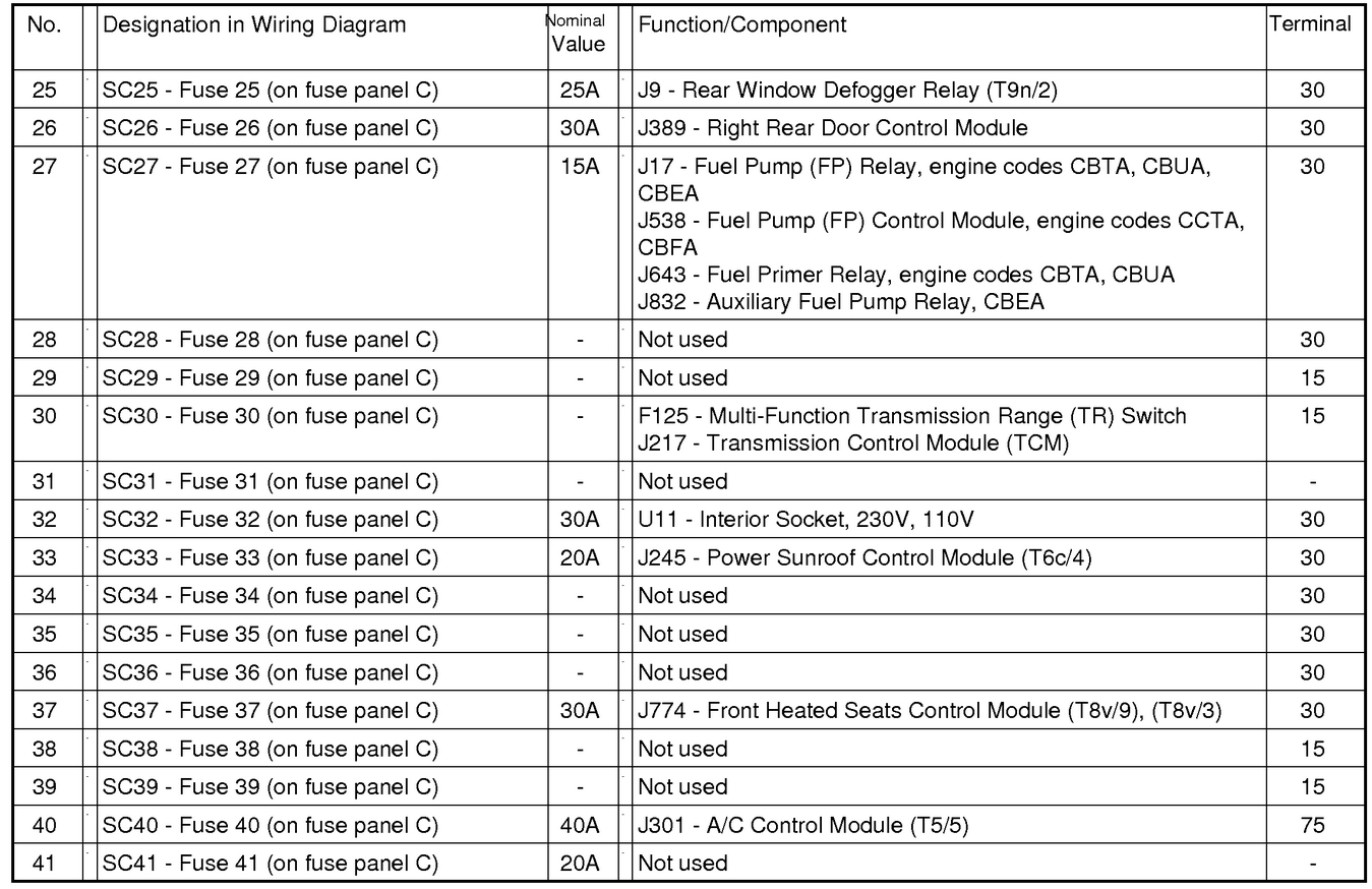

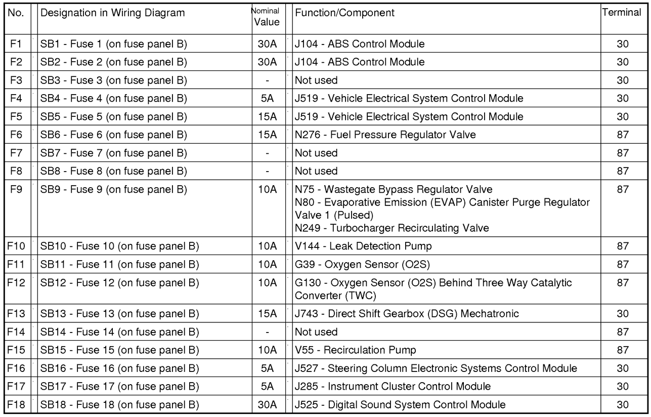

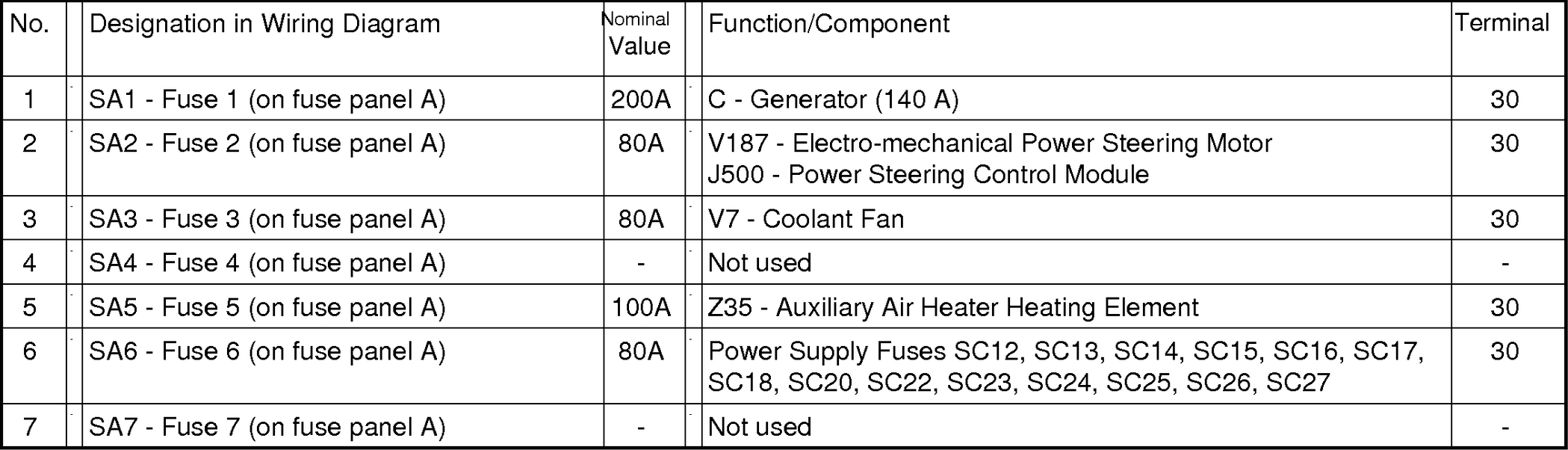

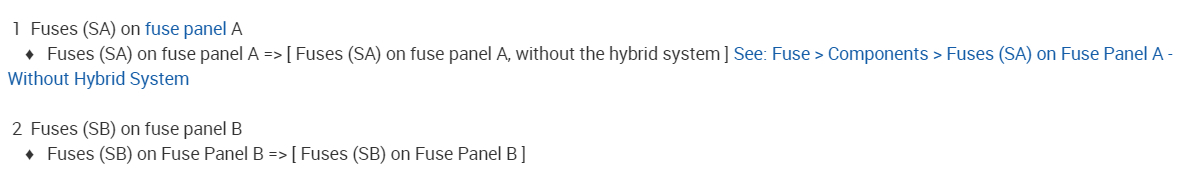

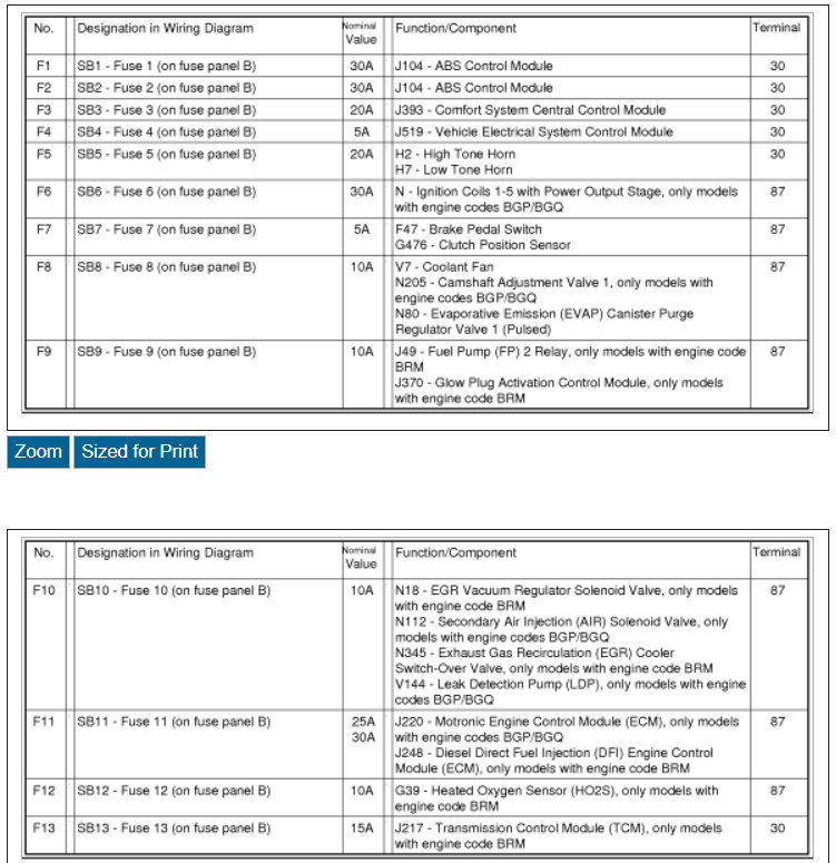

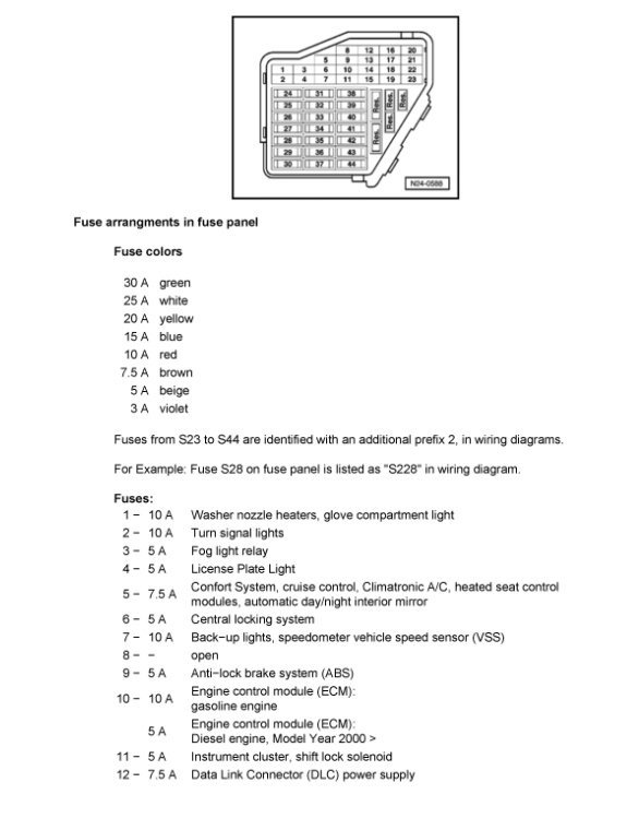

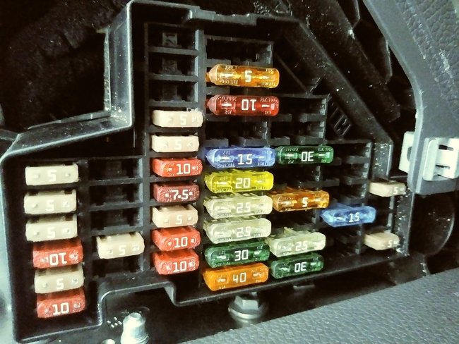

fuse diagram not one in the user manual?
2017 VOLKSWAGEN JETTA
45,000 MILES • 1.8L • 4 CYL • 2WD • MANUAL
LCOLLINWARD
There is not one in the user manual or on the back of the fuse box cover.
Feb 8, 2019 at 12:02 PM
  • CAR REPAIR CONTRIBUTOR
  • 110,193 POSTS

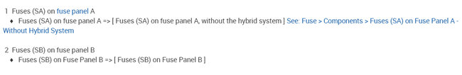

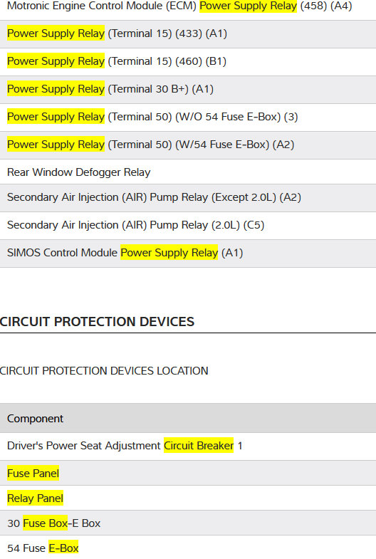

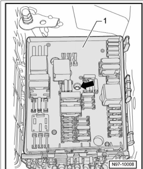

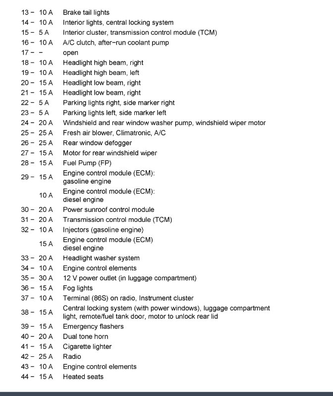

Here are the fuse allocations. I had to attach the list in several pictures. Let me know if this helps or if you have other questions. Here is a guide to help you step by step with instructions in the diagrams below to show you how on your car.
Feb 8, 2019 at 8:38 PM
LCOLLINWARD
This is awesome. Thank you. Do you know if this applies to all models?
Feb 9, 2019 at 12:38 PM
LCOLLINWARD
To clarify, does this apply to all sub-models of the 2017 Jetta?
Feb 9, 2019 at 12:52 PM
  • 110,193 POSTS
Hi and welcome back:
That is the only one they show, so I assume yes. There may be things listed on it which your vehicle doesn't have.
Let me know if you need anything.
Feb 9, 2019 at 8:06 PM

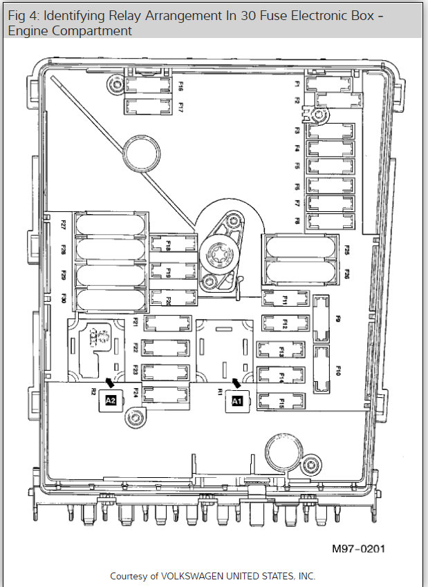

M.GUTIERREZ
  • 7 POSTS
I need a fuse diagram for both internal and external fuse boxes. the in desperate need!
Jul 14, 2020 at 12:10 PM (Merged)
94 TRANSAM
  • 680 POSTS
Hi, welcome to 2CarPros.
I need the 8th digit in your VIN so I can look up your vehicle.
Thank you, Rich
M.GUTIERREZ
  • 7 POSTS
Hello the 8th character in my VIN is: J, however is not a digit. Is this what you mean? The full VIN is 3VWRZ7AJ2AM053761
94 TRANSAM
  • 680 POSTS
You will find the info below. Let me know if you need anything else.
Rich
M.GUTIERREZ
  • 7 POSTS
Thank you for the response! I see that the list that has SC1, SC2, SC3 and so on are for the internal fuses. However for the outside one, Fuse E-Box, I don't understand. I see it's component, but I don't know where to put it and what volt level the fuse should be, thanks!
94 TRANSAM
  • 680 POSTS

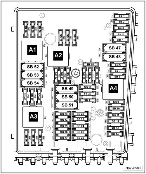

Sorry, these are the diagrams for the one under the hood and the one under the dash.
All voltages in all fuse blocks are 12 volts. Some voltages out of the computer are 5 volts.
Rich
M.GUTIERREZ
  • 7 POSTS
Hello Rich,
Unfortunately I'm still confused. If you refer back to the very first image you sent me on the first bundle of files (under the hood fuse diagram ), you'll see that it goes from sb1 all the way to sb50 (fuses) however the recent list you sent me only goes up to sb18. Is there still more to the list? I also don't understand what fuse panel A is for? Thanks
94 TRANSAM
  • 680 POSTS

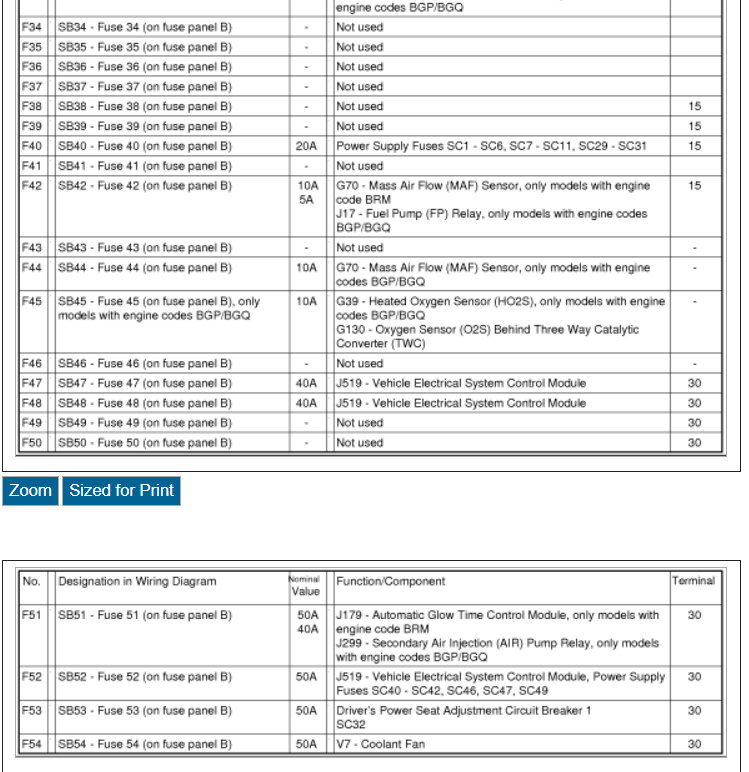

Okay, sorry again. This tiny car has more fuses than 6 American cars combined! I am also having to use 2 different sources to get this info which is making it difficult.
I am seeing this car has 4 fuse/relay boxes. Is that correct? Do you want the info for all 4?
I will keep digging tonight but at this point I think I pieced together all the info for the under hood main box. Posted below. Let me know if this is not right. And as I said I will dig for the others.
Rich

Okay, this should be the main box inside the car. Do you need the 2 relay centers also?

Hello Rich, the under the hood fuse box does not match. can you refer to another one please? I have one with 2 100 blocks.
M.GUTIERREZ
  • 7 POSTS
You also gave me to two different lists of the inside fuse panel, the second list does not match the first one.

Okay, I have the 8th VIN#, I have the year etc. That info is based on one model Jetta. There are 3 different Jetta's. It was my assumption they all had the same wiring. So what model Jetta do you have? And is it 2 door, 4 door, hatch back, auto or standard transmission?
This is nuts! hahaha.
Rich
M.GUTIERREZ
  • 7 POSTS
Mine is the Jetta Sedan .
94 TRANSAM
  • 680 POSTS
Okay, this is what I have for your vehicle. If this is not right let me know and I will pass this to someone else and see if they can find something I can't. The diagrams are named what the fuse panels are called.

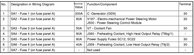

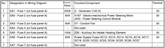

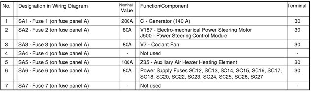

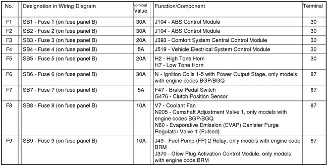

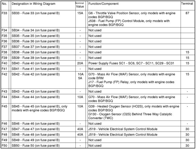

IVAN AZCUE
  • 25 POSTS

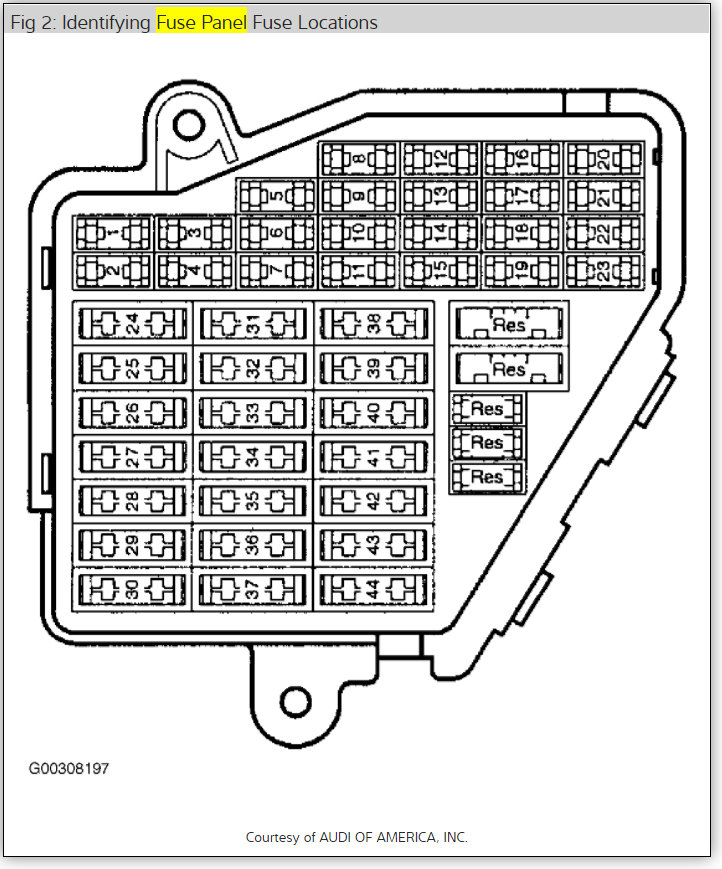

I'm looking for fuse panel information/diagrams of the inner panel and the engine compartment
engine code BGQ.
I've heard there are different variations my production date is November 2004.
Jul 14, 2020 at 12:12 PM (Merged)
STEVE W.
  • 15,167 POSTS
Welcome back. These are the fuses, locations and the circuits powered by the fuses for the underhood and interior boxes. For the Jetta build date Nov. 2004
What is the the issue you are having?

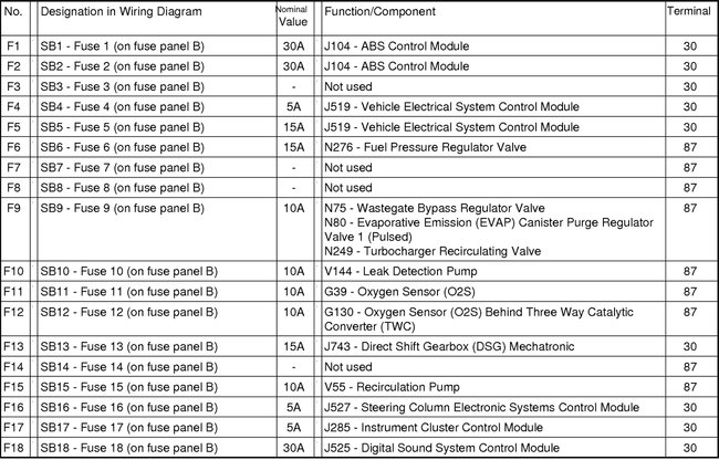

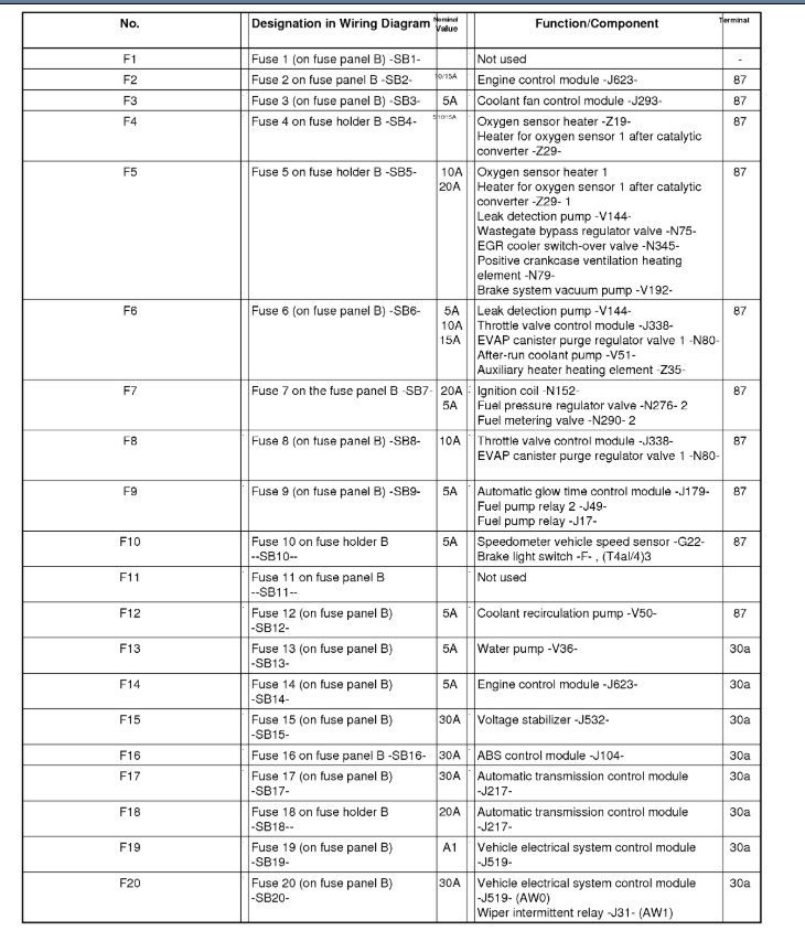

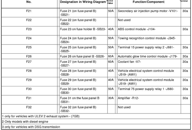

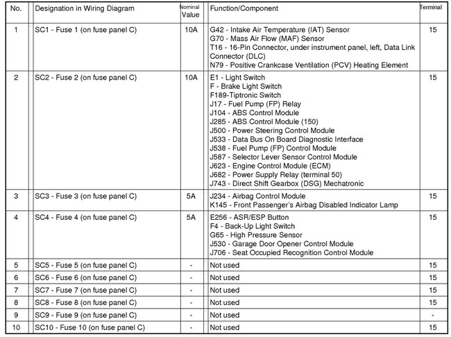

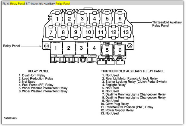

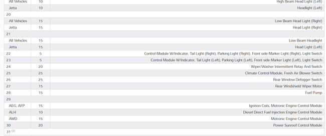

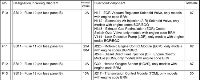

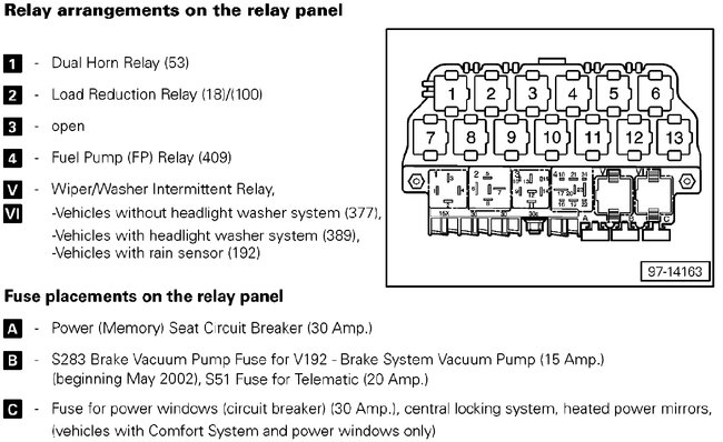

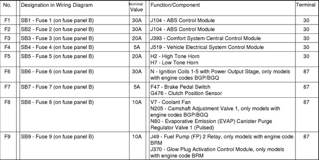

ANN BLUE HARRIS
  • 5 POSTS
I need the fuse diagram to know what fuse is for what. my car doesn't have the paper for the interior or exterior.
  • 110,193 POSTS

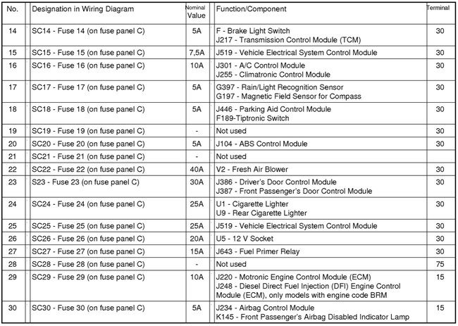

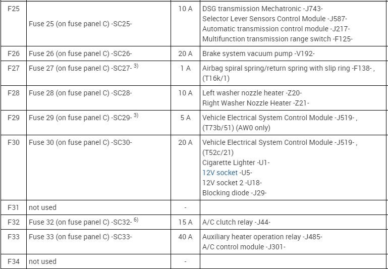

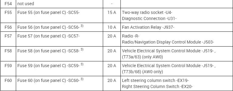

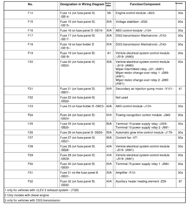

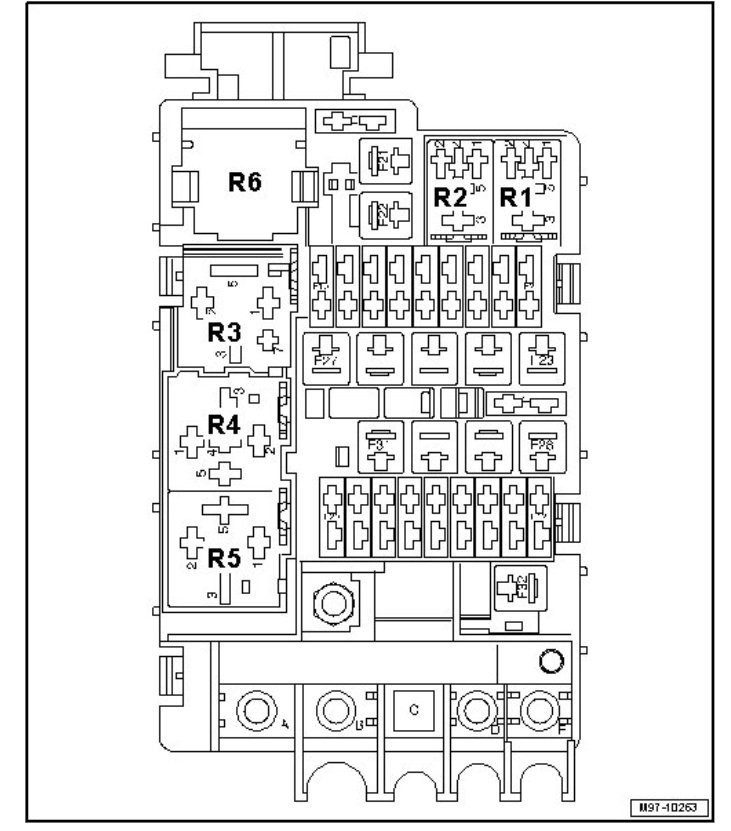

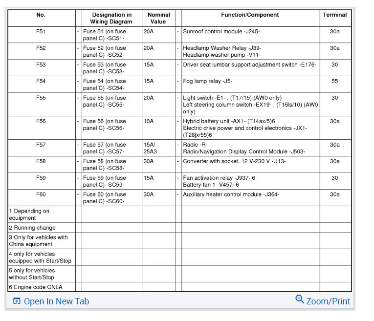

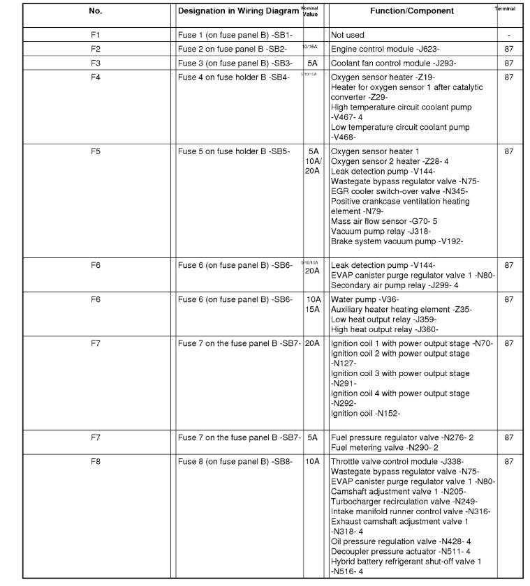

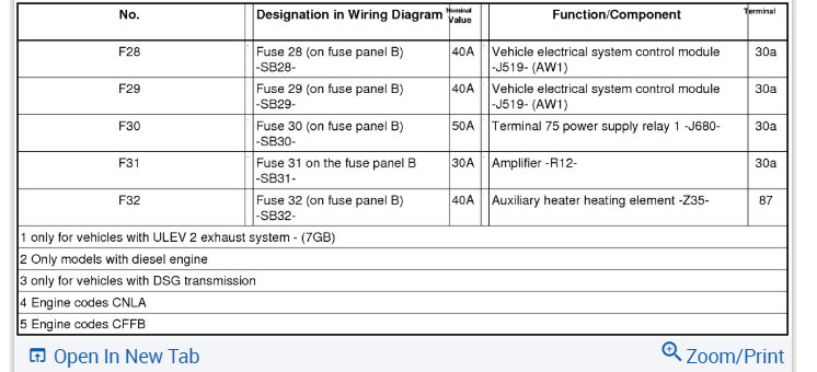

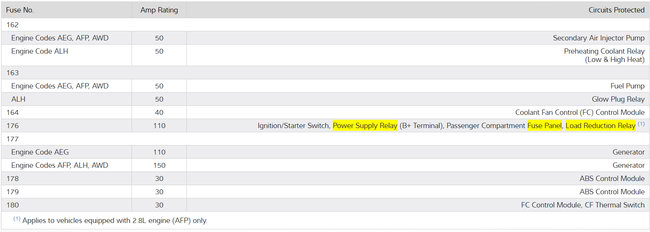

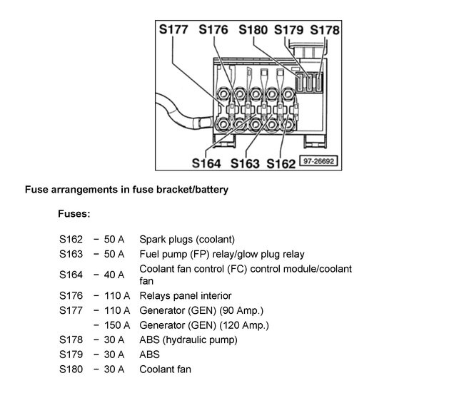

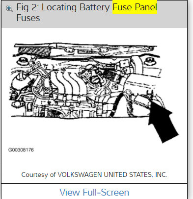

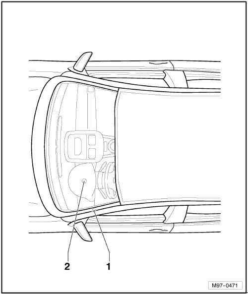

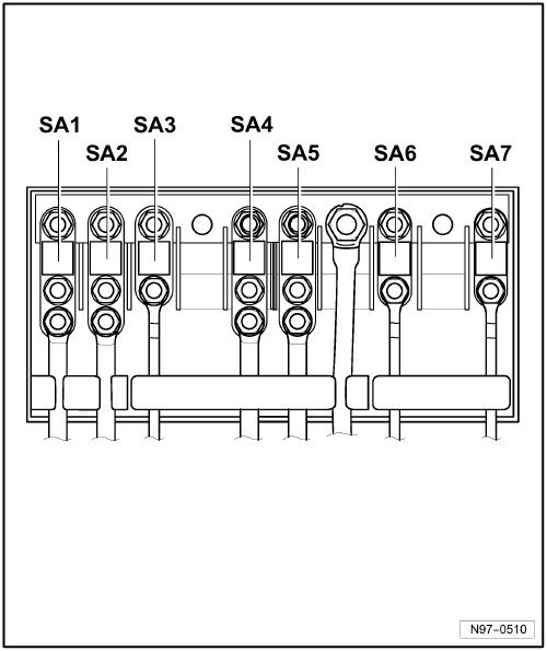

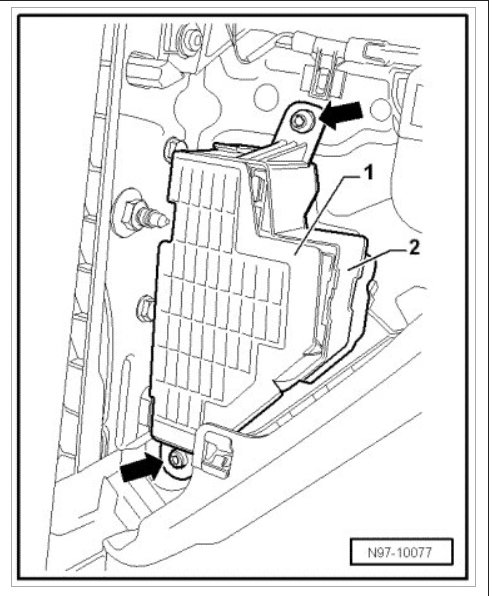

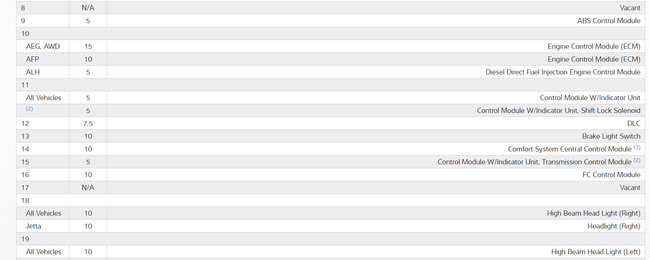

There is no V6 shown for this vehicle, so I will attach the information for both the 1.8T and the 2.0.
The first pictures are for the 1.8T. Pictures 1 and 2 are of the interior fuse panel (left side). Picture 3 is the battery bracket. Picture 4 fuses on relay panel
2.0L
Picture 5 and 6 left side fuse panel. Picture 7 is the battery bracket. Picture 8 is the fuses on the relay panel.
  • 110,193 POSTS
2.0L

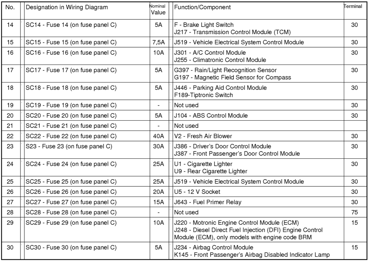

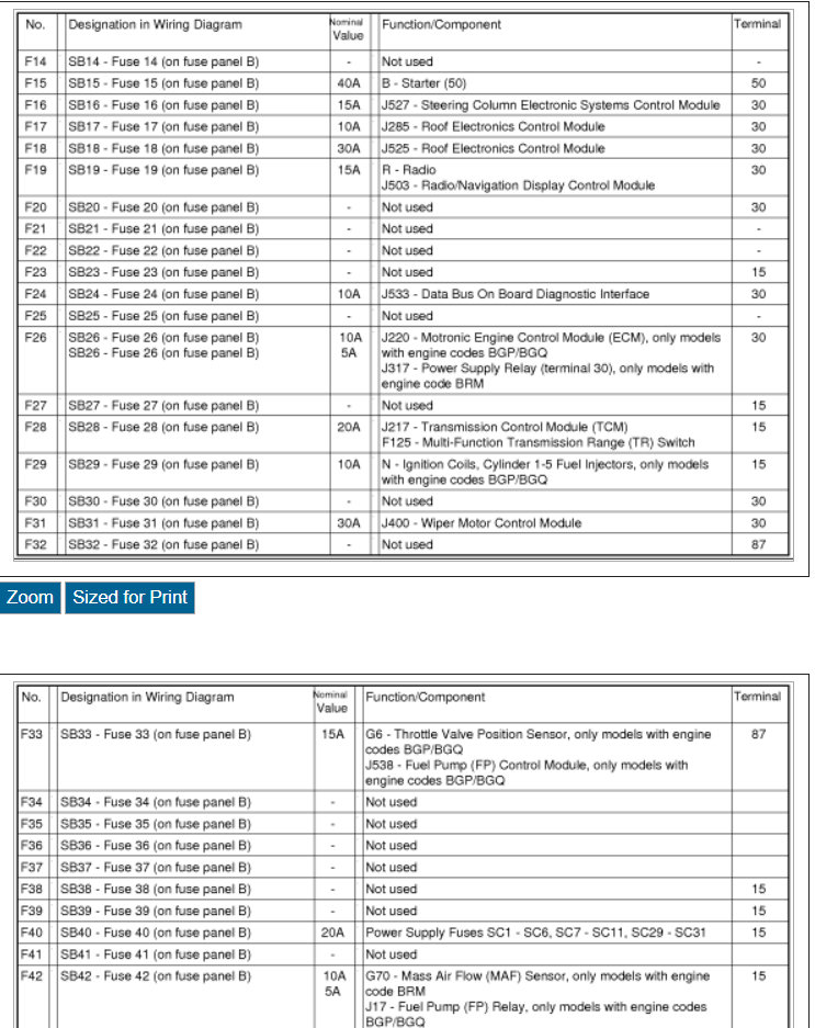

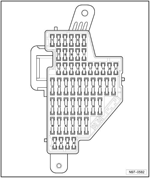

ANN BLUE HARRIS
  • 5 POSTS

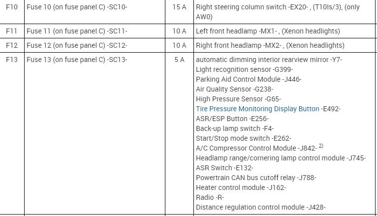

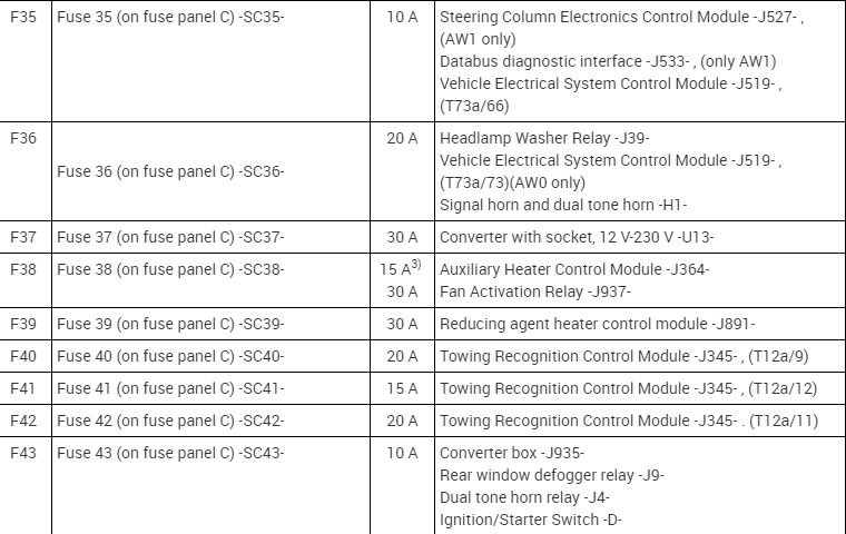

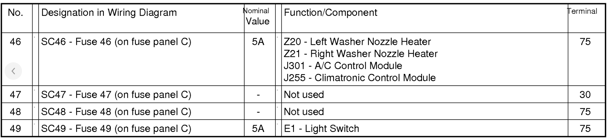

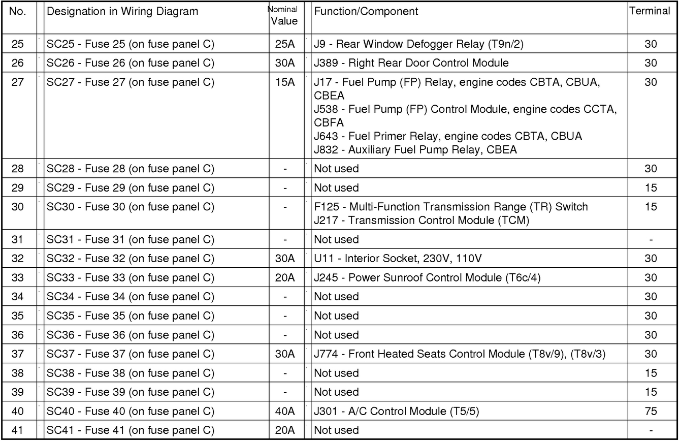

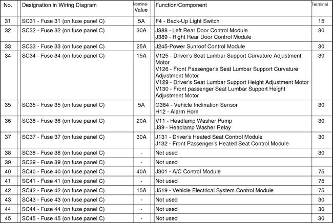

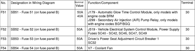

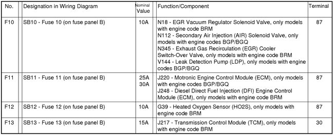

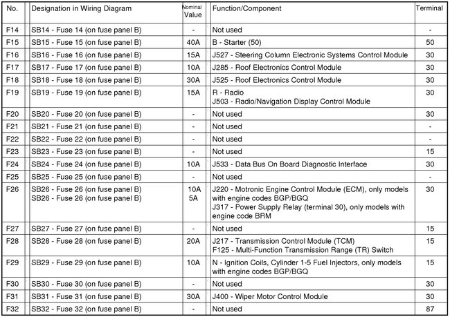

It didn't give me the option for a 5 cylinder my car is 2005 Volkswagen Jetta 2.5L it doesn't have the fuse guide that says what fuse goes to what interior or exterior.

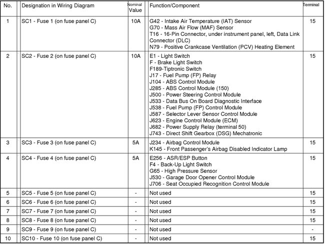

  • 110,193 POSTS

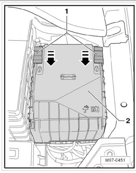

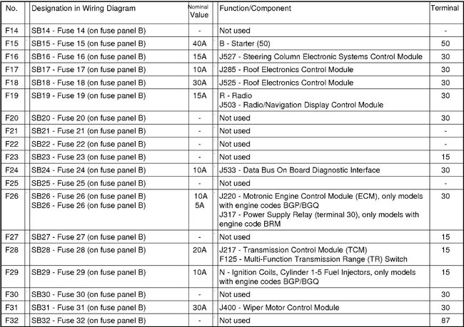

Pic 1 Fuses under hood on electronics box
Pic 2, 3, 4 Interior fuse panel legend and layout
Let me know if this helps.

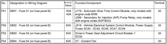

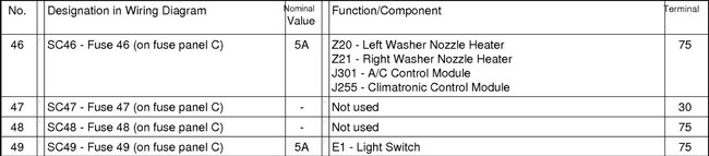

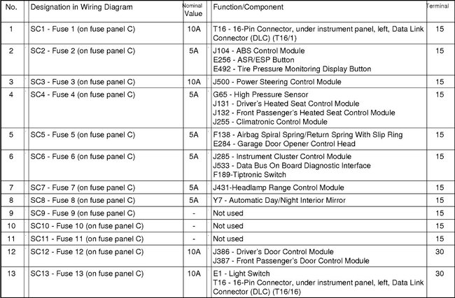

ANN BLUE HARRIS
  • 5 POSTS

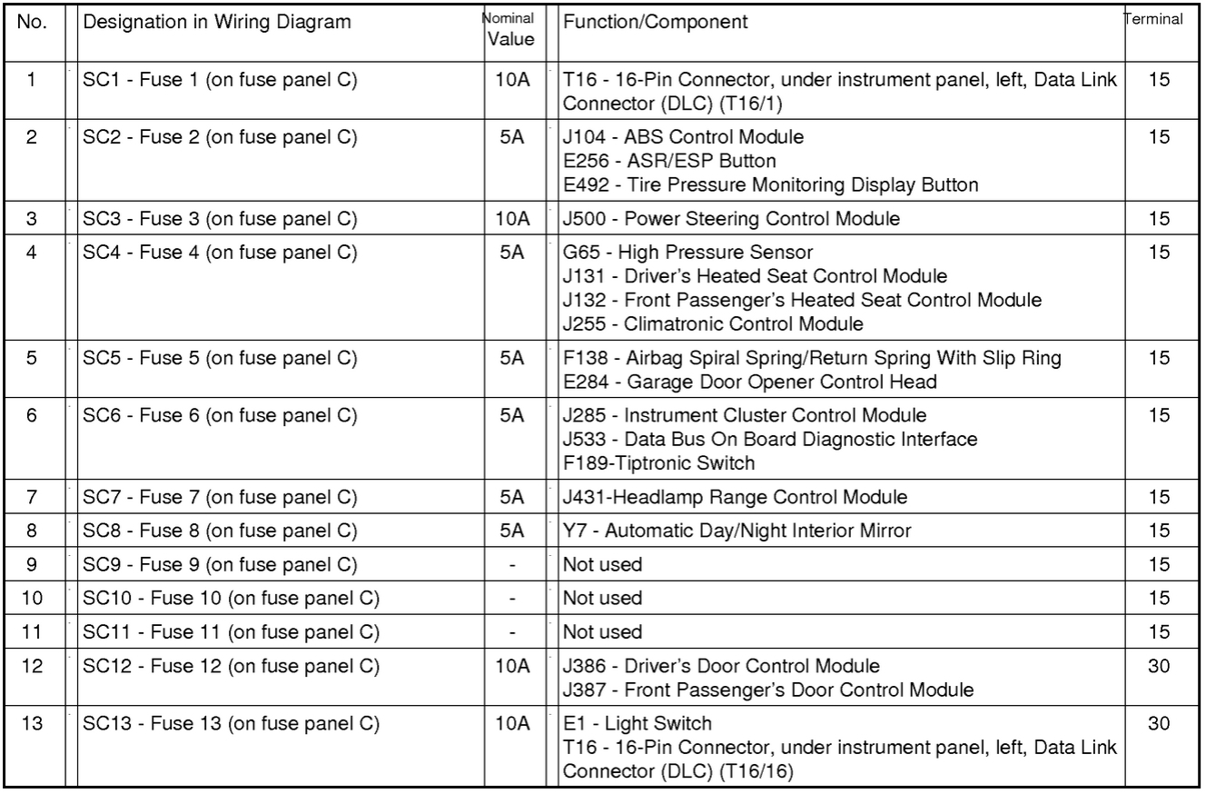

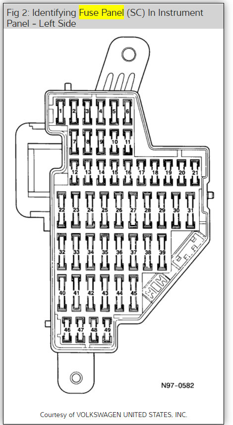

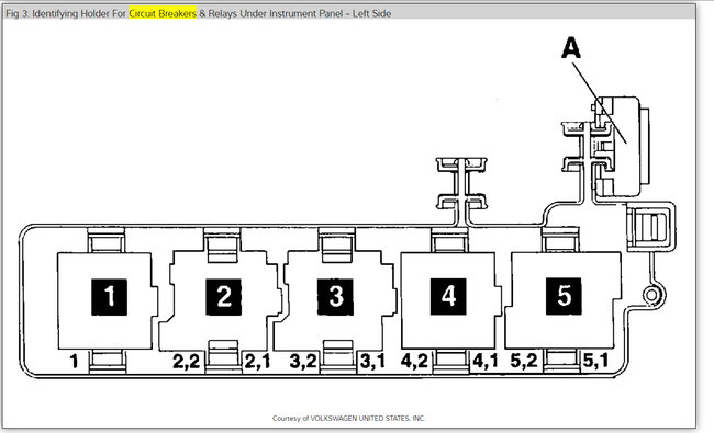

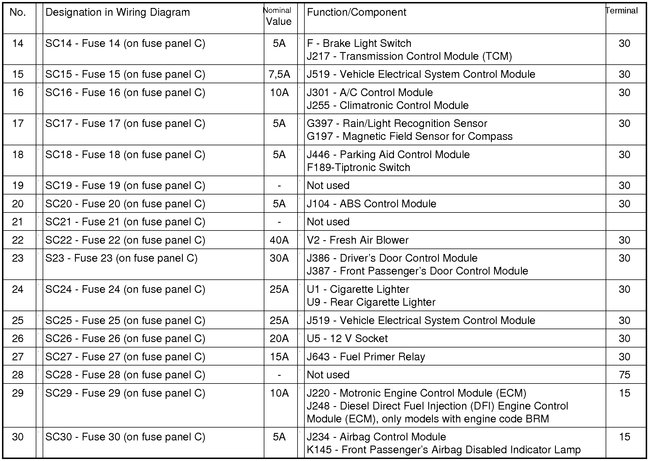

Thanks for this information. The pictures sent were internal fuses 1-4 and 14-36 I have 49 fuse slots in my car. This is the right diagram and guide I just need 1-49 internal and all fuses for external under the hood. Thanks again

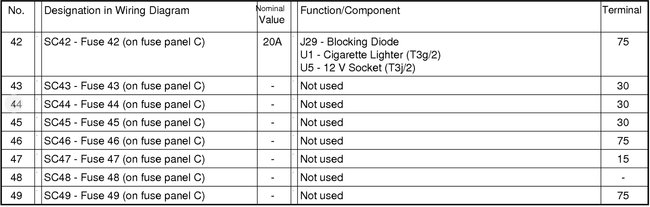

ANN BLUE HARRIS
  • 5 POSTS

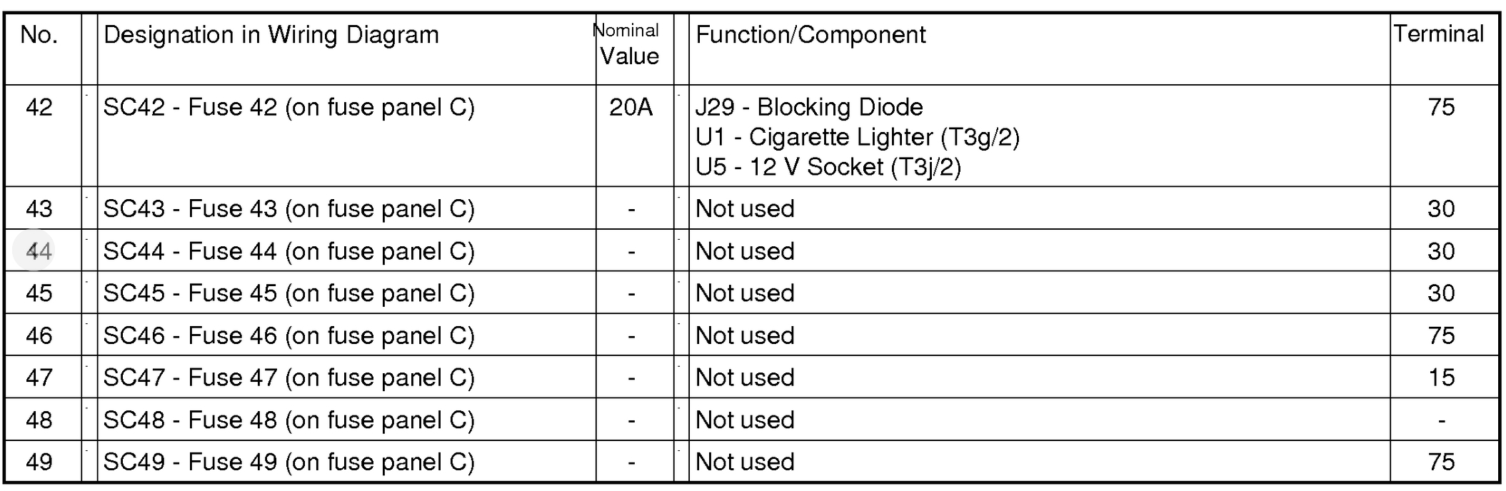

My cars internal fuse box I need 1-49 fuse numbers and what they all control.
  • 110,193 POSTS
That's fuse panel C. See the attached pictures.
There may be fuses listed that are not used.

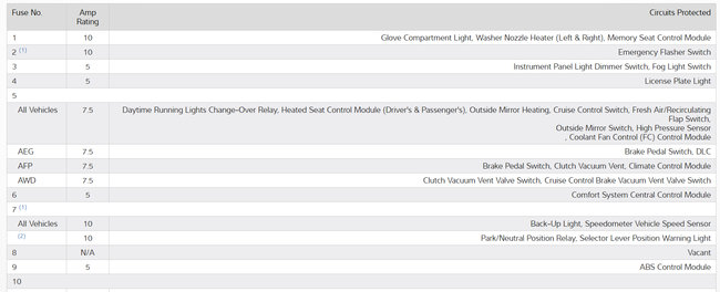

  • 110,193 POSTS

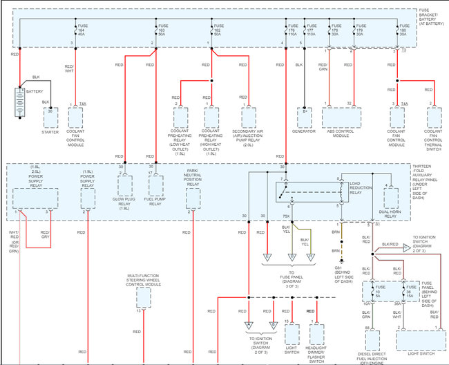

Here is the problem: There are several fuse boxes on this vehicle. What I am going to try to do to help is this. First, I am going to provide the entire power distribution wiring schematic which indicates what fuse box is supplying power and wire color and fuse number. Then I will provide what each fuse is for. Please understand, there are many pages of the schematic. I have to, at a minimum, cut them in half to make them readable for you. I will keep them in order and overlap them so you can follow them easier.
Pics 7 and 8 Instrument panel left.
I hope this helps.

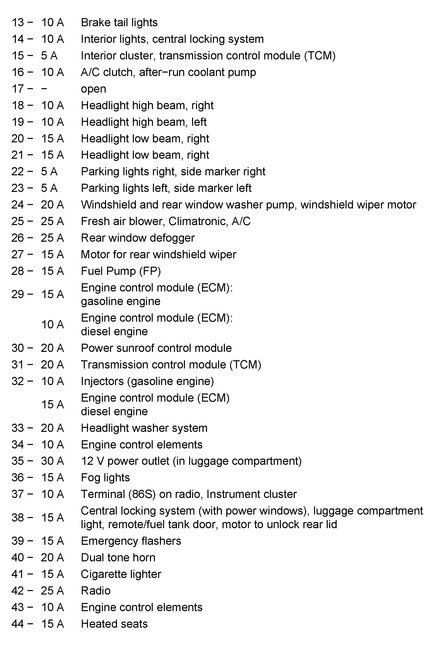

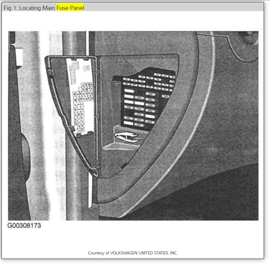

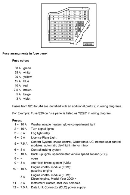

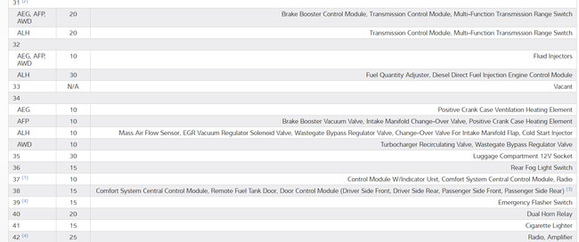

JOYPARADISE
Interior problem 4 cyl Two Wheel Drive Manual 92000 miles
I bought my daughter a 2000 Jetta this weekend and the cigarette lighter doesn't work for her to plug in a GPS. It looks as if something was spilled in it. Where can I find a diagram where I can check the fuse?
Jul 14, 2020 at 12:13 PM (Merged)
  • 54,454 POSTS
Here is a guide to help you test the fuse #41 located it from these diagrams of the fuse panel (below):
Open the driver door and look at the side of the dash, you will see an access panel, pop it open and you will see the fuses. The cover will have a small card attached to it with icons. Look
for a cigarette icon to match-up which fuse to check. Here is the fuse panel identification
Check out the diagrams (below)

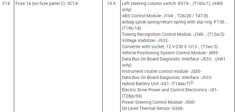

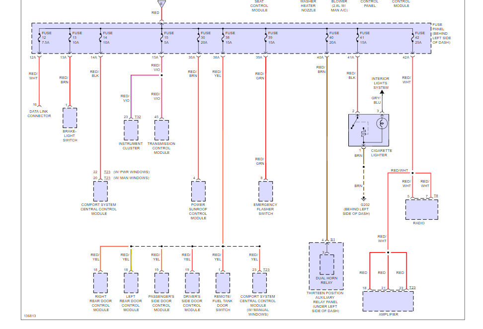

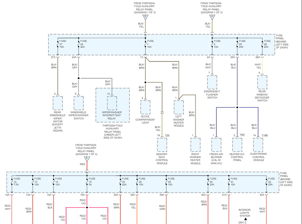

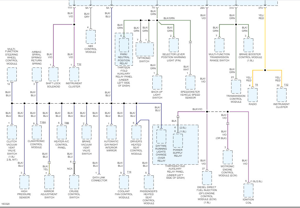

RYAN BROWN
  • 6 POSTS

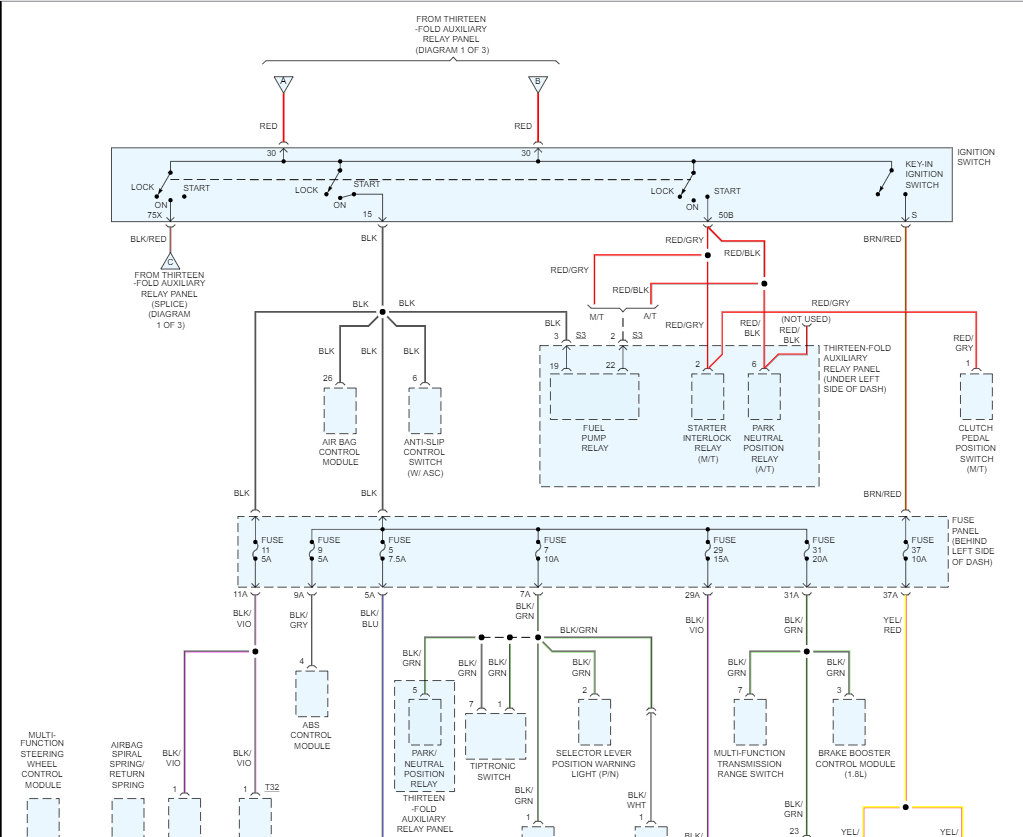

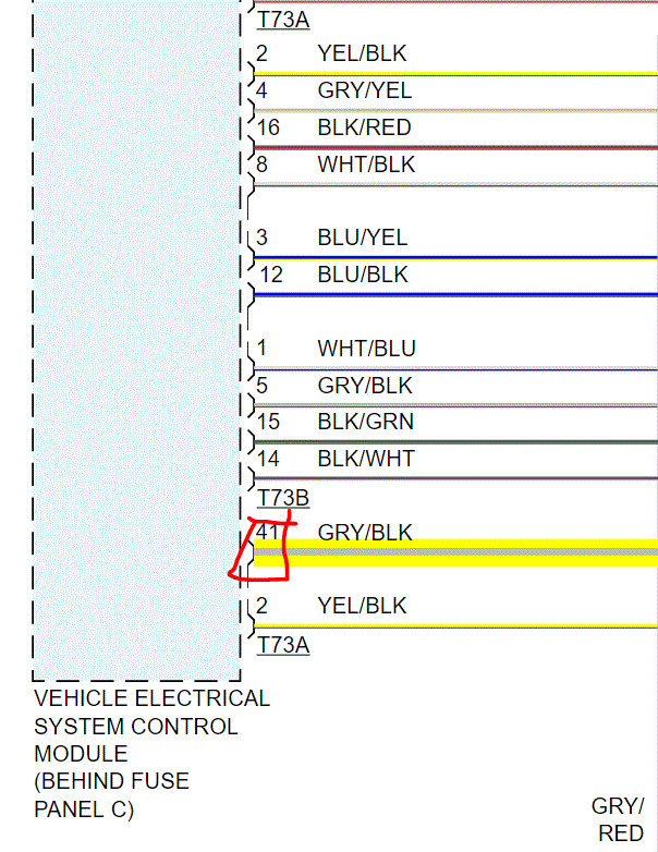

Hey Experts! The first diagram posted here at the top is the one for my vehicle! 2017 Jetta GLI. The only issue I’m having is trying to pinpoint which fuse corresponds with the rear running tail lights (drivers side). The fuses in that diagram aren’t always labeled what i would look for, (for instance windshield wipers is F10 - Right Steering Column Switch), so I’m wondering if there is a more technical term I’m just overlooking that corresponds with the drivers side tail light that I’m missing?
Apr 28, 2021 at 1:24 PM
  • 110,193 POSTS
If you look below, I attached a small portion of the wiring schematic from above. I highlighted the wire to the tail light (left side). Power is provided from the electrical control module, behind fuse panel C. Thus, there isn't a specific fuse. What you would have to do is check that pin for power.
Have you checked the grey/black wire at the tail lamp for power? If you haven't do that. Here is a link that you may find helpful:
Let's first confirm that it isn't an issue with the light socket or a bulb.
Let me know what you find.
Apr 28, 2021 at 5:26 PM
RYAN BROWN
  • 6 POSTS
Hey Joe! Appreciate the help!
Here’s what we know so far:
It’s not the bulb (replaced them with fresh ones), no dice. Swapped the left and right units - and the unit that wasn’t working works on the passenger side, and the unit that was working does not work on the drivers side.
Additionally - the running tail light does come on for certain things. When it’s in park (this is a new development as of today) and when the brake is applied (but there is about a 3 second delay - whereas the brake lights come on immediately).
So I know the thing can work, so guessing it’s not the wiring. Wasn’t sure if there is a separate fuse for the brakes vs running tail light to explain why it works for certain functions.
Apr 28, 2021 at 8:33 PM
RYAN BROWN
  • 6 POSTS
Also just want to thank all the experts on here for taking time out of your day to come help random strangers. You guys rock!
