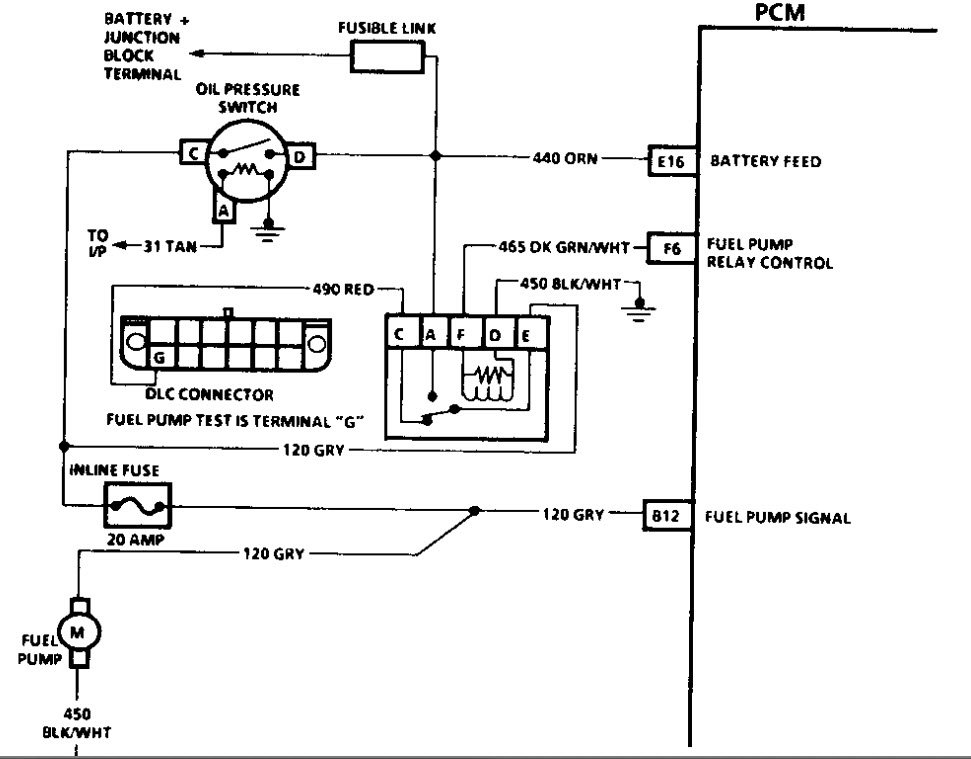

CHAS662
  • 7 POSTS
C-1500 after engine warms up starts to run rough and shuts off at low rpm. get code 54 and have tried all the easy possible fixes.
Feb 18, 2021 at 12:58 PM (Merged)
HMAC300
  • CAR REPAIR CONTRIBUTOR
  • 48,601 POSTS
see picture. fuel pump circuit check the fusible link in picture at battery should be twelve volts both sides. then check ground for pump may be corroded. should be 9-11 PSI. also, check gasket at base of TBI they like to blow out use choke cleaner to check. can be a bad relay, oil pressure switch low oil pressure etc. This guide should help.
https://www.2carpros.com/articles/engine-stalls
Check out the diagrams (Below). Please let us know what you find.

CHAS662
  • 7 POSTS
sorry didn't back to sooner. This started out with me changing map, plugs and wires, dis cap, rotary button. sense then I have changed egr, fpr and fuse, oil pressure sending unit, iac, tps. at that point it stopped firing so I changed coil pack and still no fire. I don't have a meter and get confused when I try to read one so I'm out of luck there. As you can tell at I only qualify as a shade tree. I do appreciate the help and still at a stand still.
HMAC300
  • 48,601 POSTS
you'll have to check resistance of pickup coil 400-1000 ohm and take ignition module in dist to auto parts they can check it
CHAS662
  • 7 POSTS
Put on a new ignition module. Thanks again for the help. It starts now but it runs rough and sometimes back fires. Test drive and it run so bad it would hardly go. I get code 22 for the tps but I had put a new one on already. I just took it off and used the old round bushing and put new one on. Did I need to do something else?

CHAS662
  • 7 POSTS
With your help and expert advice we have old truck going down the road smooth. Makes me fell good. Thank You very much. Hope my small donation helps..
