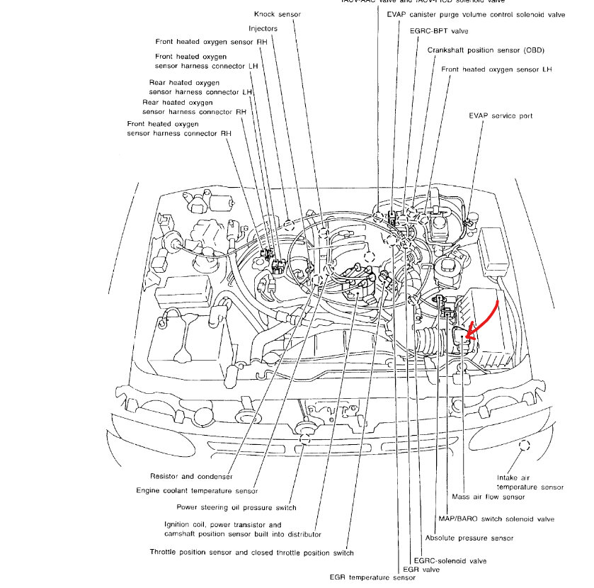

Here is the location of the MAF sensor. Check out the images (below). Please upload pictures or videos in your response of any problems so we can see what to help you with.

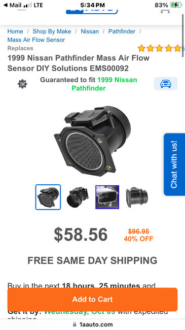

I’m ordering a new MAF do I need a code reader to rest it or can I disconnect the negative terminal for 15 minutes and put it back on?
Monday, October 7th, 2024 AT 4:33 PM
99NISSAN
  • 13 POSTS
This is the MAF I got.

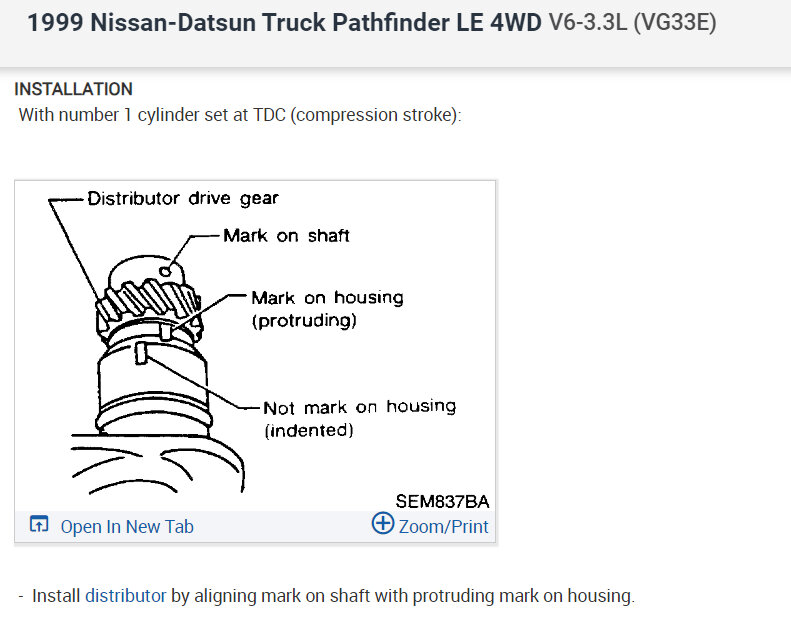

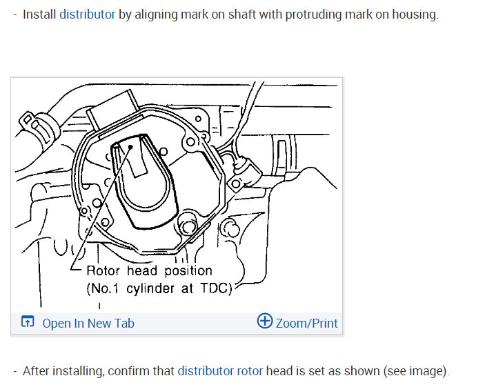

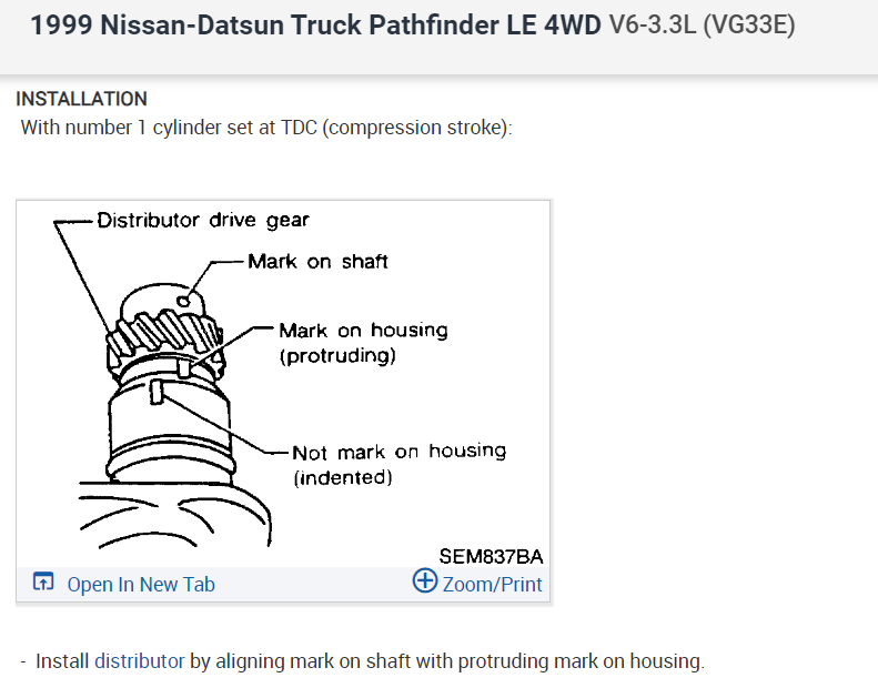

The P1320 trouble code on a 1999 Nissan Pathfinder refers to an issue with the Ignition Signal Primary Circuit. This is telling us the ignition distributor is bad, I would get a rebuilt unit and install it would shoel fix the problem. Here is how. Check out the images (below). Please let us know what happens.
Wednesday, October 16th, 2024 AT 9:43 AM
99NISSAN
  • 13 POSTS
Could I replace the whole distributor?
Wednesday, October 16th, 2024 AT 11:27 AM
KEN L
  • MASTER CERTIFIED MECHANIC
  • 55,522 POSTS
Yes, that is best, here is one on amazon for $70.00:
https://amzn.to/3NtaztC
Let us know how it goes.
Thursday, October 17th, 2024 AT 8:39 AM
99NISSAN
  • 13 POSTS
It was the distributor. Thank you so much.
