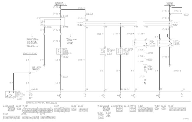

The parts you listed are all over the place which suggests you haven't diagnosed anything. Throwing random parts at a problem is the least effective and most expensive way to diagnose it and it introduces new variables the Engine Computer has to contend with. It will be cheaper and faster to get a mechanic involved.
The first thing you have to do is determine if you're losing fuel pressure, spark, or both. Check for spark right after it stalls. If it's there but the engine won't restart, you can try a squirt of starting fluid to verify fuel is missing.
If spark is missing you can skip checking for fuel and go right to checking if the automatic shutdown (ASD) relay is turning on during cranking. Since you didn't list the engine size I don't know which ignition system you have or how many ignition coils it has. You'll have to figure out which wire is the 12 volt feed to one of the coils and monitor that with a test light. A digital voltmeter can work too but you have to watch it closely at first. You should see 12 volts on that feed wire for one second after a helper turns on the ignition switch, then it will go back to 0 volts. A lot of digital meters don't respond fast enough to catch that. That's why test lights work better for this test. What is important is whether that voltage comes back during engine cranking. If you had spark, it came back and there's no need to do this test. If the voltage doesn't come back during cranking the camshaft position sensor and the crankshaft position sensor are the main suspects. Normally there will be a diagnostic fault code set that will indicate which circuit needs further diagnosis.

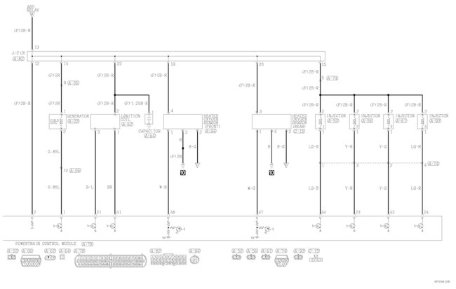

Did you check for applicable mil codes? You can do that yourself. You cycle the key, no crank, just turn key till dash lites come on. On--off, on--off, on, then the mil starts flashing, you count the flashes to get the codes. Your looking for two digit codes.
At the ignition coil, the black wire with red tracer should be hot with engine cranking, is it?
