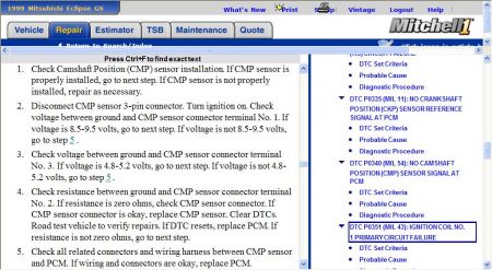

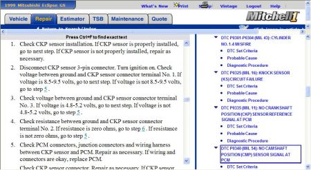

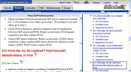

Scan the computer for OBD2 code/s and see if you get P0335 and P0340-this code relates to P0335 for the crankshaft position sensor and P0340 for the camshaft position sensor-
Inspect and test this 2 sensors
