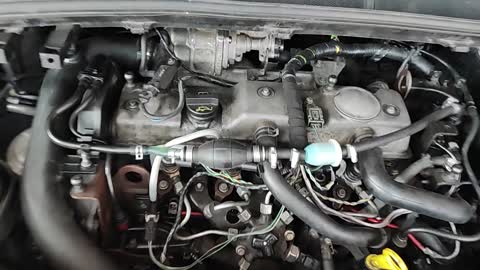

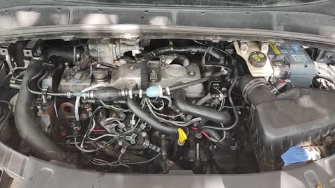

New glow plugs were installed a year ago. Even after that it started with difficulty. They were replaced due to difficult starting. I removed them a few months ago. They glowed within 10 seconds. I don't remember any resistance. I'll check again tomorrow. The glow indicator lights up for several seconds even in such good weather, the glow is so important.

The other thing you could try is to spray some Quick or Easy start into the intake and see if the starting behavior changes.
Also, as the engine fuel supply relies purely on vacuum suction to get the fuel from the tank to the high-pressure pump, you could try and bypass the fuel supply system.
Install a small, 2-5L, container filled with clean diesel at the high-pressure pump and run a clean rubber tube directly to the pump inlet. The pump will then suck directly from this container. If the starting improves then this would prove that we are having a possible vacuum leak from the supply side.

One of the injectors is new, the other 3 have been tested for a few thousand km, with a report, and the high-pressure pump has been refurbished. The fuel pipes in the engine compartment are new, as are the connectors and seals.

It sounds like this when the engine is warm. I hear a little chirping in the background.

12-13 bar compression is very low for a diesel, expect to see around 20bar normally.
That blowing/chirping noise could be caused by an injector not seating properly.
