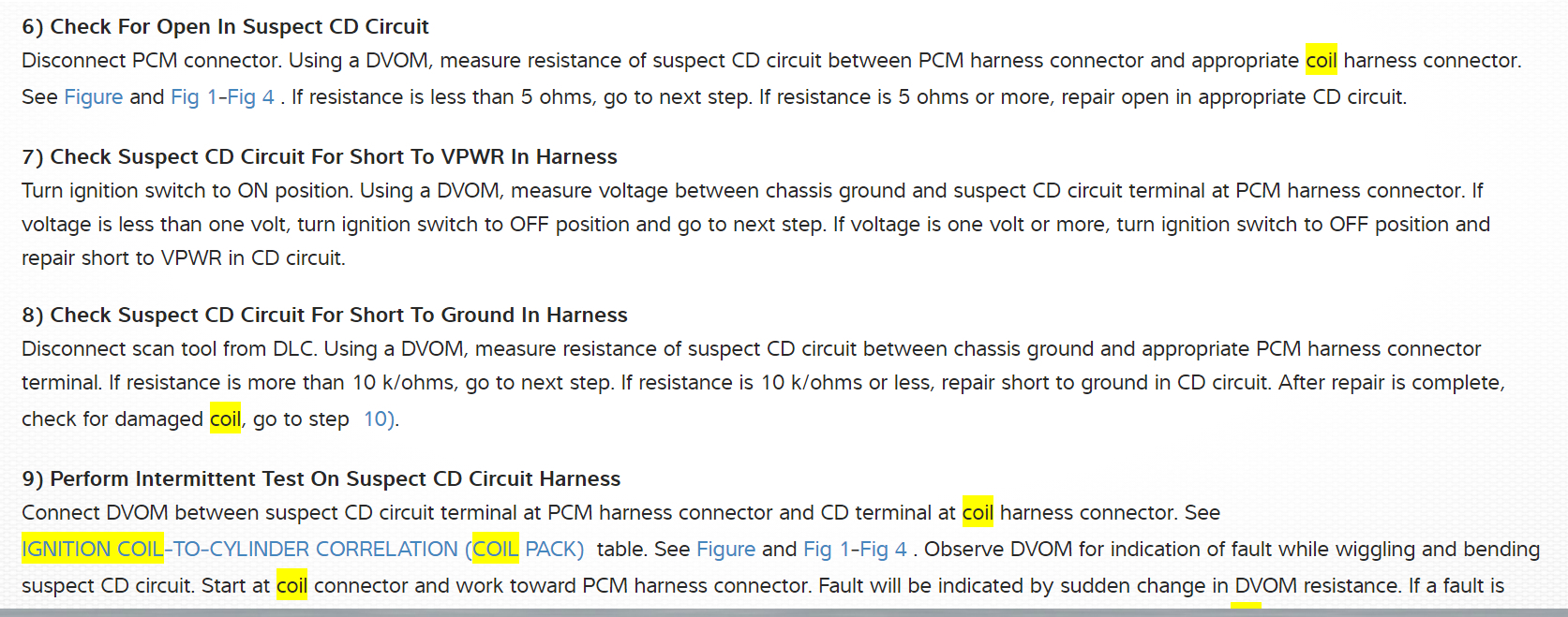

I failed to mention I found some bare wires and made sure nothing could touch and short out. I have replaced two coils that appeared to be bad. One which must've gotten hot because the spring that contacts the plug was recessed too far in insulator boot to even reach the plug and the other had a tear in the boot which could possibly cause it to arch out. Also removed fuel rail replaced o rings on the injectors that were worn or damaged. If I somehow caused bare wires to touch when I removed the coils to replace the plugs, would that blow a fuse or relay or would it damage the PCM?
Friday, December 11th, 2020 AT 12:03 PM (Merged)
SCGRANTURISMO
  • 4,897 POSTS
The PCM circuit is definitely fused, so if there was a short to ground in the circuit, the fuse would blow, not the PCM. This could for sure be an ignition issue going on. Quick question, first though, is your MIL/"Check Engine" on? Please get back to us with what you find out and we can go from there.

Yes, the check engine light has been on. I had it hooked up to a scanner at O'Reilly's and it showed that a front bank O2 sensor was bad on one side and a rear bank on the other and the cam sensor. I have changed the cam sensor, but not the O2 sensors. They could be bad, but there's another deeper root cause that's still an issue. A while back one morning it started with a small miss. I figured it needed a tune up so I was going to change the plugs and coils. I didn't have the $200.00 some for the set of coils so I just went ahead and changed just the plugs and that's when it all started I rechecked the gaps, taped up some bare spots I found in the wiring at the coil connectors, I forgot to mention when I changed the plugs I noticed the spring in one of the coils was recessed too far in the boot to even reach the plug. I was sure that was bad and the issue and a week or so later when I could afford one, I replaced it. Still missed a little but drive able. After a week or two maybe, it gradually got worse and started to backfire under the hood here and there, lagging on acceleration, hard to start. About two weeks ago it blew the plug out of the #4 cylinder and broke the coil. I'd like to think this wasn't due to an error of mine when I changed them cause I've been working on cars for years now and this has never happened. I had to use one of them kits that you tap it out and install an insert for the threads that the plug will go in. I'm pretty sure that part of the issue is fixed. Then, last week I wondered if I was looking in the wrong area so I removed the fuel rail and inspected the injectors, replaced the o-rings that were damaged, I have a fuel filter but weather has not been cooperating.

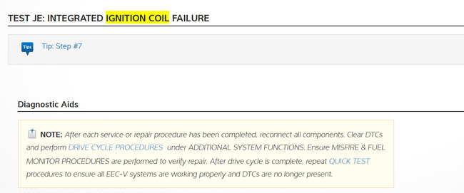

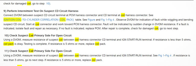

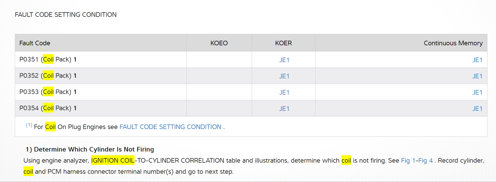

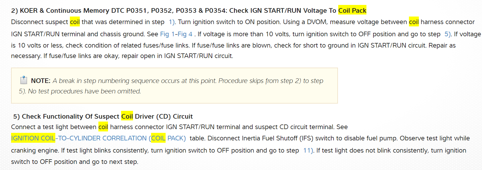

SCGRANTURISMO
  • 4,897 POSTS
Hello again,

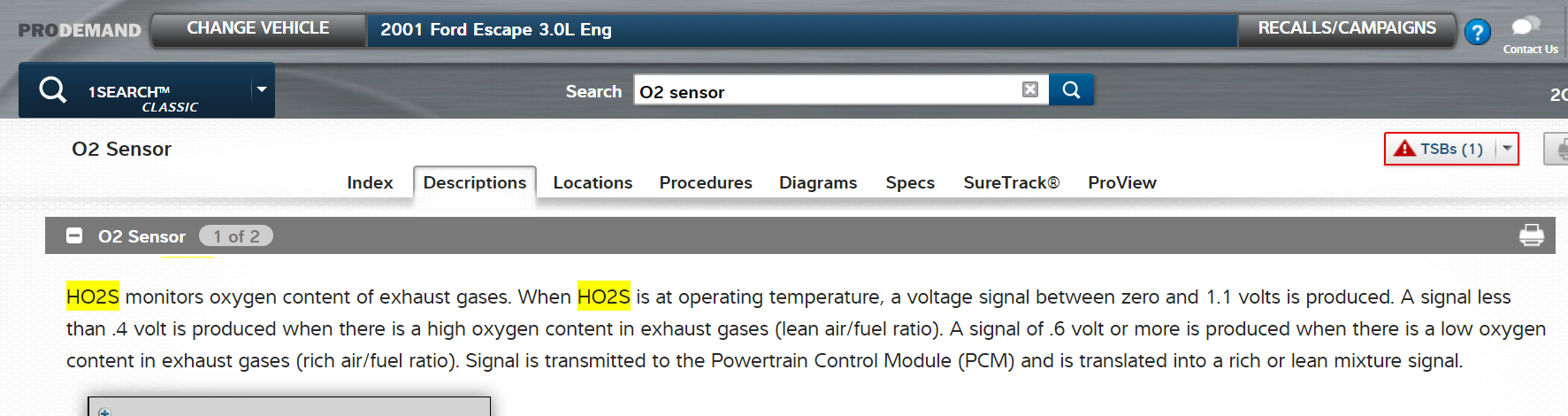

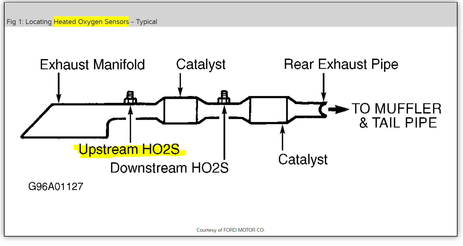

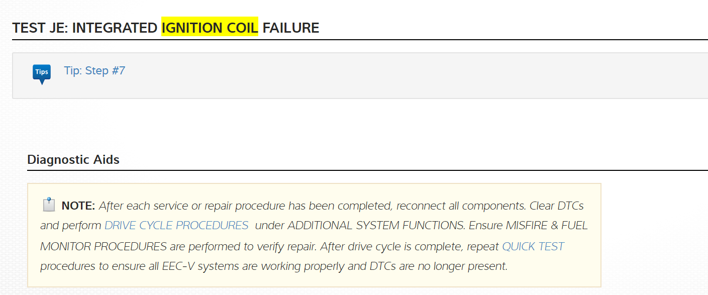

The upstream O2 sensors are critical to the driveability of your vehicle. Your vehicles Powertrain Control Module(PCM) a.K.A. "Computer" uses the upstream O2 sensor's input to determine the air;fuel:ratio, trying to keep it at or around 14.7:1, that it absolutely critical for a proper running engine. The downstream O2 sensor is used to make sure that your vehicles's catalytic converter is working properly. I have included some information for you in the diagrams below, but I would replace the upstream O2 sensor and get back to us with the results.
Thanks,
Alex
2CarPros

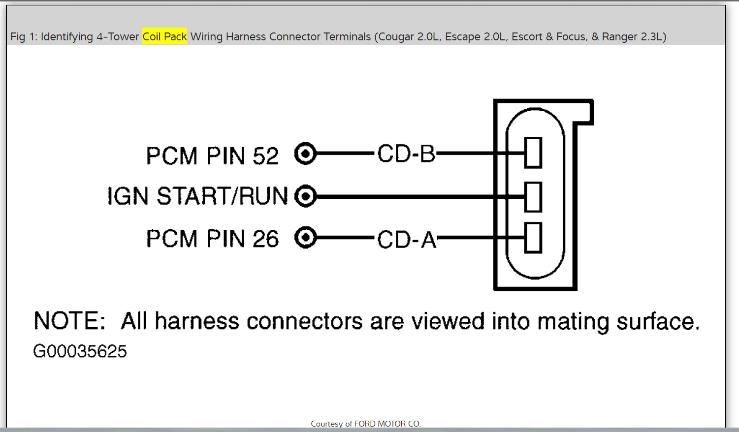

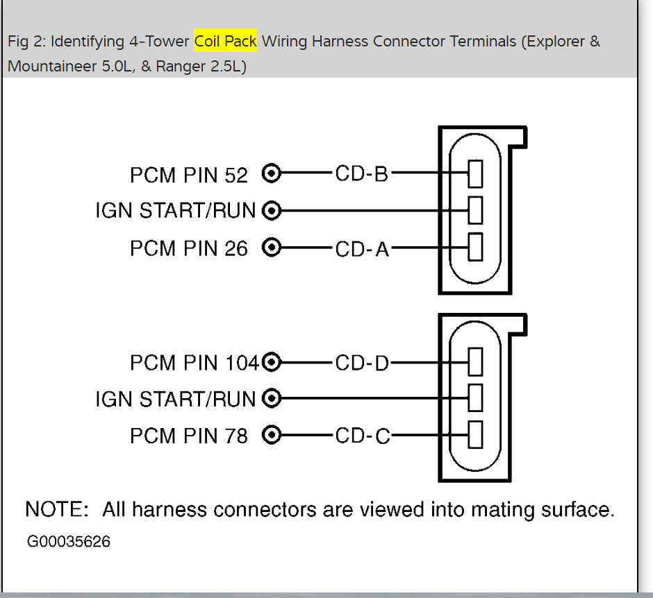

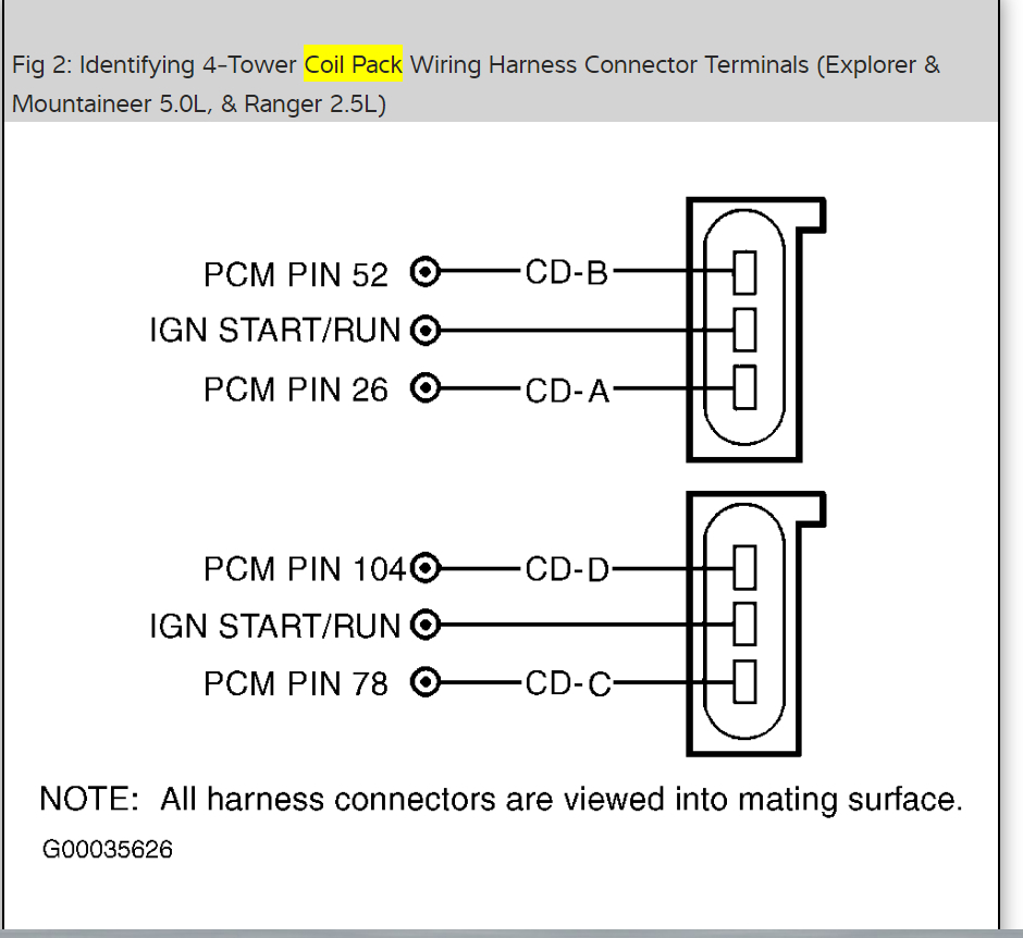

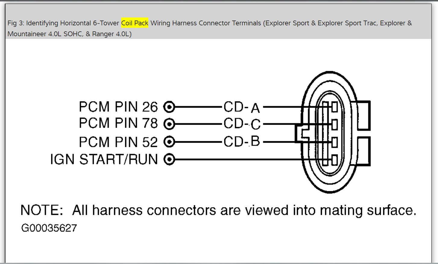

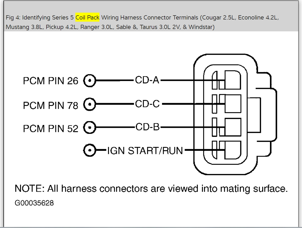

GDILGER26
  • 7 POSTS

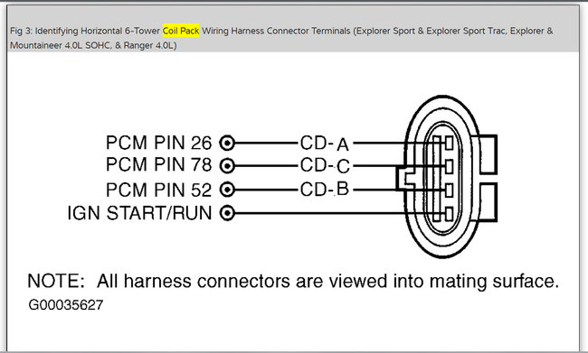

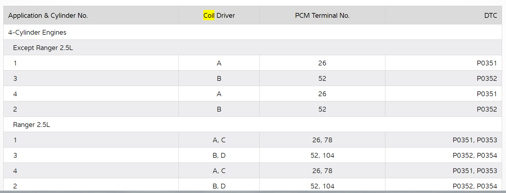

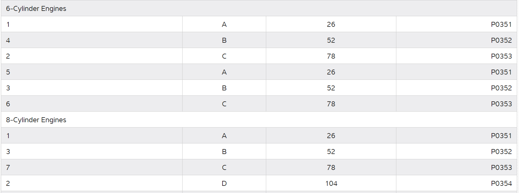

Yes, I do agree that the symptoms before I even tried any kind of repair or tune up cold have been a faulty O2 sensor. I wish I'd had it scanned before I did anything. After I had already tried the plugs and coils, then I had it scanned and wish I'd done that first. I think there's more issues now than just the o2 sensors. I noticed when I was tracing for bare wires in the harness, there are only four wires running to the front, but three coils that are two terminal connectors. Then at about the first coil towards the harness there are two wires spliced into one of the four and one runs to the center (#4) and the other to the right (6). Is that correct? I wondered if someone may have replaced the harness using one from a four cylinder engine then did that to make it work, if nothing else, just to sell it.

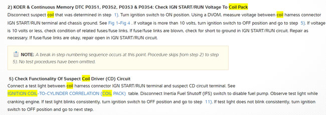

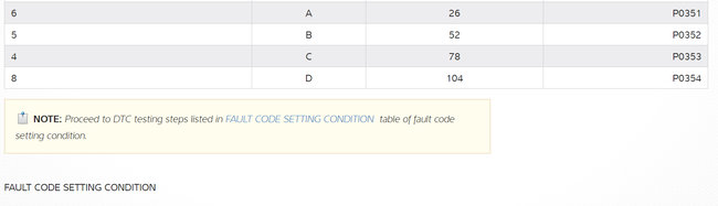

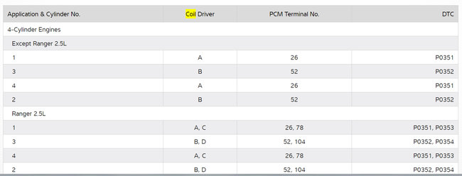

SCGRANTURISMO
  • 4,897 POSTS
Hello again,

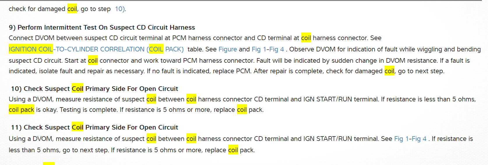

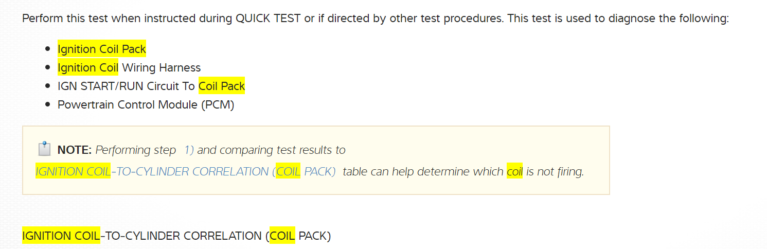

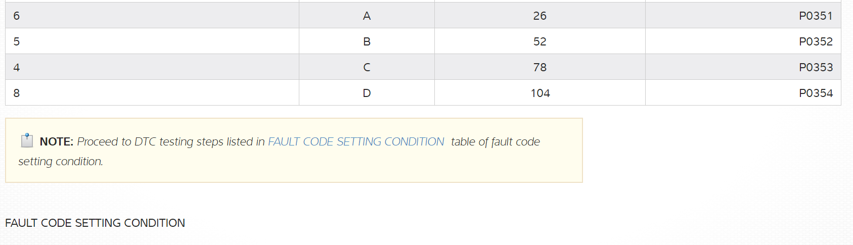

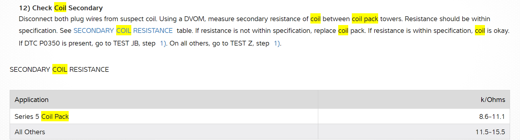

Here is the information that you requested in the diagrams below. Please go through it and get back to us with what you find out.
Thanks,
Alex
2CarPros
