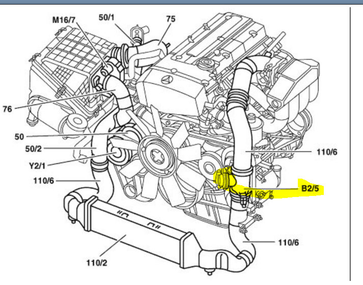

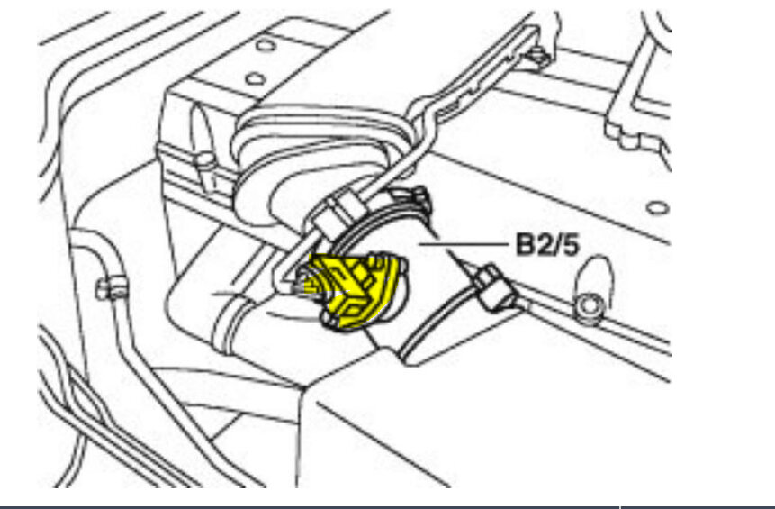

All checked, and all looks good. No leaks at all now, and all clamps seem to be holding. Thank you...
Now, back to the MAF Sensor: is there a better indication as to where it is?
Wednesday, January 4th, 2023 AT 7:41 PM
  • 110,192 POSTS
Thanks for the update. I'm glad to know that it is fixed.
As far as the mass air flow sensor, it could be in one of two places based on the engine you have.
If the engine does not have a supercharger, it will be in the air induction tube between the air filter box and the throttle body. See pic 1.
If the engine does have a supercharger, it will be in the charge air tube after the intercooler and before the throttle body. See pic 2.
Let me know if this helps.
