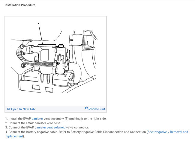

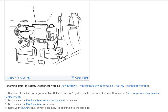

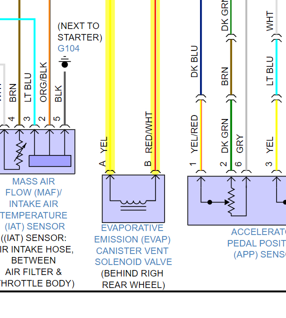

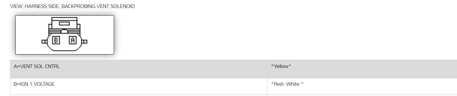

Can you give me the location of the vapor canister vent valve and how to replace it? I would appreciate it.
Apr 1, 2022 at 5:21 AM
AL514
  • 5,670 POSTS

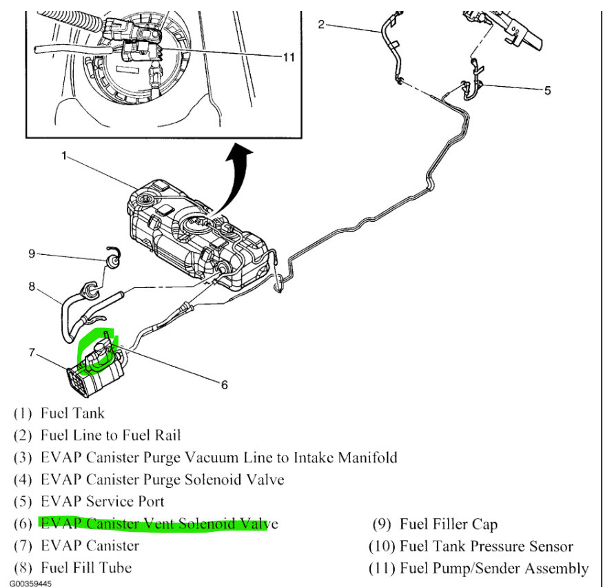

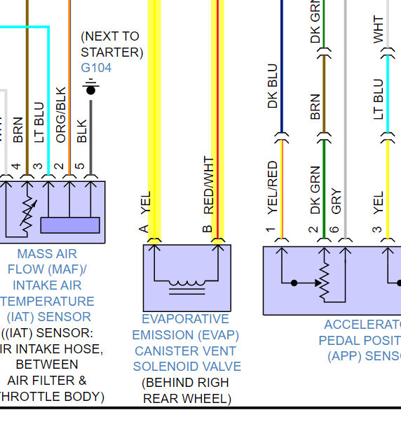

Hello, the canister vent valve is behind the passenger side rear wheel, it is attached to the canister. The charcoal canister is the big black box next to the fuel tank, you should be able to see it pretty easy. The vent valve is on the side of it. It will have two wires running to its connector. You also be able to identify it by its wire colors. It will have a rubber tube attached to it that is open to the atmosphere. They are not too difficult to change. Did you have a check engine light on for the vent valve? If so, do you remember the code number?

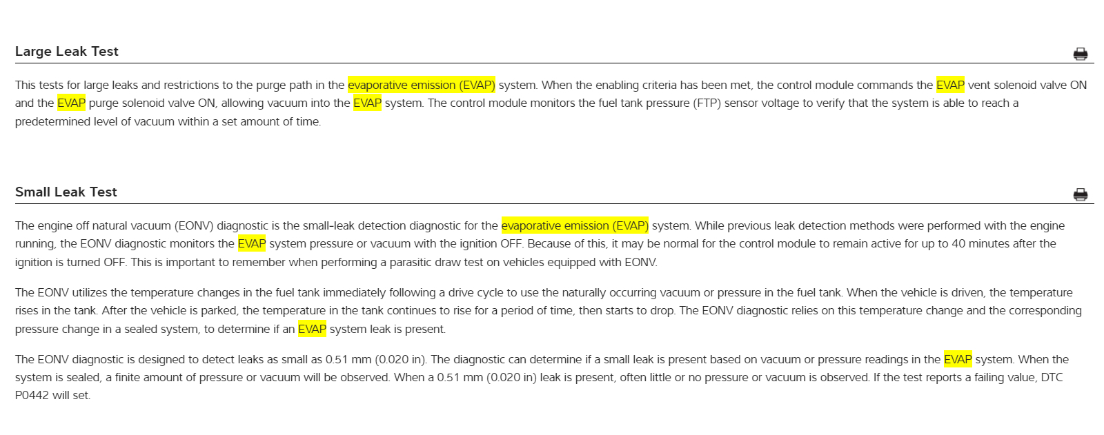

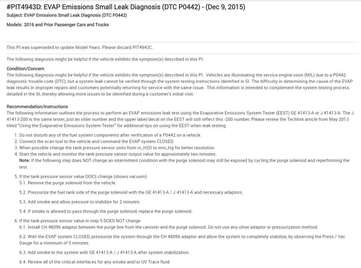

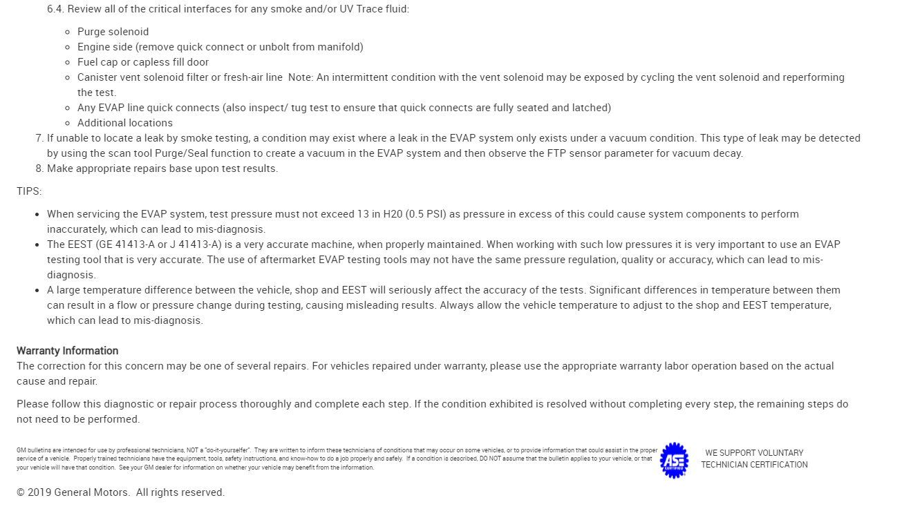

Well, the vehicle will run its own EVAP tests at certain times and conditions. The best thing to do is write down every code so you know what you're chasing. For example, there are codes for small EVAP and large EVAP leaks. Codes for the purge valve not functioning. The vent valve is not functioning. etc. The ECM can set a code according to the reading it gets from the Fuel Tank Pressure sensor when it turns on a certain component. When I have an EVAP system leak I will usually smoke test the system because the leaks can be so small, you'll never find them without a small, pressurized amount of smoke. Without a code for a certain component/ or leak, you have no place to start.

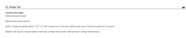

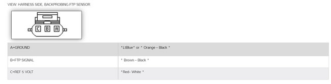

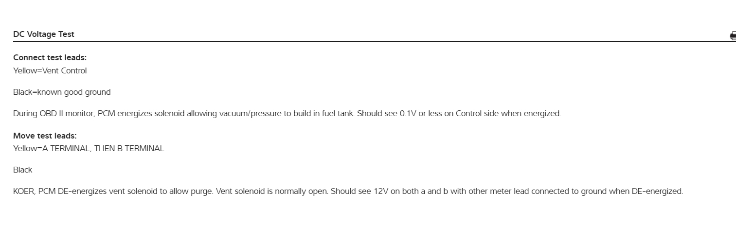

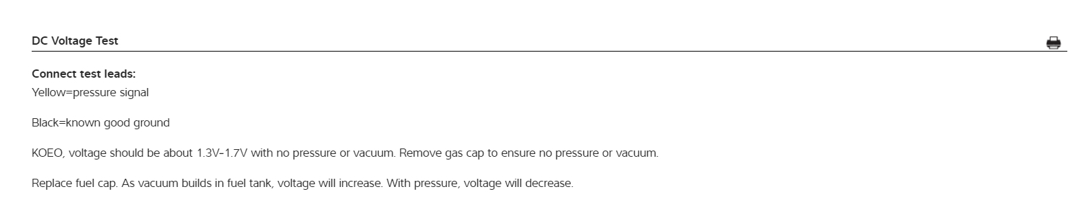

Do you have a scan tool that can read live data? If so, you can look at the Fuel Tank Pressure sensor data PID and see what it's reading while the car is idling. Next to the data PID for that sensor on the scan tool will be a value of the sensor and then a range that the sensor can be in. I'll put some testing below, but really rescan the ECM when the check engine light comes on and write the codes down. Keeping good notes of what you get for readings and codes will help you out a lot if you're learning to be a technician.
Pages 1-6 (each 2 pages is a test for a component) Page 7 is EVAP system Operations, page 8 is the Canister Purge Valve location.

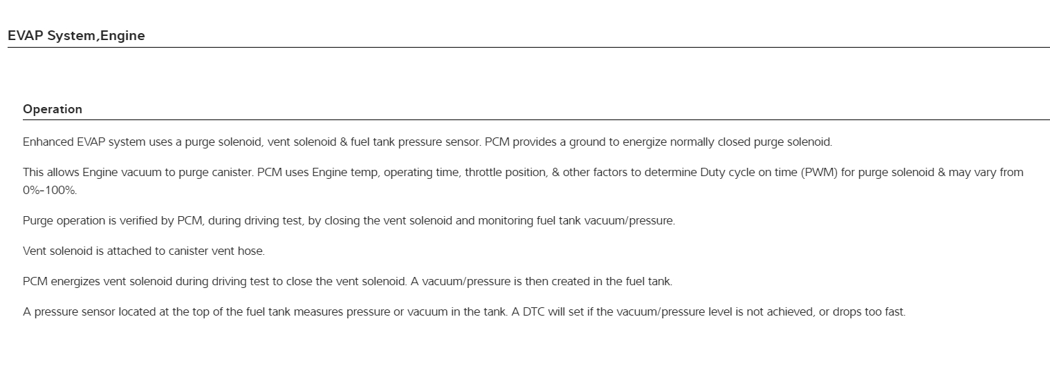

The Vent Valve you first mentioned (I put the diagram up before), is open when the vehicle is turned off. If the Vent Valve was stuck closed due to a failure, you would not be able to pump gas into the tank. That's a sign of a failed Vent valve, because the fuel vapor has no place to go.

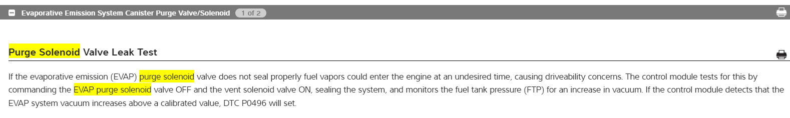

The ECM will purge fuel vapor anytime it sees pressure building in the fuel tank from the Fuel Tank Pressure Sensor.
The ECM can also set a leak code if it is purging the fuel tank vapors and does not see a rise in vacuum.
Below is a bunch of information on the whole system. But please write down the codes so we can give specific testing procedures.

No, I don’t have a high-end scan tool that lets me read what the FTP sensor is doing. I took it to a shop, and they told me the code I got was for a purge solenoid and it was stuck open. They said in order to start looking at other stuff or checking for leaks that sensor must be closed normally. So far, I have got 2 bad purge solenoids new out of the box. I'm waiting for the 3rd so I can check it when it comes in. I know the purge solenoid has to be disconnected to test it with the evap hose connecting to evap canister disconnected to see if air is coming out.

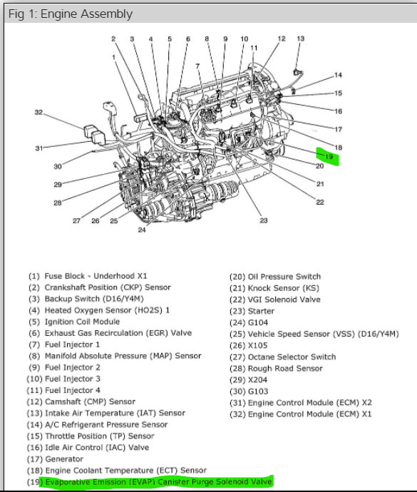

You can check the purge valve right at the intake manifold. It will have a vacuum line running to the intake manifold and another hose going back to the charcoal canister. With the Purge Solenoid connector unplugged and the engine running there should be no vacuum being pulled through the purge solenoid. Were you getting vacuum coming threw it with it unplugged?

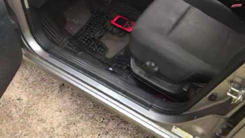

Here’s the video of the third purge valve solenoid that is stuck open. I honestly don’t know what to do with this car. I don’t know if it’s a wiring issue or bad parts out of the box. The shop I took it to before says you need to make sure the valve is closed and not stuck open before you make any more diagnosis. Let me know what you think might be going on. I made these two videos talking about what I done.

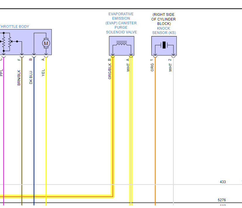

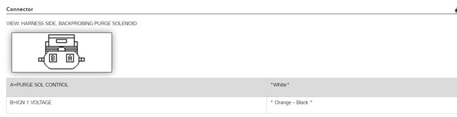

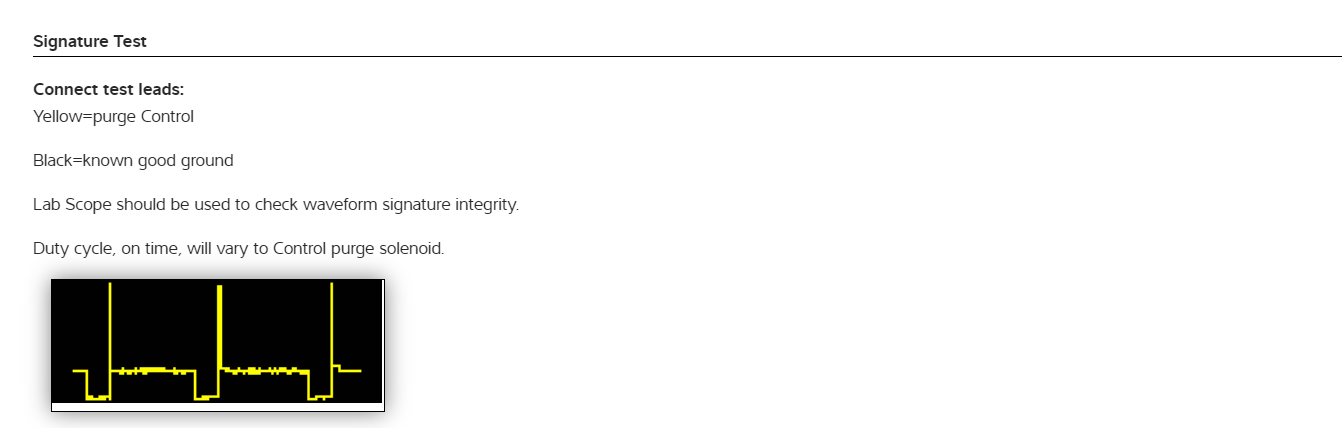

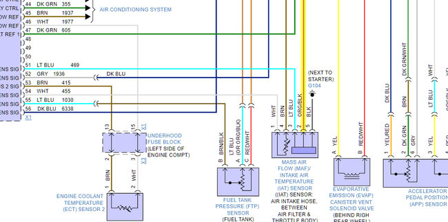

Okay, I just watched both videos, and you're correct, you shouldn't have vacuumed at the Purge valve with it unplugged. The ECM supplies 12 volts to one side of the Purge valve and controls the valve on the Ground side. Where are you getting these valves from? Is it an aftermarket place? The RPMs are jumping around because basically you have a vacuum leak through the purge valve back from the evap system. It's purging when it's not supposed to. Are you positive you have the valve lines hooked up correctly, it's not possible to put the lines on backwards at all? Three bad valves seem unlikely. But I saw you unplug it. This P0443 is a circuit code, So the ECM is monitoring the Control side (Ground side) for the purge valve ECM driver's state. With the valve off, there will be 12 volts on both sides of the valve, when it is energized, the 12 volts on the other wire of the purge valve will go to ground (so around 0 volts). This is a pulse width modulated circuit, so the ECM pulses the ground side to control the solenoid.
The code criteria are Open/High resistance or short to voltage on that control side. Do you have a multimeter? If so, I would see if you have voltage on both pins of the purge valve plug, with it unplugged and key On.
But again, that doesn't explain the vacuum issue.
The other code is being set by the open purge valve.
The fact that the code is a history code at some points indicates it's an intermittent issue.

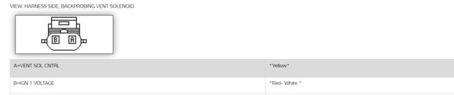

The orange/black wire is the 12-volt feed at Key On. The other wire is to the ECM.

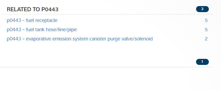

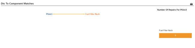

I don't see any technical service bulletins on this issue either. You might try asking the dealership you got the part from if they have seen an issue like this. To me it looks like a 3rd bad part.

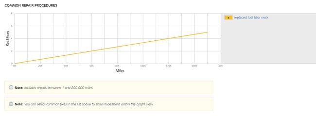

But there is some odd information here, some common repairs for this code are "Replaced Fuel Filler Neck" "Replaced Fuel Receptacle".
I would try tapping lightly on the valve while it's running and see if it closes while it's unplugged. I'm wondering if you're putting the new valve on the car and the ECM is opening it and the vacuum is holding it open somehow. Try turning the car off and leaving the valve unplugged, then start it back up and see if it's still stuck open. Thats the only rational thing I can think of besides another bad valve. I'm assuming you returned the other valves already. This is a strange situation for sure. But try those couple of things and see what happens.

The filler neck replacement was just in the information we got through All Data and Mitchell. Where we get wiring diagrams and such. There was a record of five times the filler neck was replaced, but that's only when other technicians actually put that information into those data systems. But they would replace it for a leak, yes. You would need a smoke machine to test the evap system for leaks. Thats what we use to detect leaks. But as for that Purge valve, I would check that the purge valve is closed with the engine off. When the car is at a cold start up and the idle is high there is a lot of vacuum pulling in the intake manifold. If that purge valve is closed when the car is off, i would say its okay. The evap system is normally pulled through a small diameter tube and when it's open like that with the evap canister tube off it might be keeping it open. But the code you're getting is a circuit code. So, you need to check if there is any voltage with that purge valve unplugged and just Key On. If you have voltage on both wires, then the control wire is shorted to power somewhere. Thats what the ECM is detecting and setting the code for. It monitors that control wire so it can set those type codes. I just think there's something else going on here, the purge valve might not be opening like that with the tube attached.

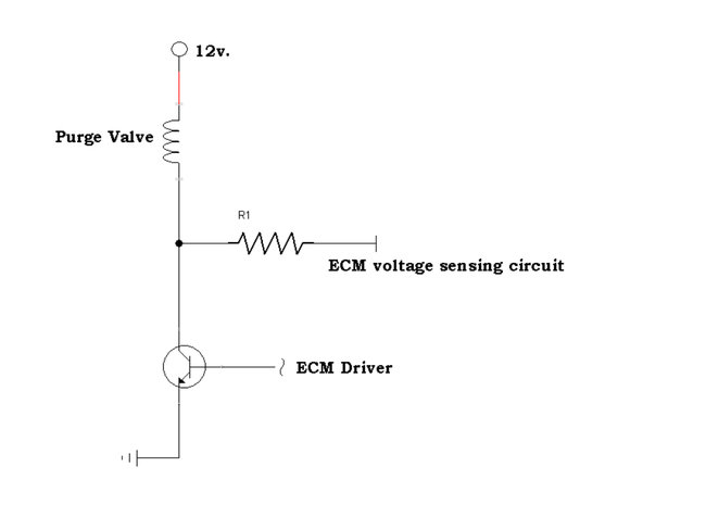

One wire is a 12-volt feed the other wire is the control wire which is ground side controlled. With it unplugged and Key On it should have only 12-volts on one side. The testing is below.
I believe the test with it unplugged and the control side reading 2.5-3.5-volts might be a bias voltage for testing. But you have no way to bi-directionally control the solenoid with a scan tool so you can't do the third test.
You can also check the White wire with the Key Off (which is the control wire going to the ECM) with your multimeter set on ohms and see if you have any continuity to battery negative or the engine block (Ground). The orange/black wire is the 12-volt feed to the solenoid. So, if you have 12-volts on both wires with it unplugged then there is a short to power on the white wire somewhere. Or a failed ECM.
You should have 12-volts on orange/black wire and 2.5-3.5 volts on the white wire with it unplugged and Key On. Engine Off.

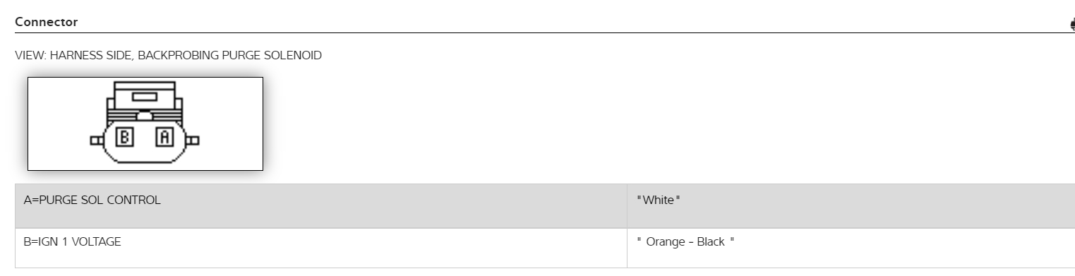

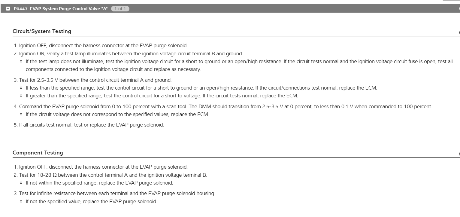

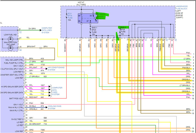

AL, you are the best. Thanks for the explanation and all this helpful information. Here's what I checked.
Circuit/System Testing:
Test 2. With the ignition on the test lamp lit touching battery ground and power to orange, black/white wire terminal.
Test 3. I needed to have 2.5-3.5v between the control circuit terminal A and ground. It was at 2.9v with the ignition on.
The info says if the circuit tests are normal you need to replace the ECM.
I also think you were referring to the 4-5 tests to use a scan tool. The third test was checking voltage and i was able to check that with my digital meter.
Component Testing:
Test 2. It says to test 18-28 ohms between control terminal A and the ignition voltage terminal B. I got 21 ohms.
Test 3. It says test for resistance between each terminal and the evap purge solenoid housing. I got around 21 ohms...but i don't know what it meant when it said "and the purge solenoid housing" I tried to test the housing and got out of range. But i got a reading for the two terminals for the component.
After the tests, it tells me the circuit is good and the purge solenoid is okay. But what could be causing the two codes, P0443 and code P0496 to come back after i clear the codes and the time it idle rough or stall on me? Can a bad ECM really do this?
How can i be sure the ECM is the problem? I know you said other techs replaced the gas cap and fuel filler neck. One shop kept blaming it on the purge solenoid. Saying he blown into it and power to it, and it wasn't working. That was the first one i replaced. But the other two I didn't blow into it because I don't have a power probe to put power to the solenoid. What is your suggestion now before wasting any more money? I bought this part at a dealership, and they said they would exchange it for the same part. But this is the third sensor i will be replacing. It can't be over and over the same thing having to keep replacing the sensor.

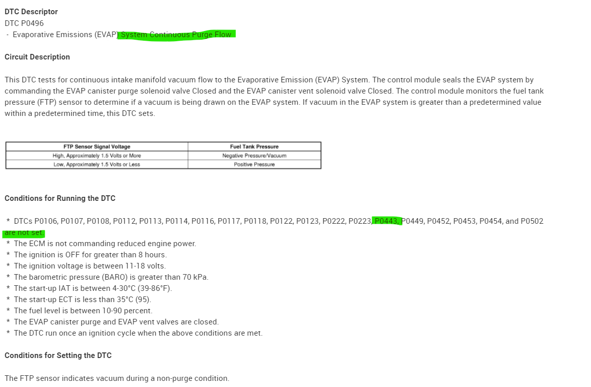

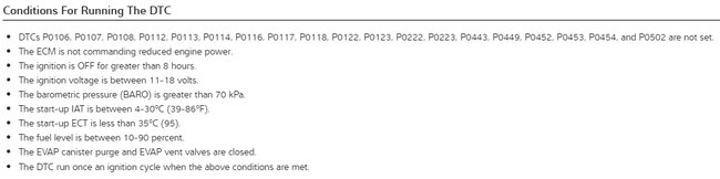

Well, there's a few possibilities for both of those codes coming back together so fast. The ECM runs a self-test on the evap system at start up. It closes the Purge valve and the Vent valve together. Those are the only 2 valves on this system. With those 2 valves closed it then watches the Fuel Tank Pressure sensor to see if too much vacuum is developing during a pre-set amount of time. Thats how the p0496 code is set. The Code description is "Fuel Tank Pressure Sensor indicates vacuum during a non-purge condition". I'm assuming you had 12 volts (or battery power) on the orange/black wire with the Key On. And 2.9 volts on the other White wire.
Those are correct readings.
The P0443 is the ECM either detecting something wrong on the Control wire (white wire) for whatever reason, Short to Ground, Short to power, Or open circuit. But you don't seem to have any of those. If you did, you would not be getting the 2.9 volts. If it were a short to ground, it would be 0 volts. Short to power you would have 12v. Open circuit you would have OL on your meter. And yes, a failed ECM can do all kinds of things. But before condemning the ECM you would have to check all of its Powers(12v) and Ground connections. Thats a rule of thumb before condemning a module. Plus, they can be very expensive. At this point considering you are low on the diagnostic equipment a shop would have, I think I would try 1 more purge valve from the dealership if they will give you a trade in. But this time, tell them what's going on, Every detail. Dealerships will see these type of issues more than any other shop would. They might know right away what is the most common cause for both of these codes together.
To be honest the running condition for the P0496 is that the P0443 is Not Set. I don't want to guess what is happening and have you replaced an ECM just to have the same codes come back again. At that point you will be beyond frustrated. You wouldn't even be able to replace the ECM because they need to be programmed to the VIN.
On both of our databases if the voltage readings are within limits, it replaces the ECM, but that is always a definite last thing we want to do.
But I think you should ask the dealership if they have seen this issue, there is no technical service bulletins yet for this because the car is probably not old enough and they haven't seen this issue enough to send out a TSB on it.

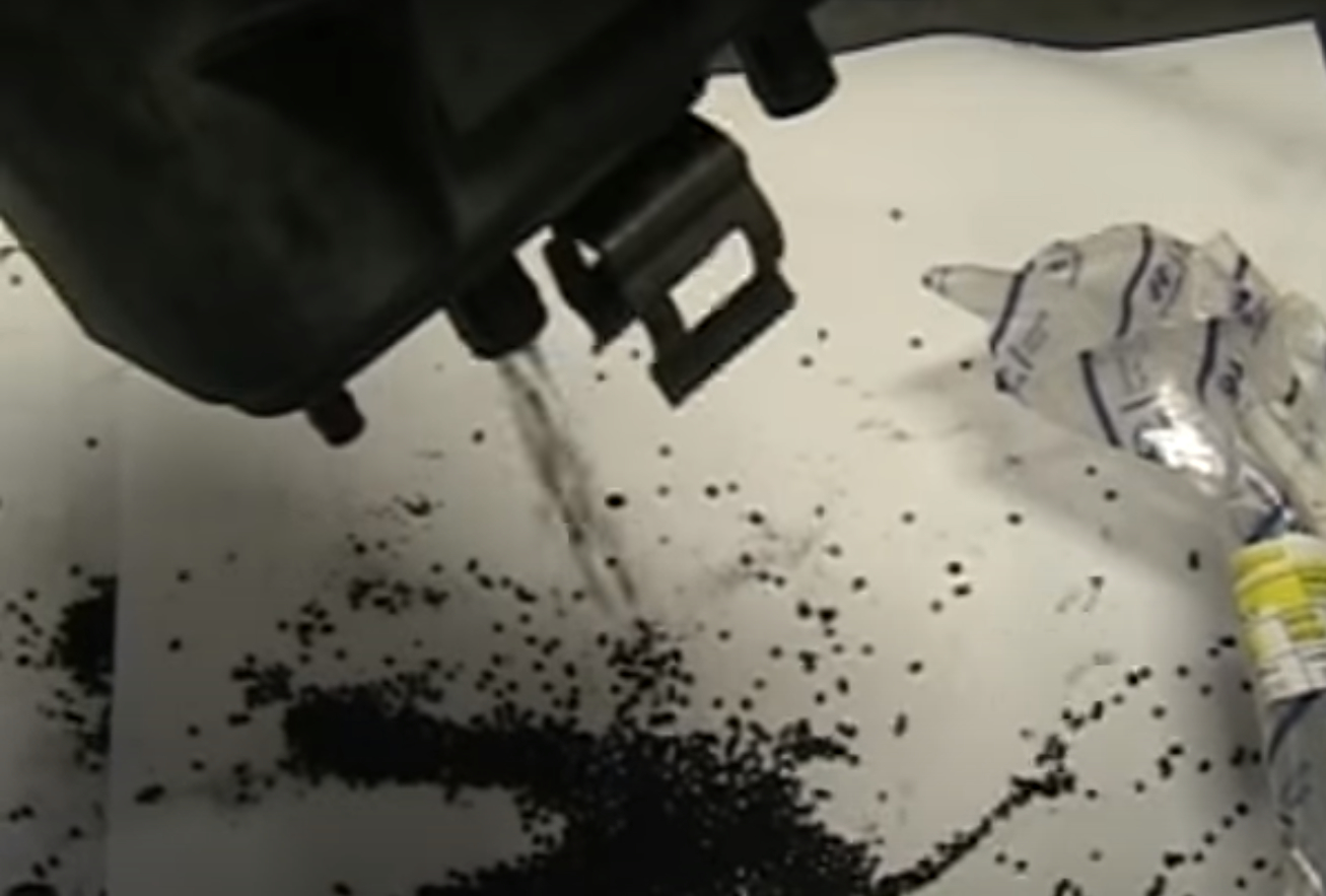

One extra thought here, I had someone suggest checking the new Purge valve before you return it for any pieces of the charcoal canister in the valve keeping it open. I hadn't thought of that. A failed charcoal canister with debris going through the evap hoses. Or even take the canister off and shake it, see if any pieces fall out.
Here is a picture of a failed charcoal canister. It can be caused by overfilling the gas tank after the handle has already auto-shut off.
This also explains the codes, the purge valve is actually stuck open and that is completing the circuit, so the ECM will see 12 volts on the control side without commanding the valve on causing the p0443. The flow without being commanded on is causing the p0496.

The charcoal canister didn’t have anything coming out of it. I had that off a week ago and I also tested it by blowing into it with a vacuum hose and air came out the other vacuum hole. I will shake the new purge to see if anything comes out. It probably won’t.

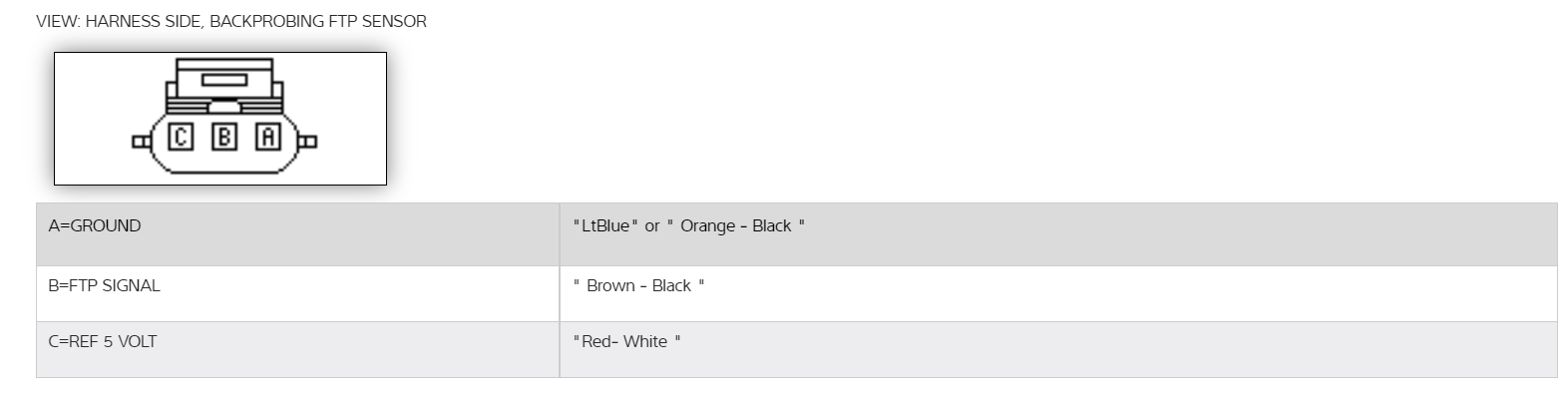

But I didn't know you were getting the P0496 first, that can be a Fuel Tank pressure sensor issue, or the sensor is showing the issue. If you check out on you tube some video's on how the purge valve works on Chevrolets it will give you a better idea of how things are controlled. The Tank pressure sensor is an extremely sensitive sensor, it doesn't measure like other pressure sensors, it measures in H20 which is very small amounts of pressure, that way it's very accurate.

Okay, yeah so, you've got some other weird issues going on too. I'm assuming it fried to 100amp fuse for the charging system? And the 11volts isn't good either. Another concern would be with the old alternator over charging the system, which means that there was higher than normal ac voltage ripple. A healthy alternator has a set of diodes in it that change the ac voltage into dc voltage that the ECM can handle. When alternators go bad, even just the regulator, if it didn't damage the diode trio it's still going to be outputting a higher-than-normal ac voltage. if it did damage the diodes, who knows how much ac voltage was hitting the ECM . At this point I might even measure the ac ripple just to see where it is at. Most people will say it can go up to 100mv but I don't like to see over 50mv. I guess that is beside the point now, but it's hard to tell if any damage was done to the ECM during all this. 11 volts on an actuator circuit is not a good sign.
I'm going through the wiring diagrams right now and noticed a few strange things. Are you getting the 11 volts while it is running? Because I assumed, and that's never a good thing, that the purge valve was getting powered up directly through the ECM , but that's not the case. I'll put the diagram below, it gets its power through the EMS2 EF25 Fuse. That fuse also powers up two oxygen sensor heater circuits, the mass air flow sensor, and the purge valve. If the purge only has 11 volts on it, then the rest of these components may only have 11 volts too.
So really you should be reading almost full battery power on the purge feed wire. You might want to go through the fuses in the driver side under-hood fuse panel and see if you find anything strange going on in there. You can see the other fuses in the diagram that are located in that box.
And if you find 11 volts on that fuse, I would do a voltage drop test while the car is running and turn some lights and accessories on to load the charging system. Put your meter on that fuse and the battery positive. That will tell you the voltage potential or voltage that is being lost from the battery positive to the fuse. Which really should be close to nothing.
And do the same for the ECU EF 14 Fuse 10amp. If there is a difference between those two fuses, then there is too much voltage drop across that Engine Main Relay. If it's 11 volts on the ECU fuse, that is a problem. That feeds directly into the ECM pin 12 X1 connector.
I know we're getting away from the purge valve here a little, but we should make sure that this 11 volts isn't happening everywhere.
Also go through and check the rest of your ground connections. To the engine block, to the chassis, because this ECM only has one ground connection. And it's down near the starter. It's a black wire. I'm surprised the ECM only has one ground, that really can cause so many issues. Is that the one you found loose?

The reason for the p0443 was that when the valve was open, it was essentially completing the circuit, and the 12volts was going right threw the valve back down to the ecm on the control wire, and that wire has a voltage sensing circuit on it. So every time that valve bounced completely open it would be sending voltage to the ecm and the ecm saw that as a short to voltage and set a code. A made a little diagram (2nd) so you can see how it detects the voltage reading. Hopefully the new valve is not damaged. You might want to check its resistance after it gets hot, like after a good drive. Most electronic components malfunction either really hot or really cold. sorry for the long message..

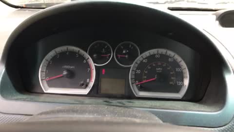

Hi AL, I wanted to give you the progress on the purge valve sensor. I drove it for a long time today on the highway, no major highways, just around city highways. It drives fine, but still lacks engine performance. It could be a lot smoother and when you step on the gas to accelerate it feels like it lacks performance like its delaying power. I know city driving always sucks and on highways it always drives greater because you are traveling at higher speeds and not stopping much.
As I mention above in the video pointing out rpms, on occasions the RPMs would rev on its own as if you were making a complete stop slowing down the vehicle down, when sitting at a light idling, the rpm would rev itself to 2,000 RPMs on its own and the engine would surge, the car would feel like it's pulling itself down the road when it's supposed to be at a complete stop, normally when you are at a complete stop the rpm needle should not continue to rise unless you are stepping on the throttle if that makes any sense. Today all it did was rev to 1000 rpms at a complete stop for about two seconds when the car was stopped at a red light. The car didn't continue to pull itself down the road like it would do before. It was steady with no engine surge.
When I came home, I rechecked for any codes. No light came on ever since i repositioned the sensor because I remember I told you i connected it wrong and that was the reason the P0496 kept coming back. But when I checked for codes, the only code I still saw stored in the ECM was the P0443. There wasn't the P0496 anymore because the drive cycle must have cleared it on its own. I retested the circuit and component. Voltage and resistance were still in range. Battery power is at 12.5v with the car off now. I replaced the battery. The battery wasn't holding the correct CCA.
