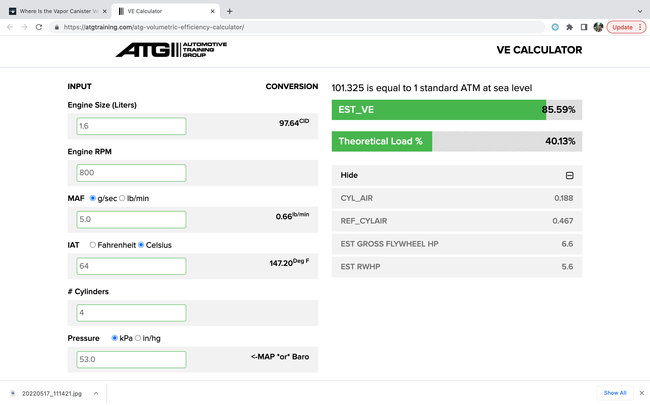

Try this, (webpage below), It is a VE test, volumetric efficiency test using data numbers.
You put in the numbers you're seeing on your scan tool, and it will tell you how well the car is breathing.
https://atgtraining.com/atg-volumetric-efficiency-calculator/

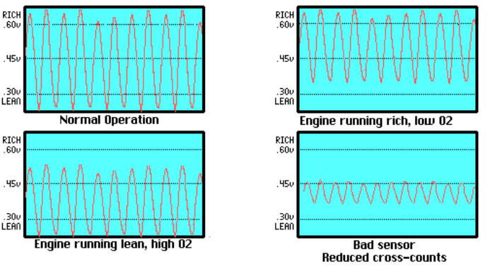

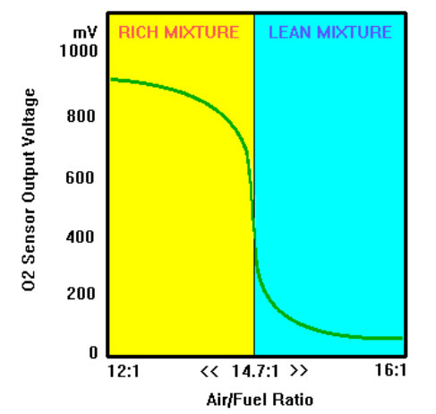

https://www.2carpros.com/articles/how-an-oxygen-sensor-works
https://www.2carpros.com/articles/how-to-test-an-oxygen-sensor-02-sensor

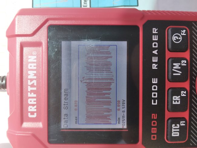

0xygen sensor voltage readings: at idle, acel and decel
O2s bank 1 sensor 1- swinging from 0.95v to 840v
02s bank 1 sensor 2 - does not reach below 600v, it can go as high as 850 but stays around 700.

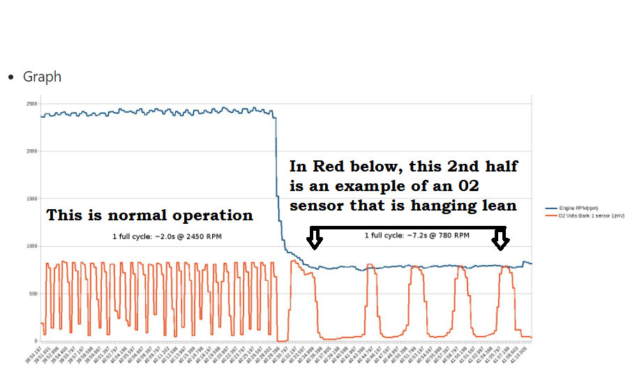

Here is the graph I attach also of the o2 sensor bank 1- sensor 1
You see how the current changes in the middle? That is when the rpm needle surges at idle.

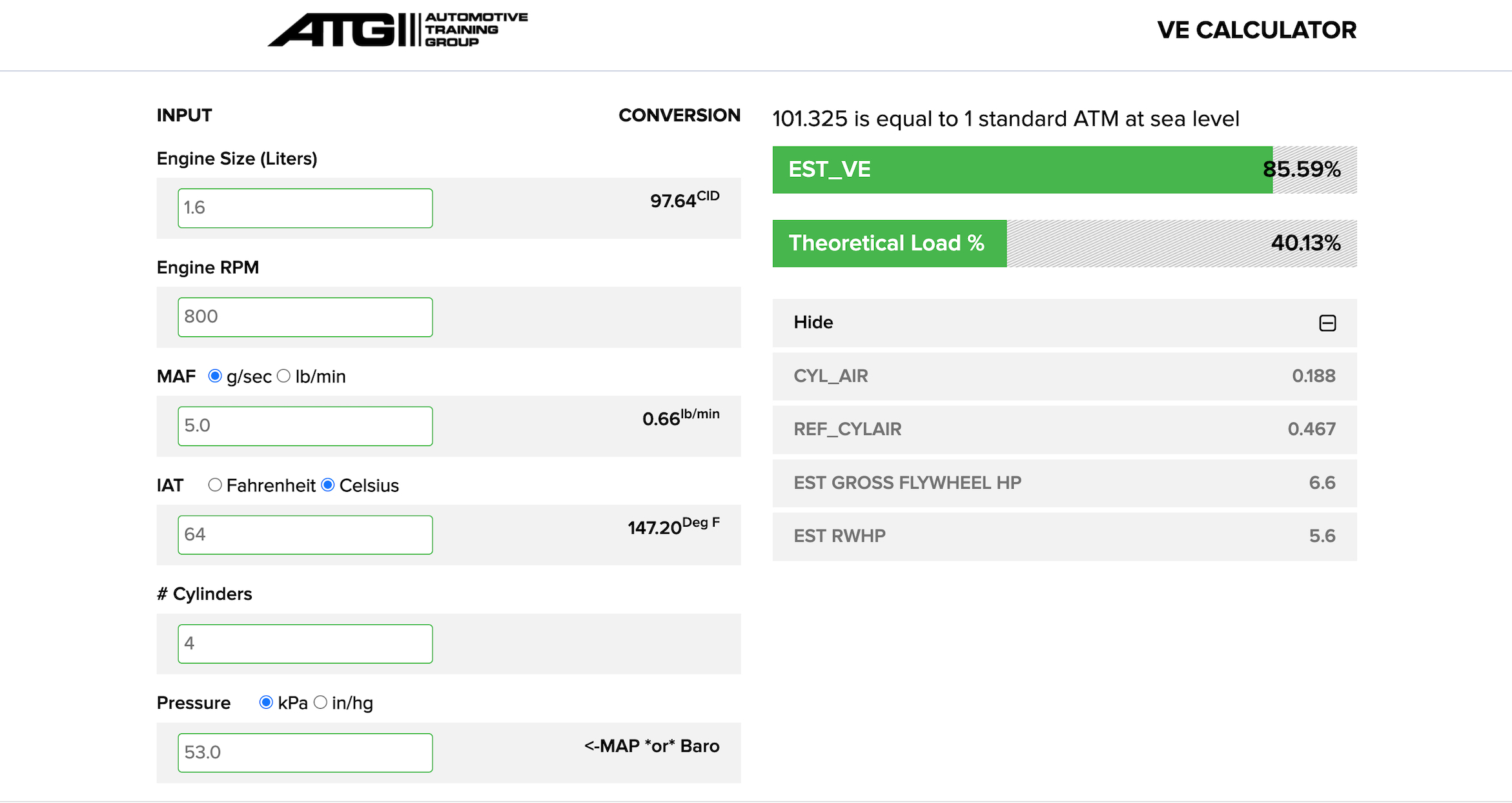

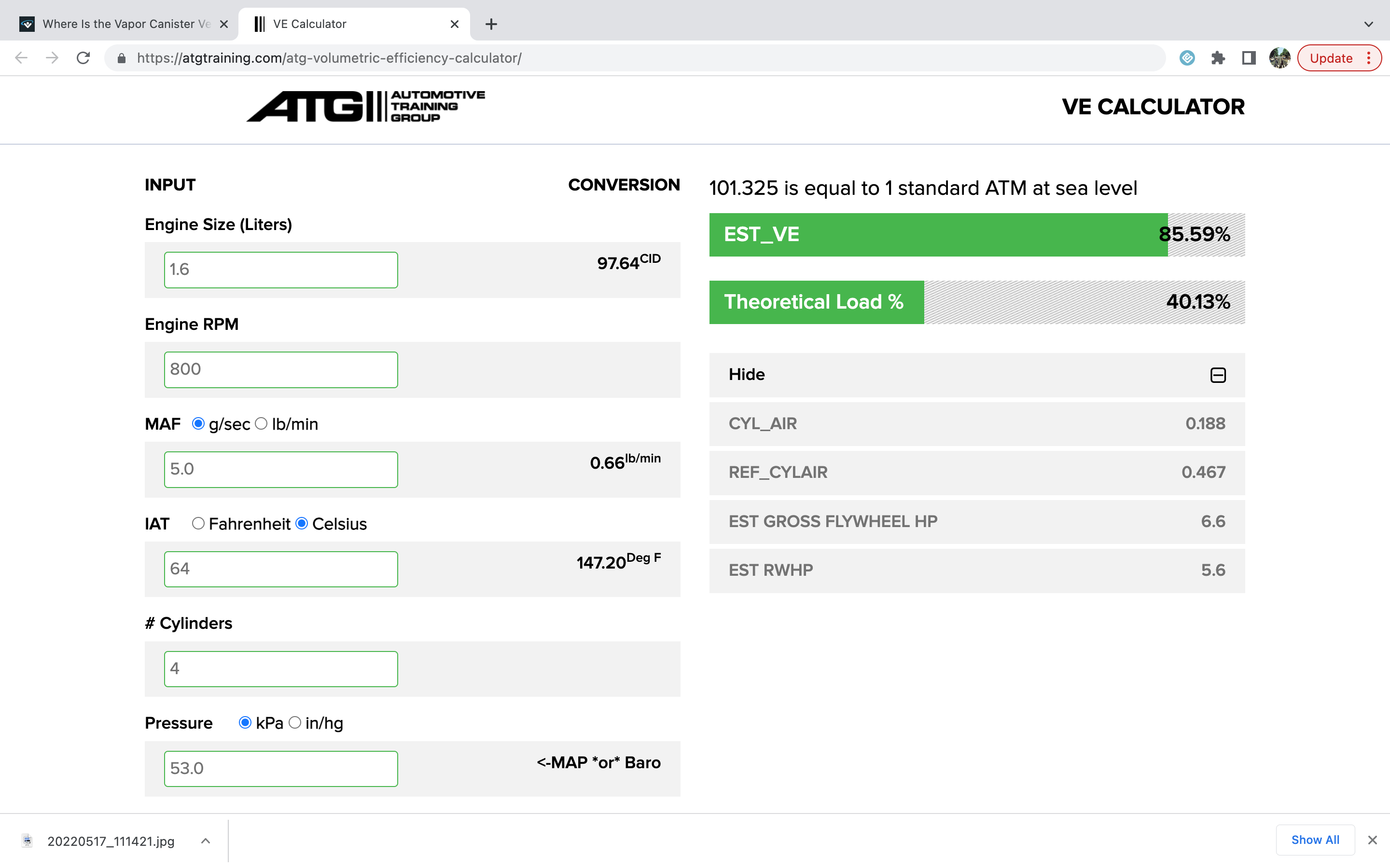

Here is how the engine is breathing also.

Don't worry about anything below %10+/-. That amount of change is going to happen.
It seems the idle surge on the brake pedal is really the concern, correct? And does the idle surge if it's in Park and you're not on the brake pedal?
So far you have done the VE test and it came out really good. So, the converter is not an issue. The front 02 looks great. That little flutter in the middle is the ECM correcting its fuel strategy. We just need to find out why you're getting an over rich condition intermittently. You might have a fuel injector that's sticking when it's hot. I'll put a link below for a Fuel Injector pulse kit. So, you can do a Fuel Injector balance test when the vehicle is hot. Thats when your issue is happening.

On your 02 graph, you can see it goes rich for a split second, then goes lean for a second. That looks like a fuel injector sticking open on decel and the ECM compensating for it. I would try the injector balance test while it's really hot, so right after a long drive. It doesn't look like it surges for very long. Your fuel pressure spec is 53-60psi. While the pressure gauge is on the rail make sure the pressure doesn't drop off suddenly either.
