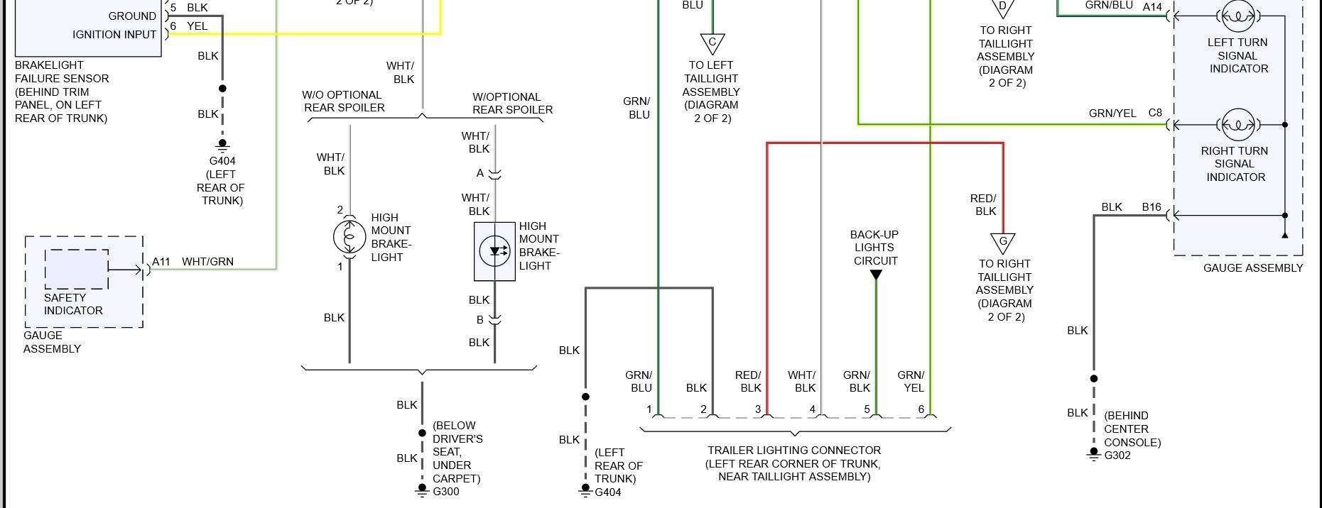

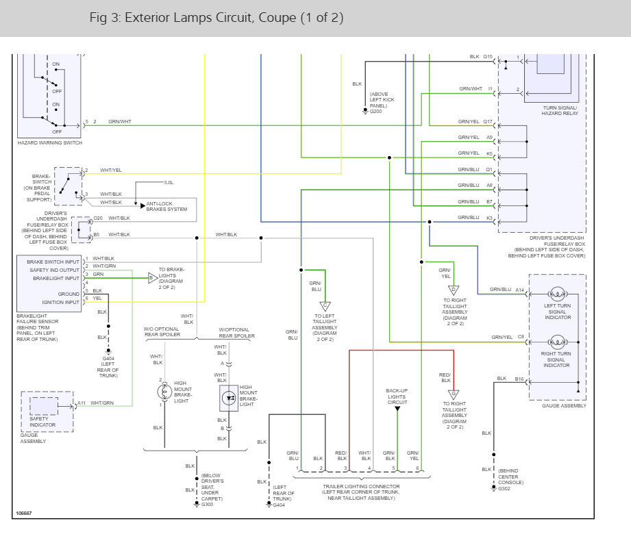

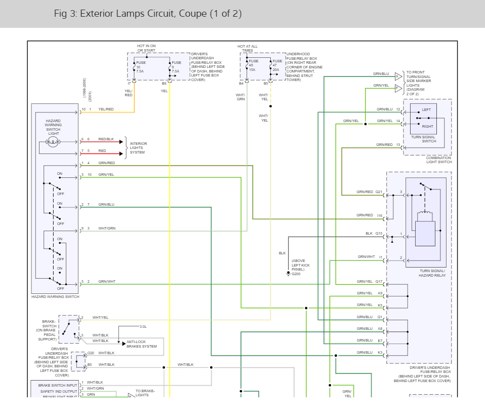

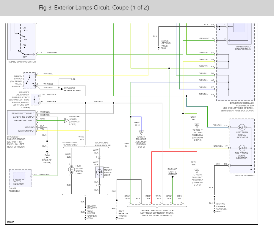

I noticed that when my headlights are on, my right turn signal goes slow. When my headlights are off, they go fast. I just tried changing the bulb and that didn't do anything. What else could this be?
Monday, May 17th, 2021 AT 12:22 PM (Merged)
94 TRANSAM
  • 680 POSTS
It sounds like you either have a bad ground or low circuit voltage.
I would test your battery ground to the motor, frame and body and then test your lighting ground. You should read 0.04 ohms at each location.
The ground locations are noted in the diagram below. There are 4 in total.
Also test the voltage at the battery while running. This should be around 14.5 volts. If it reads 13 or less your voltage regulator had failed.
I would do an alternator check here is a guide to help you.
Check out the diagrams (Below). Please run this test and get back to us.

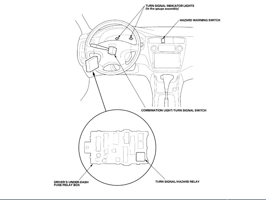

It could be the turn signal flasher relay contacts are wearing and causing resistance this will slow down the flashing when the system takes on more load like turning on the head lamps. Check all the exterior lights be sure they good and bright like they should be a blown bulb or poorly lite bulb will indicate an electrical problem in the power or ground circuit. I'm attaching repair guides and turn signal flasher relay location below. Let us know if you need more information for this problem and we will get for you.
https://www.2carpros.com/articles/turn-signals-not-working-blinker
Thank you
TONYSBABYGIRL
  • 67 POSTS
I understand where the flasher relay is, but now how do I test it? Can I do it with a test light that I use on my fuses? If so, how?
