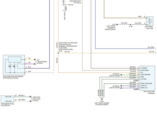

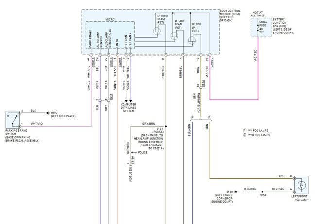

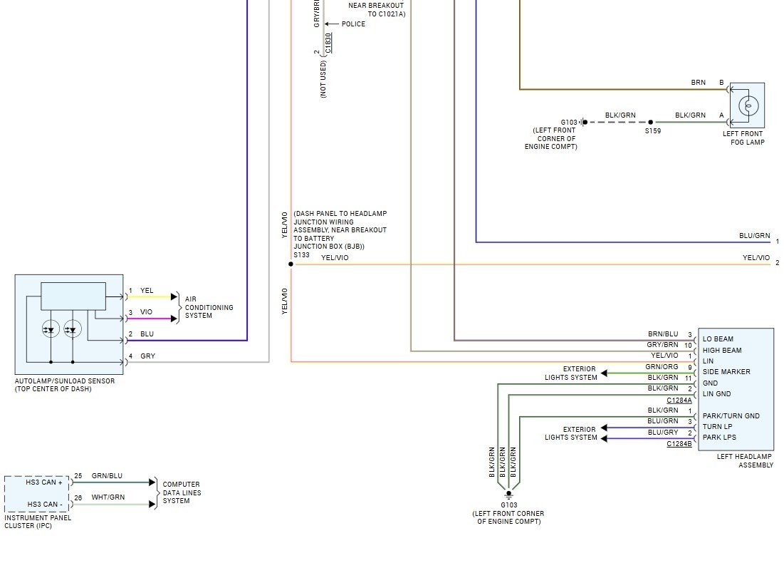

Drivers side low beam LED lights not working. I replaced LED headlight module. Only 1 of hot pin at the connection.
Mar 13, 2025 at 12:33 PM
STEVE W.
  • 15,172 POSTS

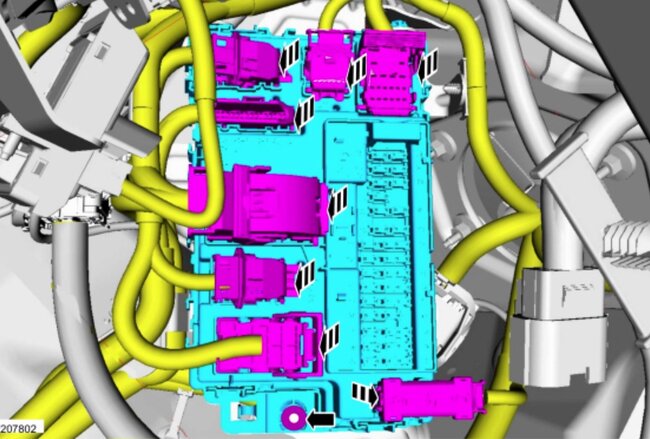

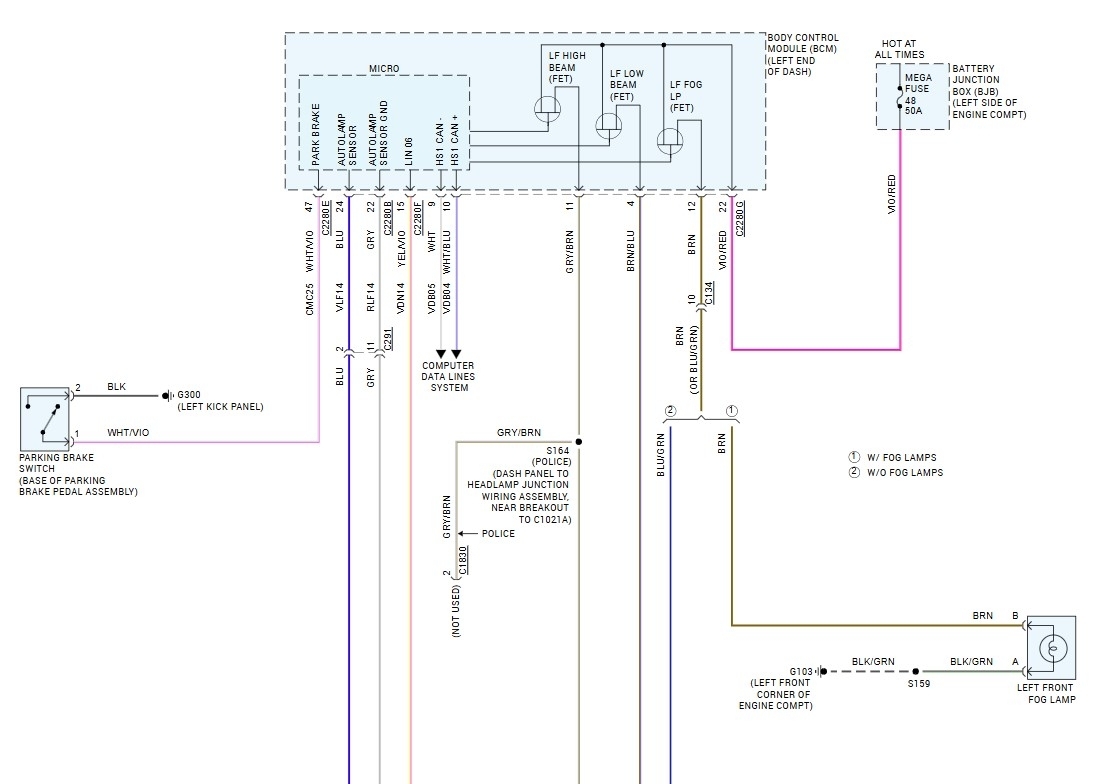

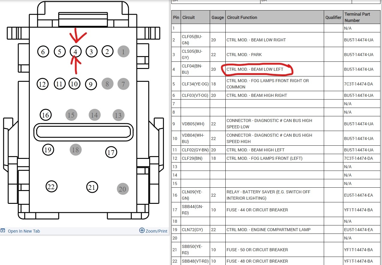

Looking at the wiring it looks like the low beam is fed directly from the BCM which is a common failure item. However, to be sure a couple of tests should show the issue. You say it's low only? High and marker work? If yes, then it isn't a fuse or ground issue as those are both shared. That leaves the BCM or the wiring. Grab a simple test light and go to the connector for the left side module. Turn on the low beam lamps. Now use a needle to slip between the wire and the insulation in the back of the connector (back pinning) at the Brown wire with blue stripe. Connect the test light to a known ground. Does it light when you touch the needle? If yes there is a problem in the connector or in the headlight assembly. No light = go to the BCM at the left side of the dash and find connector C2280G and the same Brown blue wire. Use the needle to go into the back of that terminal, does the light come on? No- replace the BCM. However, unless you have a dealer level scan tool with TPMS abilities and at least 2 keys for the truck you may want a shop to handle the repair.
