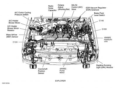

The headlight'd are controlled by the DRL module ... check the wiring & fuse #15 in underhood fuse box ??
Daytime Running Lights (DRL) Module Behind left headlight. See Fig. 1
