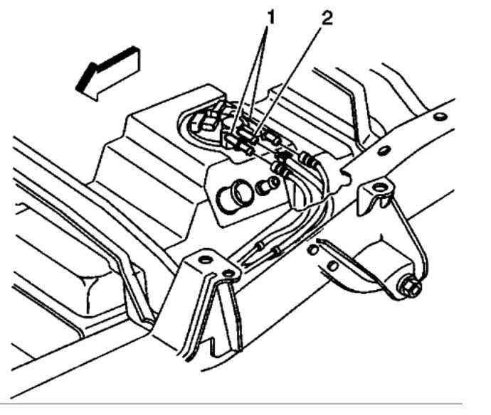

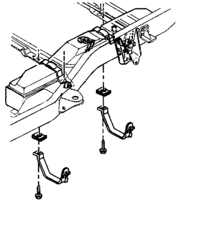

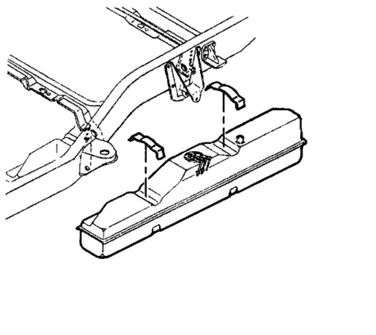

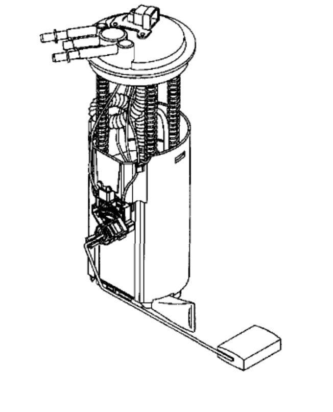

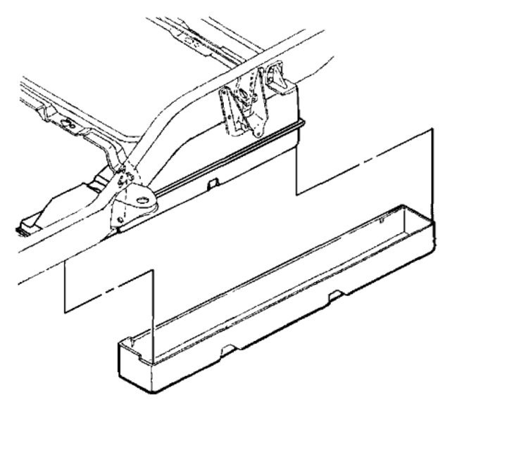

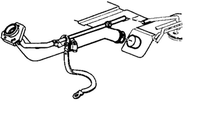

It sounds like the fuel pump is going out which is common. Here is a guide that will confirm the problem:
If you have no pressure the pump is probably bad. Here is a guide that will show you what you are in for when doing the job:
https://www.2carpros.com/articles/how-to-replace-an-electric-fuel-pump
Here are some diagrams to show you what it will be like on your car.
