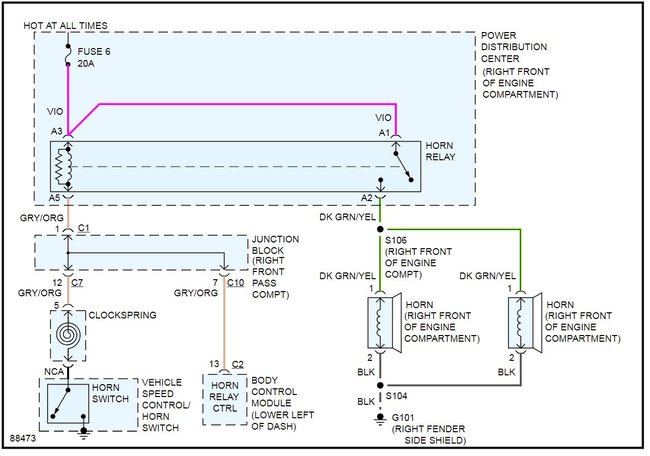

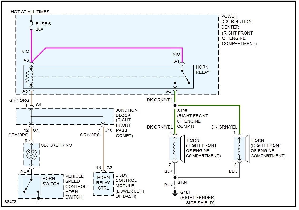

I was curious to see if you guys know how to fix my horn? I have a 1998 Jeep Grand Cherokee and it's just doesn't make any noise at all. Thanks!
Monday, November 11th, 2019 AT 6:03 PM (Merged)
BLACKOP555
  • 10,371 POSTS
First thing to check is the relay and see if its clicking when horn button is pushed. if not check the horn button and the relay. if its clicking and no horn response check the wiring and the horn.
Heres a guide on testing wiring
Attached below is the wiring diagram for your horn
