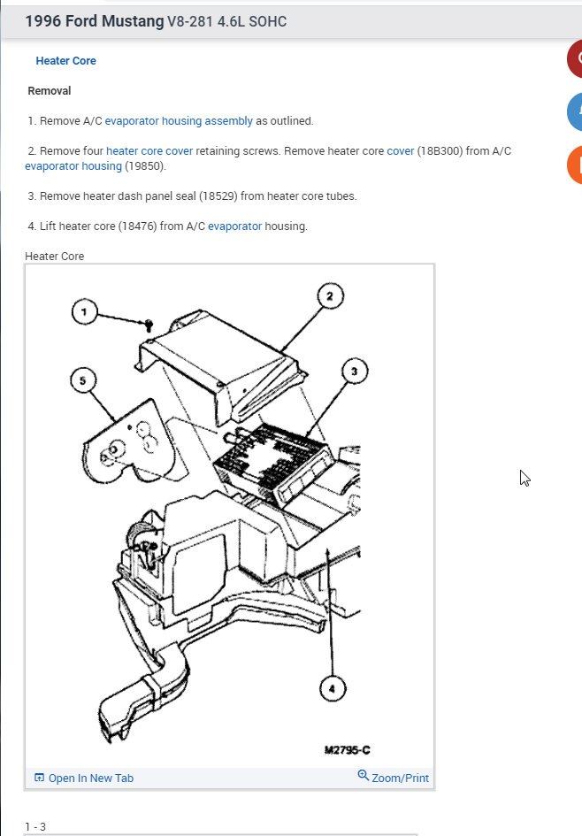

Cars overheating and I got smoke pouring into the car from the vents or steam. Is it the EGR valve?

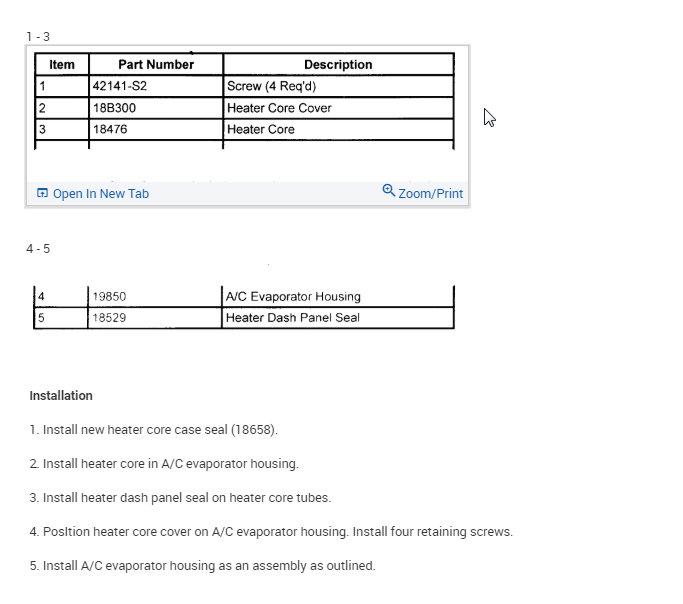

This sounds like the heater core. The heater core is what heats the air that comes into the vehicle so that you have heat. It does this by passing the air over mini radiator where the hot coolant goes through it. So when the cold air from the outside passes over this heater core, it heats the air. When the heater core leaks it allows coolant out and can cause the engine to overheat because it gets low on coolant but at the same time that hot coolant gets picked up by the air coming into the vehicle and brings it in as steam. If there is coolant in your cooling system and not just water then it should smell sweet which will confirm this is the issue.
