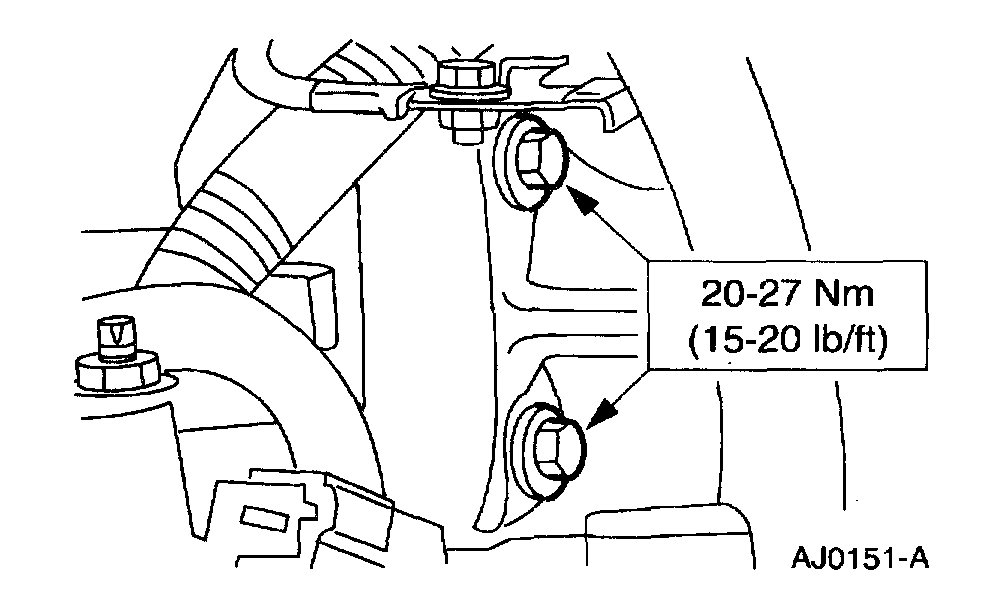

I know very little about auto mechanics. Please excuse me if I don't use correct terminology. I'll do my best to explain the issue.
My car listed above ZX2 model has intermittent starting problems. Most the time it starts right up, takes about 2 seconds after turning the key, and seems to be have full power on the starter. In other words, it doesn't have a slow start like you'd hear with a low battery. But every once in a while, the starter won't engage when I turn the key there is 100% no solenoid click. There is a short pump noise, presumably the fuel pump?
When the starting problem occurs, the car cannot be jump started -- have to compression start (push/pop the clutch).
I had a vacuum leak (low idle/varying RPM idle/frequent stalls) and figured it was related. But I had the vacuum leak fixed a few weeks ago (idles great now and never stalls!), And the intermittent starting problem continues.
The car just passed California smog test.
The problem has occurred in all weather conditions; heat, cold, and rain. It's also started just fine in all of those weather conditions. The problem has occurred on a cold start, and has also occurred when I've been driving the car all day.
I've fiddled with the clutch switch, and the ignition switch when it doesn't start, and that hasn't made any difference. Fuses are okay. When it doesn't start, I still have lights, radio, ventilation, and power to all electrical components. This doesn't seem to be electrical.
I've been told to replace the starter and the battery. But why? If it's starting just fine 85% of the time, why would I need to replace the starter or battery?
Thanks for any ideas.

First, your terminology is better than most. LOL Honestly!! Now, it doesn't sound like a battery issue. However, I do recommend that you confirm the the battery terminals are clean and tight. This is an electrical issue and I was always taught to start at the beginning, the battery.
Since we know that the battery is good, then I honestly either suspect there is a bad connection or the starter solenoid is going bad. When this type of problem would happen years ago, people would hit the starter with a tool and it would work again. That isn't what I'm recommending, but I do need you to do a check for me.
This check will need to be done when the starter doesn't work. You will need a helper. Basically, there are two terminals on the starter. One is a heavy gauge wire direct from the battery. That has battery power all the time. The second wire is a smaller (thinner) wire that only gets power when the key is turned to the start position. I need you to have a helper turn the key to start (when nothing happens) while you check if there is then voltage to the smaller wire.
Here is a link that will help you do this:
If you find there is power at the smaller wire when the key is in the start position, then the starter solenoid is bad. If there is no power, then we have to work backwards which we will do once the test is completed and it is determined the be required.

4. Remove the lower bolt retaining the starter motor.
5. Lower the vehicle.
pic 1
6. Remove the two bolts.

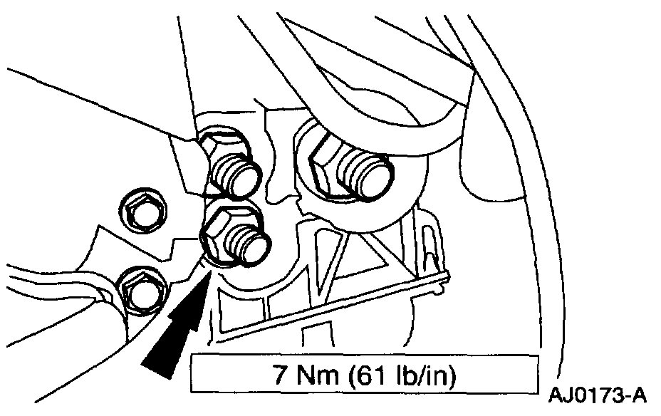

8. Remove the starter motor from block mounting surface to gain access for wiring.
pic 2
9. Remove the integral connector.
Remove the nuts.
