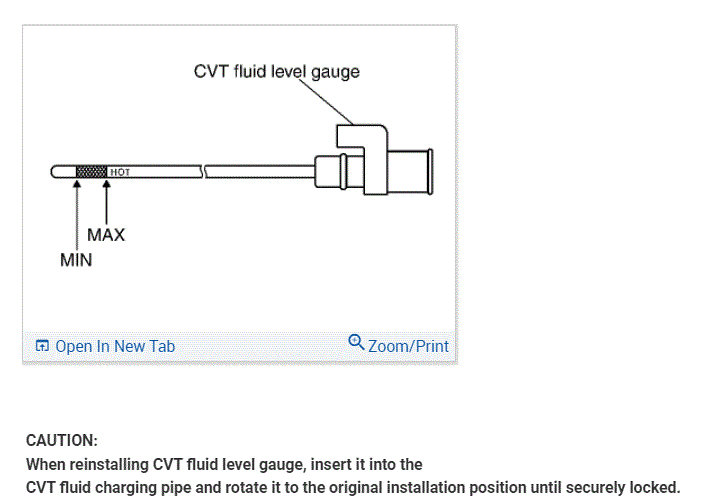

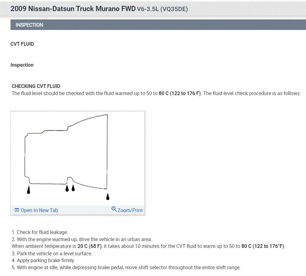

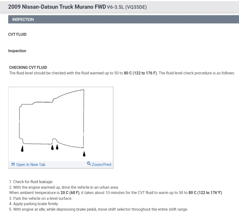

If the transmission is slipping, you will notice the engine RPMs increasing much faster than the vehicle is accelerating. Is that happening? Does it seem like that could be happening when you accelerate? Is the transmission fluid clean and full?
Have you tried having the computer scanned to see if there is anything stored that may indicate where a problem could be coming from?
I feel really bad to know you are still having issues with the rack and pinion. Is that where all the oil is leaking from?

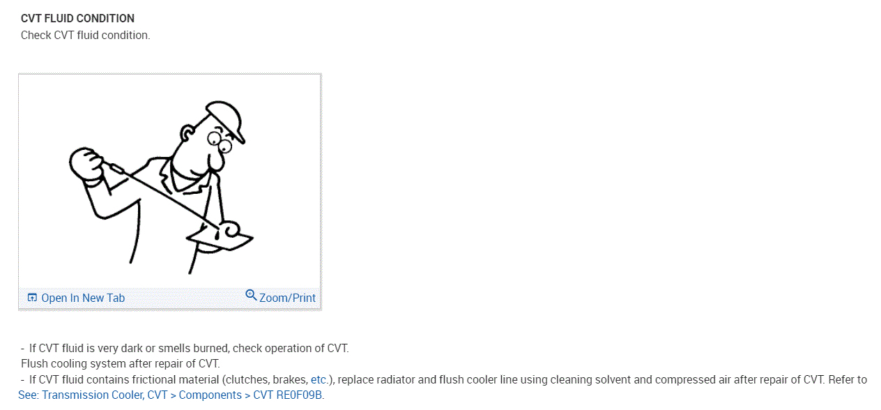

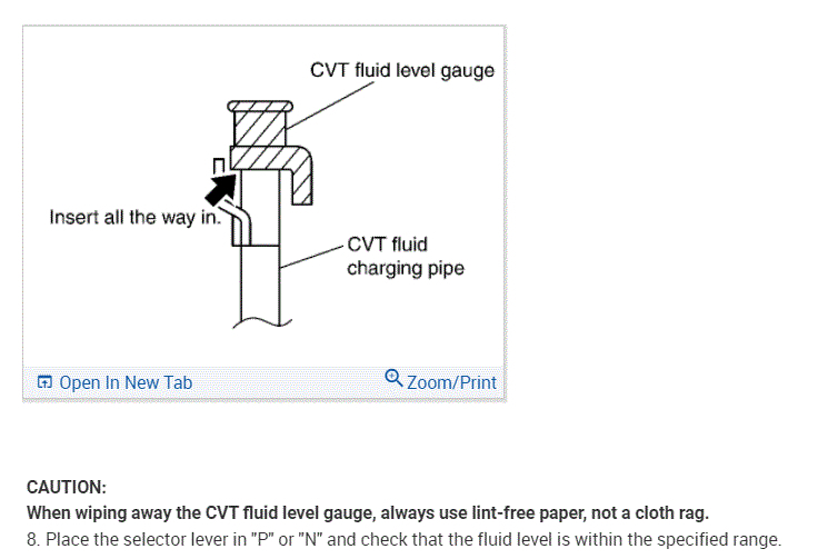

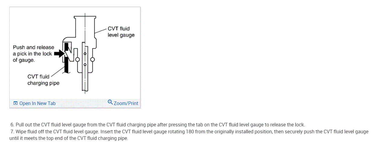

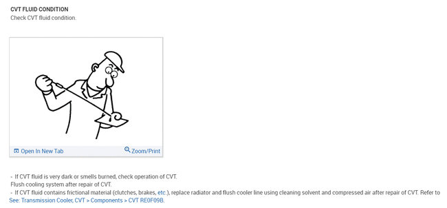

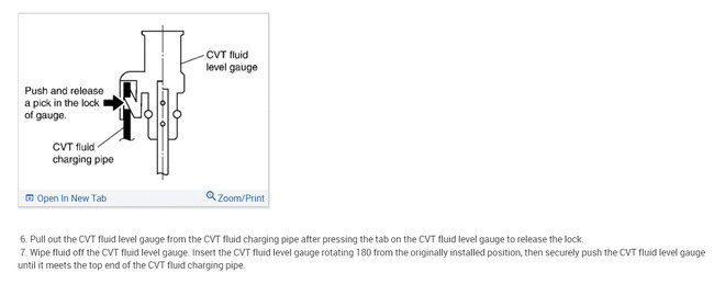

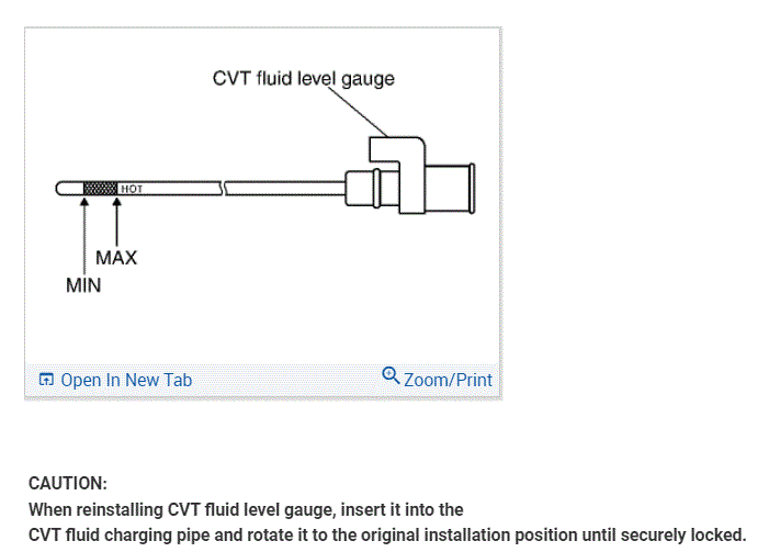

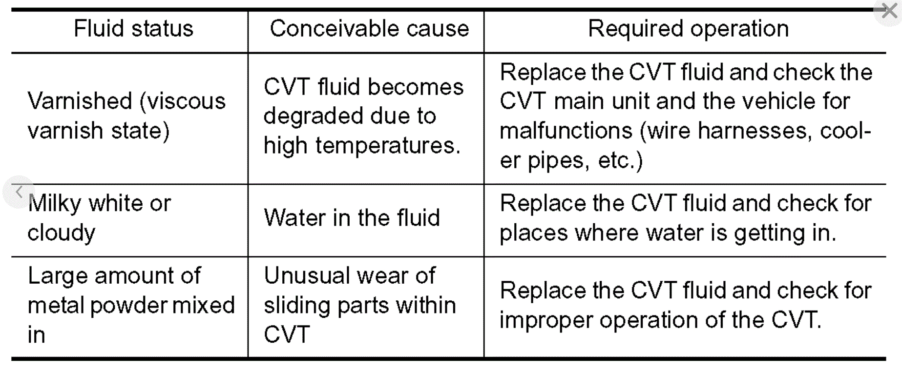

I attached directions below for checking the transmission fluid and what to look for. Do this and let me know what you find. It has a CVT transmission, and they just aren't as reliable as traditional ones.

At 1 point yes the rpm was revving as high as 3to4 but that hasn't happened in a while unlike other CVT transmission I've had this 1 has a dipstick under the hood for me to check the transmission fluid and it is full and it doesn't look dirty, but considering I don't know if it's ever been done. I have thought of draining and replacing the fluid but was told it may do more harm than good. So, I havent yet and it doesn't smell burnt ether but when I'm pressing the gas it feels as though its struggling to get power, but no RPM raises higher then 2 to 3 mostly as for the leaks underneath I noticed right after replacing the pump 3 times due to the 1st two times being done by an idiot leaving it half taken off the 2nd time and the eye bolt and the high pressure hose there's leaking coming from somewhere in this area as well as on the driver's side at the other end connection area or the transmission they are so close I can't tell to be honest, but hers all I have changed the rack but it was used the high pressure hose eye bolts, reservoir, pump, drive belt, battery, control arms, both tie rods on both sides, and both axles. I think that's all. I did notice that there are some tiny rubber hoses that look to ne deteriorating underneath of the engine cover but I used electric tape to seal them. I ran a code scan, and nothing came up, that's why I was wondering if I should have a diagnostic ran on it to see if anything comes up. I also noticed the other am that after starting it there was a light white smoke coming from the tail pipe so I googled it and it said that if any of the plugs had gotten moisture or coolant around them these symptoms could be related, but as you see I have been spending a lot of time and money and work done myself and getting nowhere really and the plugs are not cheap nor easy to do the back 3 and cost is about the same as a diagnostic test. So, I don't know which to do 1st or even at all I have not owned the truck a year yet and mind you wasn't driving it for about 4 to 6 months of this time due to all the issues so with all this info. What's your thoughts now as to what to do? Once the sun comes up I will snap a few pics or a video of what I'm trying to explain. Thanks for responding.

The reason I say about the overall condition is because of the transmission issue you mentioned. If the RPMs are increasing and the vehicle isn't speeding up, it sounds like it is slipping. With a CVT, that usually requires replacement. As far as replacing the fluid, a CVT is different than traditional transmissions, so unless you told me it smelled burnt and was very dirty, you would be fine.

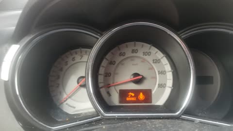

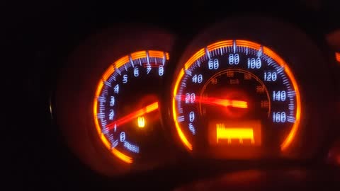

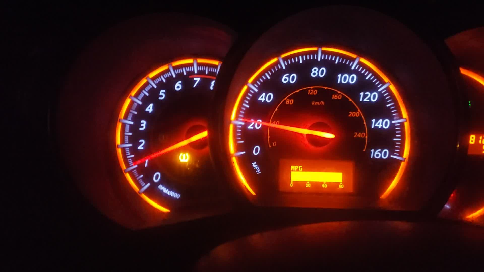

Do me a favor. Video it is starting so I can hear it and see the tachometer. Also, if possible, record what it is doing when driving it. It's as close as I can get to a test drive unless you're in Pittsburgh. LOL

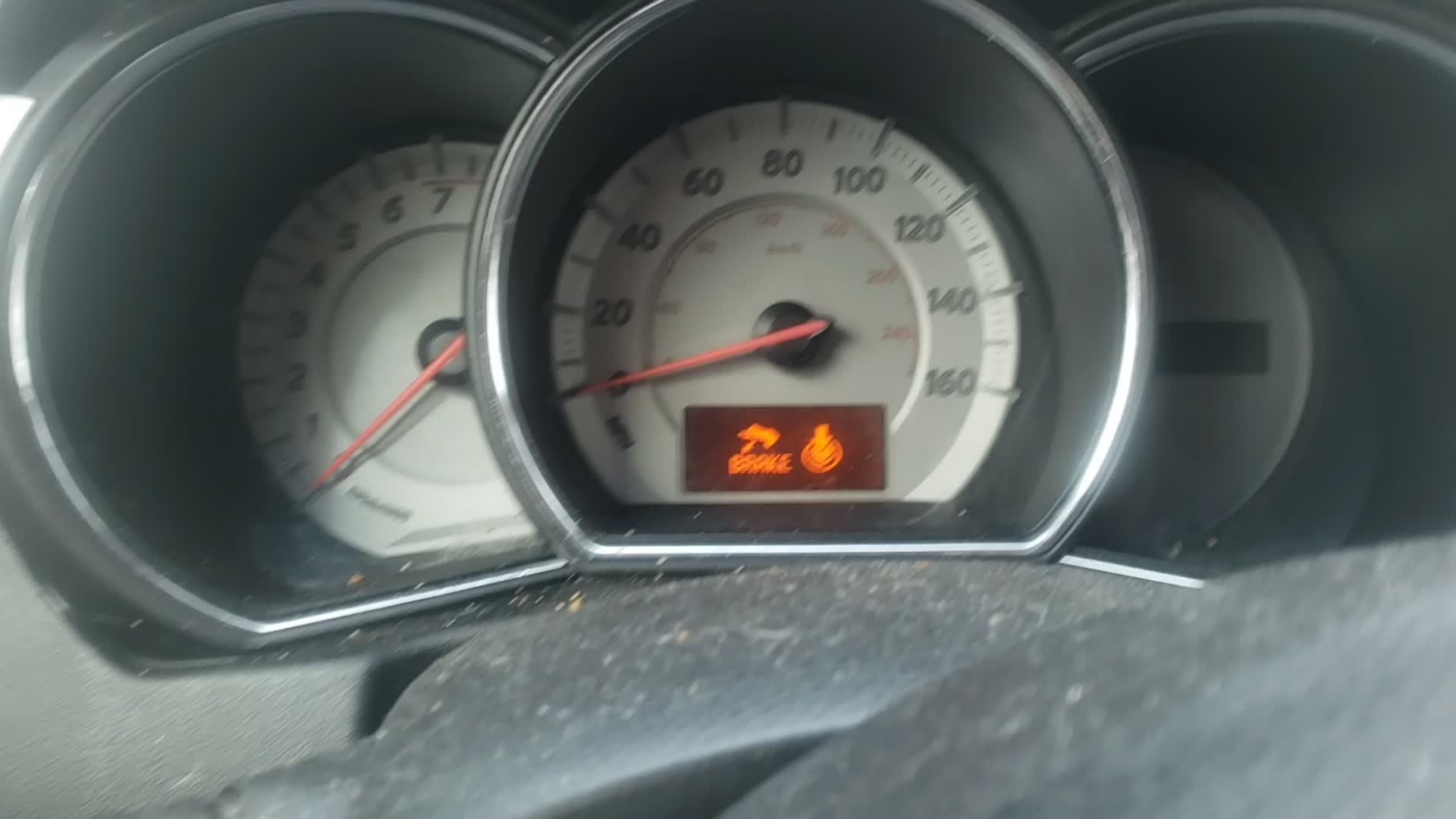

Okay, I will but no the RPMs stay steady between 2 to 3 and it accelerates; still, it's just what I feel when I'm pressing the gas pedal it feels like its struggling and leaks. Haha LOL, I swear the leaks this dang thing got going on now I never see anything coming out when its running or parked but say I clean my driveway today park my car the next morning I will have spots of fluids under it.I rarely have to add any oil transmission or power steering fluids to it. I will go pop my hood and then have my son record the sound when I start it and again showing the dash info and the other stuff you mentioned.

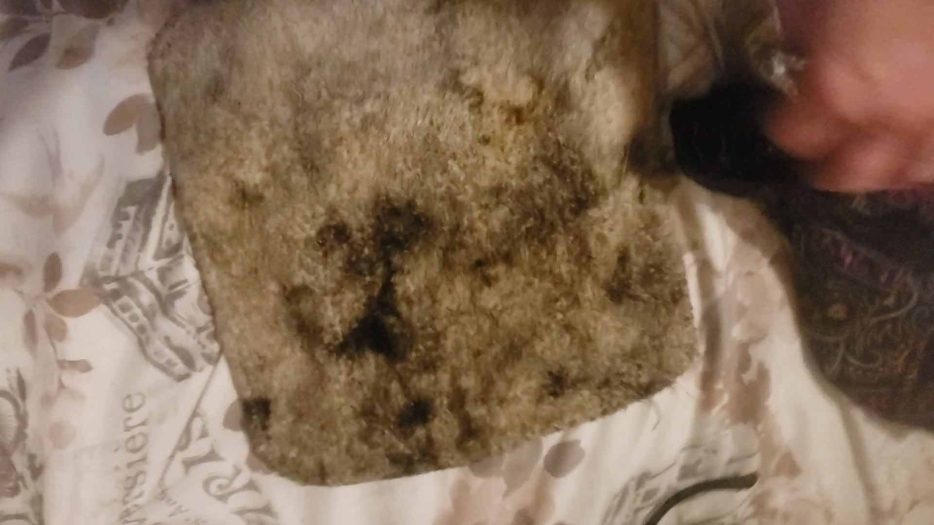

Sounds good. I will watch for your video. Also, pay attention to the color of the spots on the driveway. Maybe even place a piece of cardboard under it to catch the leak. Then see if you can confirm where it's coming from. The color itself can be very informative, so let me know if you can tell.

Okay, so I'm going to try to upload again. My phones acting up and wouldn't let me yesterday.
Tuesday, February 1st, 2022 AT 9:21 AM
  • 110,192 POSTS
Veronica, the bar at the bottom indicates the miles per gallon you are getting at a specific time. When you accelerate, it will drop to the left. The harder you accelerate, the further down it will go. That's normal.
I ran both videos two times each and I cannot hear the engine no matter how loud I make it. Also, the transmission doesn't appear to be slipping, which is a good thing. Sitting here, it seems to run well.

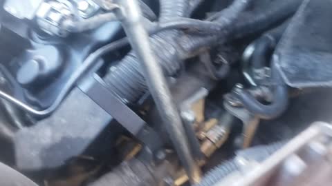

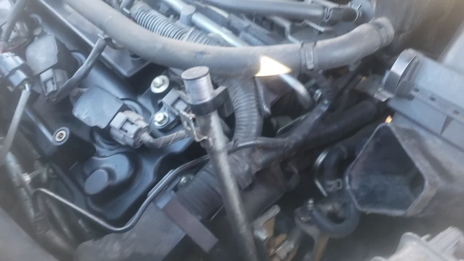

Okay, so here are the little hoses I mentioned earlier that I thought someone had cut at first until I looked closer and saw they are deteriorating and there's a unconnected hose. I don't know where it goes other than somewhere under the breather box. I'm cleaning the MAF Sensor and throttle body now then my plugs. What rare your thoughts?

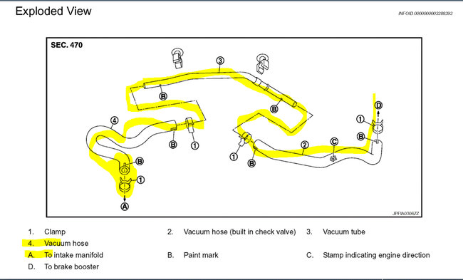

I watched the video you provided. First, on the passenger side, it appears that there is a purple vacuum hose that is disconnected. Is that correct? As far as the one by the air box, that looks like it could provide vacuum to the brake booster. Note it is much larger. If you follow it, where does it end?
I attached a pic below showing the vacuum hoses to the brake booster. Let me know if it is one of them.

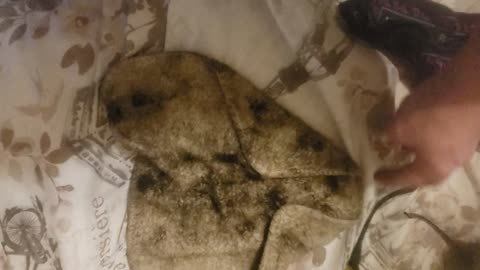

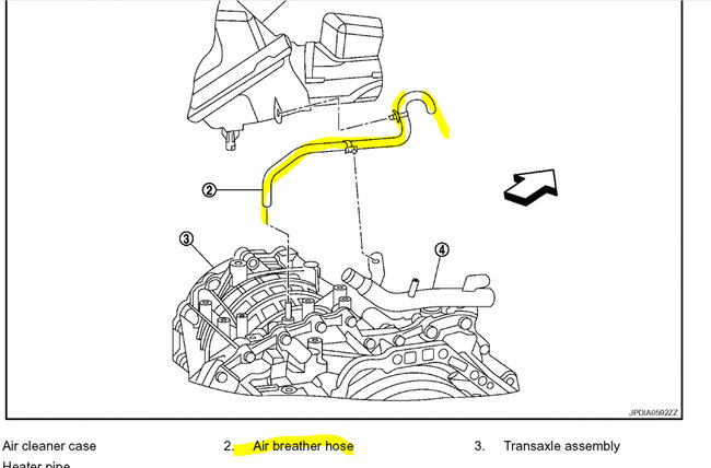

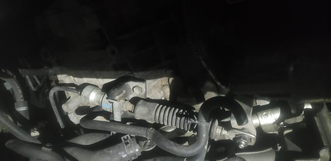

Wow I swear I had responded yesterday sending 3 videos and now I don't see the feed at all from that so il try again so its not the passenger side that hose comes off the tranny and I to idk what but it runs under the air filter box now on to my most latest progress I cleaned the maf sensor and the throttle body and this is what I got out of it im including a video there looks to be a fiter or something like it inside the flap thats stained and a lil bent still but much cleaner I also put a new air filter in im going to change my plugs and the throttle body air intake housing hose thing cause its been mended enuf prior to me buying the truck when driving its got more power now but while coasting it will jerk slightly as if trying to stall out I also got a piece of cardboard to place under it tonite to see leak spots

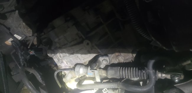

Good to hear from you. Listen, is it possible for you to take a pic of the hose coming from the trans? There should be transmission fluid cooler lines, but nothing to do with vacuum. Let me know. I'll watch for your reply.

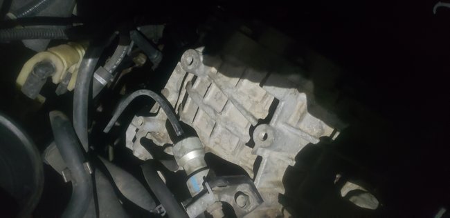

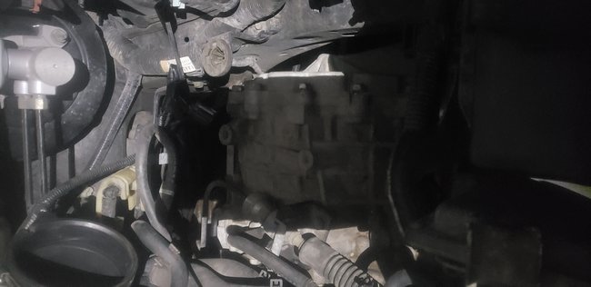

Okay, so here are a few different pics of the hose and what it is coming off of. Also, I got a piece of cardboard big enough to fit under my truck side to side so I can show you all my leaks. I will send it in the morning. Sorry, this is at night, but I got off work too late.
Wednesday, February 9th, 2022 AT 4:51 PM
  • 110,192 POSTS

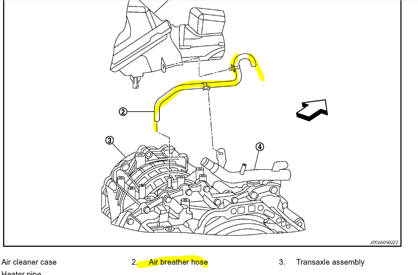

I looked through the pics. That is a transmission vent. It doesn't attach to anything on that side. See pic below.
Let me know about the leaks.
See pic below
